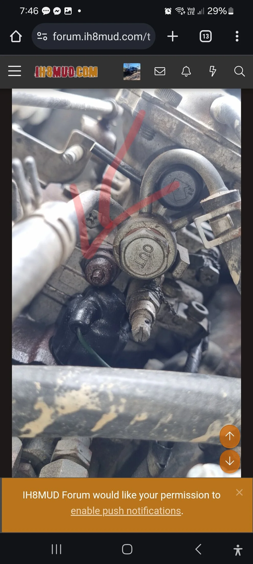

Can I replace this on my own, or is a diesel specialist required.
May 14, 2023
5
21
australia

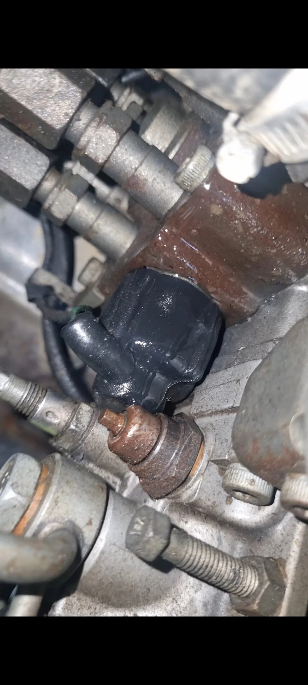

Ive attached a link below, essentially the line drawn to the screw is leaking and i need to find a part or some information about it to replace or fix with seal sizes etc.

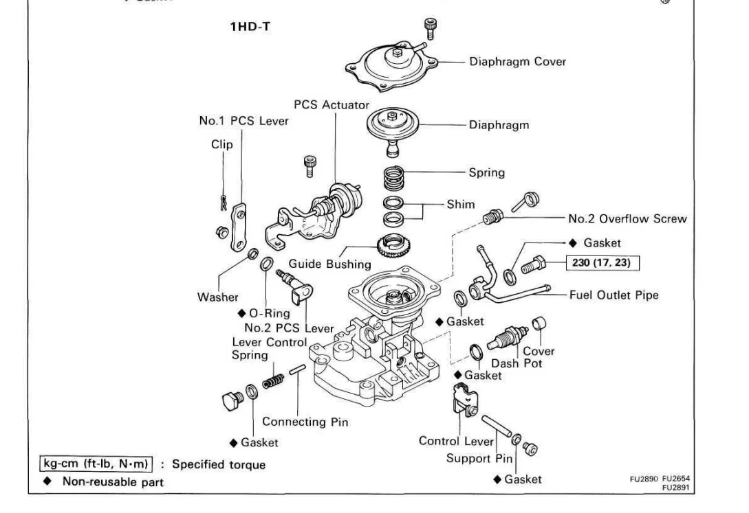

the leak is coming from the end under the cap cover where the threads are, on the FSM its labelled Dash port?
Really struggling to get a P/N or an actually name for the Screw/nut and would love some help..
Thank you in advanced.

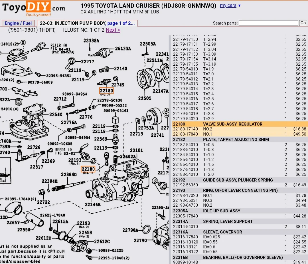

Go to www.partsouq.com and enter your VIN. All parts and part numbers will be available to you.
Go to post 15 in this thread
Thread 'Injector Pump Solenoid Question' Injector Pump Solenoid Question - https://forum.ih8mud.com/threads/injector-pump-solenoid-question.1301805/
Screen shot below is from Toyodiy, but as mentioned above, the same diagrams are available on partsouq.com
I can't find any reference to a seal, or oring.
Wondering if it relies on a tapered thread
Thank you mate I had major difficulty finding something like this. I have a hdj80r 1992, any idea if the pumo has changed from 1992-1995? Thanks!
The good news is I've found the part, I've had mixed recommendations on what my next step is tho.
