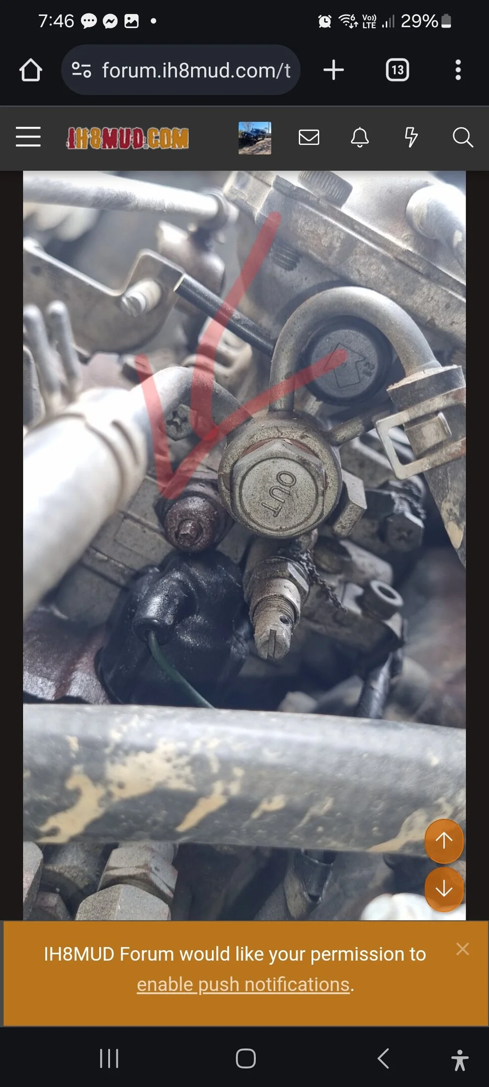

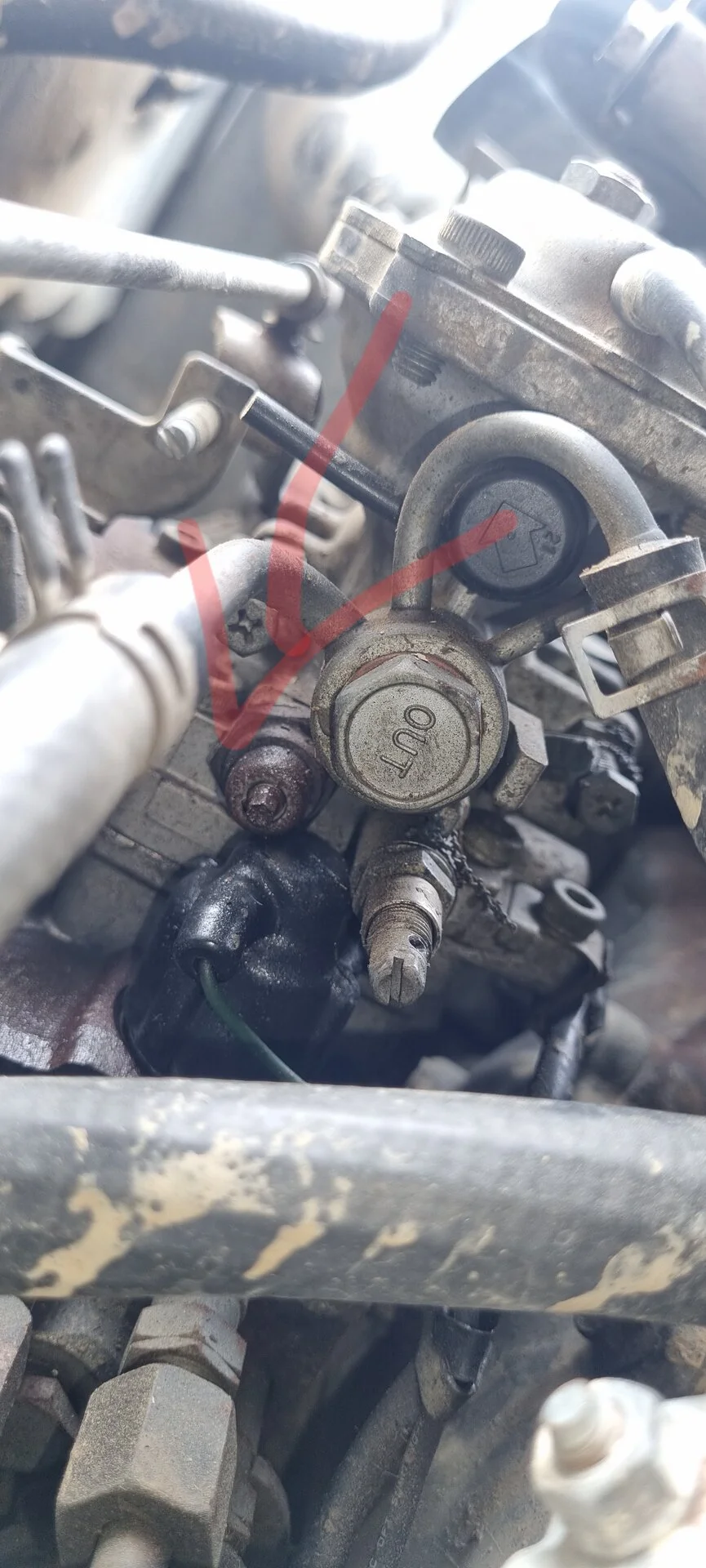

I've found the leak is coming from where the red arrow is situated. Can't tell if it's the seal or something else. Any advice?

Injection pumps leak when O rings get hard and shrink, or if copper seal washers have been re-used.
If the leak is really coming from that point (which IIRC is a small pressure regulator), then you can try replacing the copper washer, though they should never start to leak unless they have been disturbed. If that does not work, either the leak is coming from somewhere else (most likely) or the component itself is leaking.

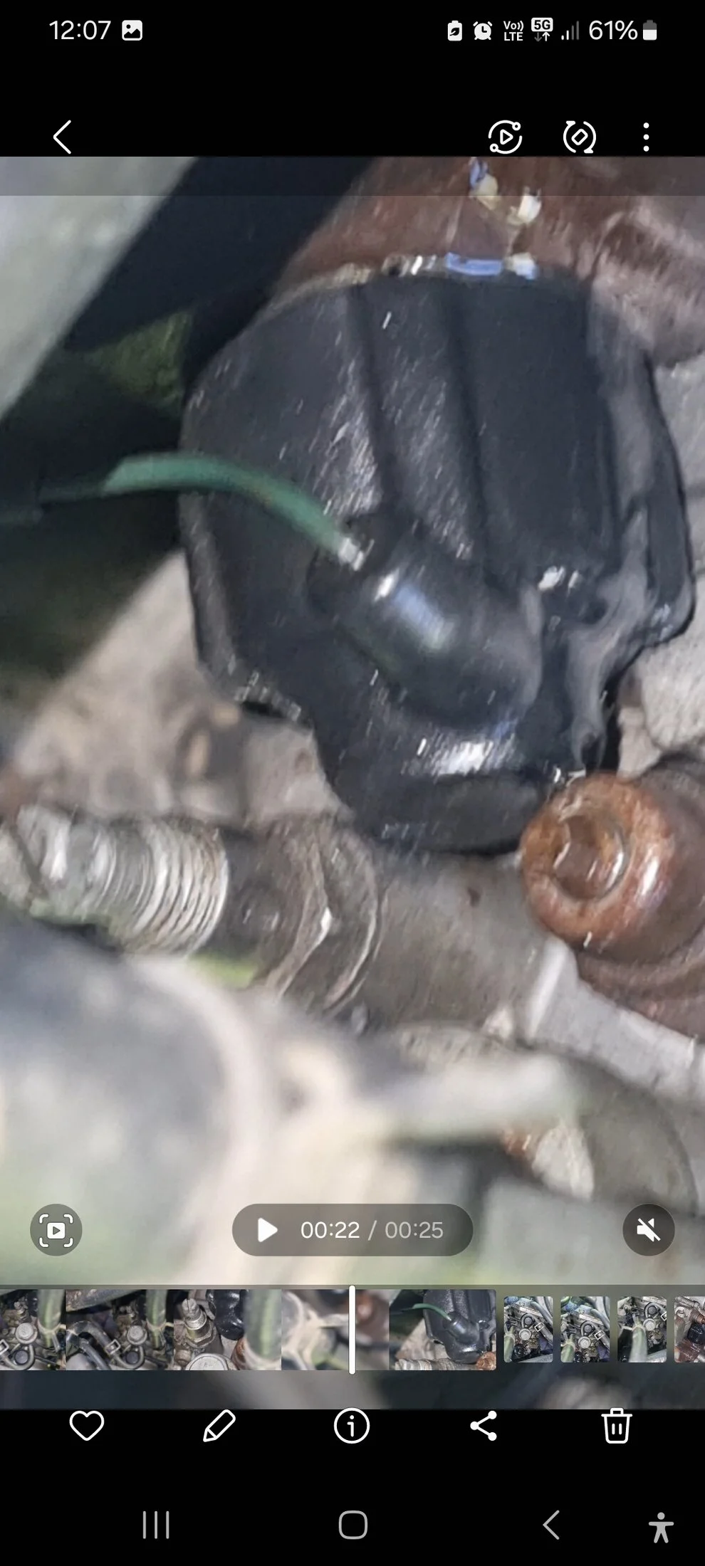

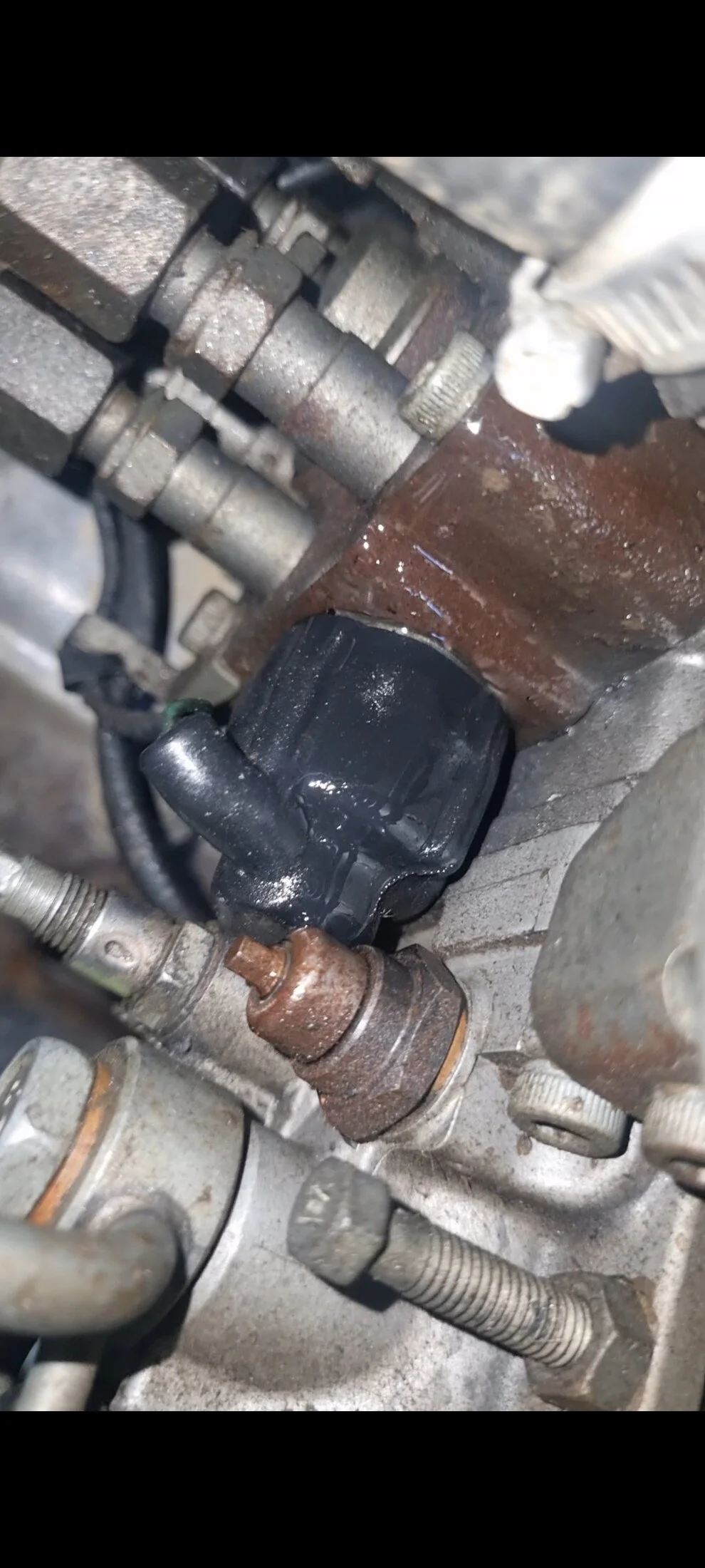

The whole (solenoid or lead wire plastic cover?) seems to be soaked with more prominent fuel going on the side under the pressure regulator? The rusty valve.
It looks like the regulator is leaking through the threads of the adjuster bolt, it does not look like it's coming from the copper washer against the body.
You may be able to remove the cover to expose a lock nut and possibly another washer or O ring, but I have never been in there myself. Worst case, you could buy a new regulator - I believe that P/N 22749-64851 should fit.
