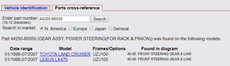

I did some research and of course the oem ones are the best way to go, but the Lexus dealer asked $1000 for the part. I found someone on the forum just bought the one for LC from Comeback Toyota just for $532. So my question is can I get a rack for LC and put it on my 1999 LX470? Has anyone done this before?
I see the part number is 4425060050 for the LC steering rack. Can't find a part # for Lexus steering rack though.

Going to rockauto, checking the Land Cruiser rack part numbers against the Lexus LX470 rack part numbers, indicates they are the same. Personally, as much work that is involved, I wouldn’t risk it with aftermarket, I would get Toyota.
I've not checked you part numbers. But yes they are interchangeable form 98-02. 98-02 use a "D" bushing on PS with two tie down bolt and two bolts on DS one front the other on rear of race.
In 2003 they went to a different design that has one tie down both on each the DS & PS, this will not work for you.

Its the same
