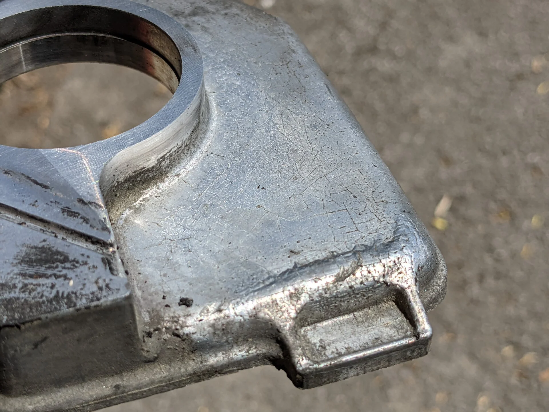

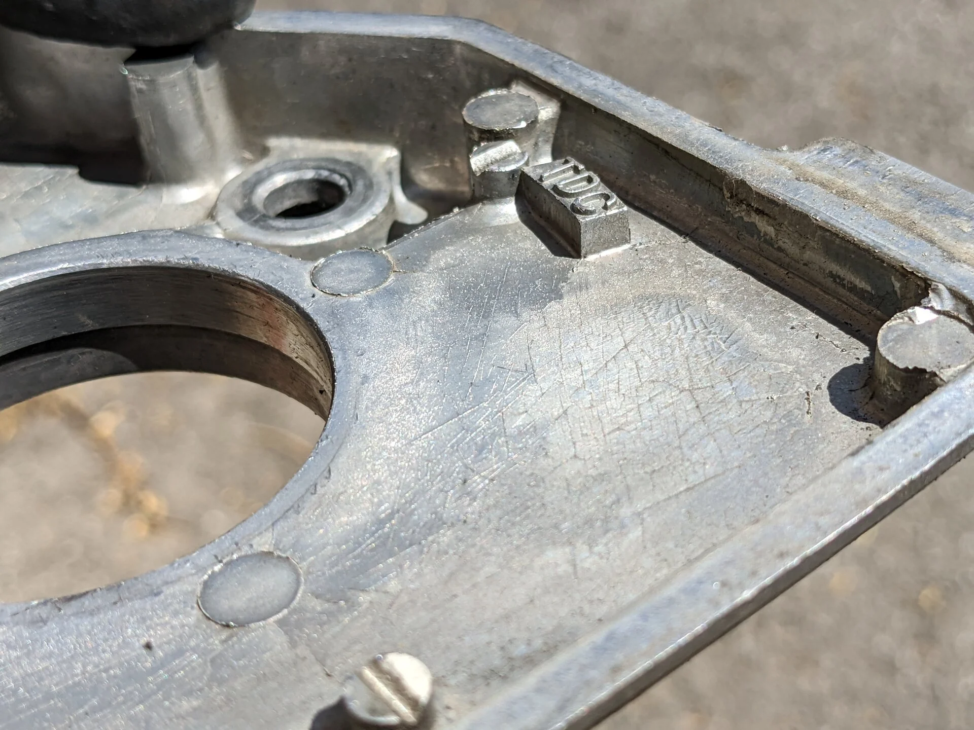

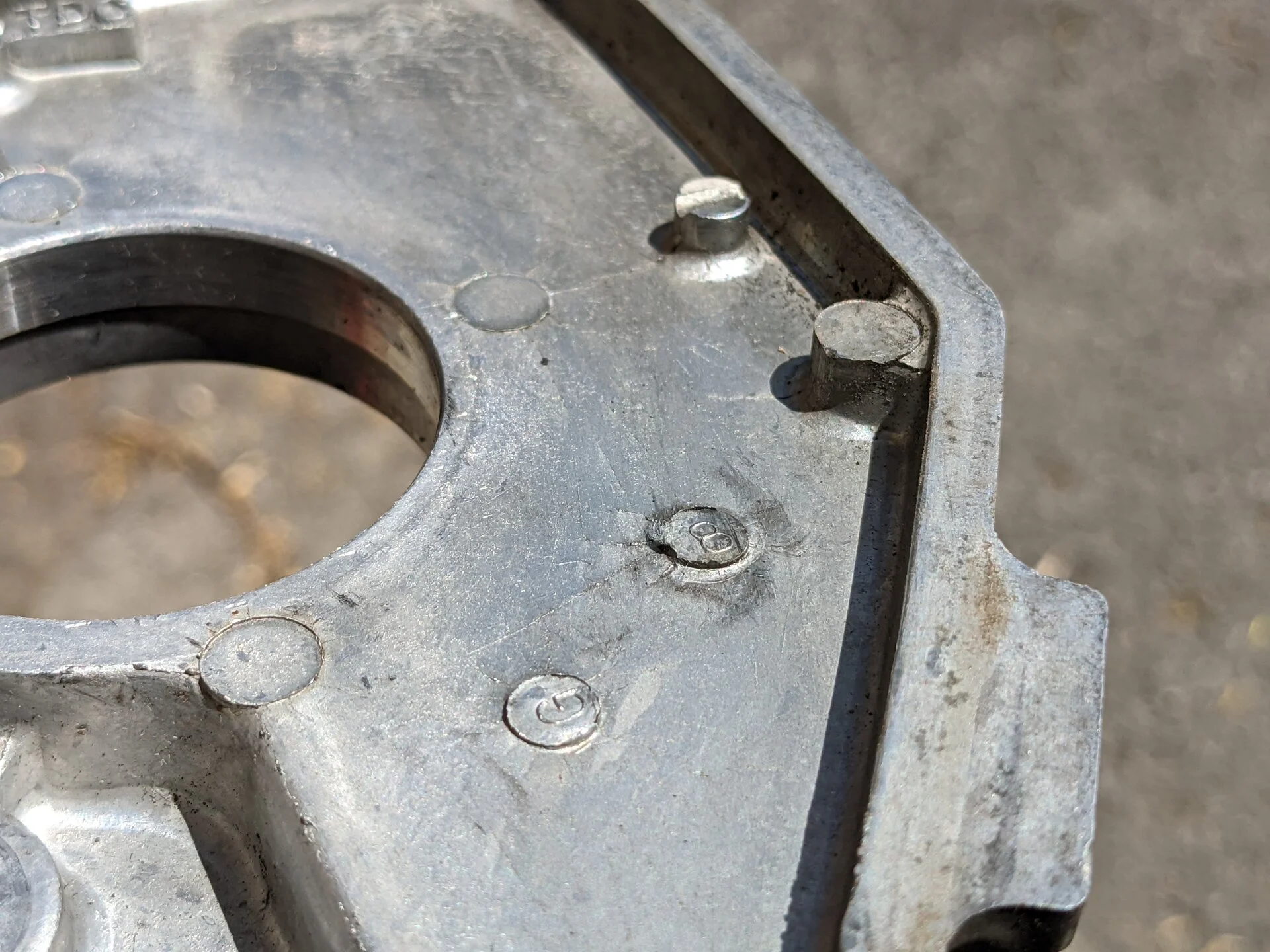

Hi,
In the process of changing the timing belt, water pump + belt as well as A/C belt, thermostat and camshaft oil seal on 1PZ and just noticed what looks like very fine cracks or casting marks on both sides of the oil seal retainer. Also there appears to be a slight lump on the back side at the top which might be a repair weld although I see no obvious crack under or around it. Opinions?
I'm currently looking for a replacement (11382-17010) but I'm not sure if it is worth replacing or not. If I can find the part relatively easily and it isn't too expensive I'll go ahead and replace it. I believe this part is the same as on the 1HZ so it shouldn't be too difficult to get...
Also, any good sources for a replacement gasket (11213-18010) for the cylinder head cover of a 1PZ? Mine appears a bit squished...
Thanks!
Normal part of the casting operation at Aisin.
