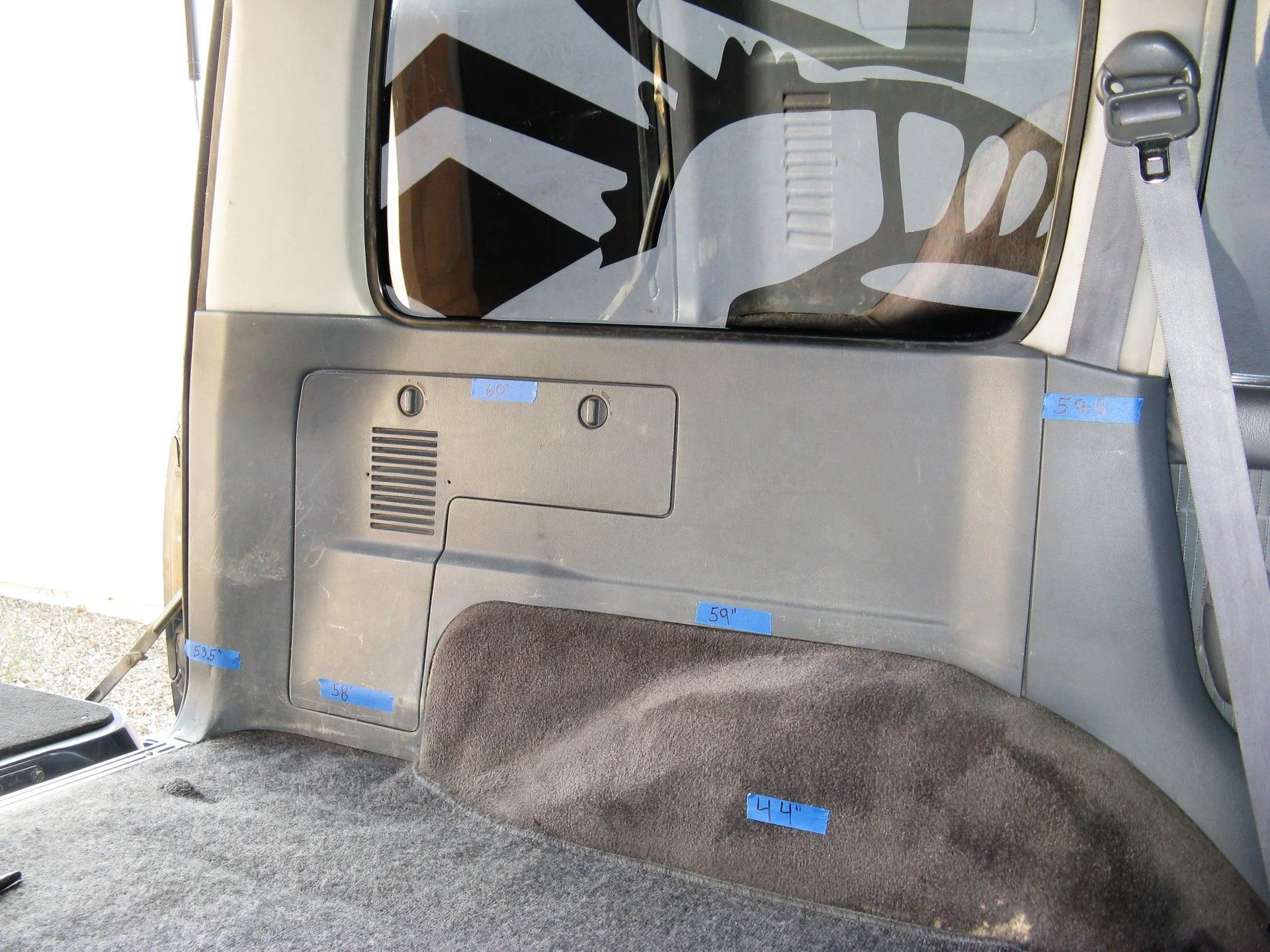

Some measurement for the guys thinking about building out the inside.
A 3/4 cut keeps the full back accessible up to the back of the seats
Side measurements on horizontal at the noted measurement
Floor measurements from the back of the tailgate forward

3/4 is the way to go for me. I'm thinking of interior layout possibilities and was just doing the same as @LandCruiserPhil with the measurements.
I was thinking about a build that would leave one rear seat, but I'm not sure. I'd really like an area to sit, maybe something fold down and a small swing out table for eating or a laptop.
The other side would need to hold the fridge and have a place to put the stove if I needed to cook something inside...
I'd be losing the storage in the arb drawers and haven't figured that out yet.. I'm wondering if this platform is just too small for those ideas ????
