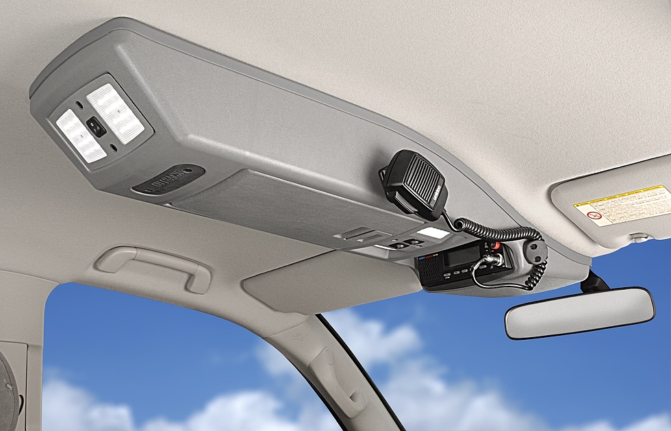

If one had the time and skills, one could fabricate an overhead console, like this one by Outback but much shorter, with a dome light facing rearward.
There are tons of dome light options. Just hit your local junkyard and find something compact. Then stick an LED bulb in it. Or do LED strip lights!
