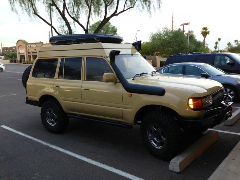

Sweet technology! And the install looks nice! However, I thought the ability of this RTT to go under/through trees branches was a good selling point!
Nothing has changed. The new panel is more durable then a frame constructed panel. I ran a framed mounted panel for several years with zero issues.
Now that you will be camping in the sun. (Do you have to face west in the eve?) Are you considering an awning?
I see no need to camp in the sun. I set up at the end of the day or dark and Im gone by 7AM:meh:(CampTeq advantage;)) but I do try to park facing east for the night. With the CampTeq open the panel starts making power the minute the sun comes over the mountains when it is needed most.

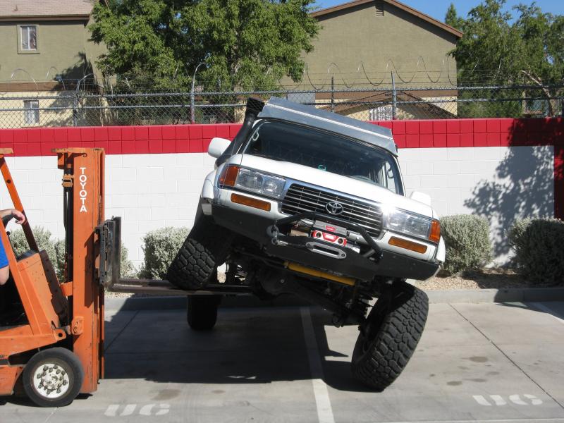

Custom front swaybar disconnects (new version)
Without swaybar disconnects I could lift a front wheel 26" before another wheel lifted
With front swaybar disconnected I get an increase of 4.5" or 30 1/2" inches = ~15% increase
Surprising results for just disconnecting the swaybar
To disconnect and connect the front sway can be done 1 -2 minutes.
The mod also adds a higher degree of safety by keeping the wheels planted in more extreme condition with additional traction.
Pictures are with the swaybar disconnected

My Solar set up:
Solar Panel - Grape Solar 100w thin (.12") 20"x40" Panel attached to top with 3M .045 double sided tape
Charge Controller - Mornigstar ProStar 30m Displays Battery voltage, Solar output, Load amps
12V outlet for Convenience and wired to controller to read power consumed from outlet.
Battery - Optima Blue top separated from starting battery when vehicle is off. Battery located at rear of vehicle and will charge from vehicle when running.
Normal Load - Waeco CF-50 fridge, Net book power supply and GPS dongle

The Panels thin profile has been a big plus with the type of travel I do and has proved to be very durable. Over the last several months I have stood on the panel and been in contact wirth many branches and tree limbs with no signs of any damage.
