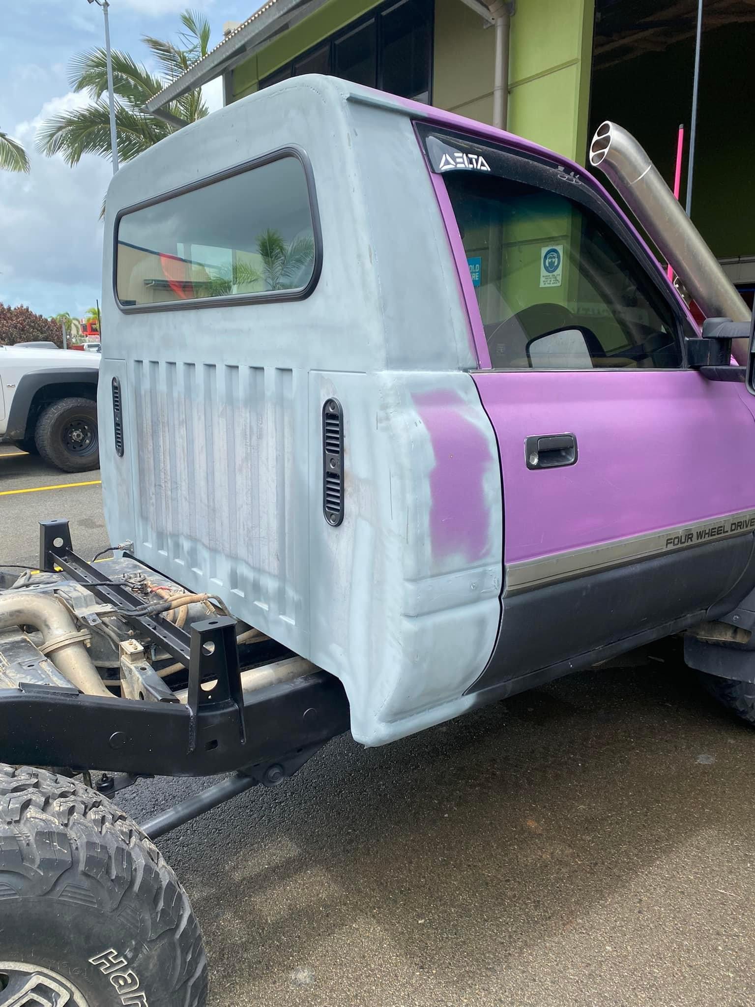

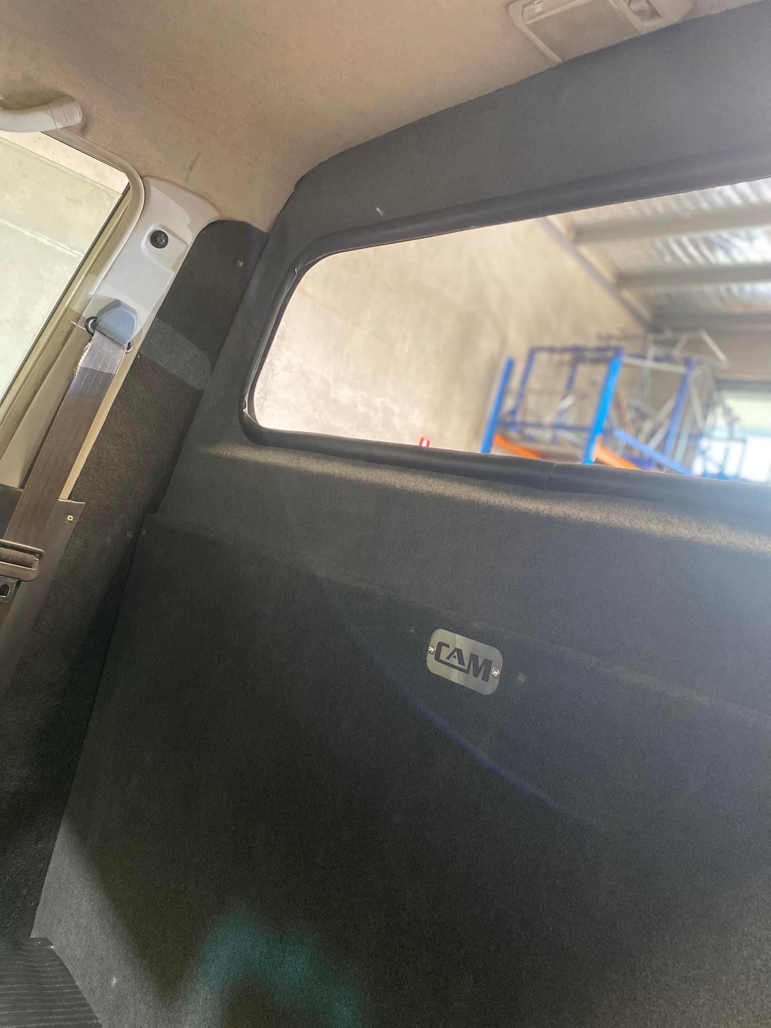

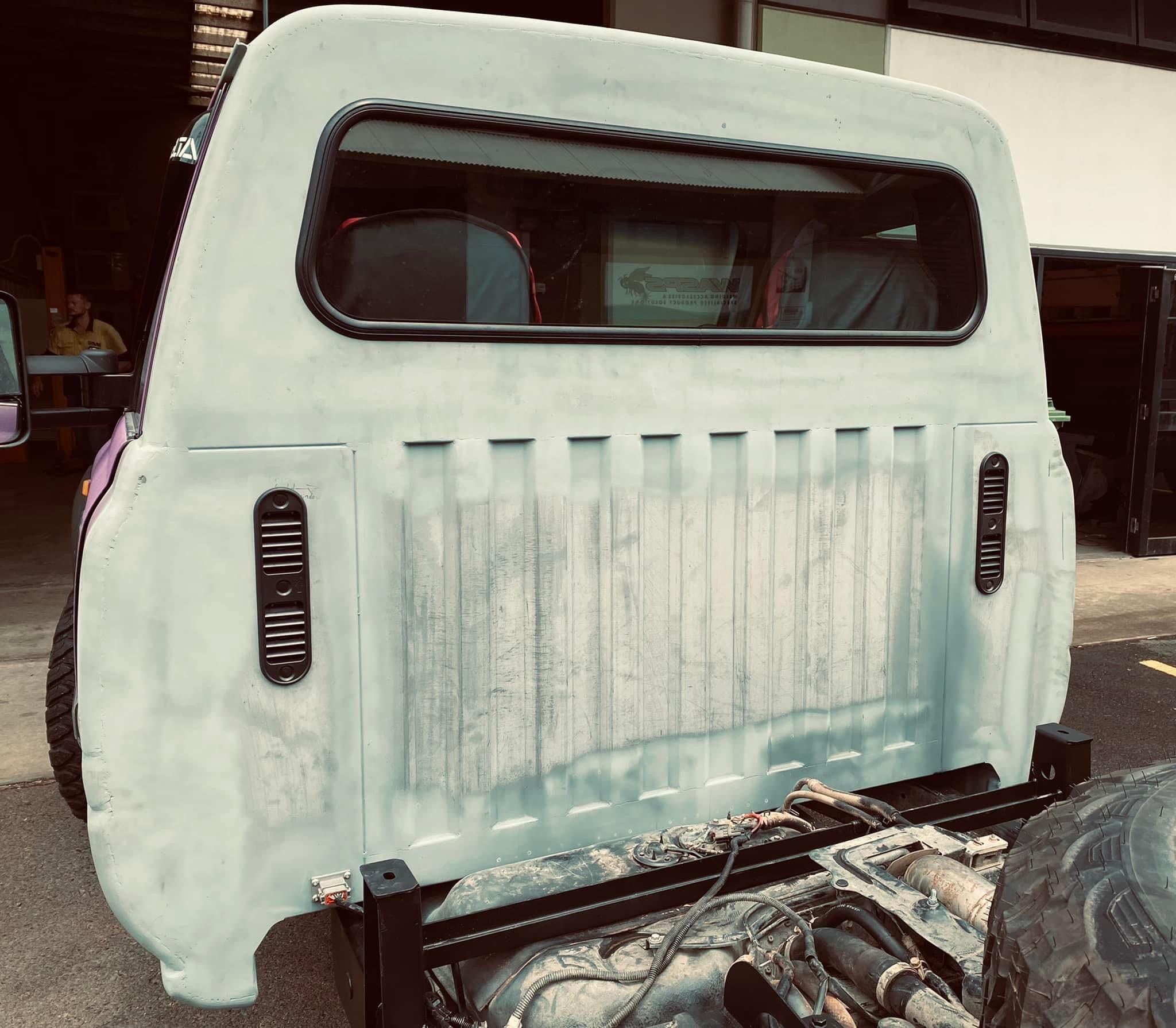

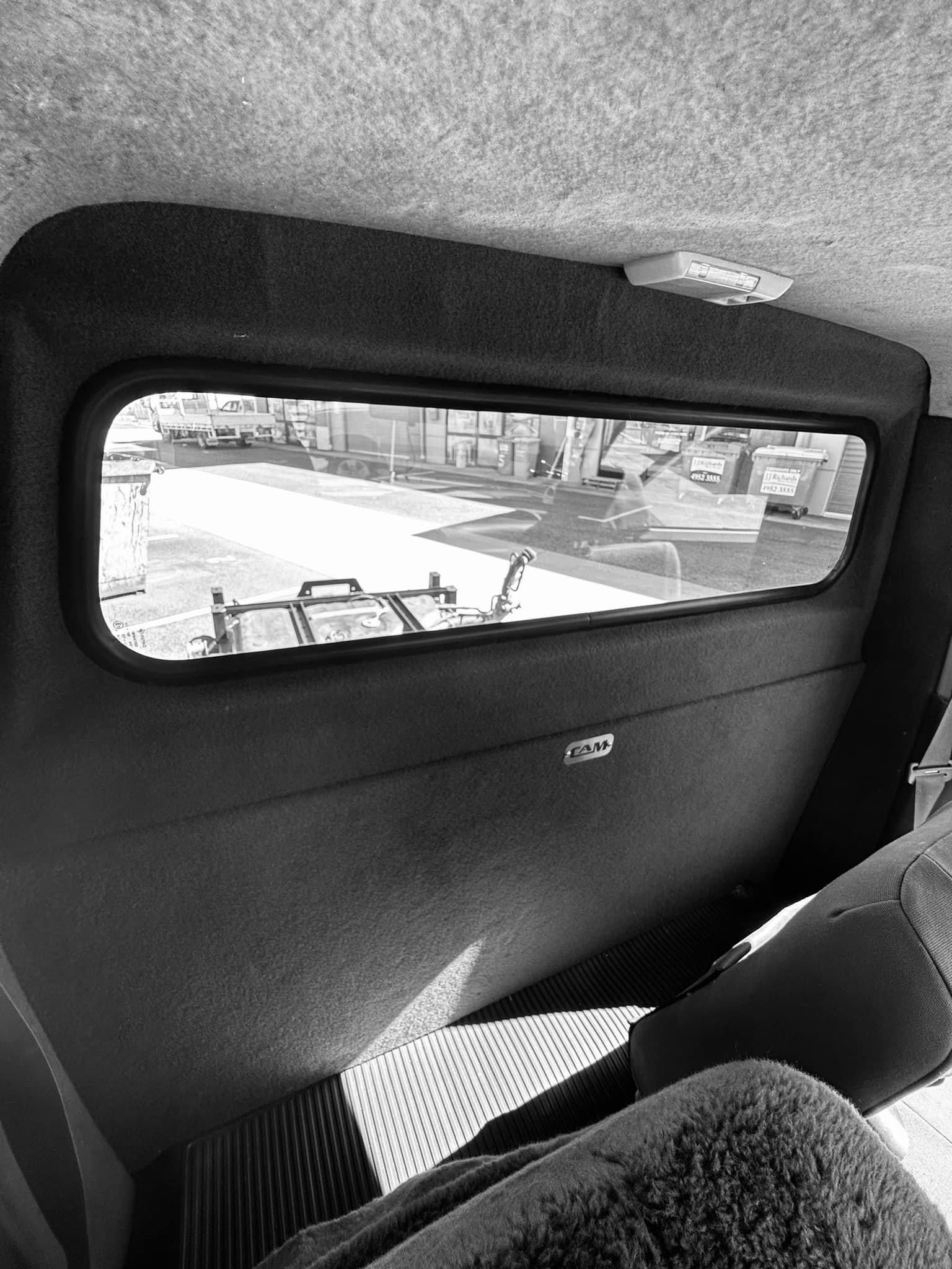

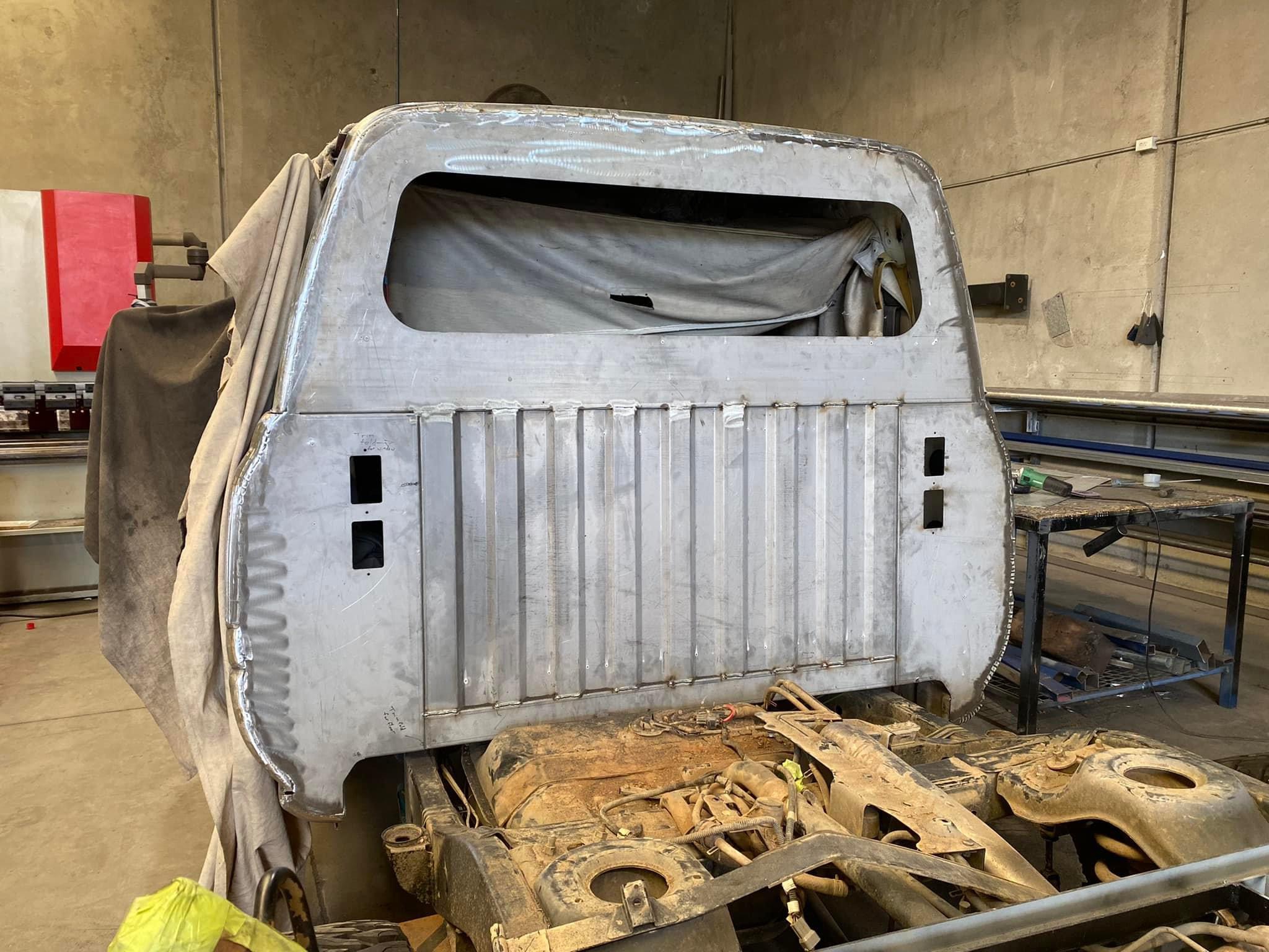

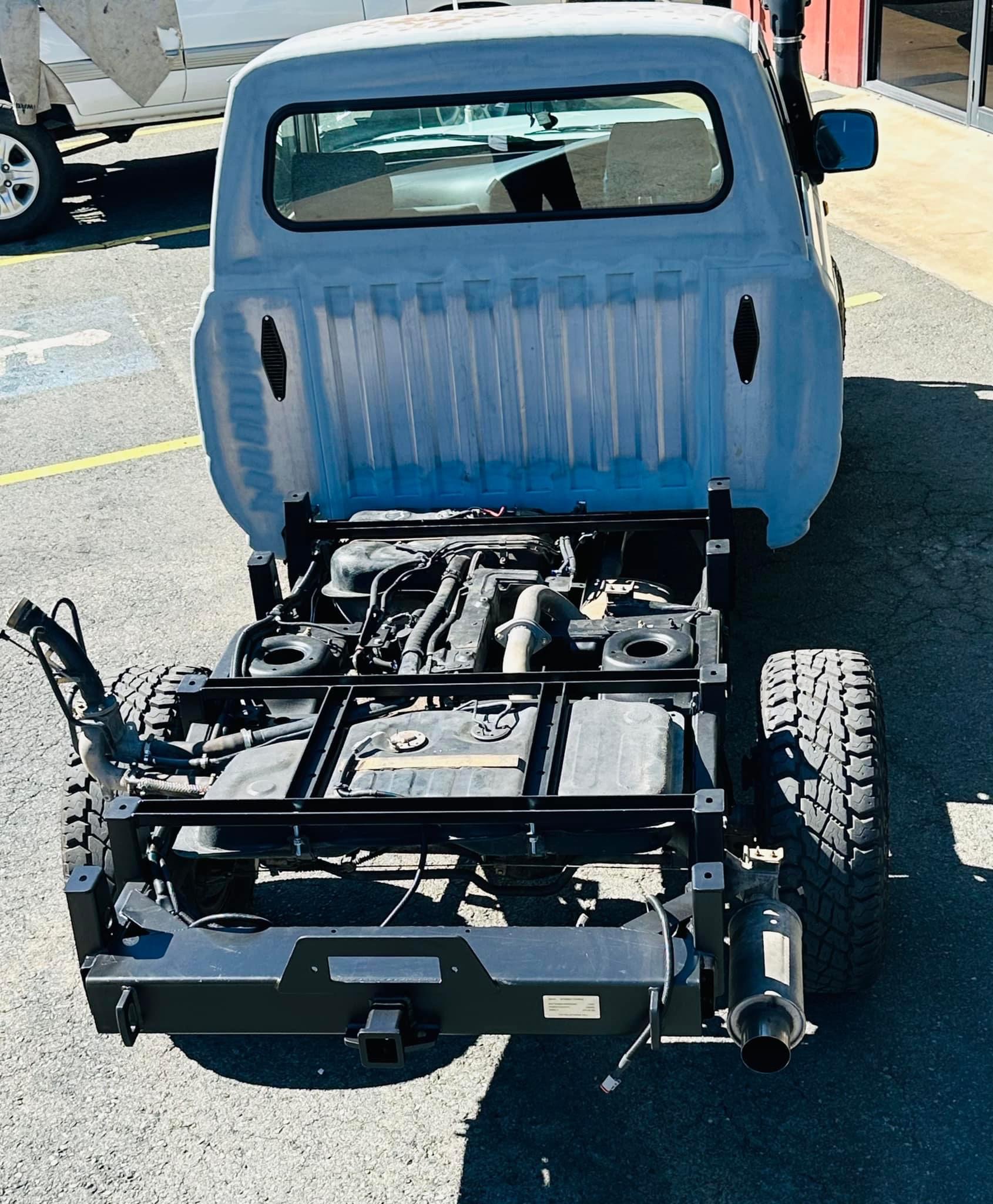

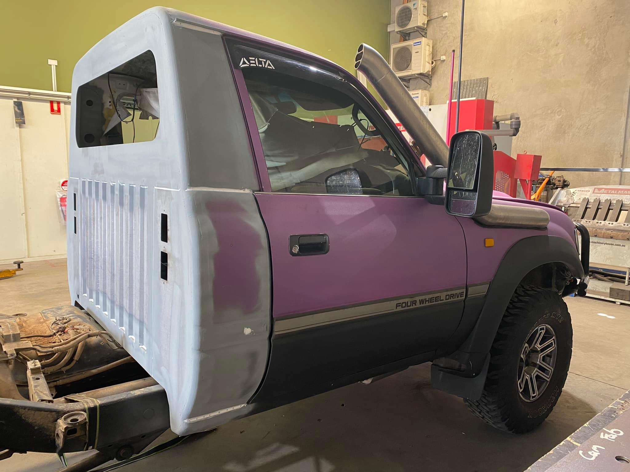

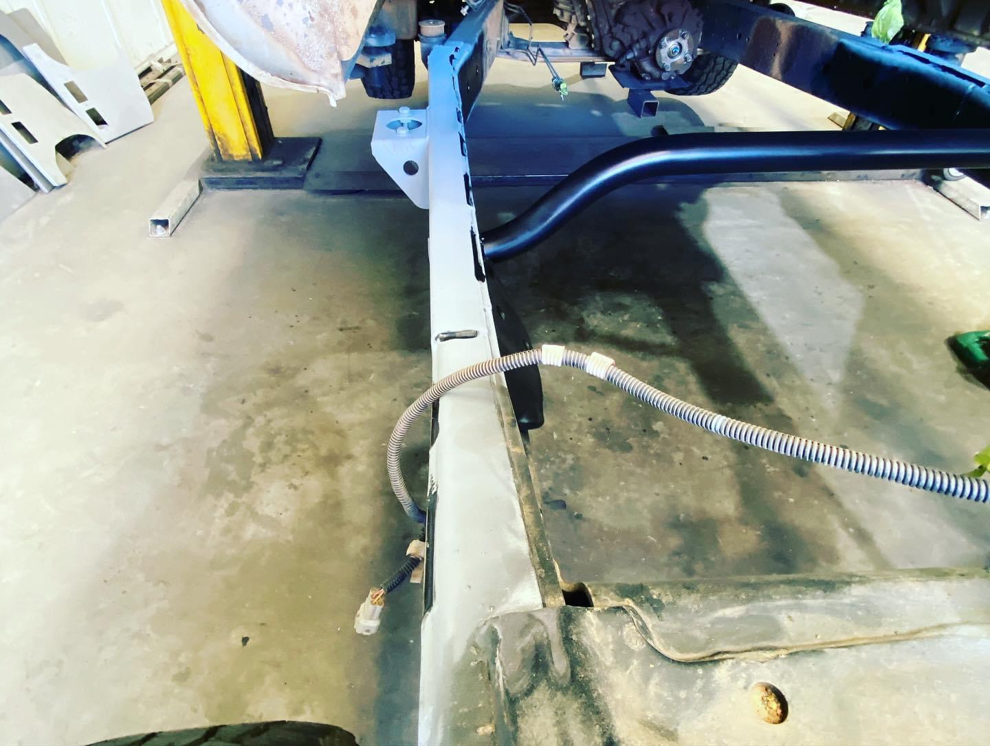

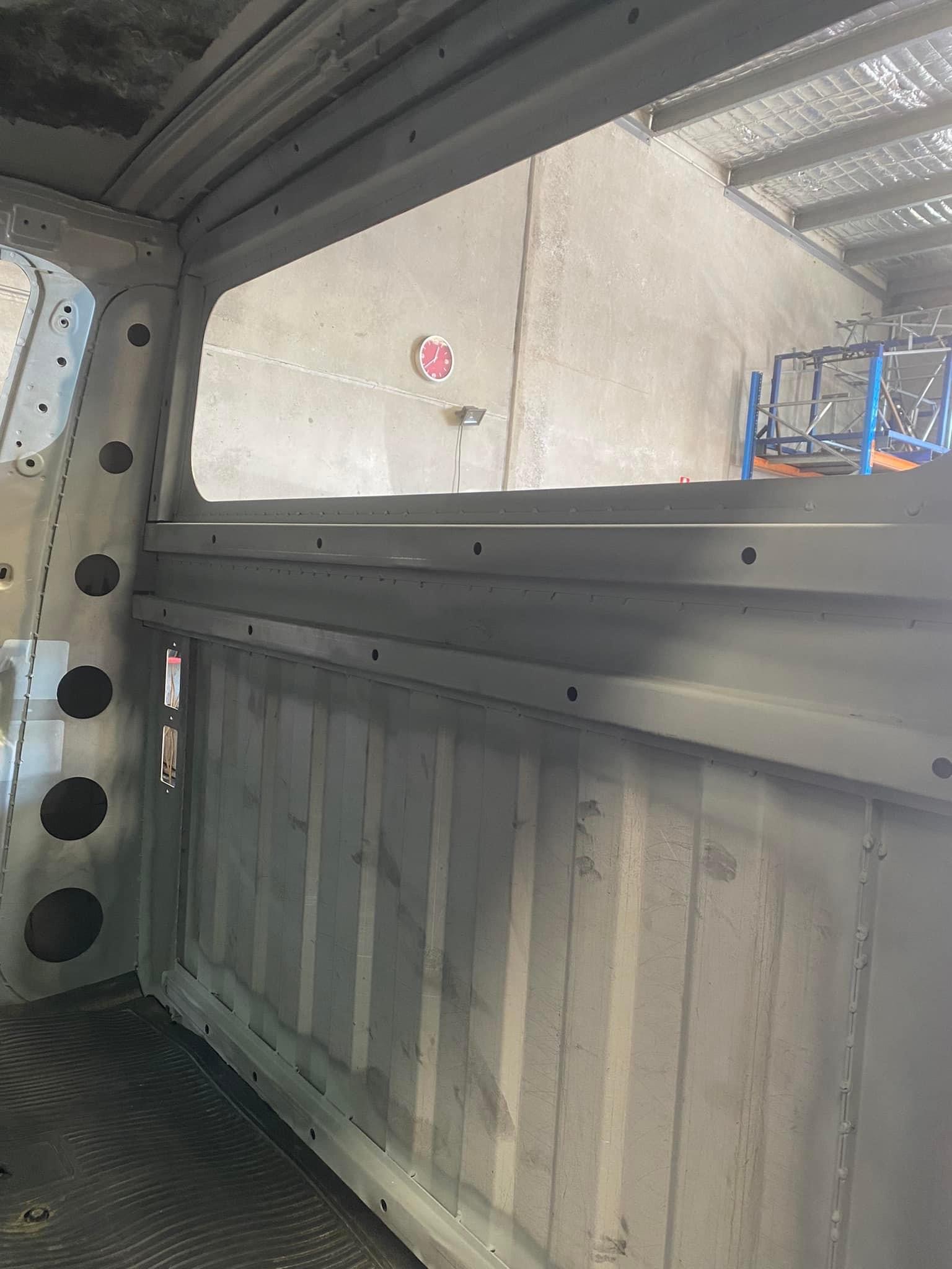

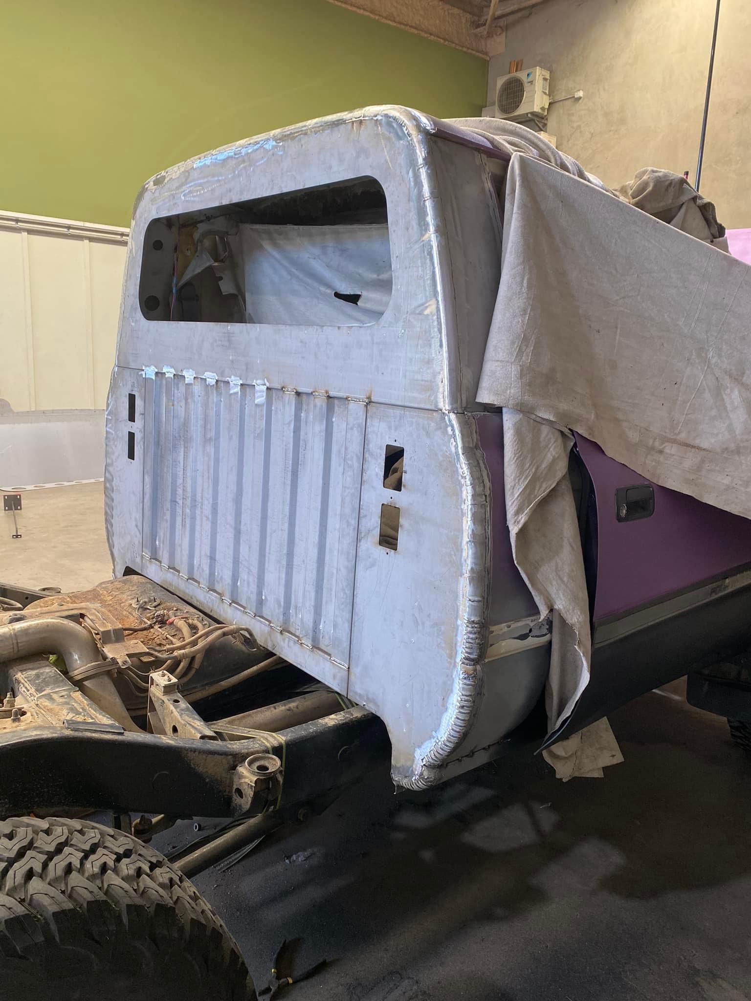

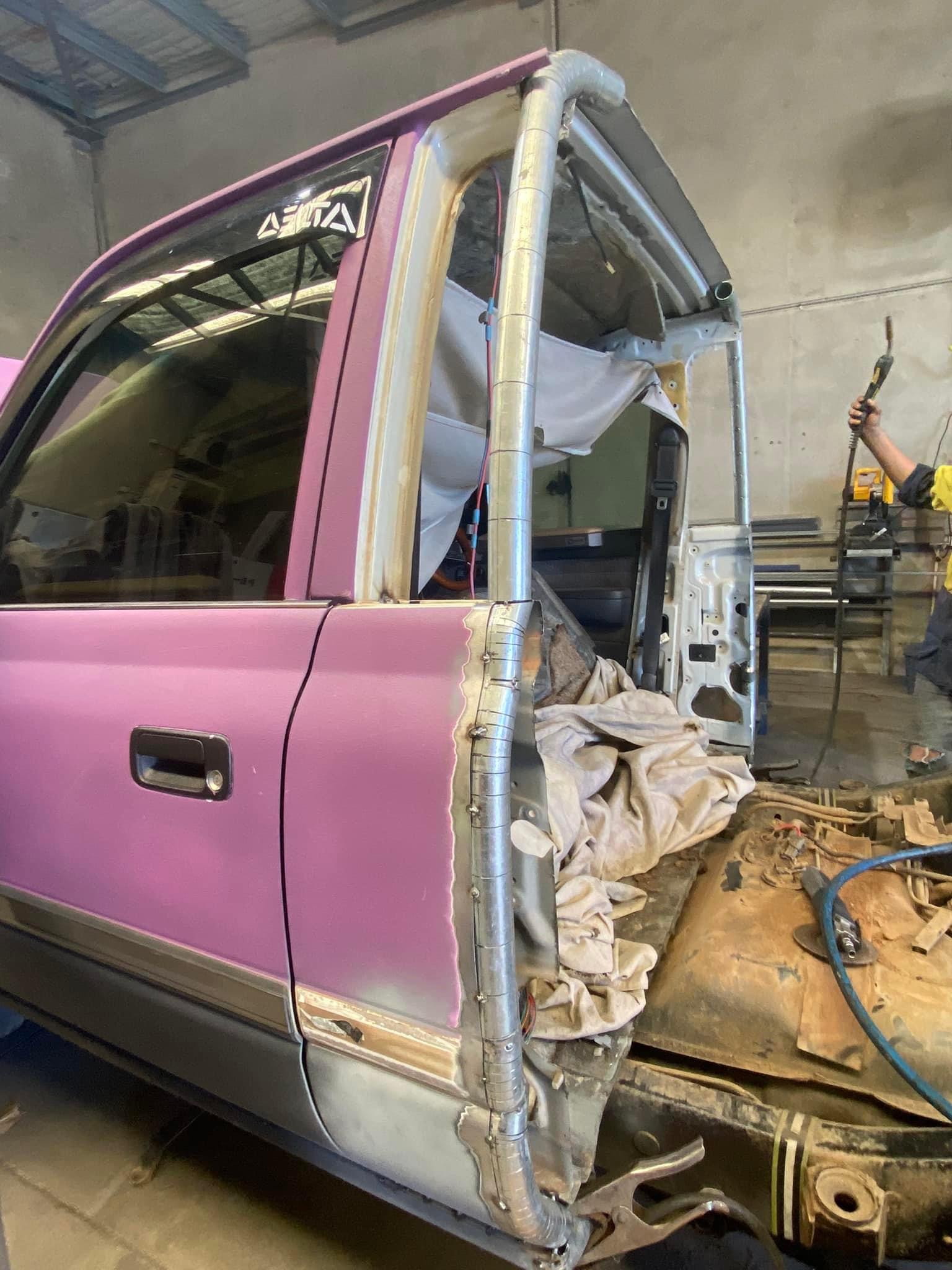

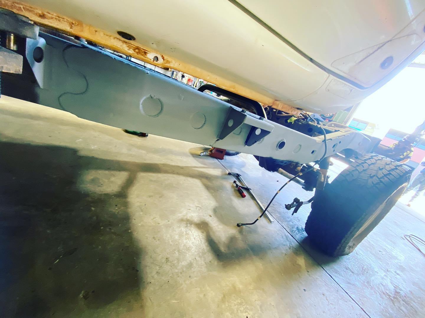

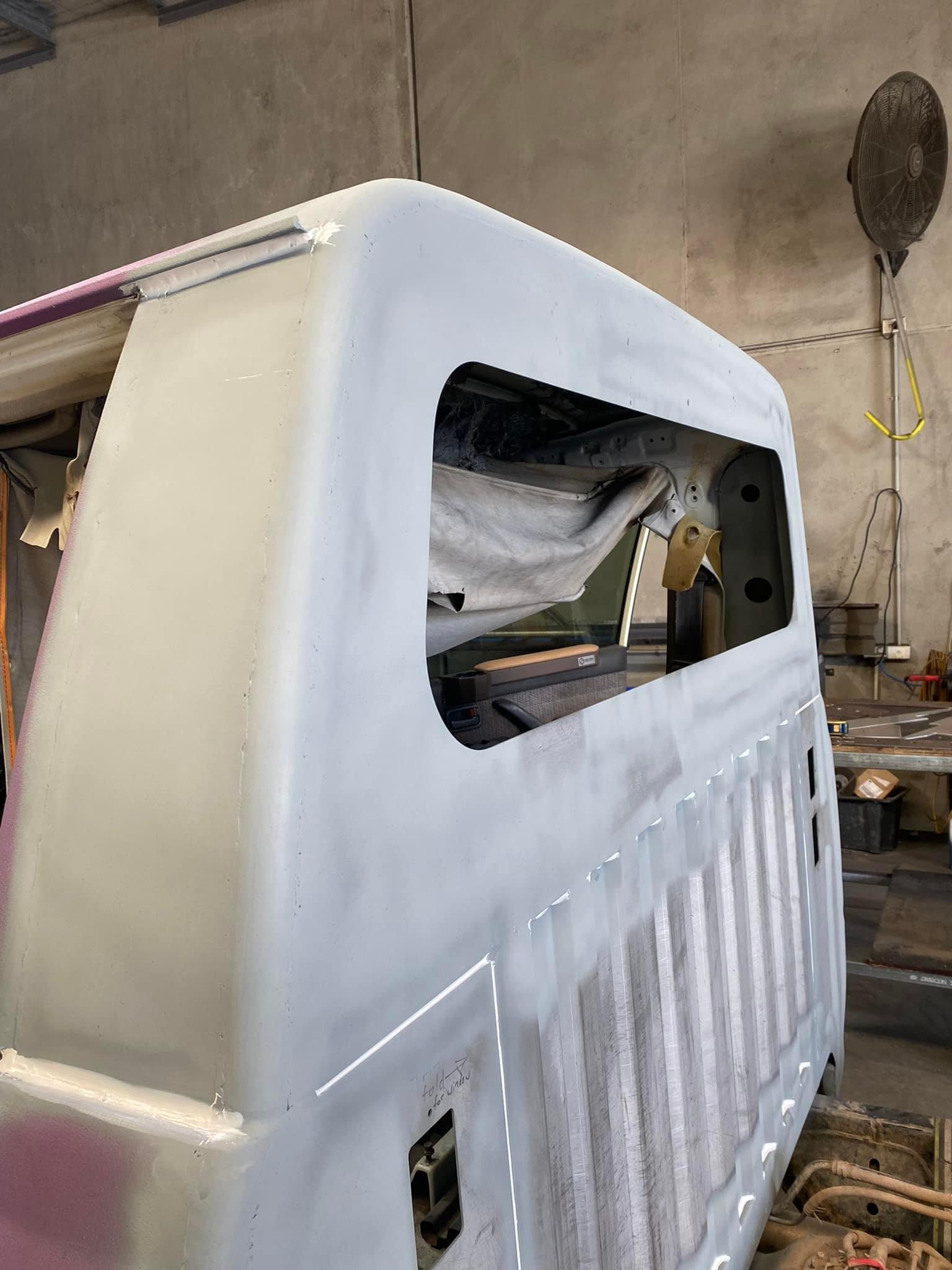

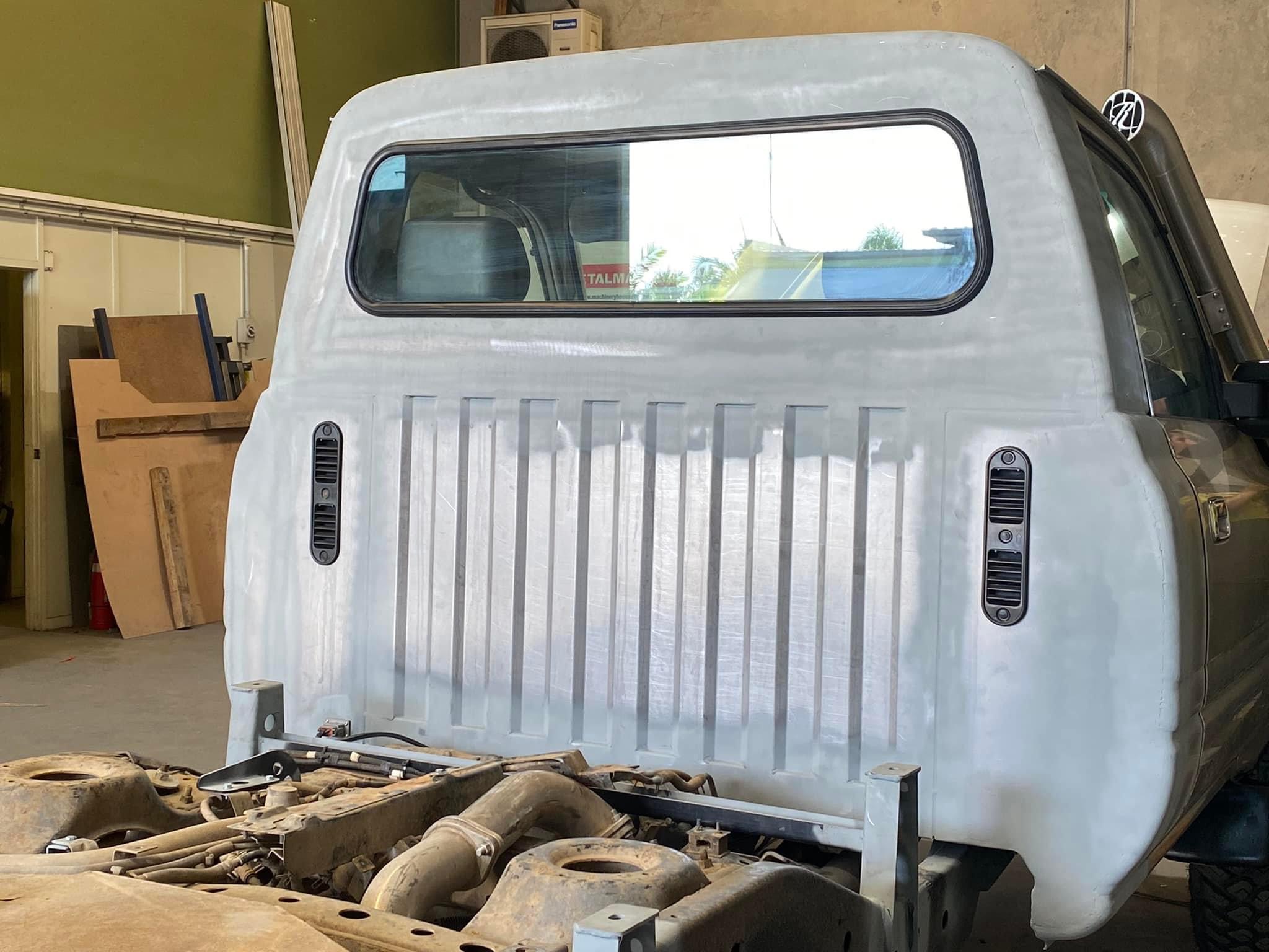

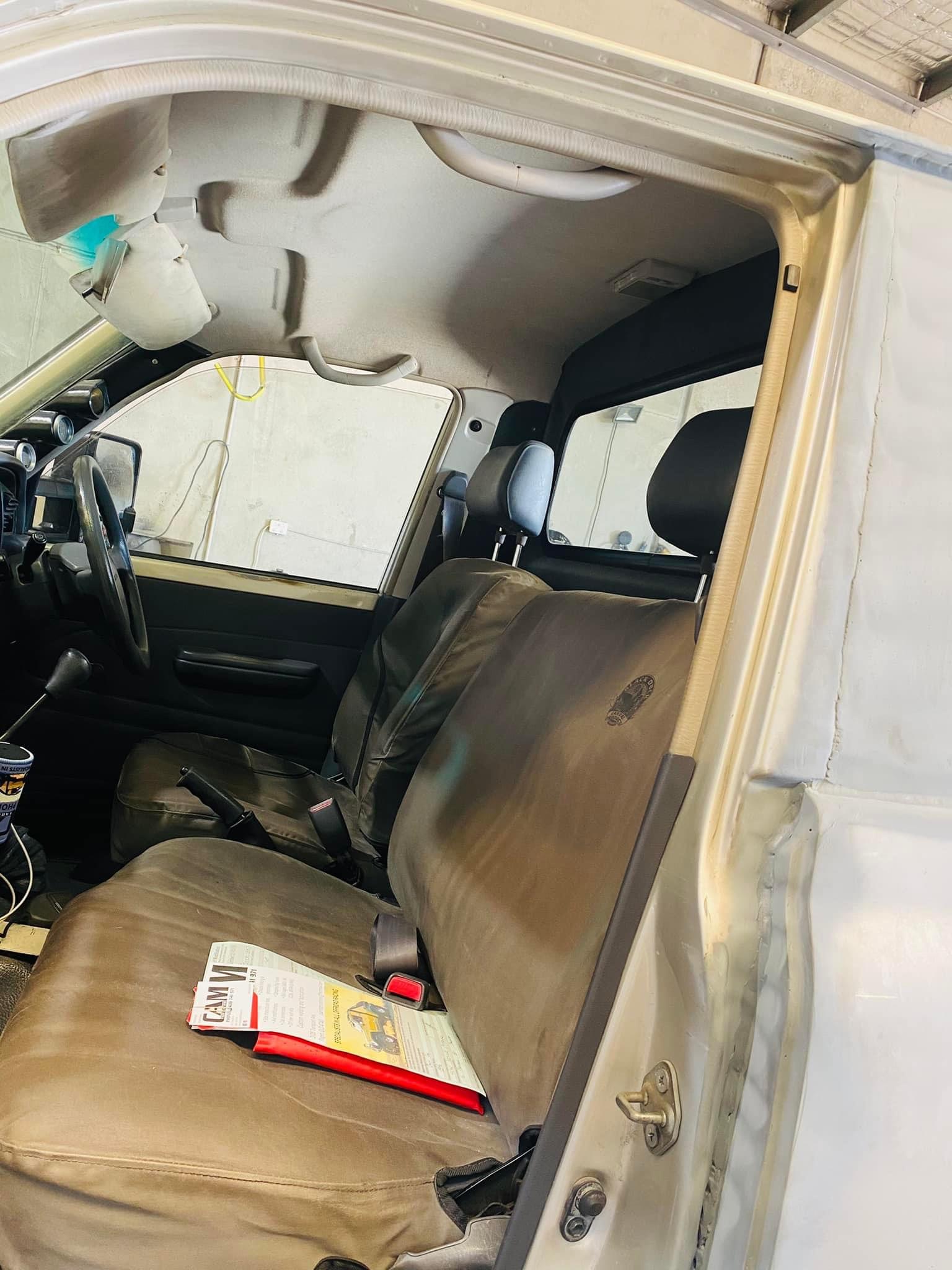

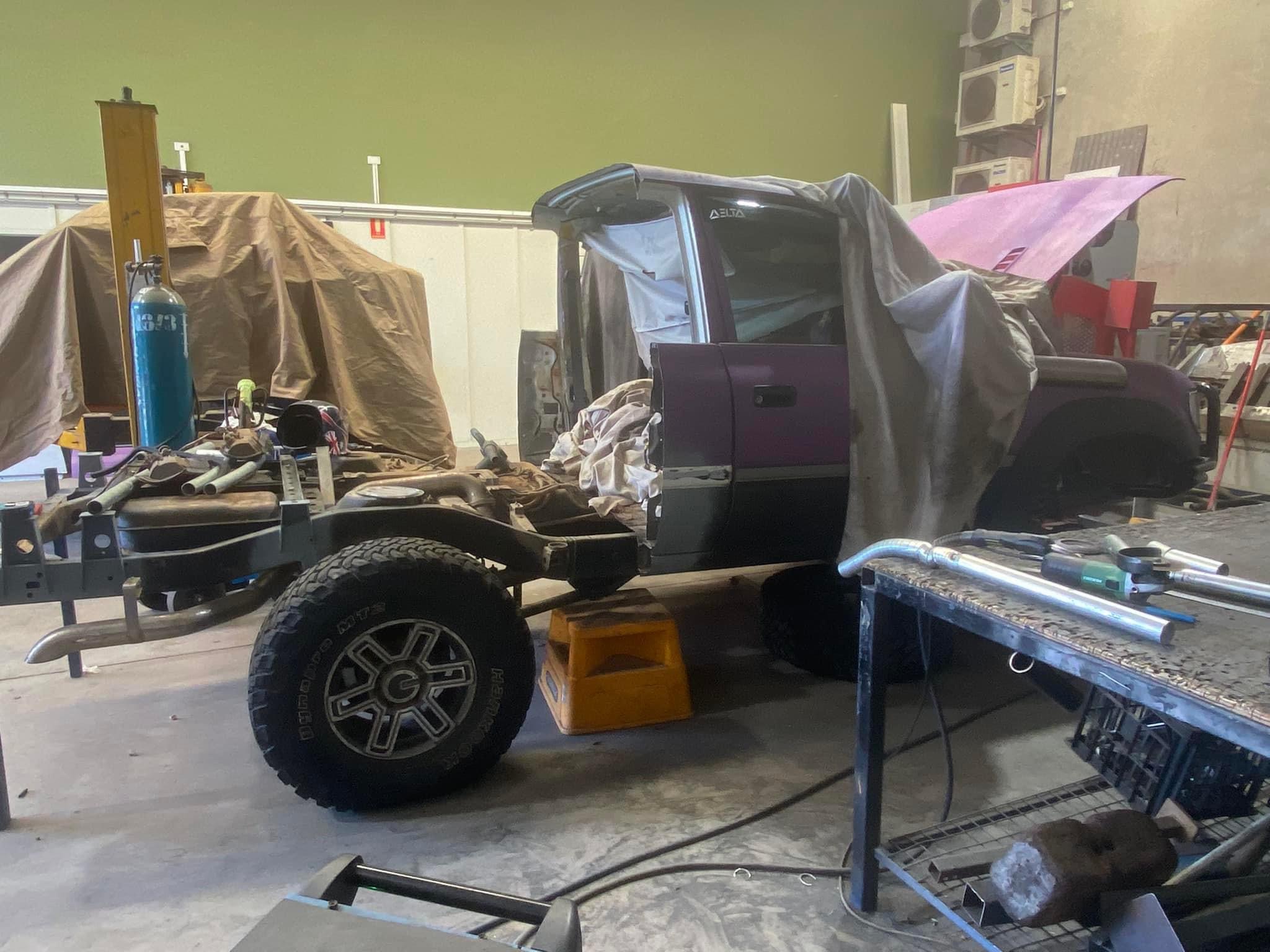

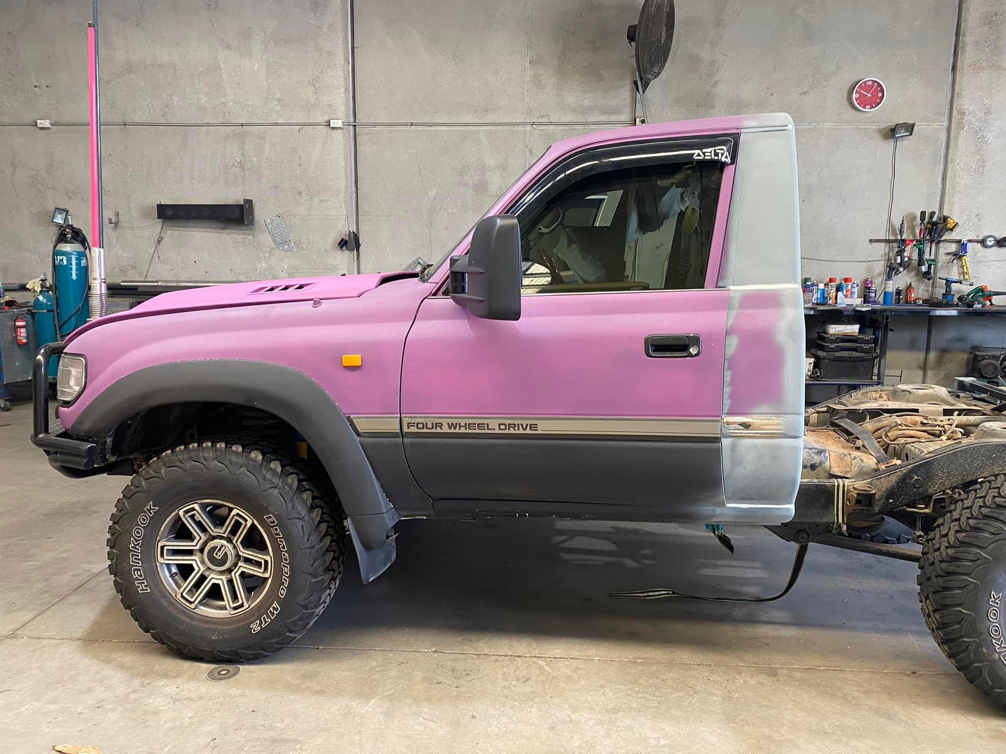

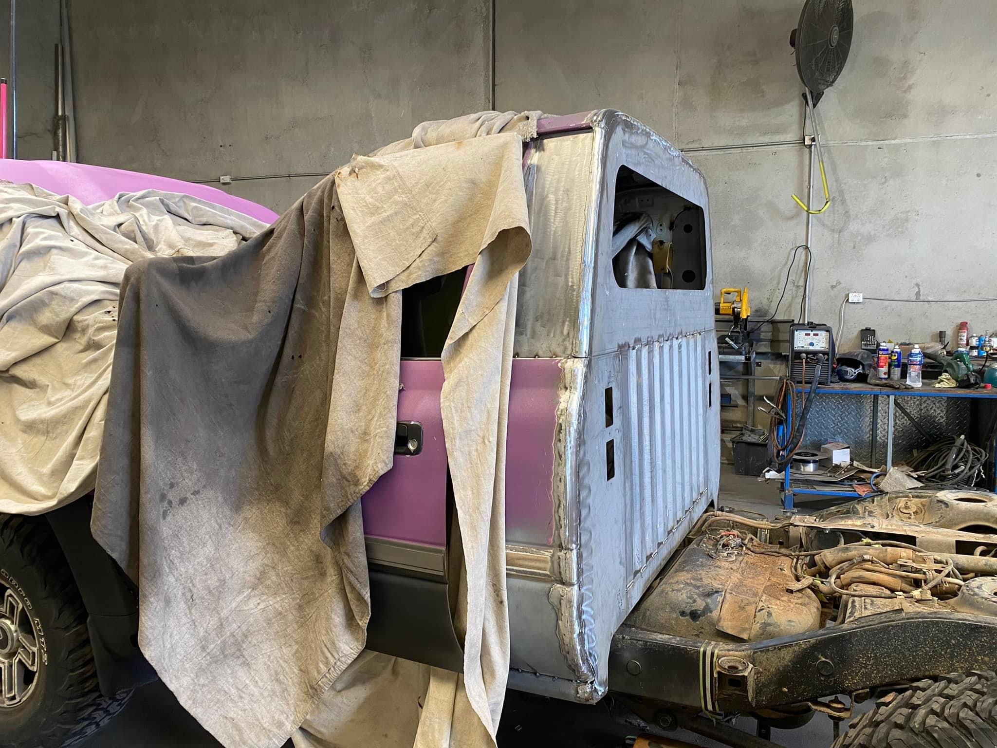

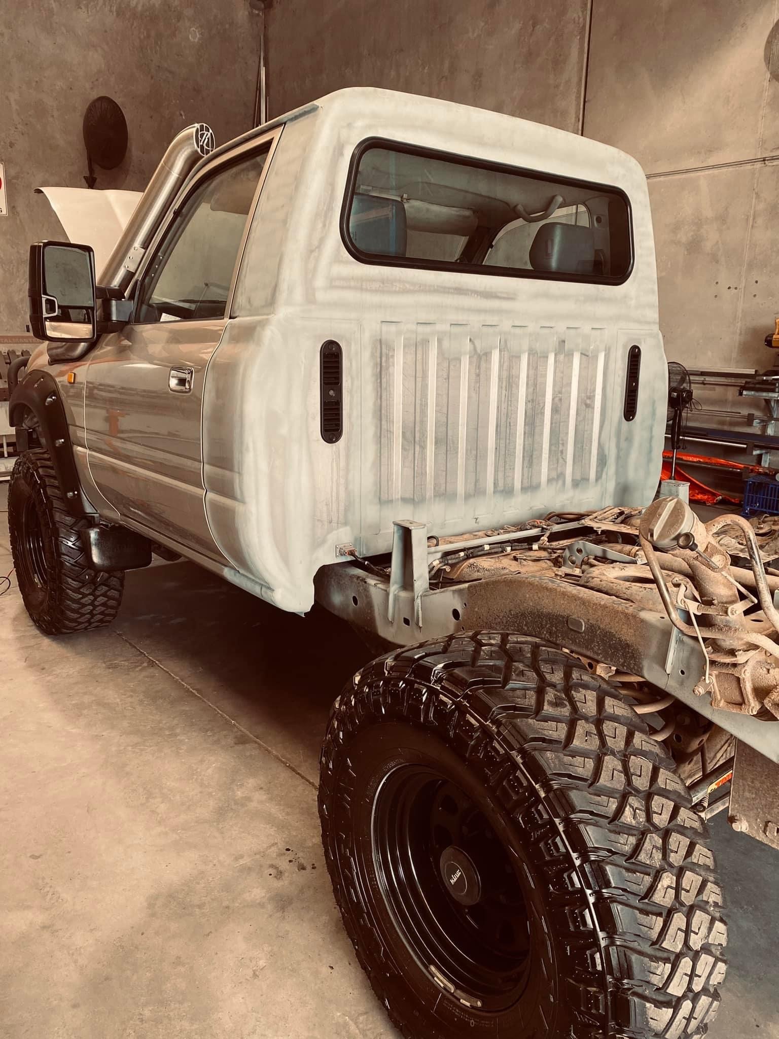

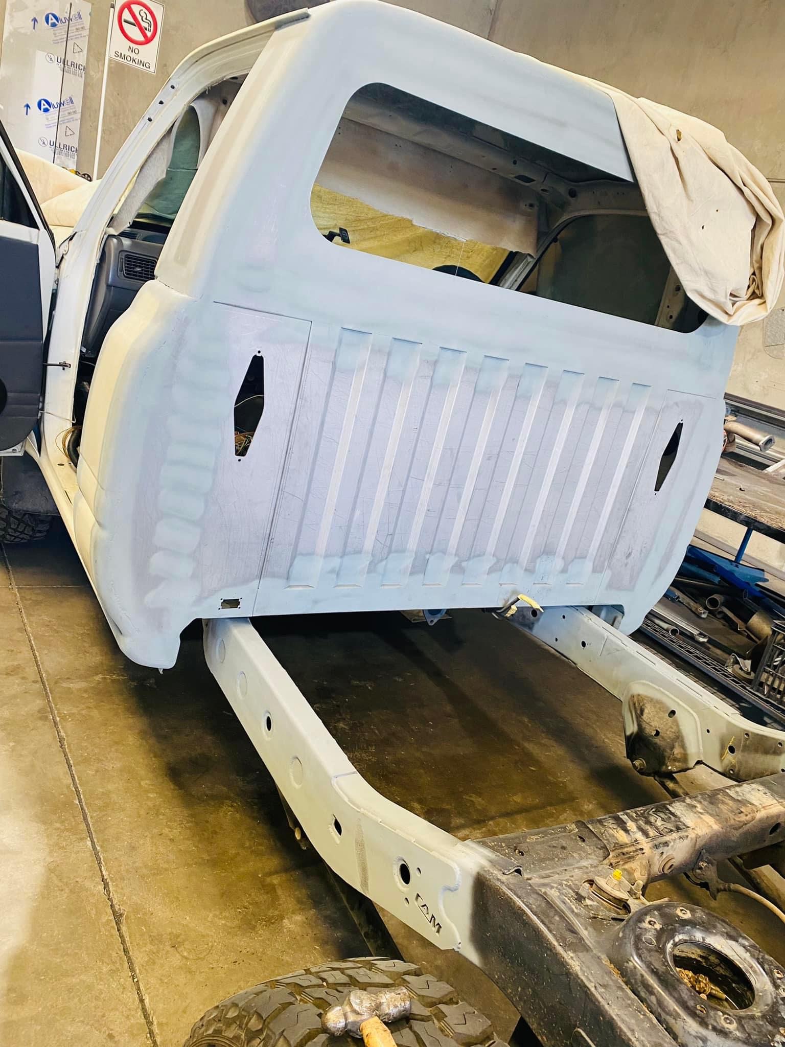

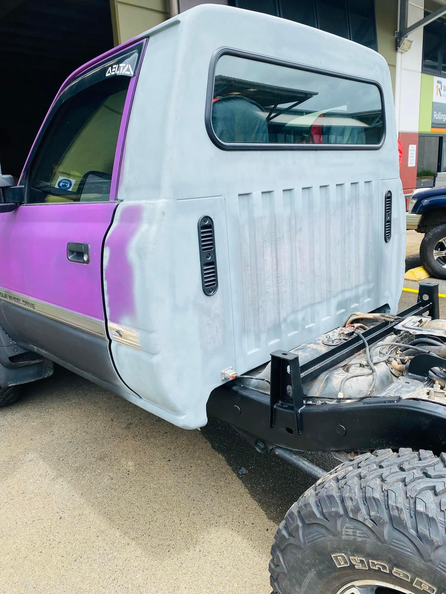

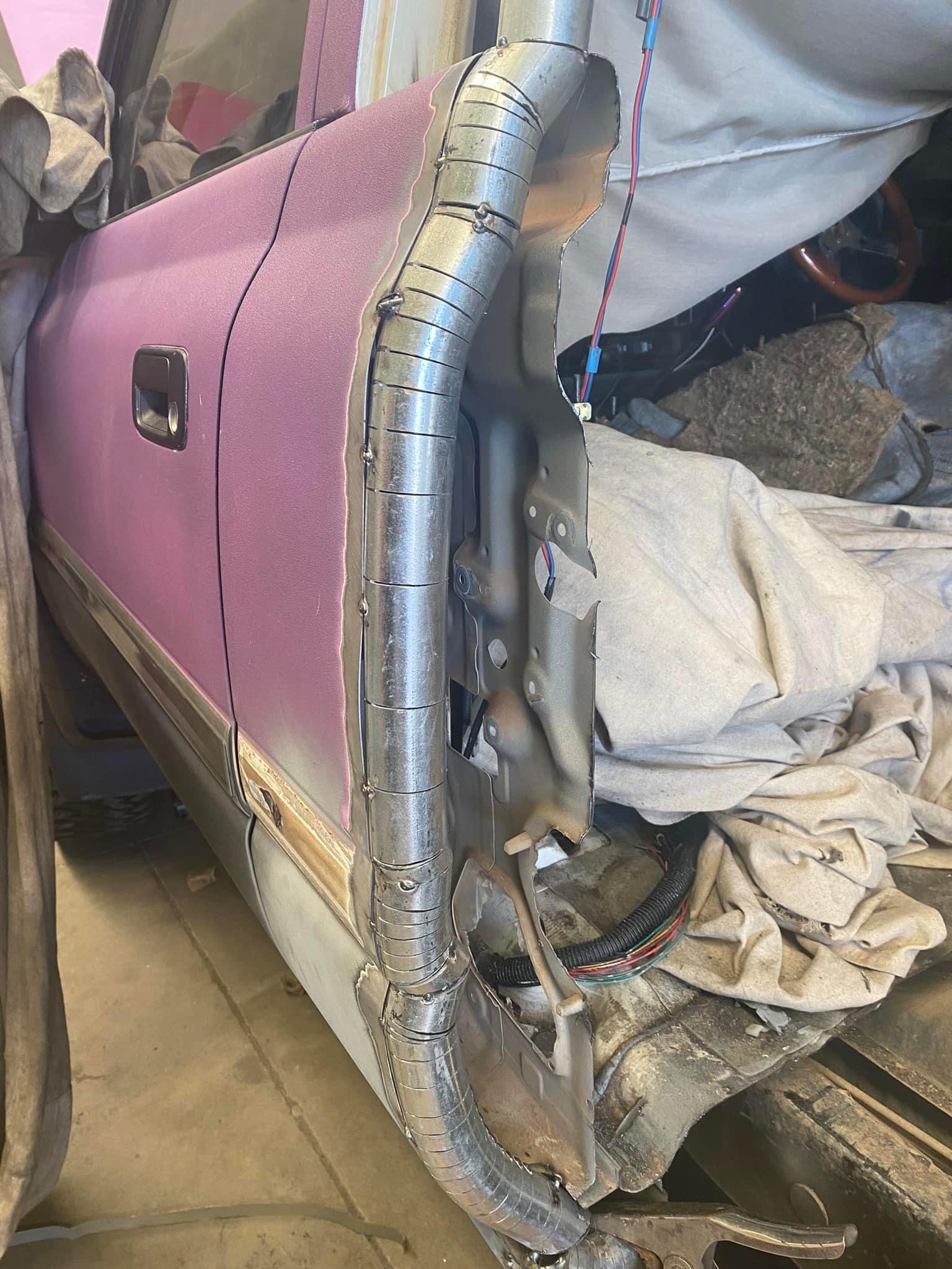

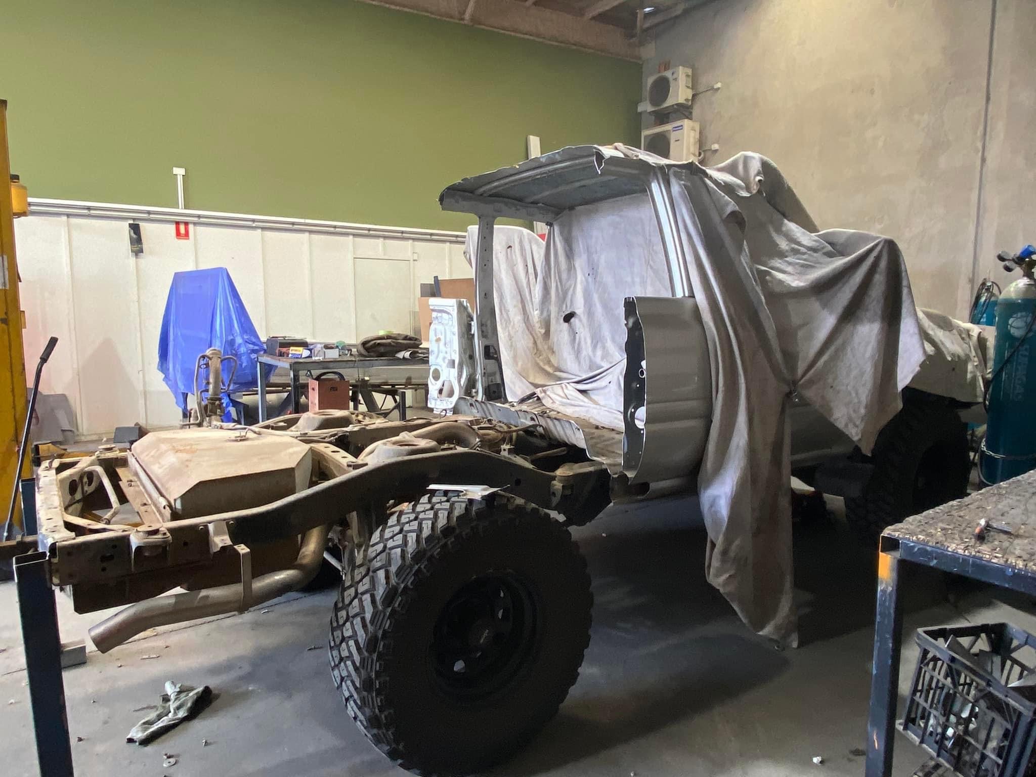

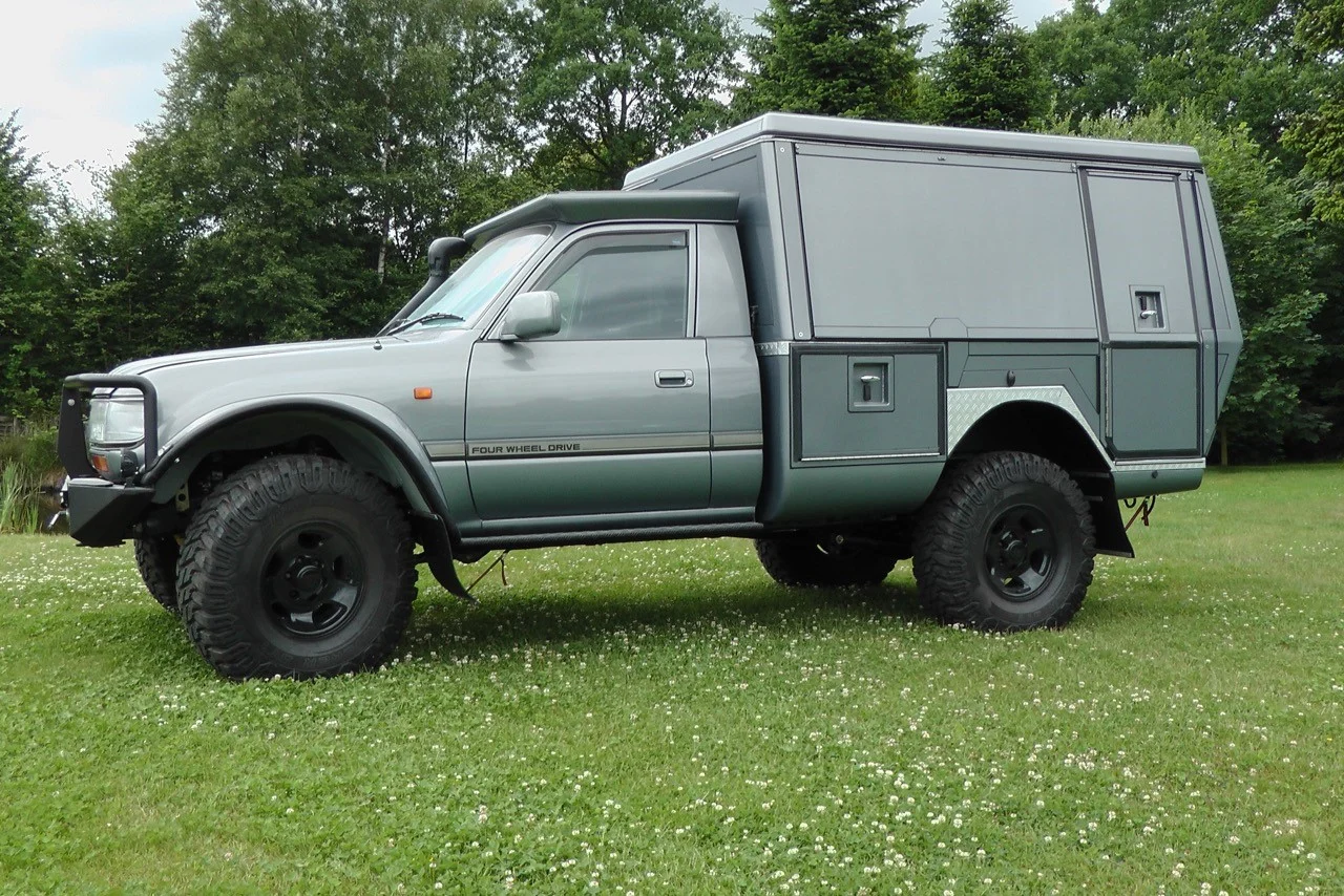

Opening the old thread as I decided to go on with the conversion. The plan is following:

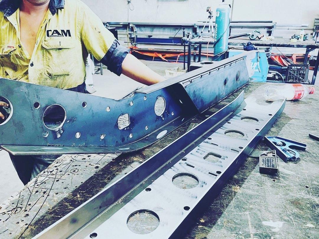

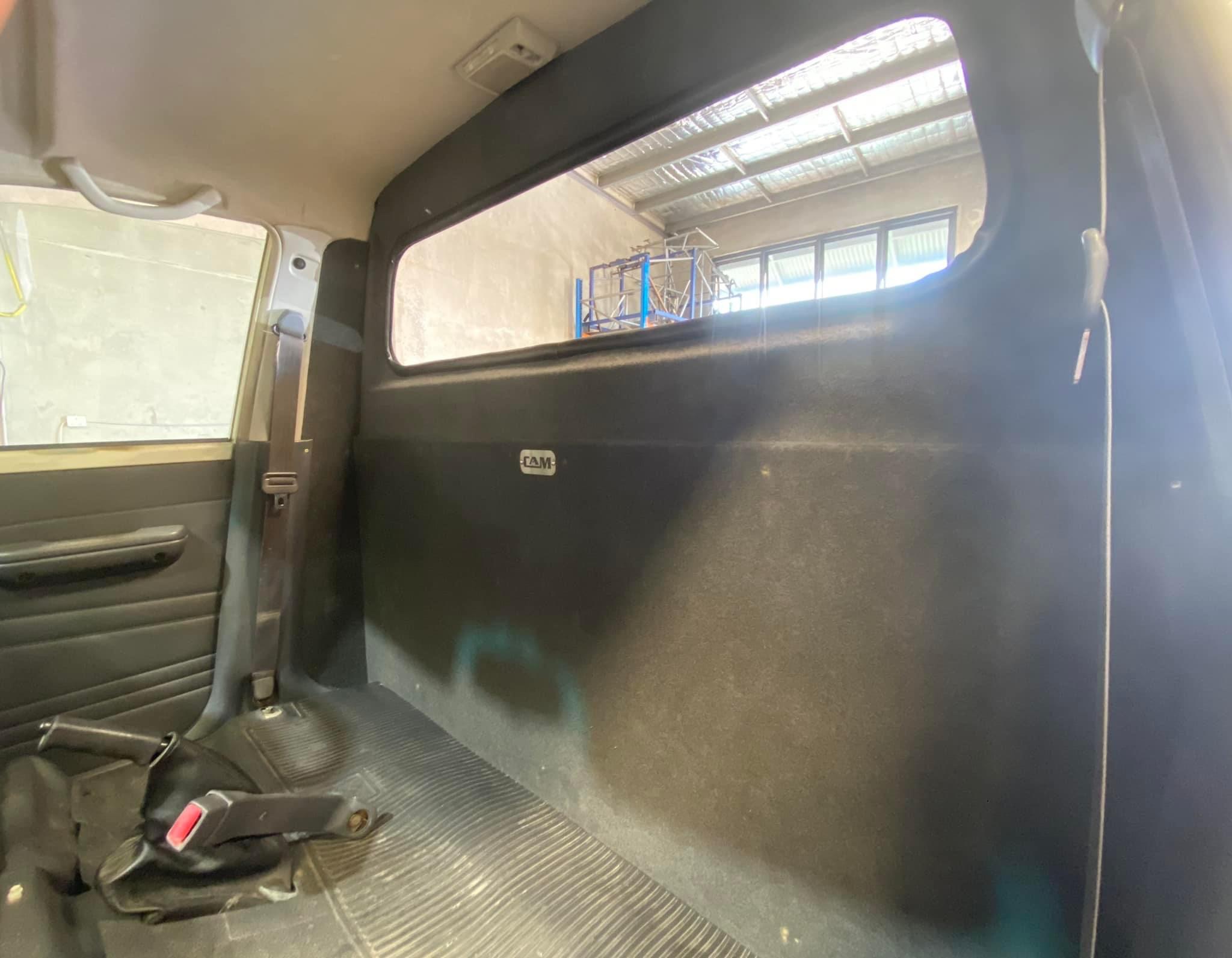

* chop the vehicle to extra cab using the CAM fabrication kit from Australia

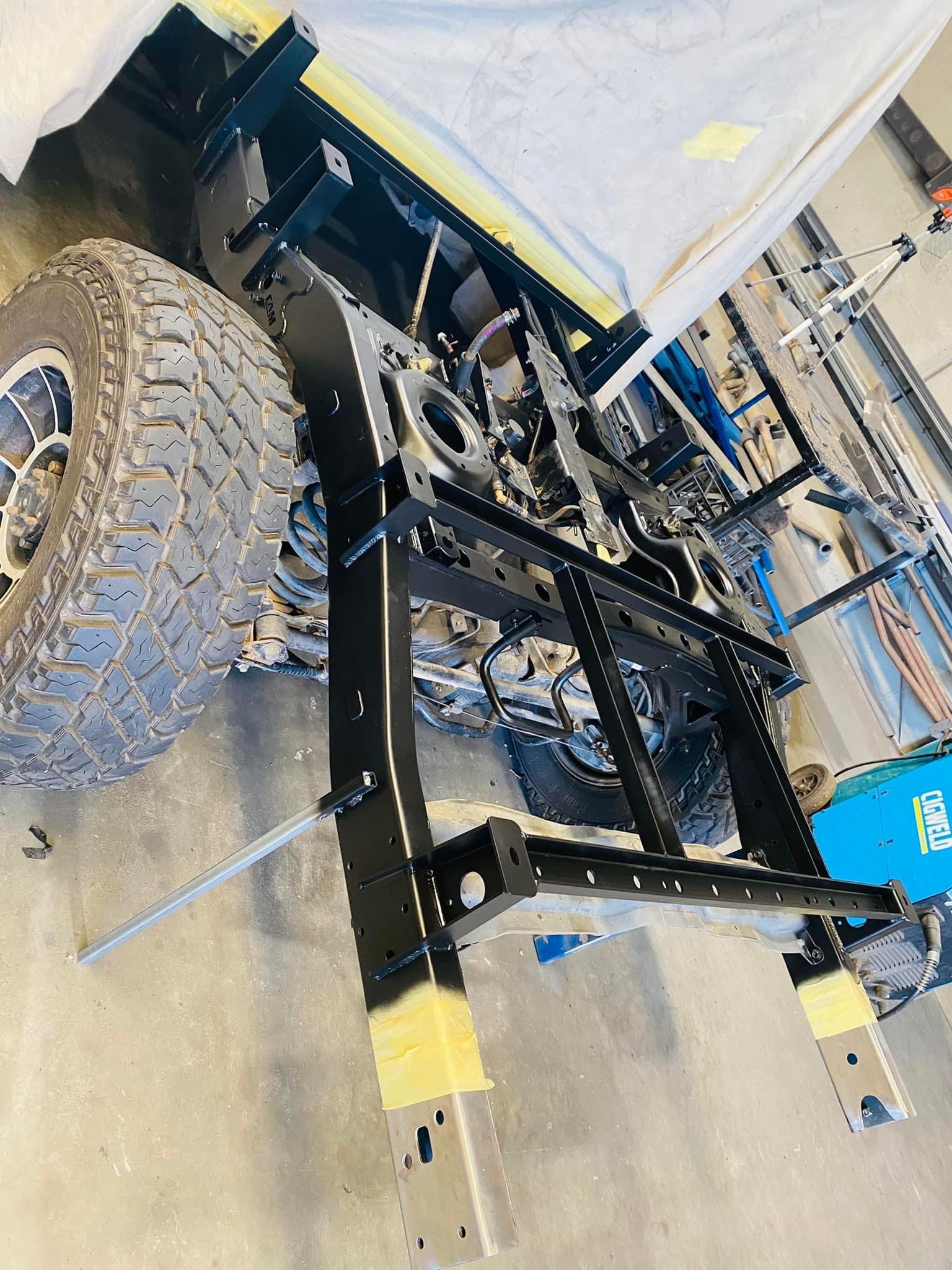

* extend the chassis 450 mm
* build the box with dimension 3000x185x145

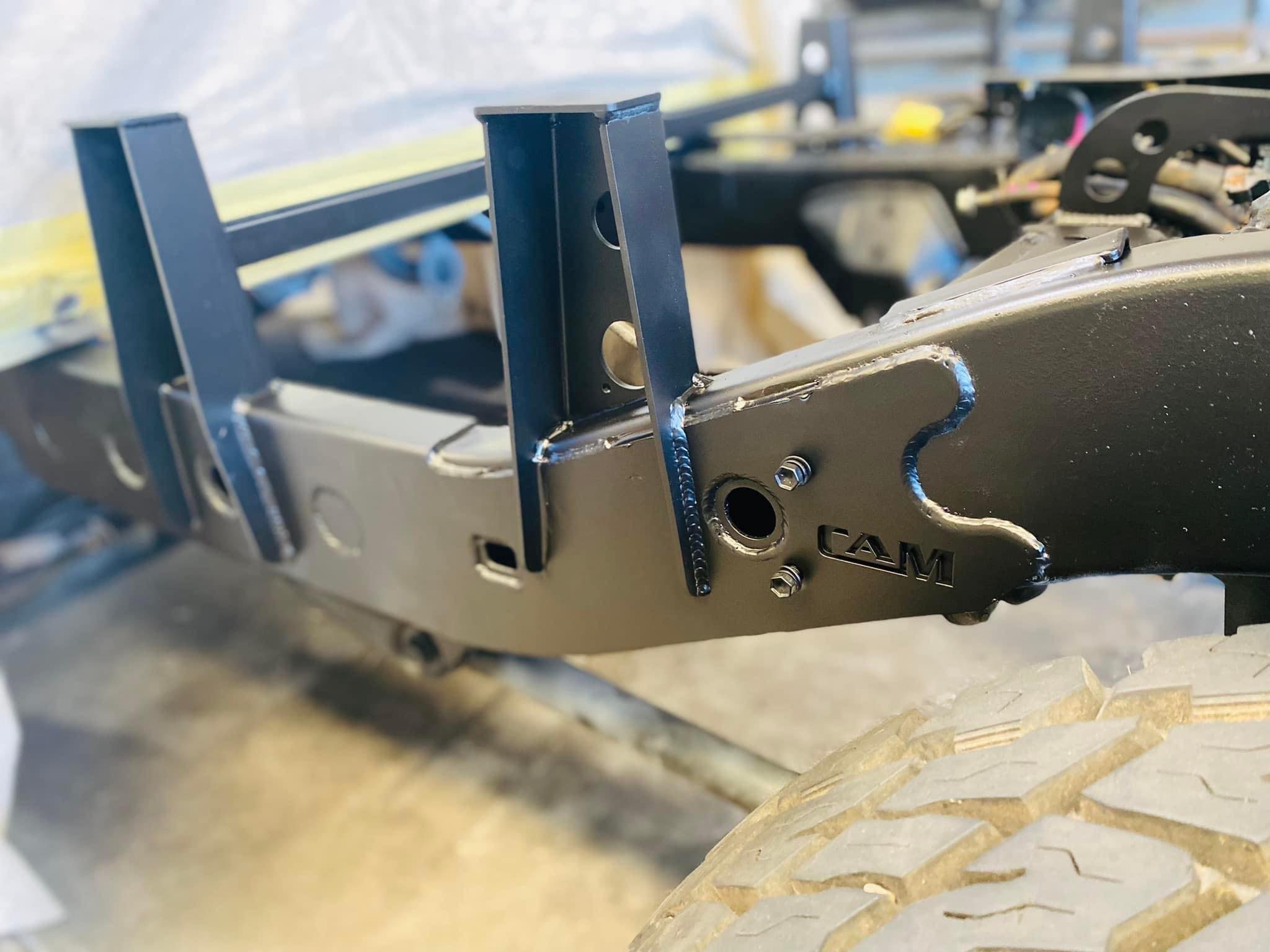

The land cruiser 80 chop is pretty common in the Australia, there is a very good facebook page where all the info is shared run by the Sam Young. The kit for chopping is developed by CAM fabrications and comes with all needed ( even window and rubber gasket ). For the chassis extension I think that wheelbase of around 3300 should be a very good for camper. There are 300, 450, 600, 900 mm extensions for the 80 being again developed by CAM fabrications.
As the camper, I was recently in Germany in BushTaxi treffen ( big Land Cruiser meeting ) and a lot of people are doing the conversion themself. Providing the exact dimensions the nomad campers would just cut the panels, provide the adhesives , even doors can be bought from them.

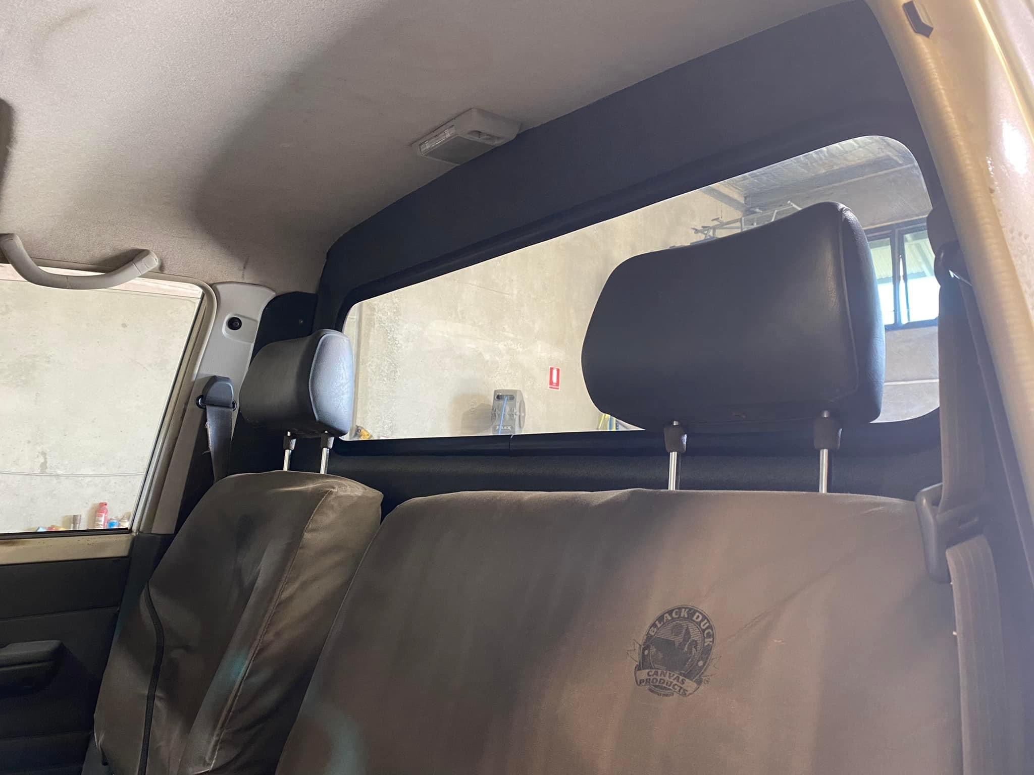

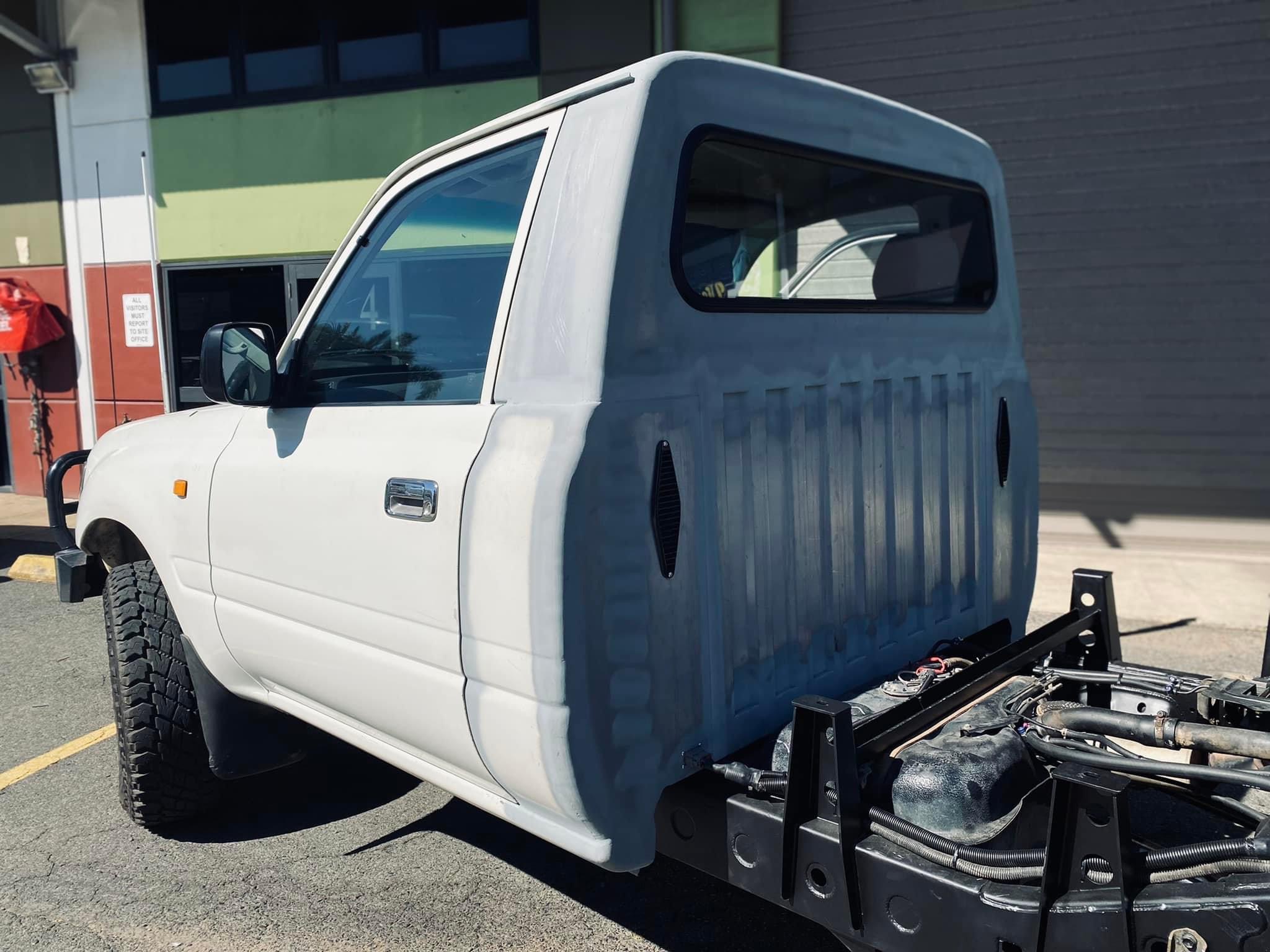

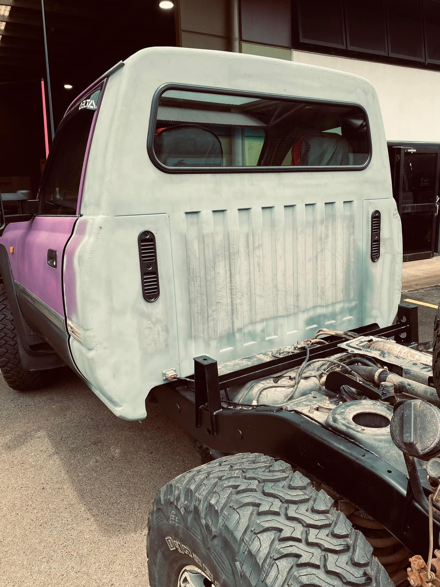

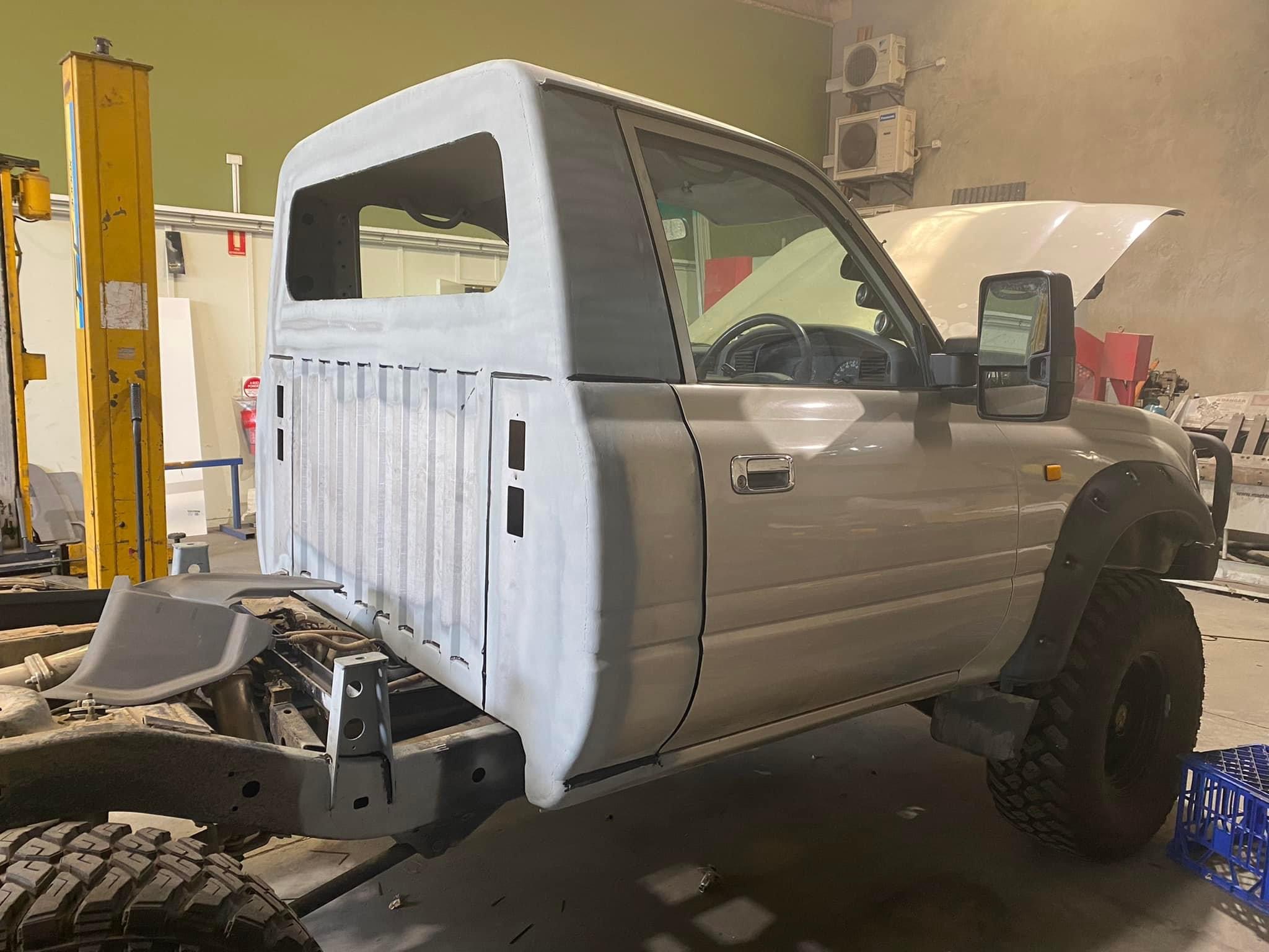

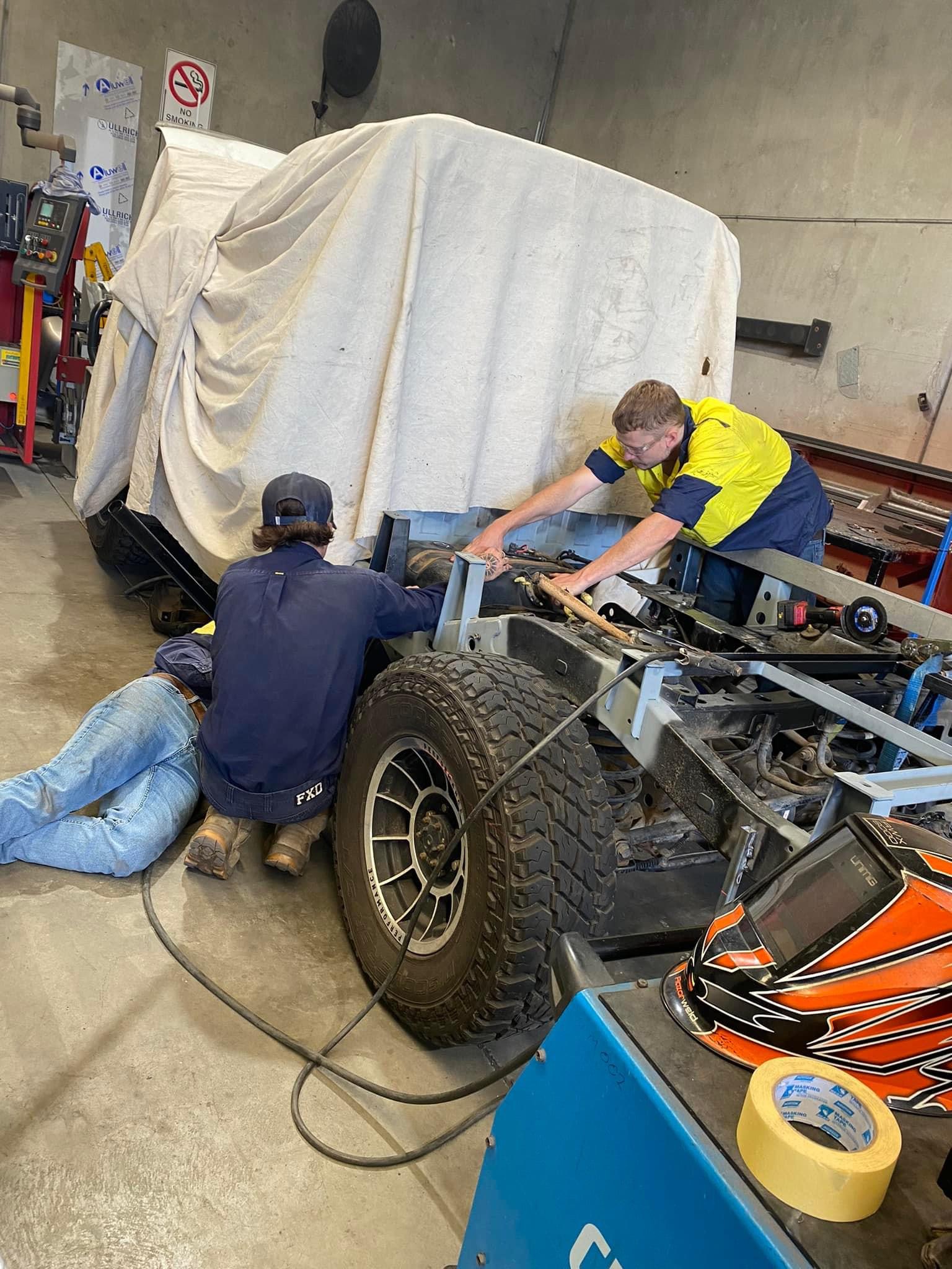

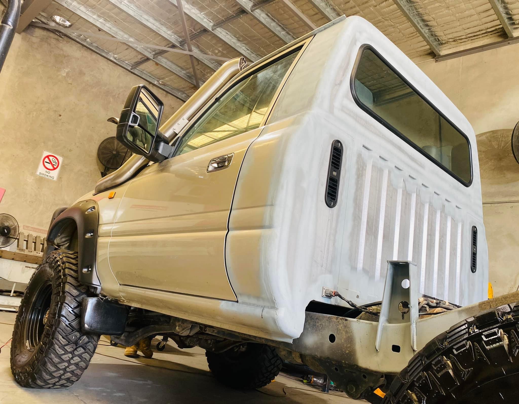

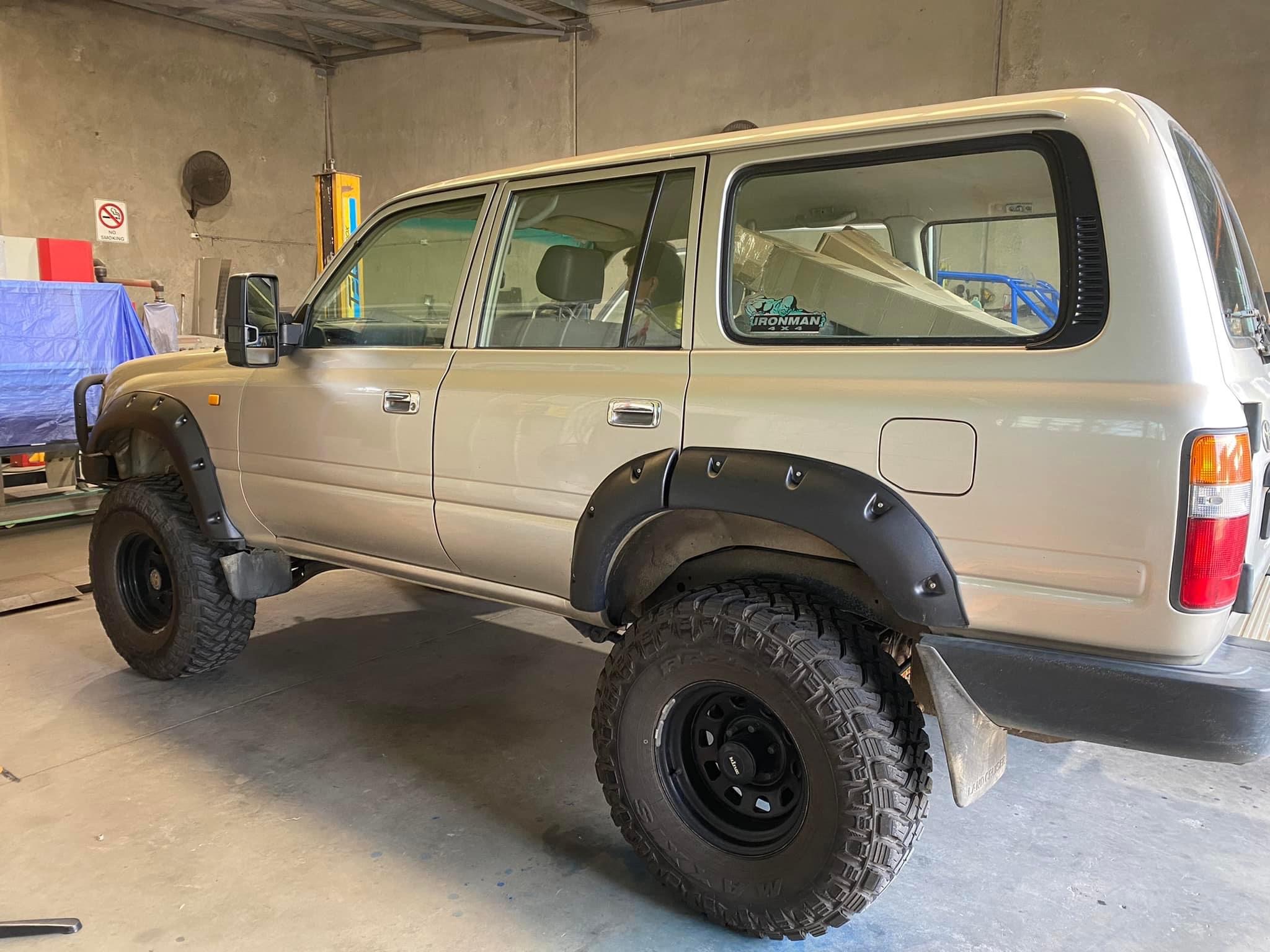

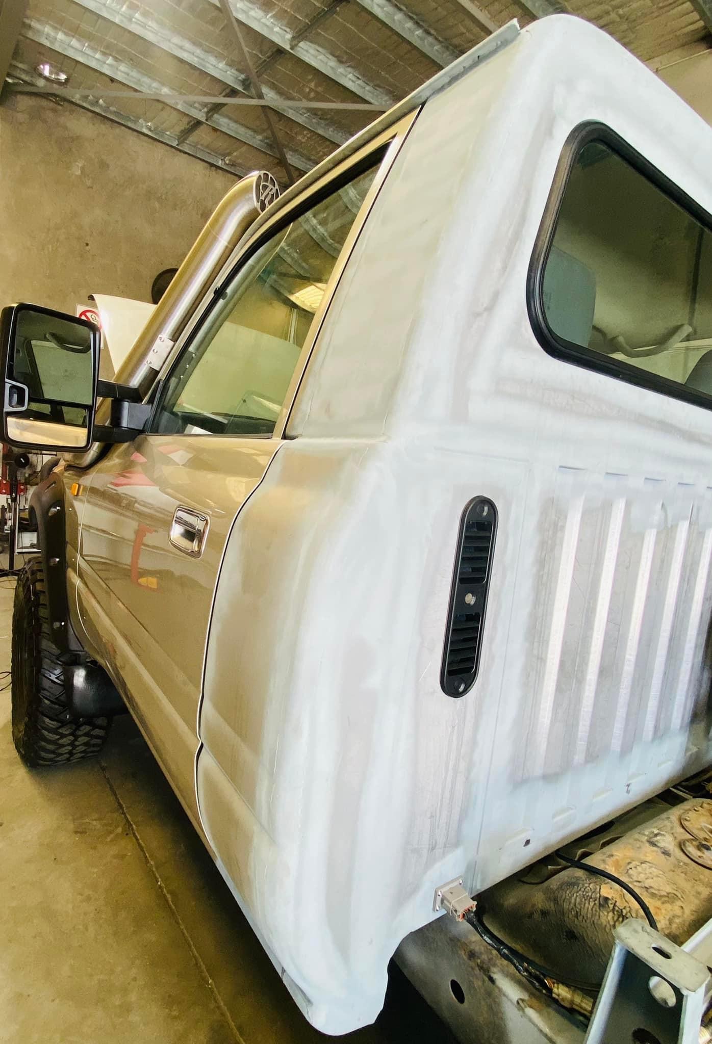

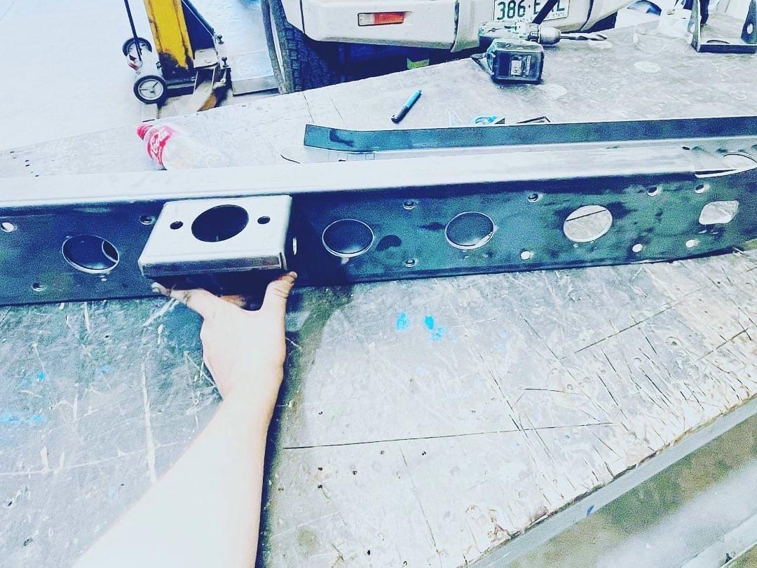

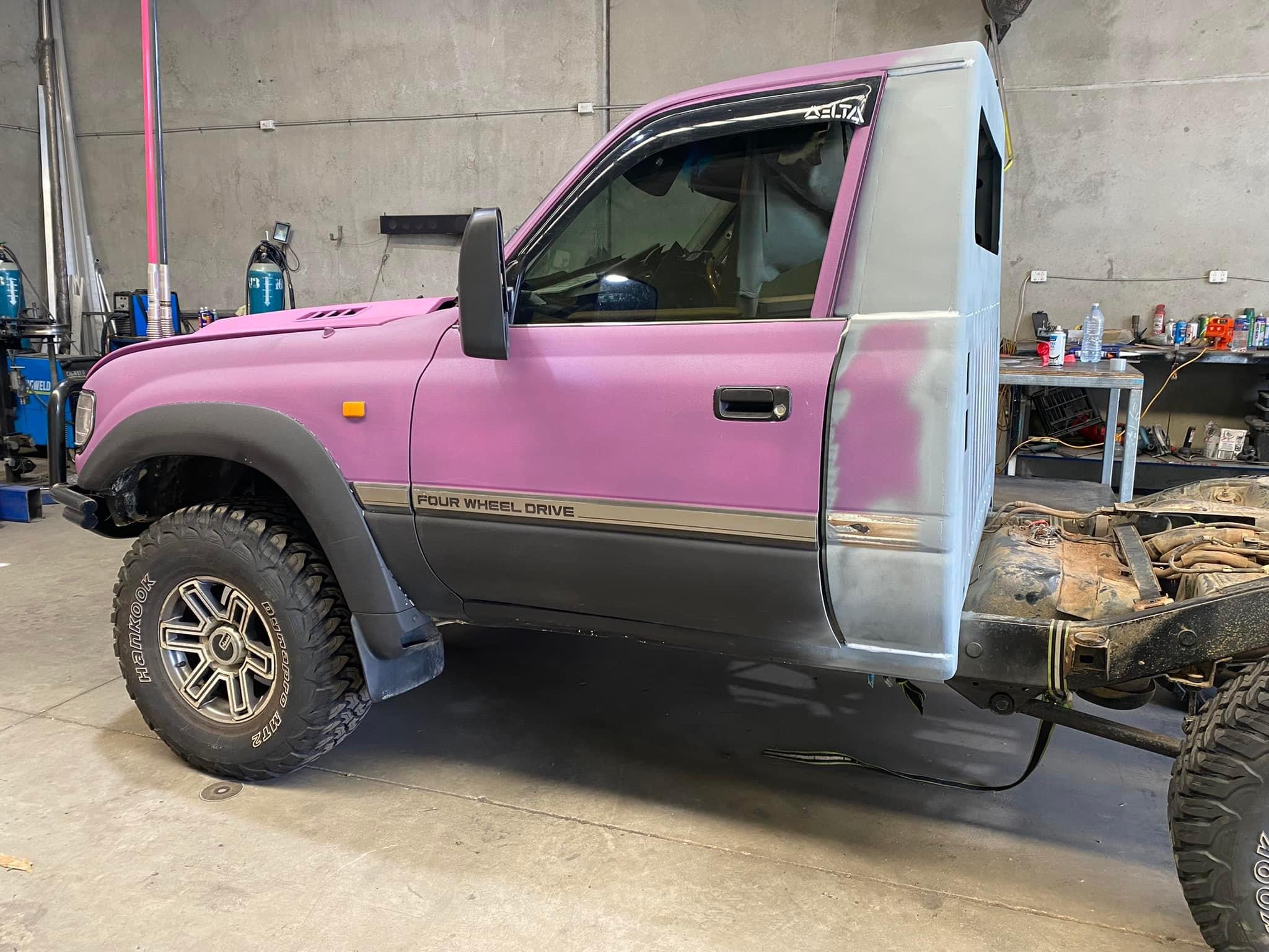

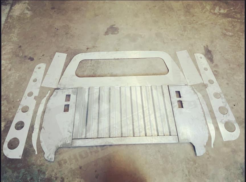

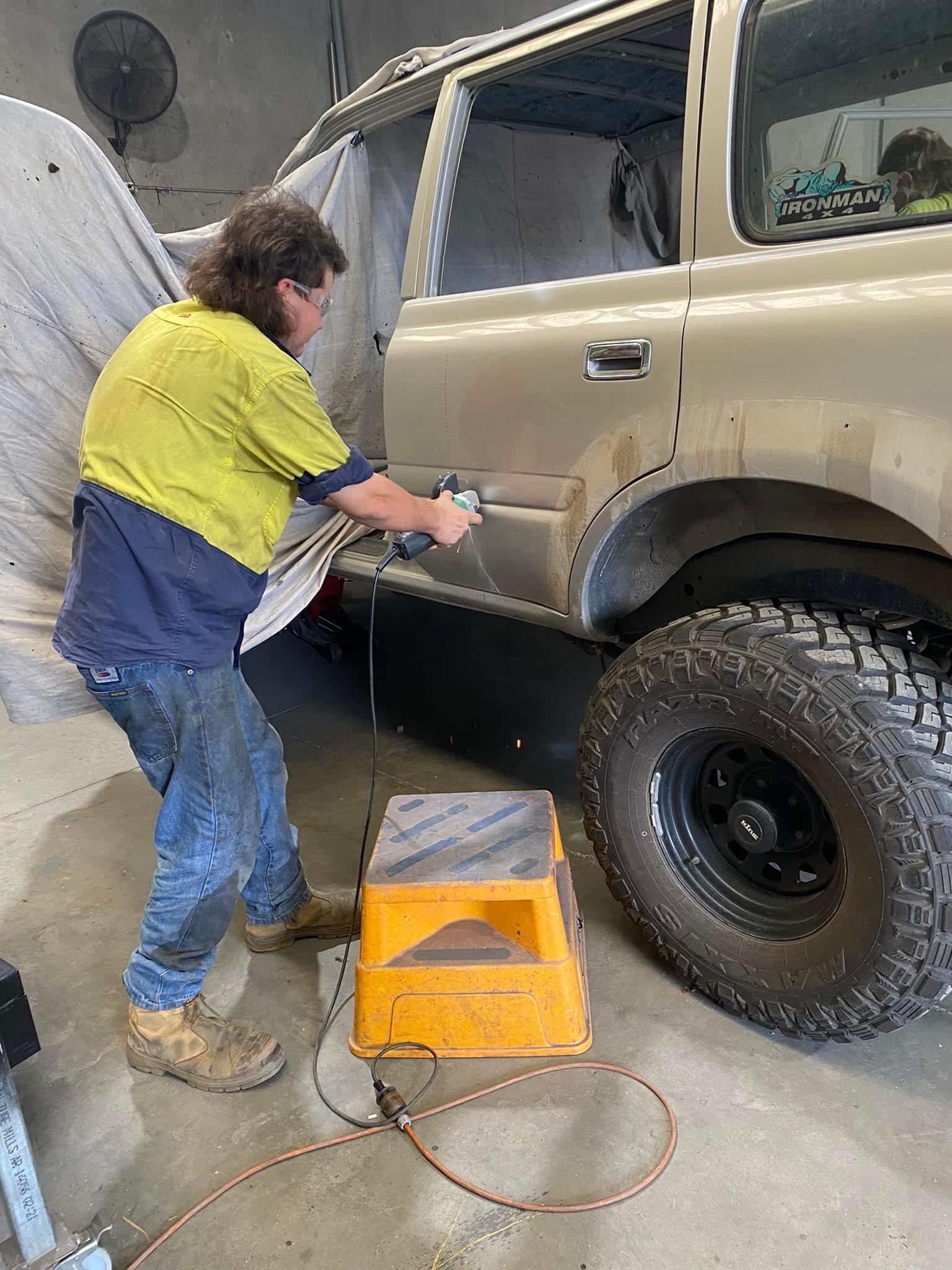

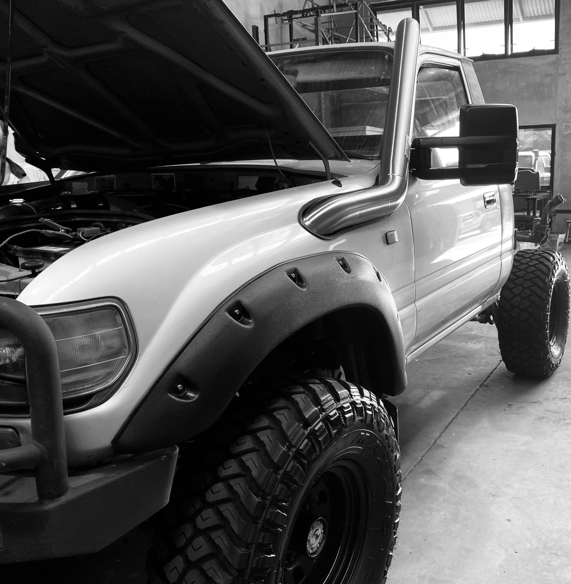

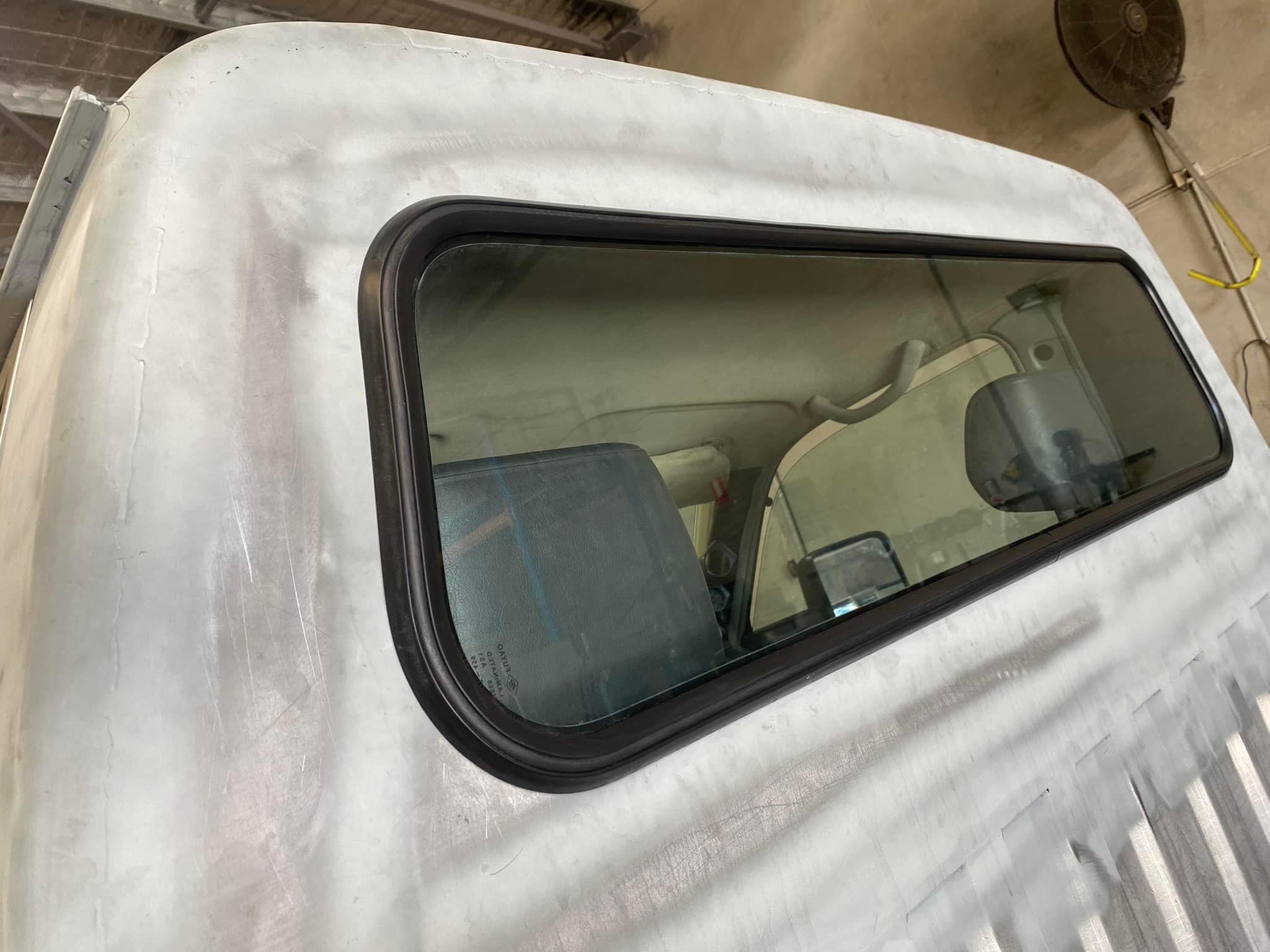

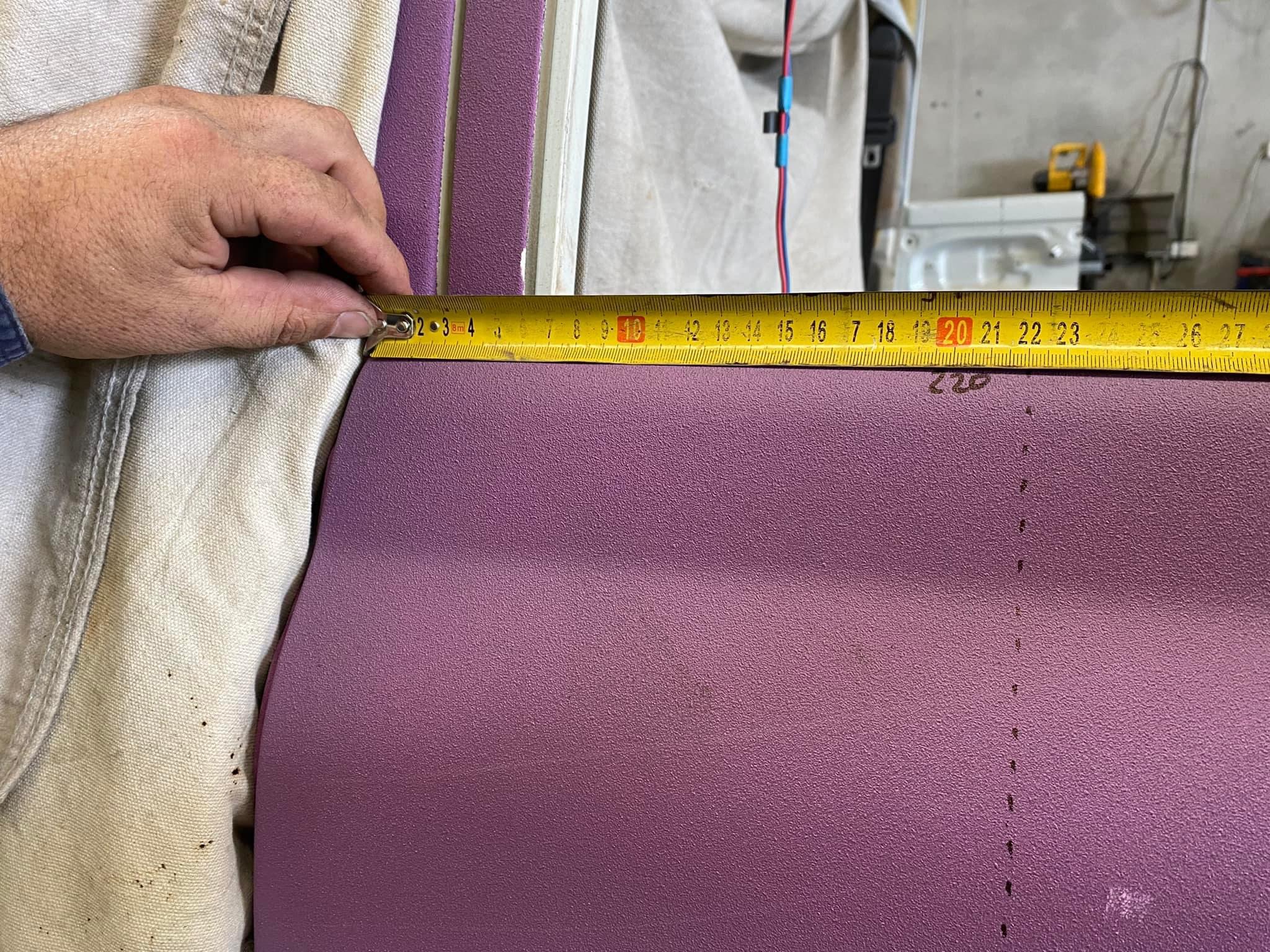

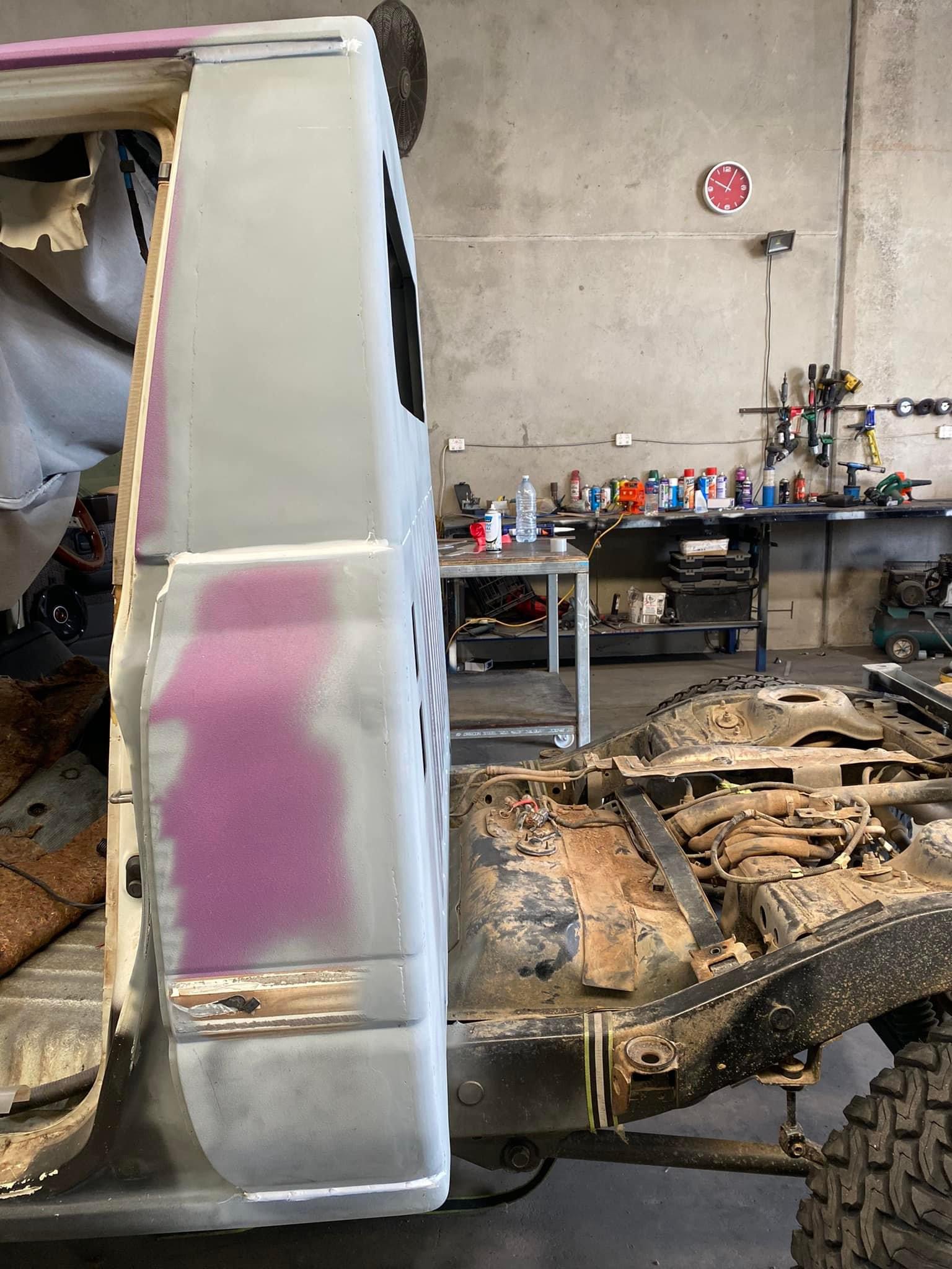

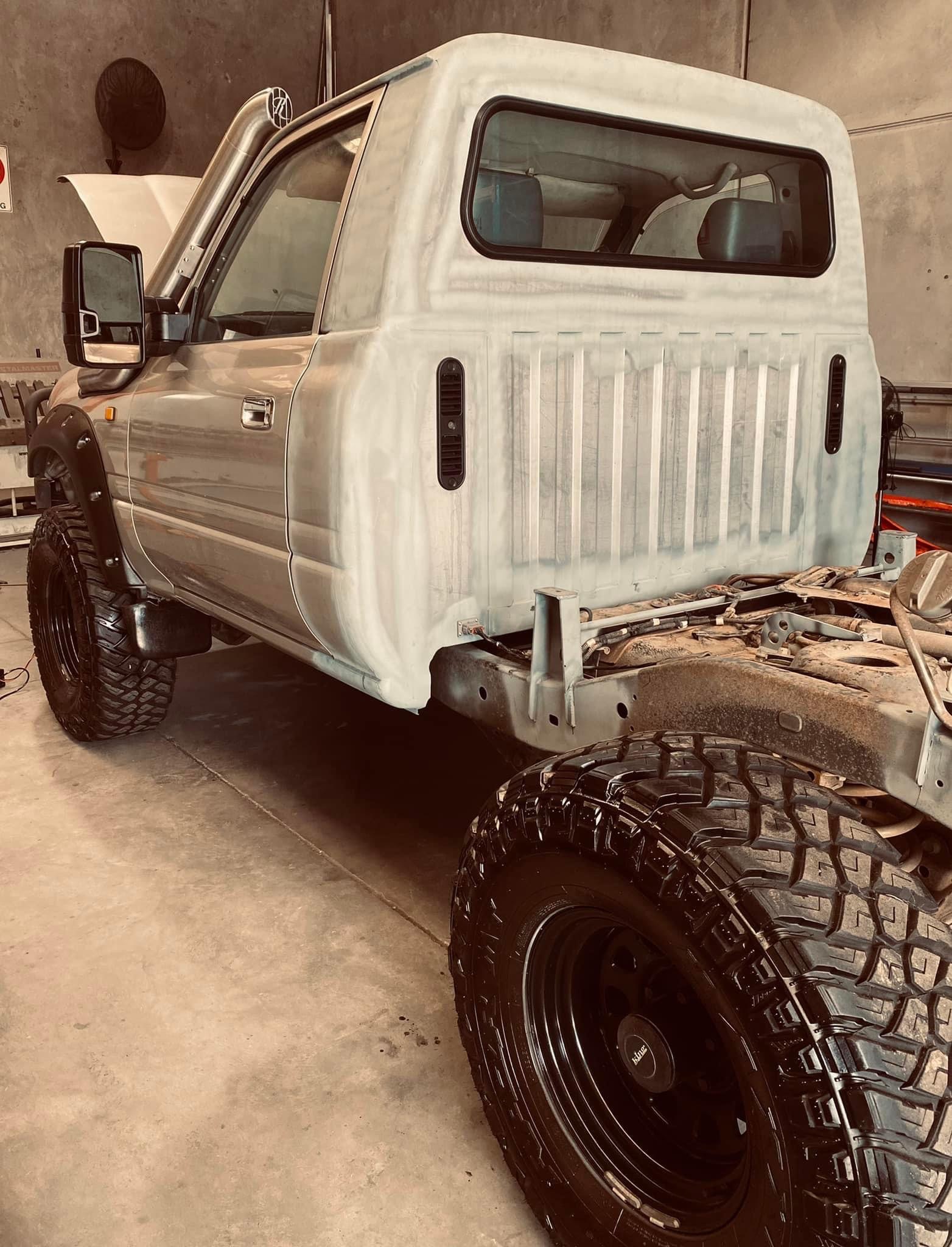

Attached are the pictures from CAM fabrications.

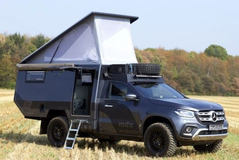

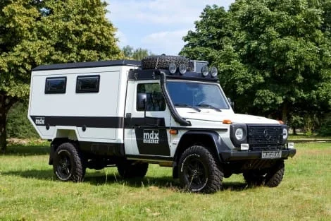

The wheel base of these are
Mercedes X :3150 mm
Defender: 3226 mm
Mercedes G: 3428 mm
The 80 has wheel base of 2850 + 450 mm extension = 3300 mm
All camper boxes in below pictures are 3000 mm long and around 1900 - 2000 mm wide

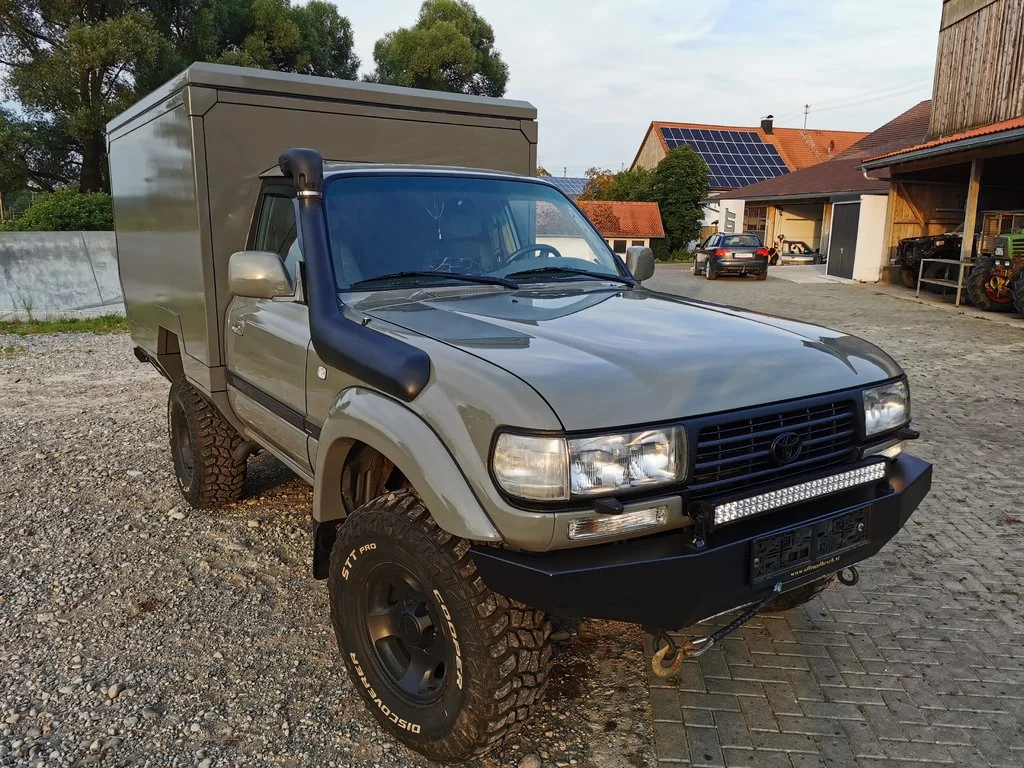

I will have the camper box with straight walls , the same way as here, bellow pictures are from the bush taxi forum:
( pretty recent build ), the box dimensions are 261x193x140cm.
Having the CAM Fabrications ute tray mounts a little bit higher then the mounts of Uwe I think that 140 cm box height will be too much:
