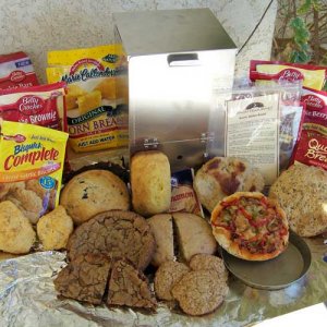

the basic design is out of gil gilpatrick's book, BUILDING OUTDOOR GEAR. it's the large one. he has dimensions for 3 sizes in the write up. i used aluminum door kick plate as it was free.95. the shelf is perforated 16ga. stainless. it was also free.95. yup, just hoarded material from various demolitions at work. it took me about 2hrs to put it together
yes, i cheated with the cinnamon rolls, pilsbury prepped the rolls, i baked em. it took about an hour 15 minutes from striking match to slathering icing on.
the shelf pulls out so the kelly kettle fits in with the baking pan for transport. i'll probably fashion some sort of cover to turn it into a box and carry other cooking/baking utensils in it also
forgot to mention last night, the amount of fuel, a.k.a. fire wood, used was not what i would call a large amount. i'd say 3/4s of a milk crate full. it was an even mix of pine, maple n oak. about 11/2" x 16" in size.
