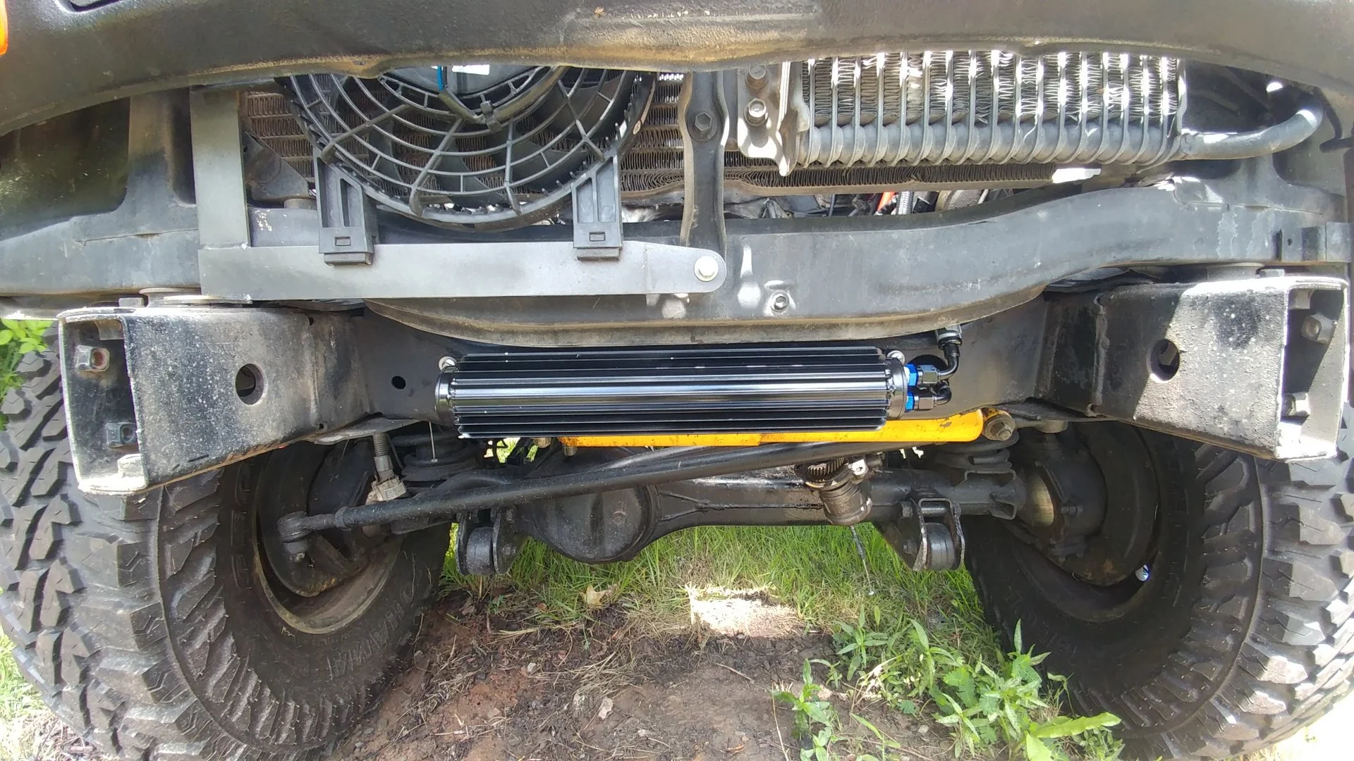

Continuing to chip away. Finished the EGR delete by taking out the half of the spaghetti and blocking the EGR with @NLXTACY's "key chain".
Then replacing the paperclip with Derale's power steering cooler. Have the thank @TYM4FUN and @cvenom96 for helping with the parts list.
Also got schooled by @fourtrax on looming the hoses.

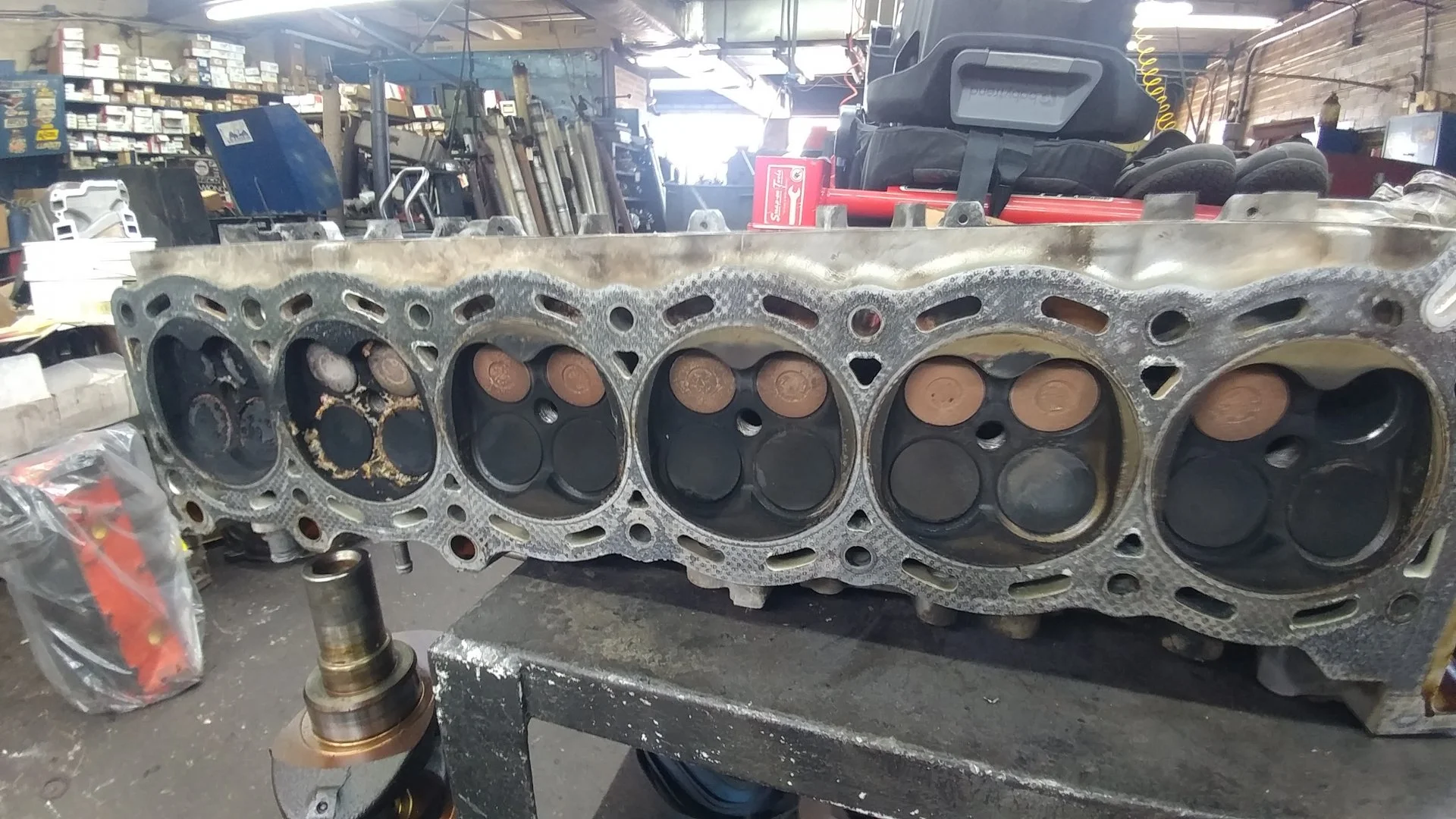

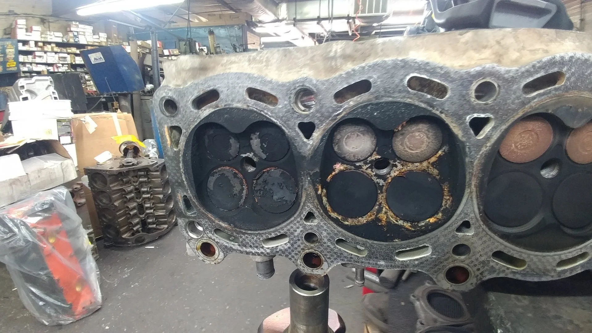

Stopped the the machine shop this morning for a progress report. Looks like I blew the head gasket between the 5th & 6th cylinders.
Said everything else looked good, but I'm going to have them rebuild everything.

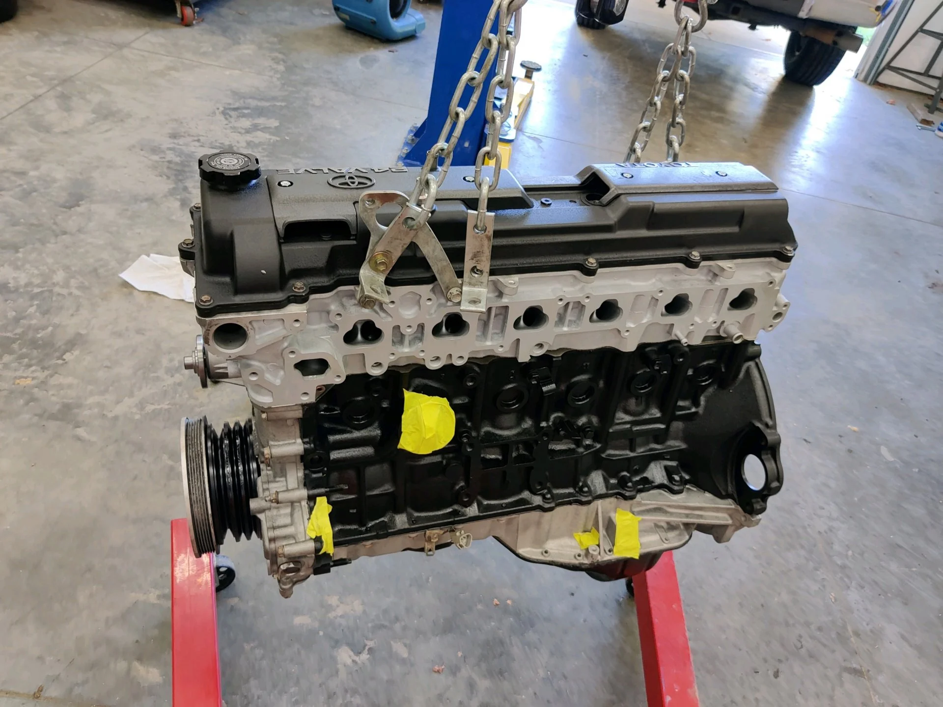

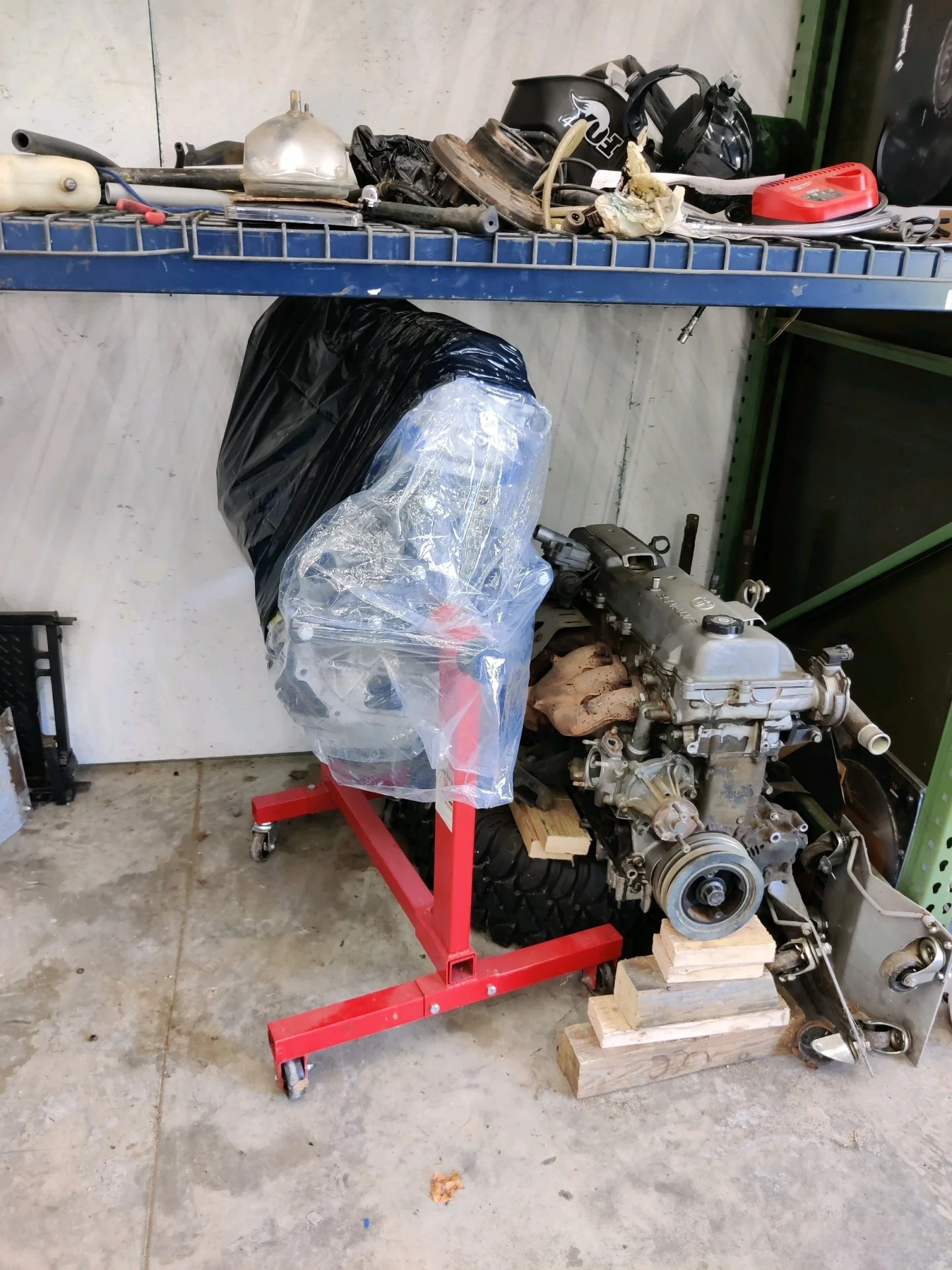

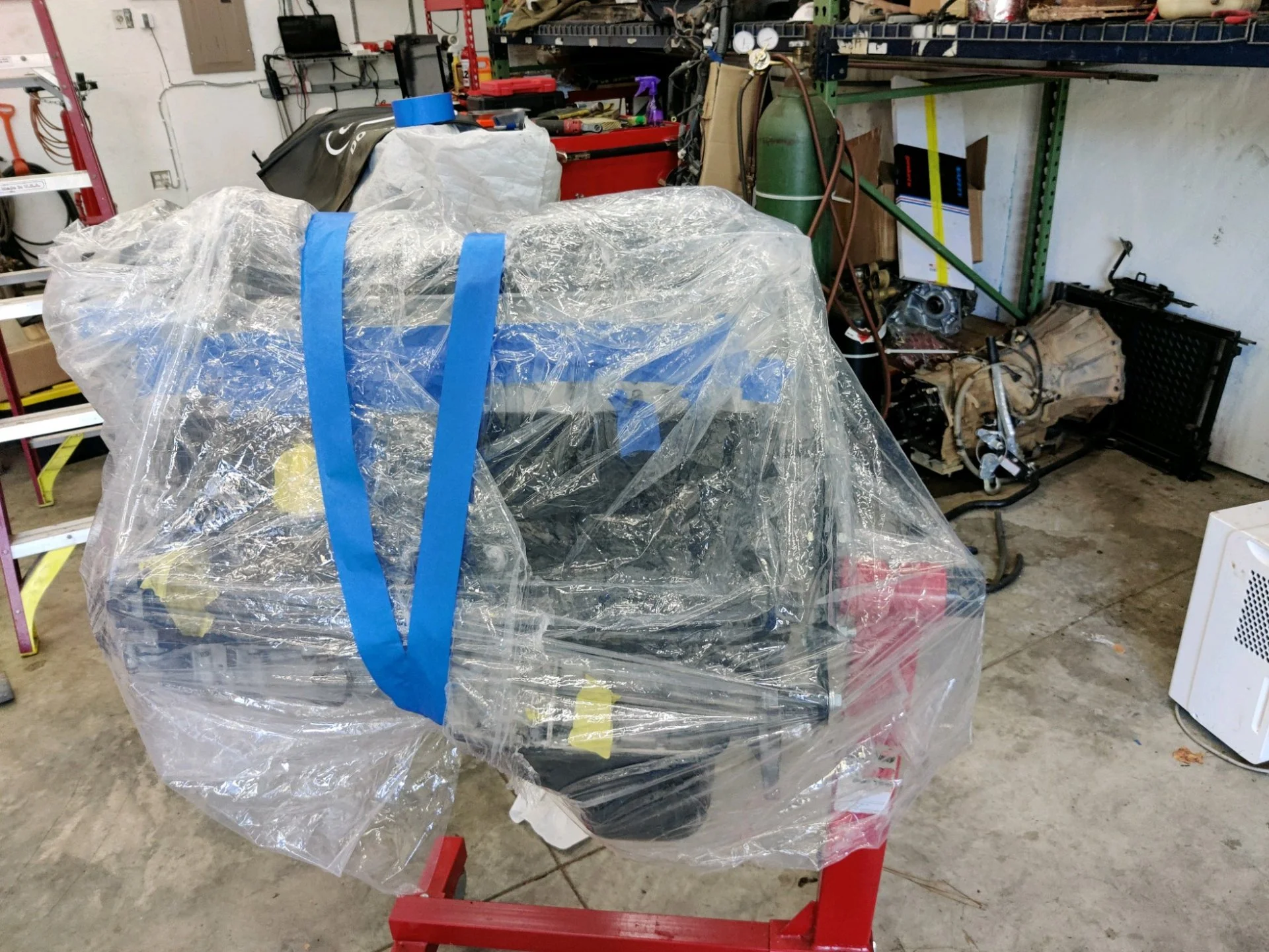

The machine shop called and @fourtrax picked up my engine today.
Then he wrapped it up and ticked it away :)
