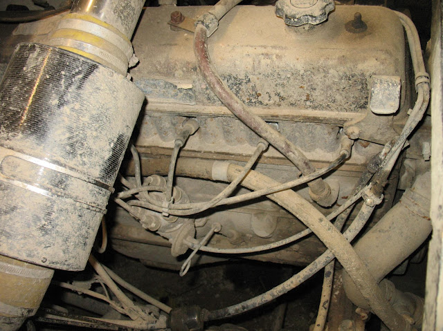

Hi everybody, I decided to replace my old, tired stock F engine with a 2F I bought a couple of years ago.
My car is a 1972 FJ, the 2F comes from a early 1979 FJ.
Actually I have a 5 gears H55F gearbox and I would keep running it; fortunately I noticed that the 2F was probably coupled with another H55F so I shouldn't have to modify the gearbox bell.
Now here there are my questions:
1 - First of all: what do I have to modify to swap the engine? Engine supports, fan, flywheel or...
2 - Now that the 2F engine is still on the ground, is there something I can do to fix it in the better way before put it up?
Soon I'll post a couple of pics to be clearer.
Thanks a lot!! :steer:
Old F engine:
New 2F engine:

Welcome first off thats a good swap, your 2F will bolt right in to the same mounts as your 1F I am guessing your running a 3speed trans ? if so your 3 speed bell housing will bolt right up, as far as your new 2F I would suggest new gaskets . oilpan, side cover, valve cover and also the rear main seal. Keep posting pics and if you need anything let us know

Ooops, I forgot a thing: now I run a 5 speed gearbox coming from a HJ 61 (to put it on I modified the old gear bell that was coupled with a 3 speed gearbox)and I would like to keep it. I tried the gear bell of the new engine and seems to be coupled with that kind of gearbox, is it possible? The engine is a gen or feb '79.
Old F engine:
New 2F engine:
Molto bene, Francesco!
I think you've chosen a great motor to swap in, and I look forward to your progress.
As previously stated, this should be a mostly bolt-in swap, especially since you're already running an H55, all the difficult steps, such as cutting and relocating of the transmission cross-member has already been done.
I'm subscribed to this swap!:popcorn:
Buona fortuna; il mio amico!

Toy will not be able to use to much from your old 1F motor on the 2F you can swap out the intake and exaust that way you can still use your old exaust collector and pipe. I would suggest changing the rear main seal, oil pan gasket and intake/exaust gasket everything else you can change after its installed if your looking to save money. You can post up in the parts wanted section I do not know the cost of shipping but if you want PM me a list of what your looking for and I can price it here and then check the cost of shipping to Italy. Do you have any Toyota dealers there we could get you the part numbers if you do. Just let me know Rob

You can use the clutch parts you have now with the new engine.
Clean-up the 2F. If you can this is the time to replace all the gaskets (valve cover, side cover, oil pan, & timing gear.)
Yes, plan on replacing all of the ignition parts (spark plugs, wires, distributor cap, and so on.)
Send a message to Kurt at Cruiser Outfitters he can supply the parts you need at a reasonable price.
Good luck!

Hi everybody! That's what happened in the last days: I talked to some mates who are helping me in the work and I decided to put the engine on as it is now. I talked also to the old owner who told me that everything should run fine, oil filter and sparks are new and he suggested to put the engine and try it.
In the pic you can see the engine ready to be removed; fortunatley I can do it without removing the gearbox too.
Soon new updates!
