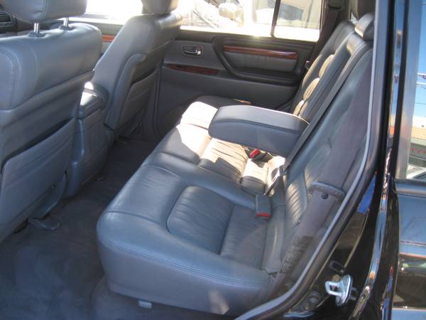

I wonder if it worth the price or I should keep looking?
here is pics

Worth it to check out I think. What color is interior grey or tan?
