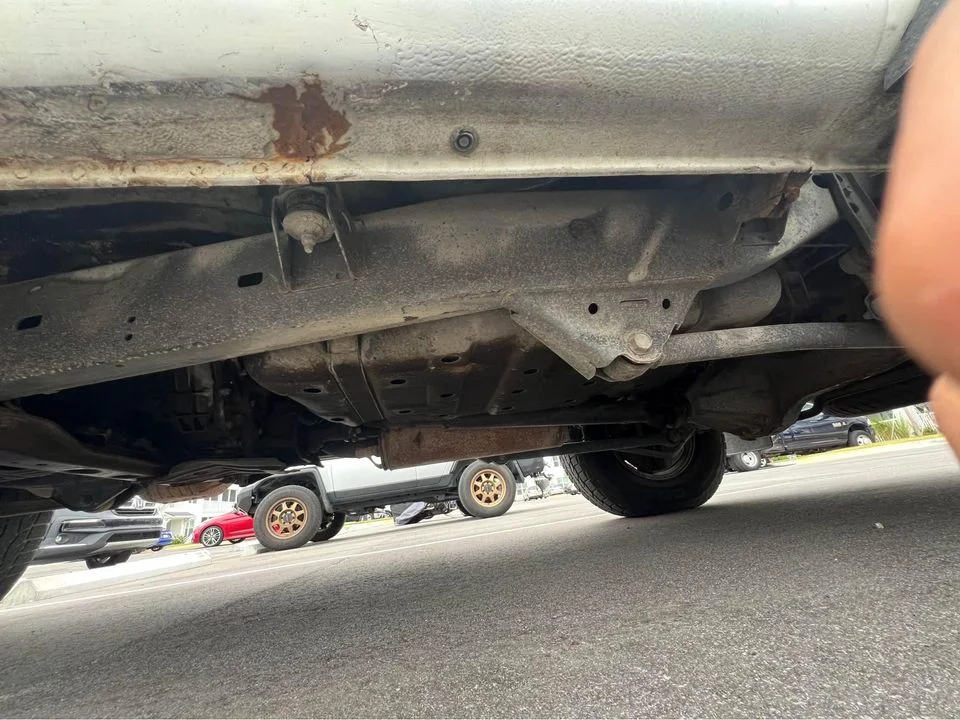

94 should be fine, I have found and replaced o2 sensors, looks good on the inside and out. Over spray paint underneath, might want to find out what kind of damage it was from. Good starting point.

That damage to the rocker doesn’t look fantastic…. It has rust already happening which means if you want it to last for many years your going to need someone to actually replace the rocker itself and repair it right. That rust is coming from the inside out which means will only get worse and become a giant hole. If that knock/tick is anything outside of the power steering gear I would plan on a rebuild anyways. 200k is young for a 1FZ to die though. Makes you wonder the maintenance history.
Looks like a nice truck, but I would beat him up on price about that noise. A rebuild using OEM parts is gonna be a 10k project. Not saying it needs a rebuild just plan for the worst so you’re not disappointed if it comes to that. Clean trucks are hard to come. Agree with the rocker rusting inside out is bad news.

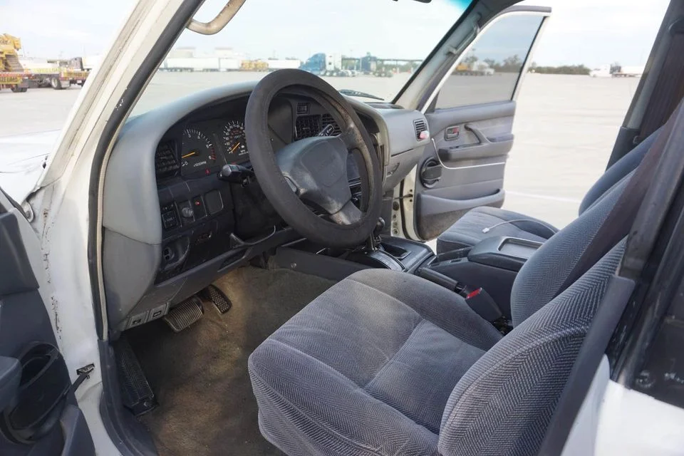

The interior looks nice and clean and cloth is a big plus !

Yeah man the more I look at this the more I would pass on this at 5 grand… so yes the rocker is toast as I mentioned, but this damage goes much deeper just based on these few grainy hard-to-see photos.

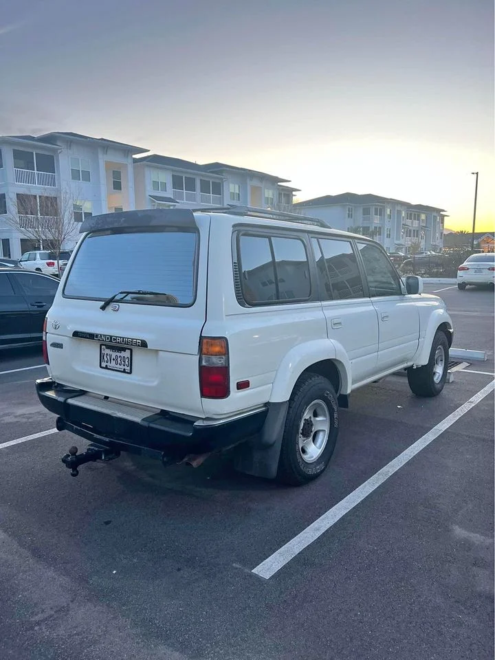

Please observe the door gaps on the R/F fender to door. Not a good gap. It could be crappy photo and bad angle, but I doubt it.

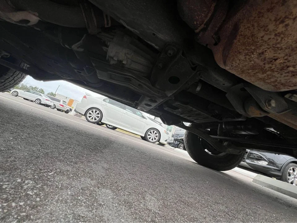

The drivers side rear lower control arm is clearly bent badly in the photo. Judging by the condition of what I’m seeing mechanically so far it’s been driven like that for who knows how long. That WILL throw off your pinion angle and cause vibrations and if ignored will ruin your joints as well as damage transfer case output bearing and pinion bearings.
The collision damage seems to be on the drivers side hence the poorly repaired rocker. So expect door issues/paint repairs. Judging on the rocker repair quality I would brace yourself for much much more body issues if someone with experience looks at this for you.
