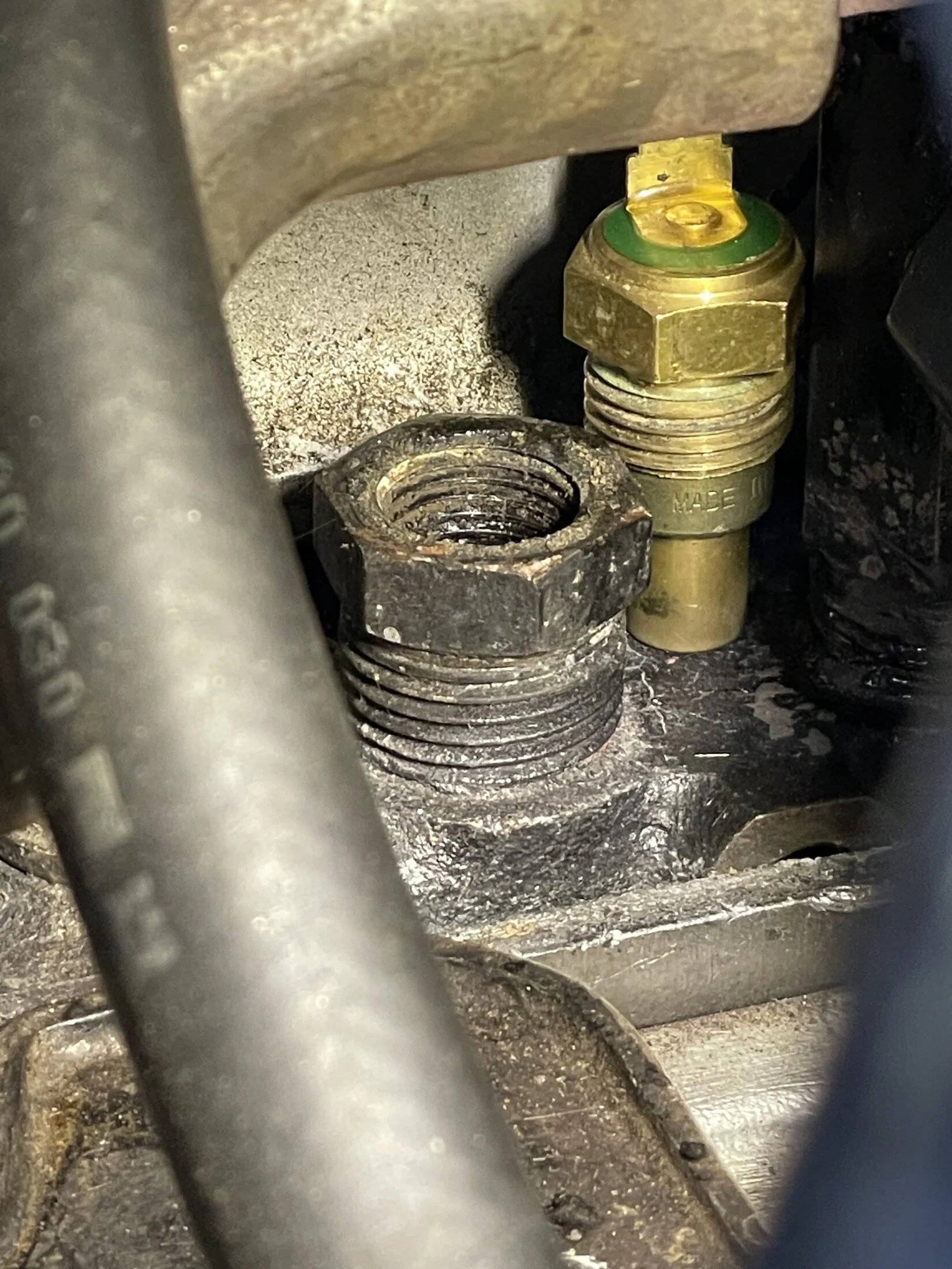

Should this threaded adapter be shorter so the temperature probe sits further down in the coolant?

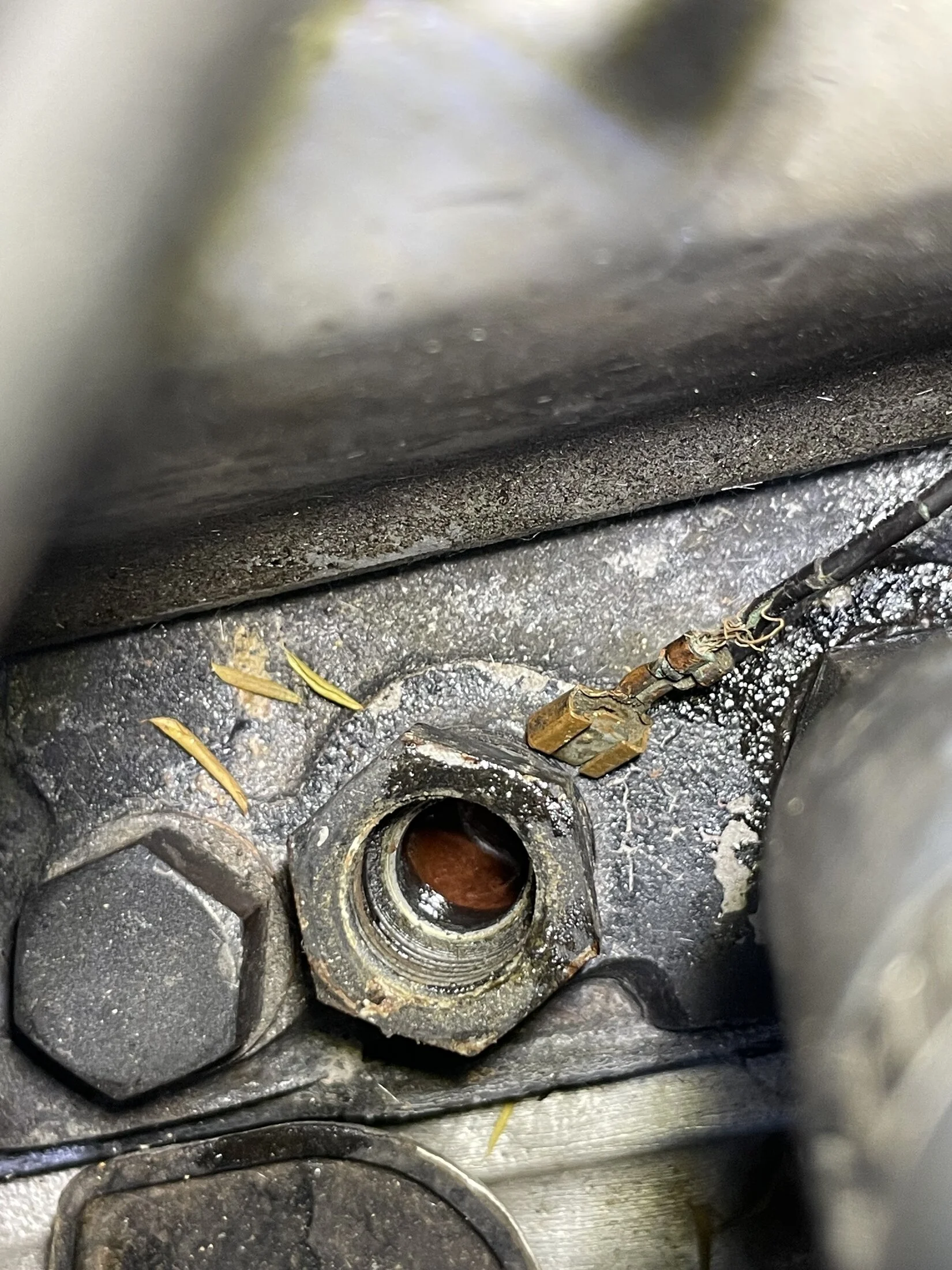

I just completed this fix and sure enough only the very tip of the sensor was in the coolant and the rest was dry. I had the engine rebuilt on this truck five years ago and have since replaced the radiator the fan clutch the thermostat multiple times the temp sender And the last effort was going to be adding a manual temperature gauge just for sanity.
Man oh man I wish I had seen this thread five years ago. I drive with a laser thermometer in the console because when I go any distance the gauge shows high temps. It’s stressful. I pull over and reassure myself that we’re not overheating. But sadly it’s left me hesitant to drive too far.
I just filled the air pocket and look forward to testing this fix… but it makes so much sense, I have high hopes.
Back to the original question which is, it seems like the threaded adapter sits really high. Wouldn’t a shorter adapter prevent this air pocket all together? Or would the sensor block the coolant flow? Does anyone know if that adapter is oem?
If you look at the picture, I stood the temp sender next to the adapter. If you take into account the thickness of the engine head there is minimal if any adapter sitting down in the coolant.
Update. Didn’t work. Still getting high temp readings on the gauge….. crap.
