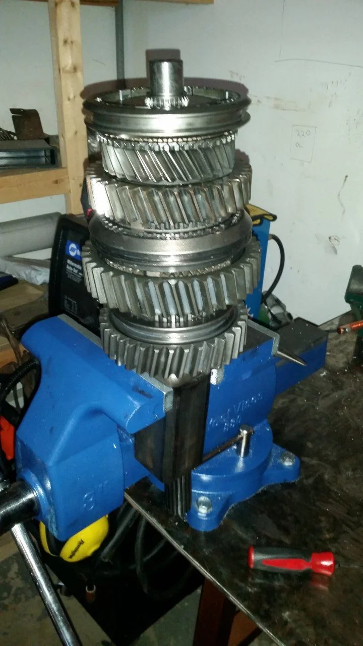

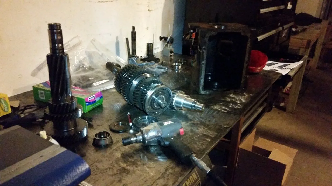

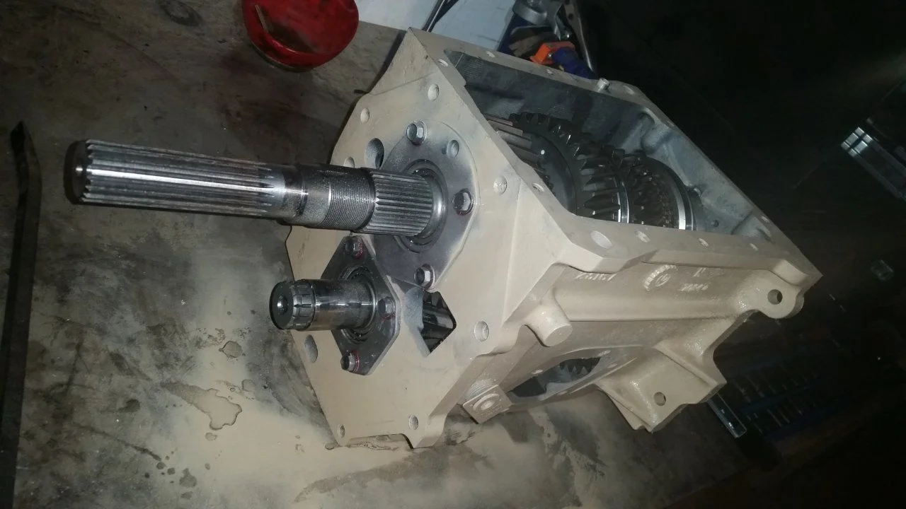

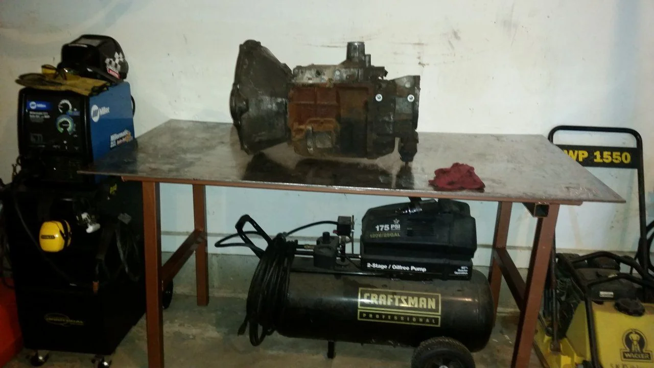

I have still have to write up my rebuild with the new mainshaft...but here are a few teasers.
