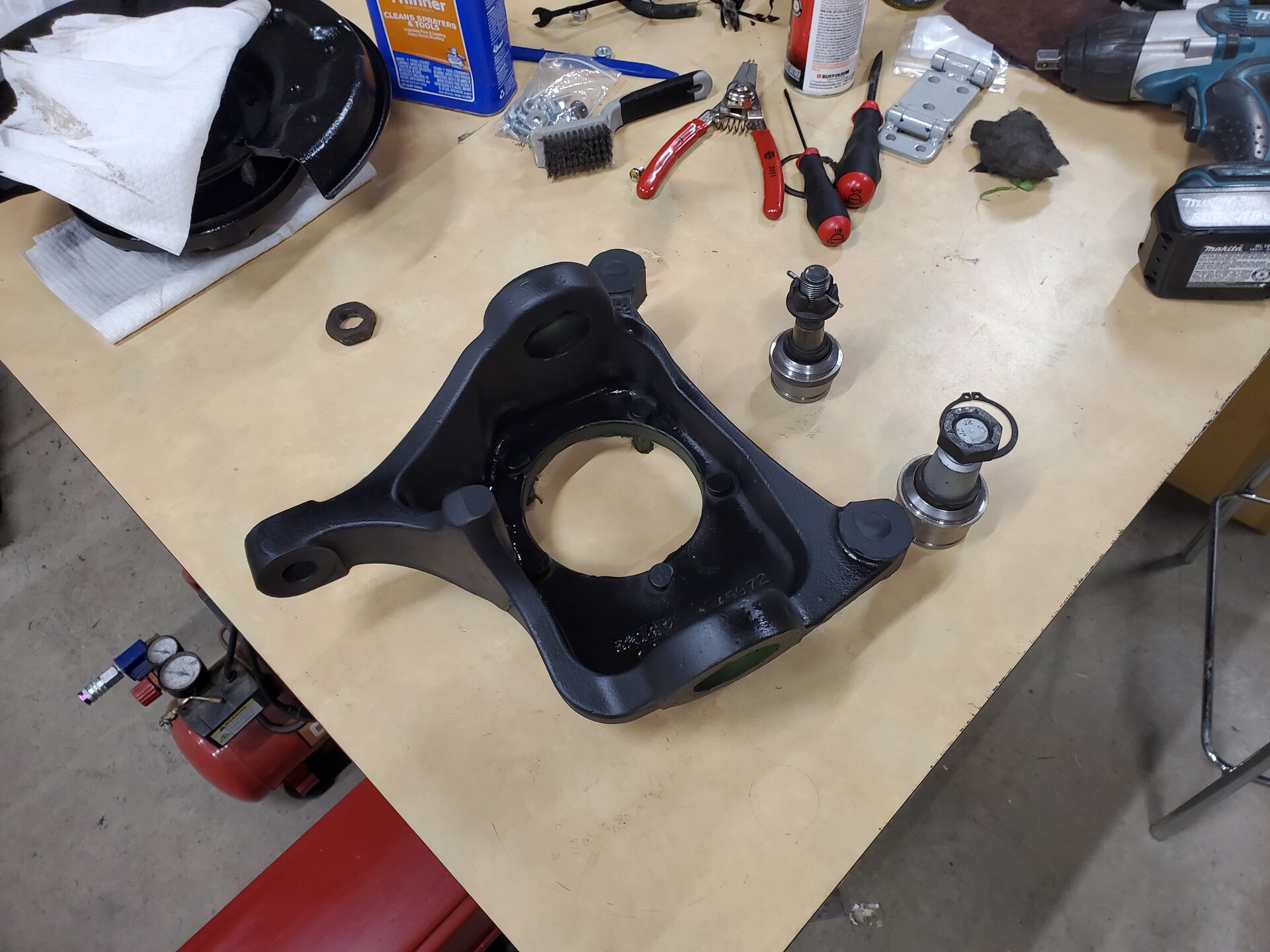

Well, I need parts to get back on the 40 and the 80, so I decided to start working on the 60 for Bumble. I grabbed one of the knuckles and pressed out the old ball joints. Cleaned it up and threw a coat of rust converter primer on it.
Once it flashed off, I figured I'd press in the new joints. Apparently the d60 lower joint is a monster and the ball joint press wouldn't seat it all the way. I fiddled with it and after some digging around, I found that a spindle nut was jsut about the right size to space out the press. So I ground the threads out and then used it to finish seating the lower joint.
And here's the finished product with the new snap ring installed.
The upper should slide in and tomorrow I have some Ford blue tractor paint that I will paint on. Then that should have this knuckle ready to go. Then I'll get the other one cleaned up.

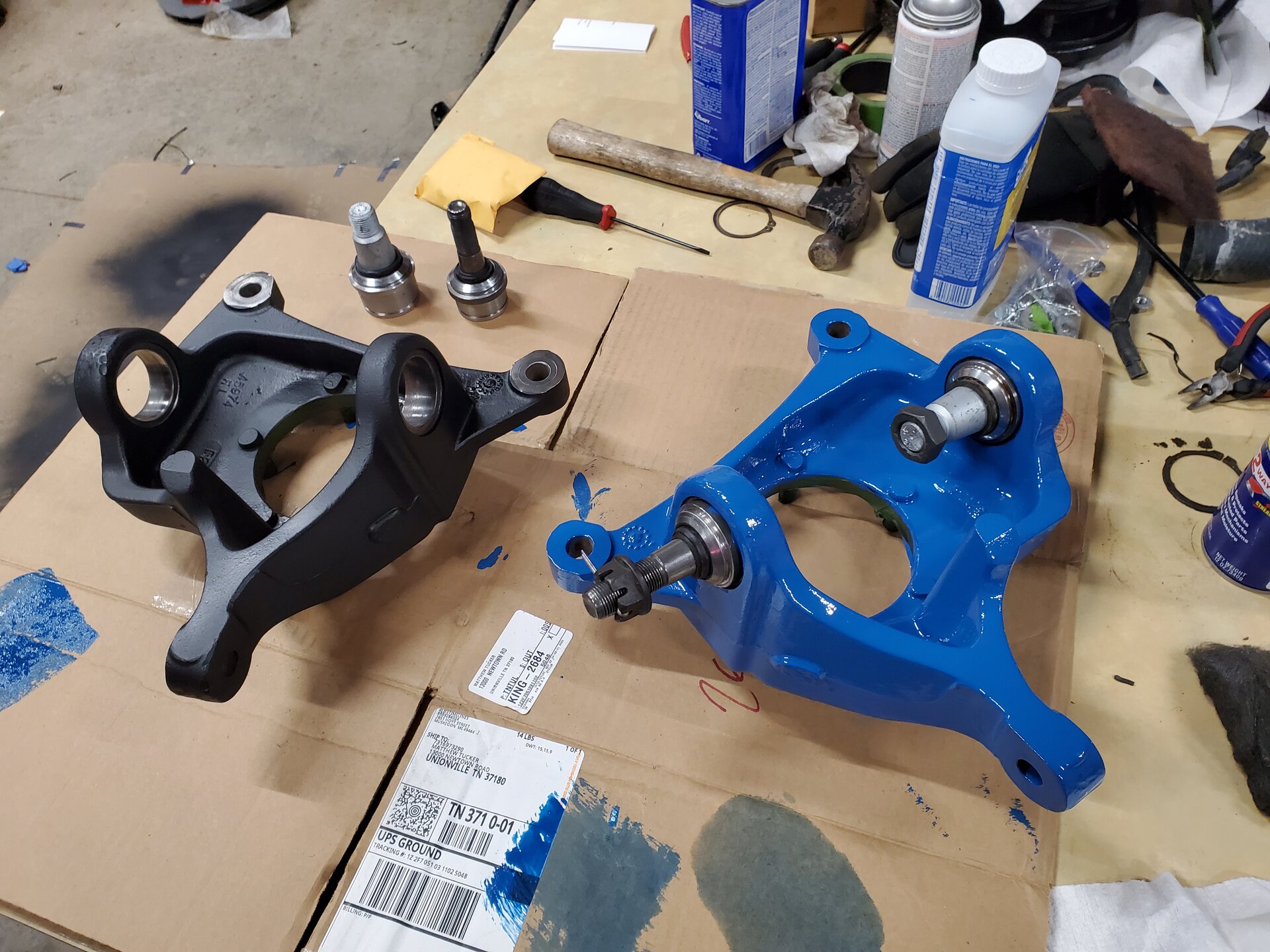

You've all seen Reid orange, I give you Ford blue!
Second knuckle got a good cleaning
Then a coat of rust converter.
And then I used my special tool and installed the new dana joints.
Now I just to have to paint the second knuckle and they'll be set.

One knuckle two knuckle, now they're both blue knuckles.
I also realized today that someday I'm going to hate that I painted the snap rings, but that'll be a job for the wire wheel on another day.
