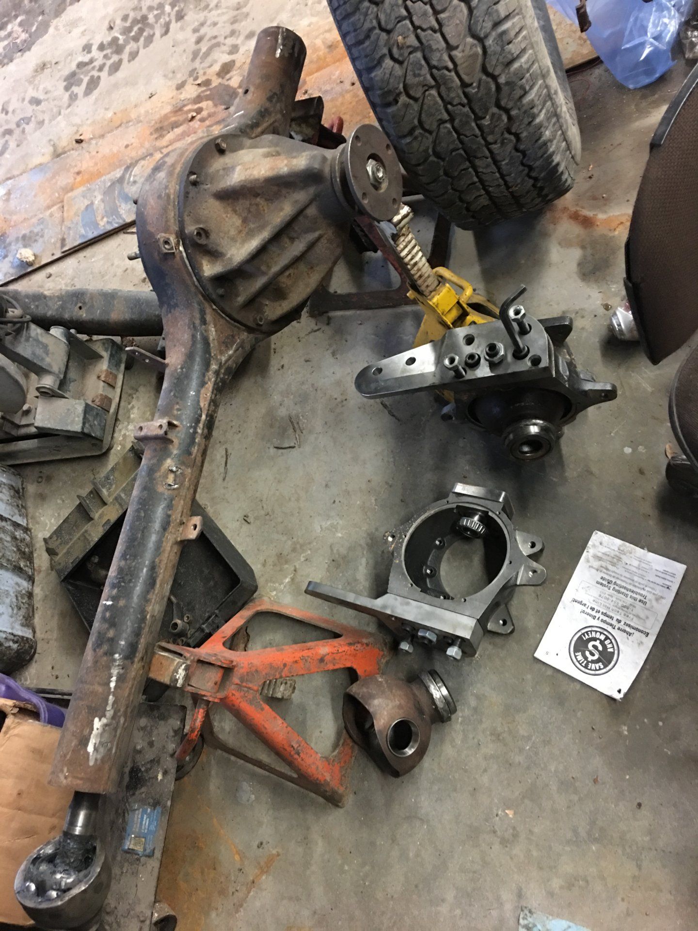

Hi all,
I’ve installed 80 series axles with e-lockers front and rear on my bj42 rockrawker in 2007,modified the 80 knuckles to highsteer,5:29s,Long fields....after many years of wheeling,the front housing is bent,I broke the ring and pinion in Moab is 2013,now I’ve acquired the hellfire highsteer,60 series rear housing cut to 80 series width,my question is where can I get front 80 series long side axle with Long splines so l can use the 80 rear e locker in the front??
I already have the e locker....

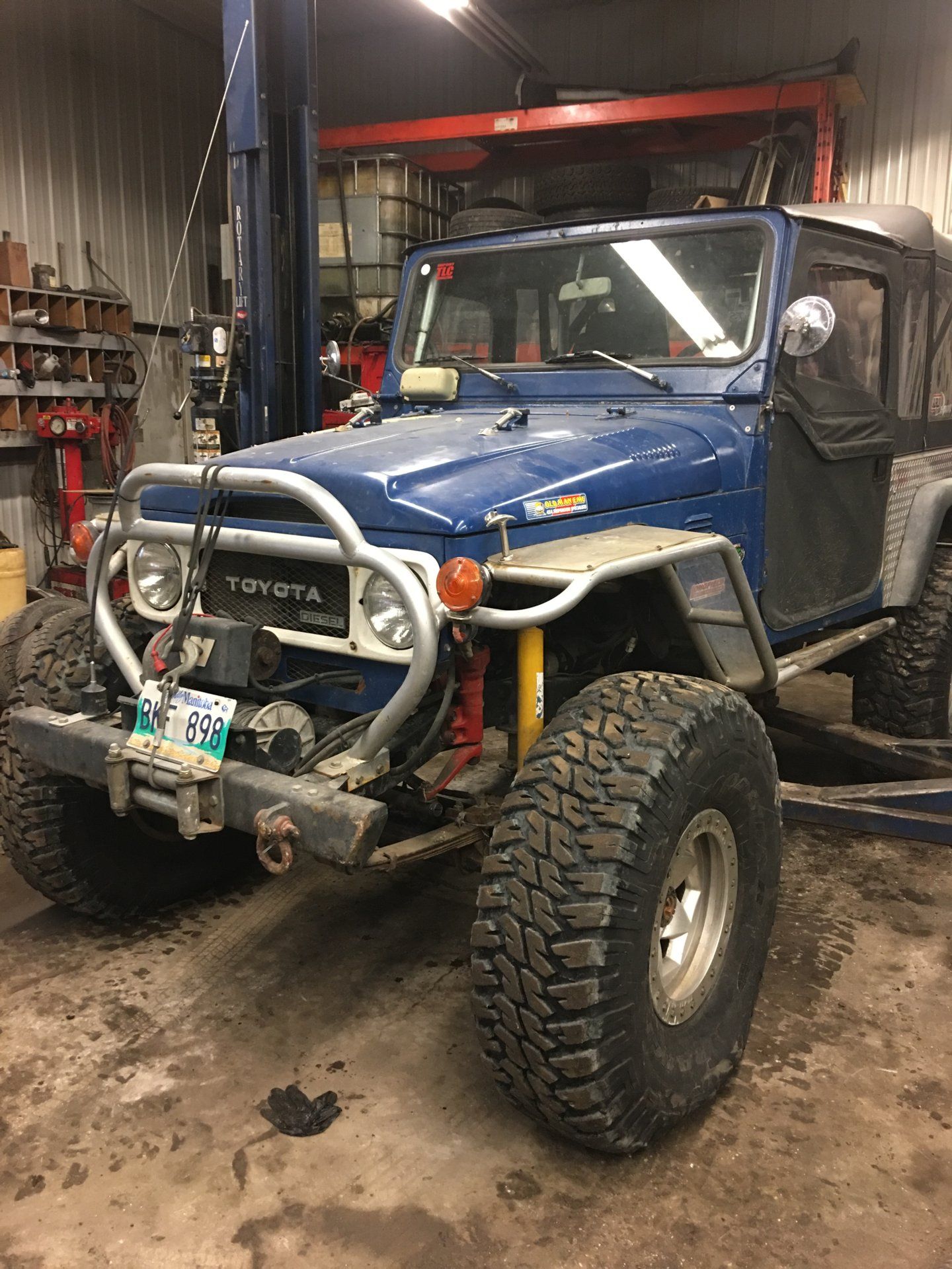

Hi Jim,yes those are 40s.
Don’t really have time to write a build thread,I’ve a shop and work on lots of jdm Diesel cruisers n Mitsubishi.
Short specs:
3B Diesel intercooler turbo
H55,marlin toybox 4.7
On board air York compressor
Roll bar is my air tank
Front bumper n inner front fender my vacuum tank for brakes
60 series front n rear springs
Trail gear steering ram n pump
Really want to 3 link the front but it cost a lot more to get all the parts to Canada
Plus I’ve two more bj42s and a fj55 to build.

I bought a rear From Bobby and then after he passed, a front from RCV. I sent them a sketch of what I was after and paid $290 USD in 2014. This is a picture of that sketch but you will have to measure your own length. I did this by sticking the diff in the center and determining the position of where the end of the axle should be relative to a datum. Then I removed the diff and installed the hellfire complete with an 80 series shaft I had to see how far in that went. Find the difference and then add/subtract that from the length of the shaft I used. This took some time and I was careful in the measuring, think machinist layout of a precision part. It all worked in the end
