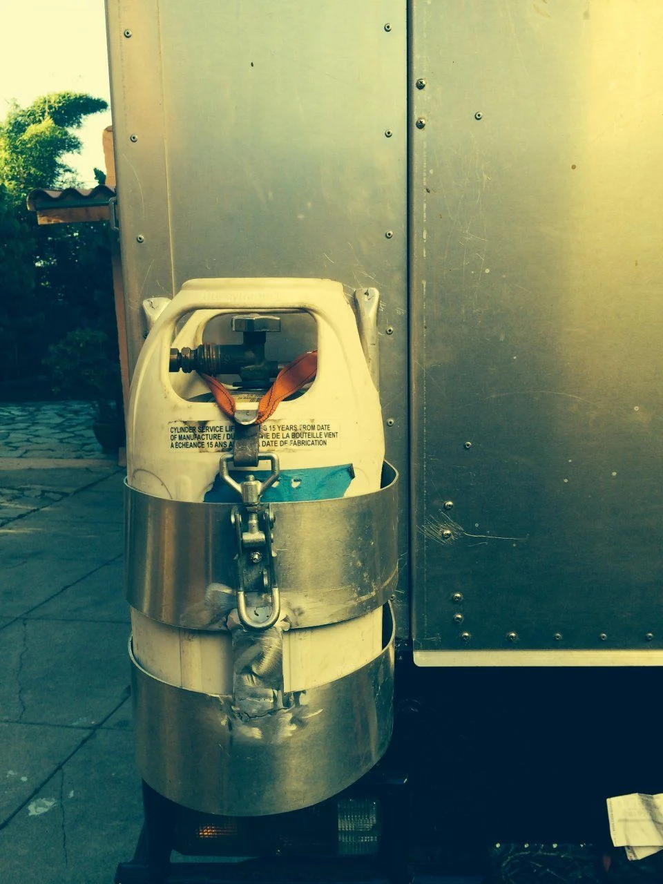

1) mounted a 2 or 3 gallon propane tank

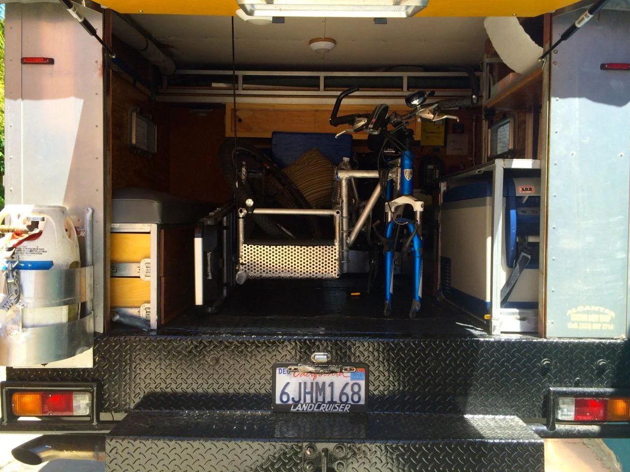

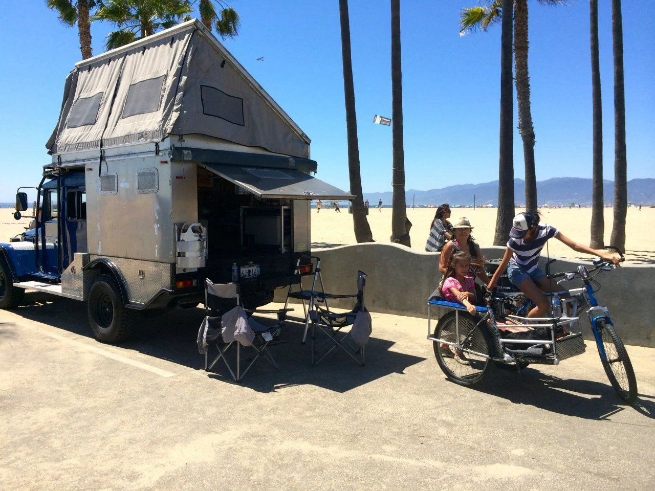

2) build Nulla a litter sister, an all aluminum bicycle side car. as you can see from the picture it fit inside the Nulla, but it also mounts in front of the Nulla. i don't have a picture of that at this time but i will share later. the side car works nicely with my wife, two little dogs and I. Our grand daughters loves it when they travel with us. we want to be able to go to the nearest town after setting up camp. we are thinking of making the side car electric but yet decided, we don't want to lose the exercise value of riding a bike.

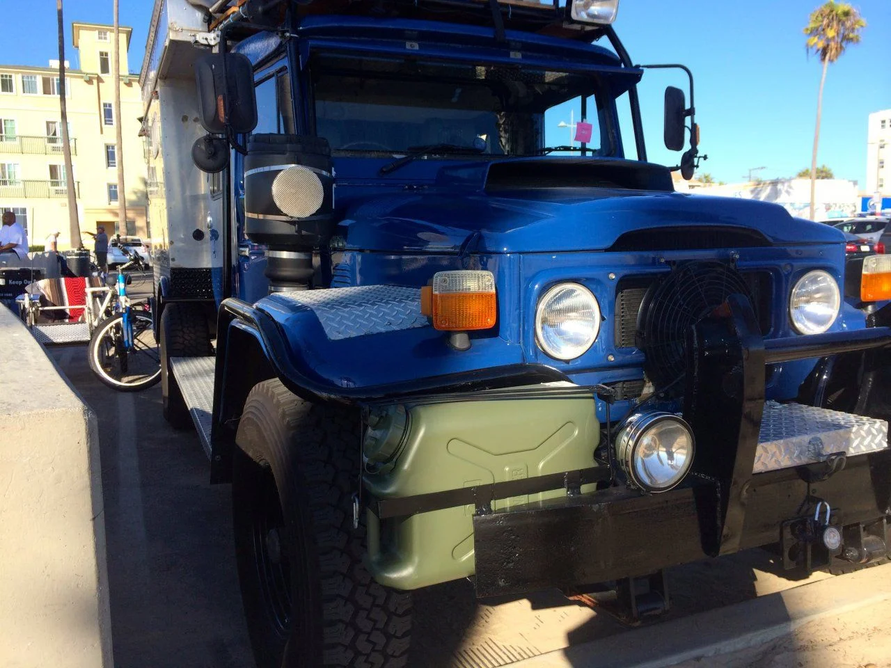

3) mounted two 5 gallon scepter can in front, when traveling the can are flipped upward (with the cap up), when we get ready to use the can just flip it downward open the air vent to let the water out. maybe someday a faucet can be added but for now this set up work just fine. trying to avoid added complexities. yes they have a lock.

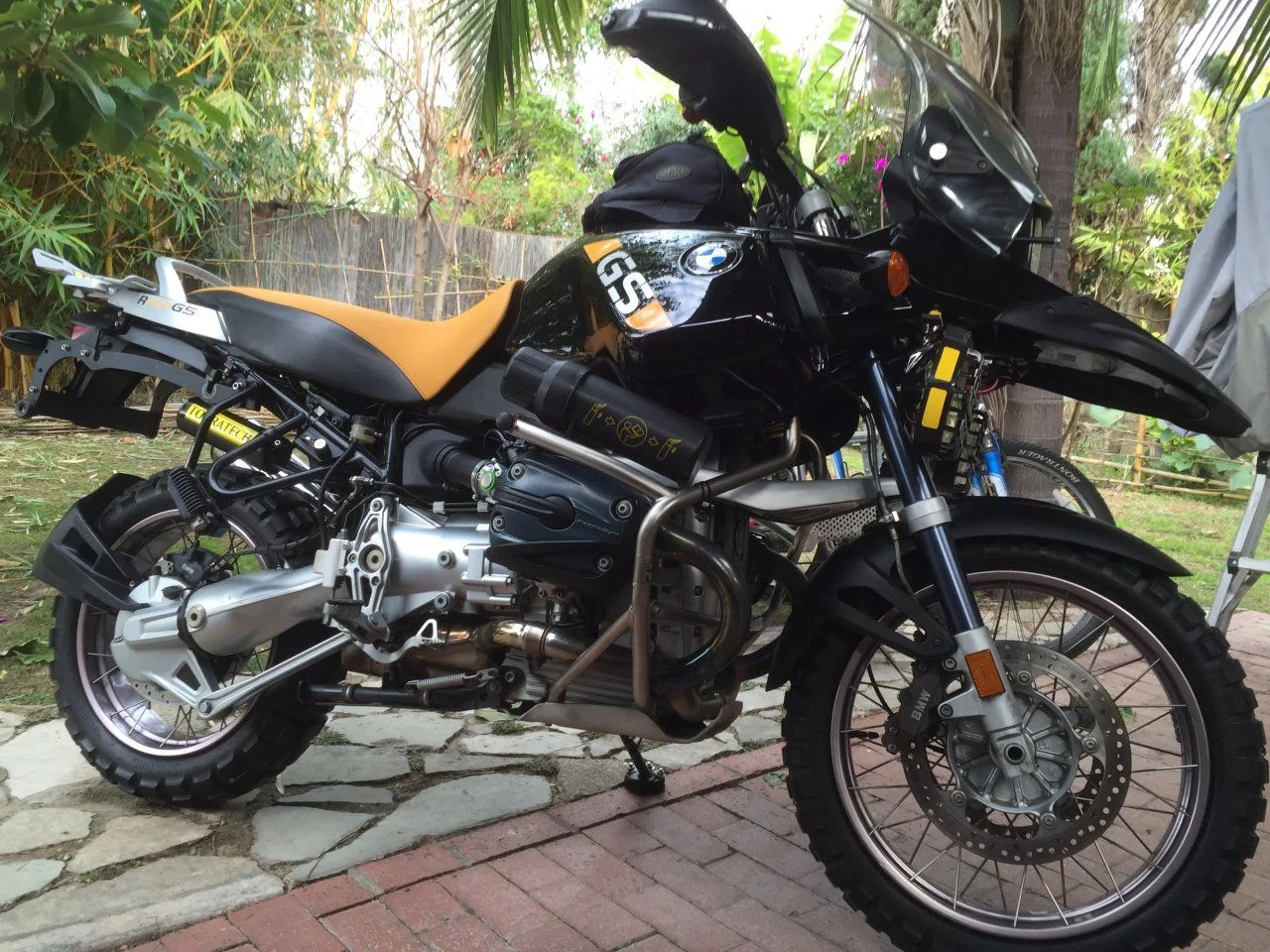

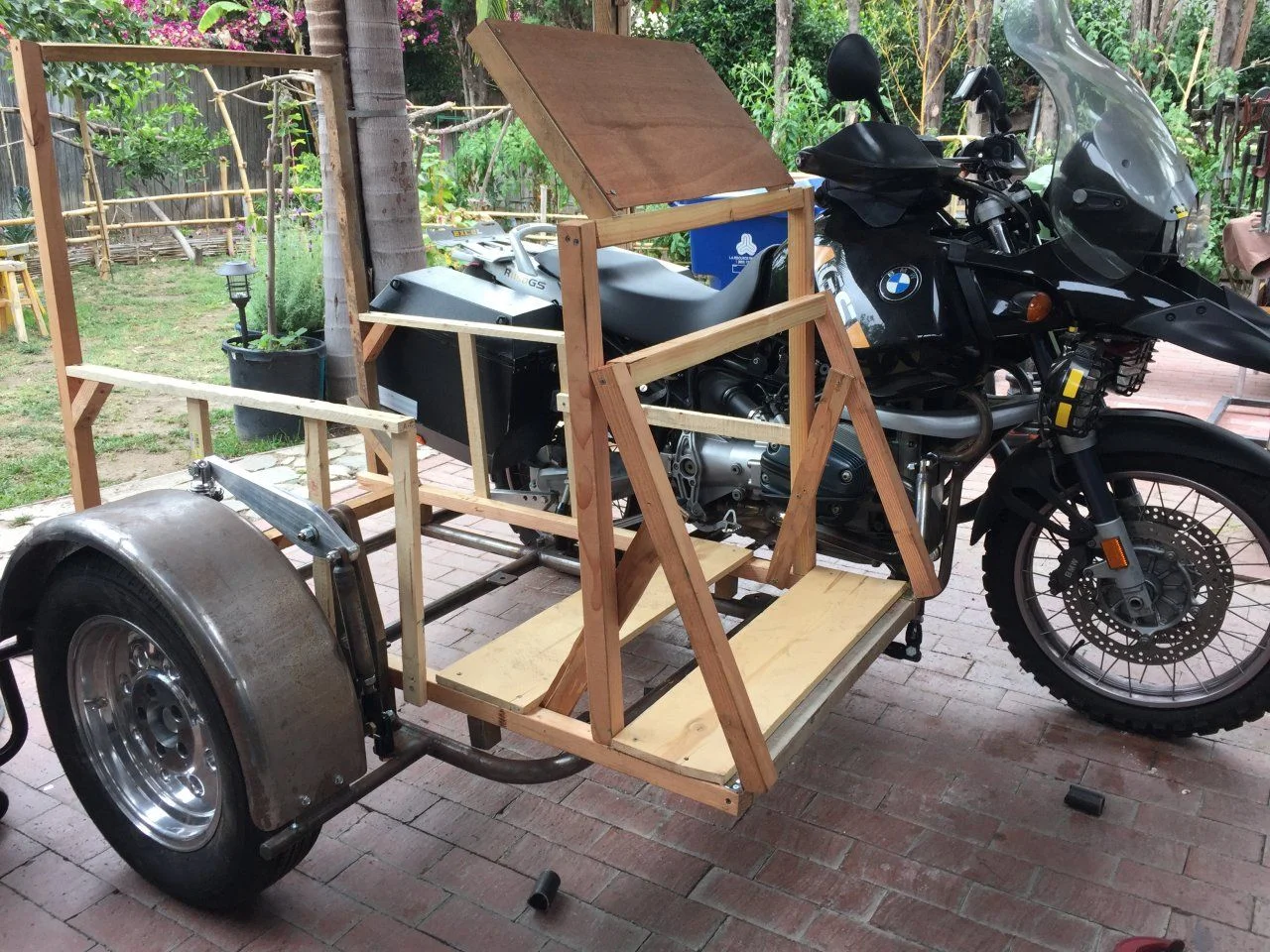

thank you all for the positive comments, here is a little up date; we are now in the process of building the tow vehicle for Nulla it will be a motorcycle with a side car here is the bike should have a rolling chassi by May (hopefully). the side car will be trailered. when we get to camp we do not want to break camp, this will allow us to take the sidecar to explore the area.... thx again

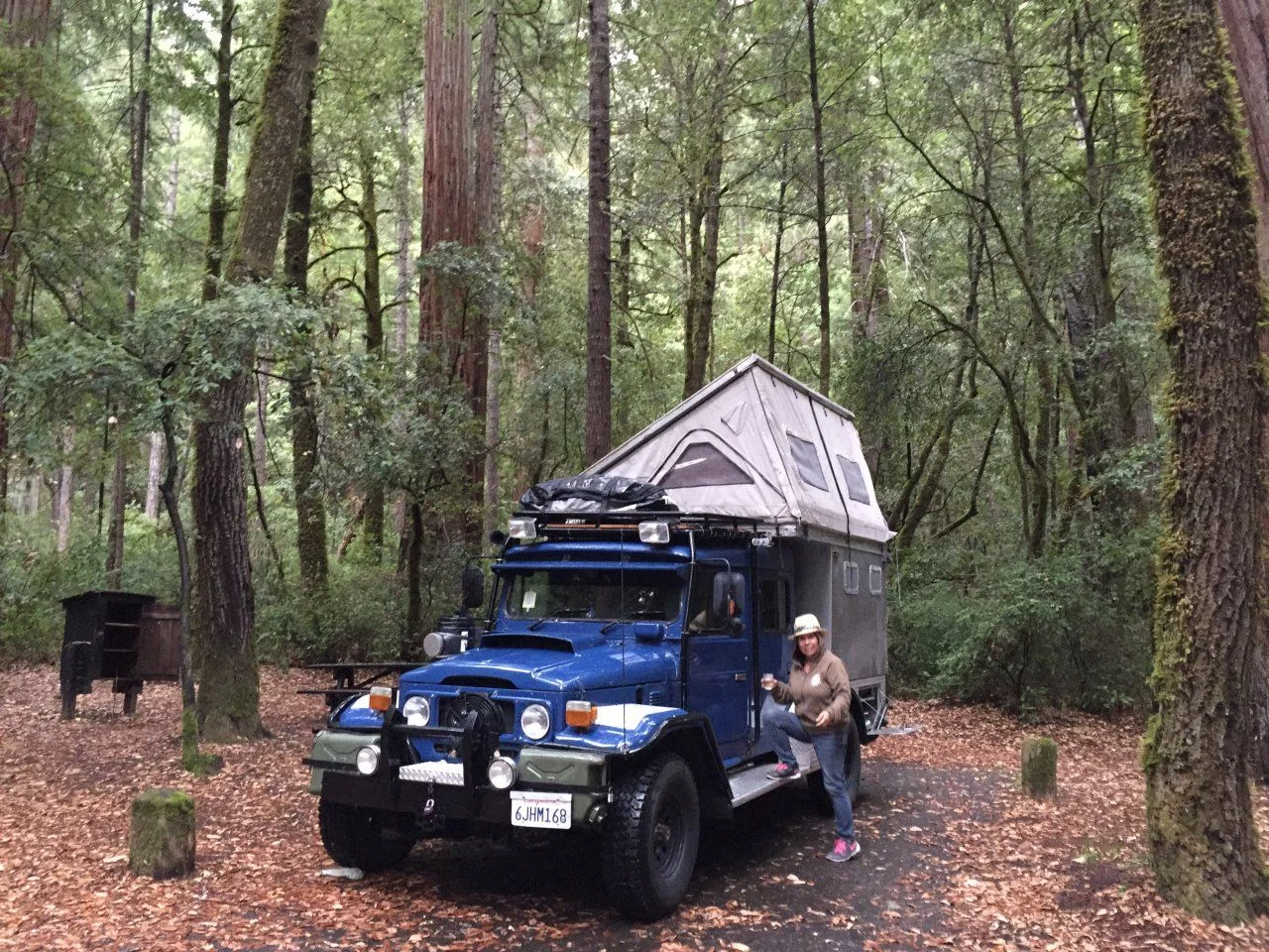

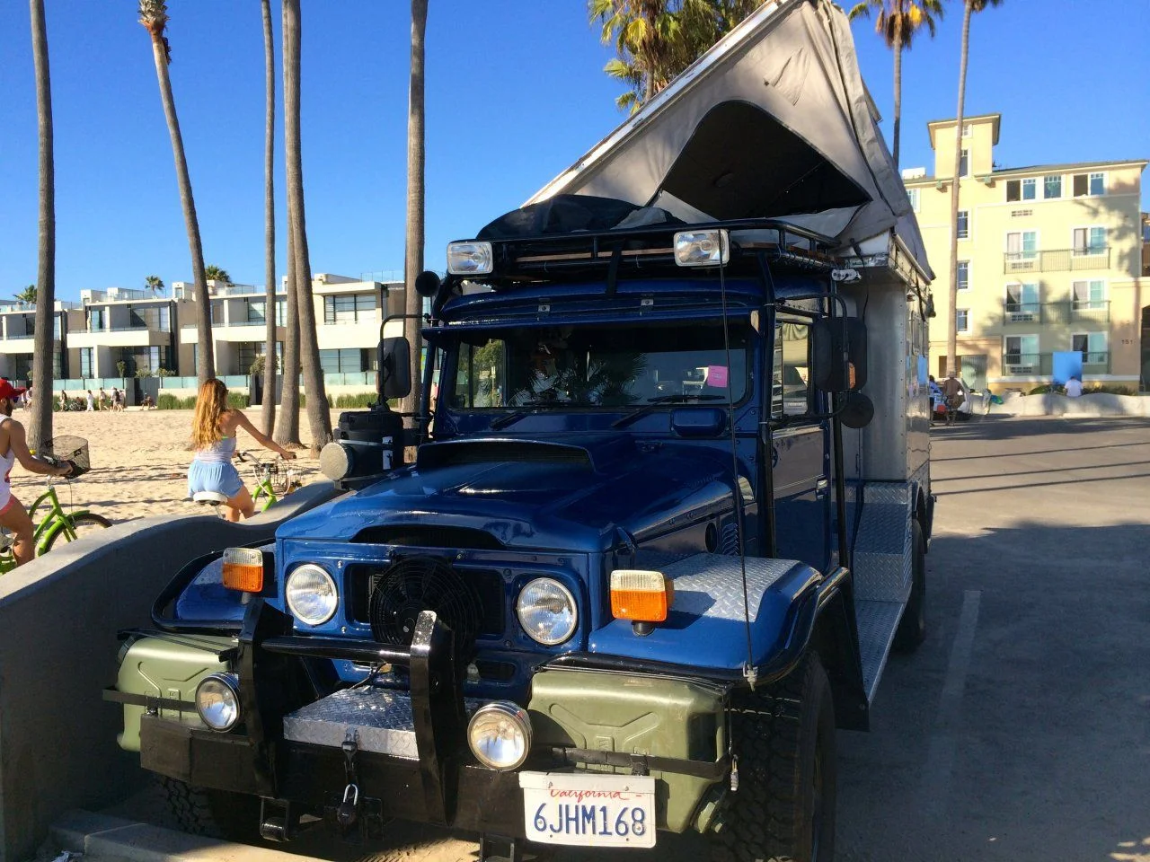

1. Nulla is currently on the road

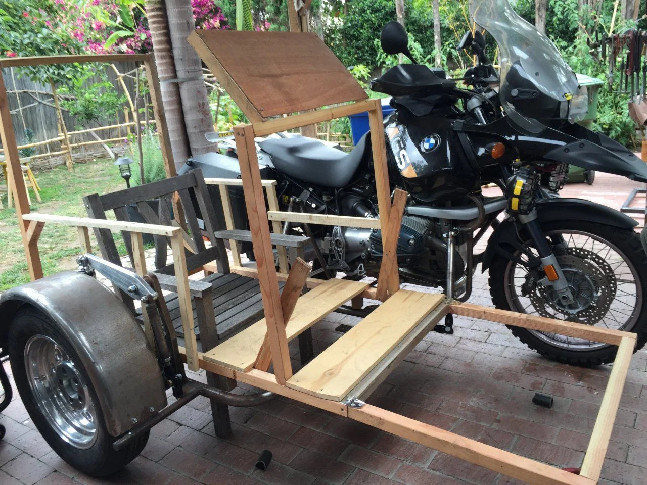

2. Nulla's sister motorcycle sidecar. the plan is to trailer the sidecar to use as transportation when we reach destination. it will not be made out of wood that is a mock up. the sidecar extend to 7 foot sleeping area, 30 inches wide...... thanks

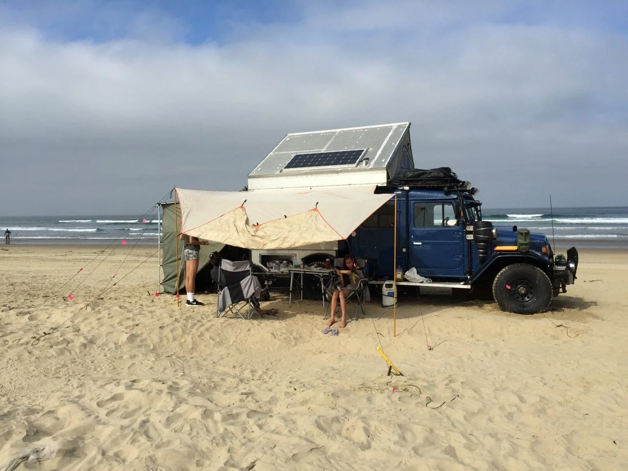

So our beach pictures look like this (this is in Goa, India)
