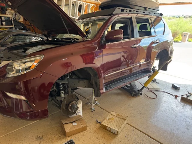

It was definitely time for brakes!
OEM Rotors front and rear
Hawk Performance HP Plus Brake Pads - Front
Hawk Performance HPS Brake Pads - Rear
