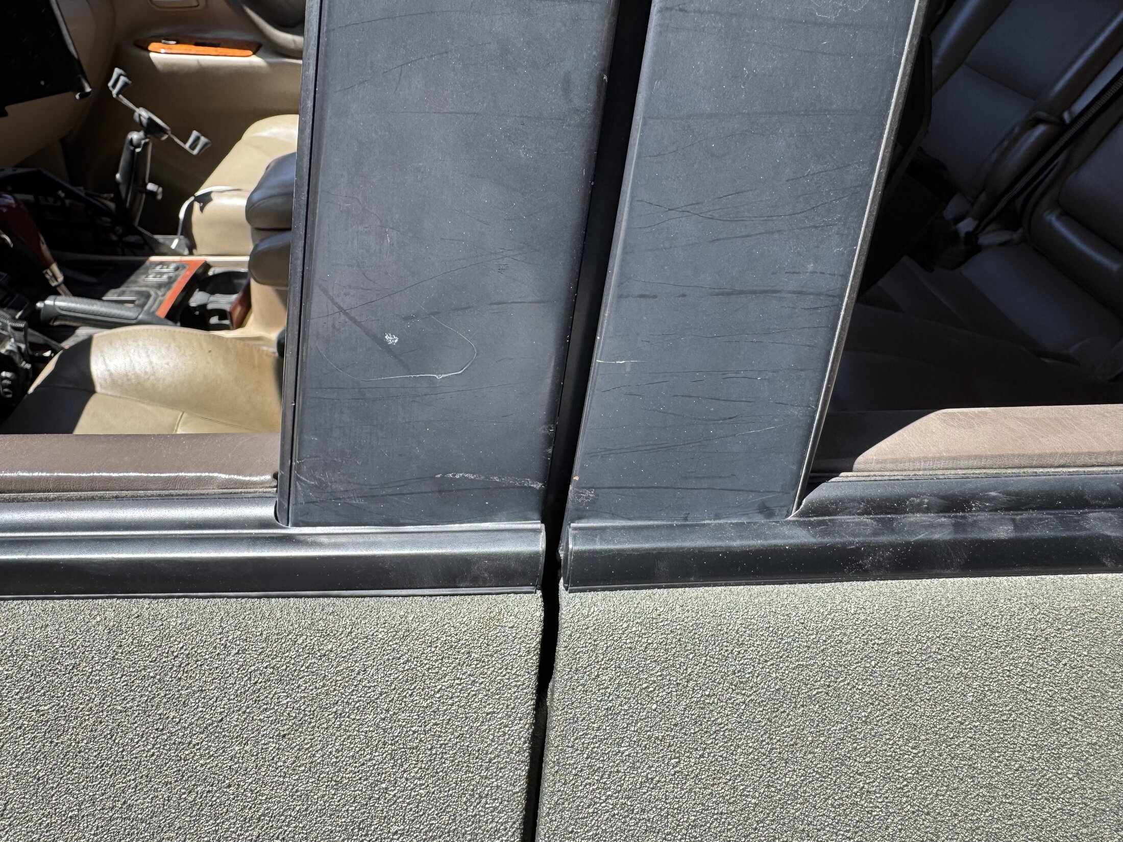

My A/C line clamps are broken. Go figure. Been putting that off for far too long. I noticed all the weatherstripping/trim along the bottom of the windows is starting to shrink and crack. The drivers rear window switch was starting to get stuck up. Causing the motor to overheat and the window to not work. So I placed an order on PartSouq.
everything is back to being nice again! Except the broken clip on the door panel… they don’t make them in the darker brown color from what I can tell. So I ordered the tan and will have to paint it once I find a color close.
