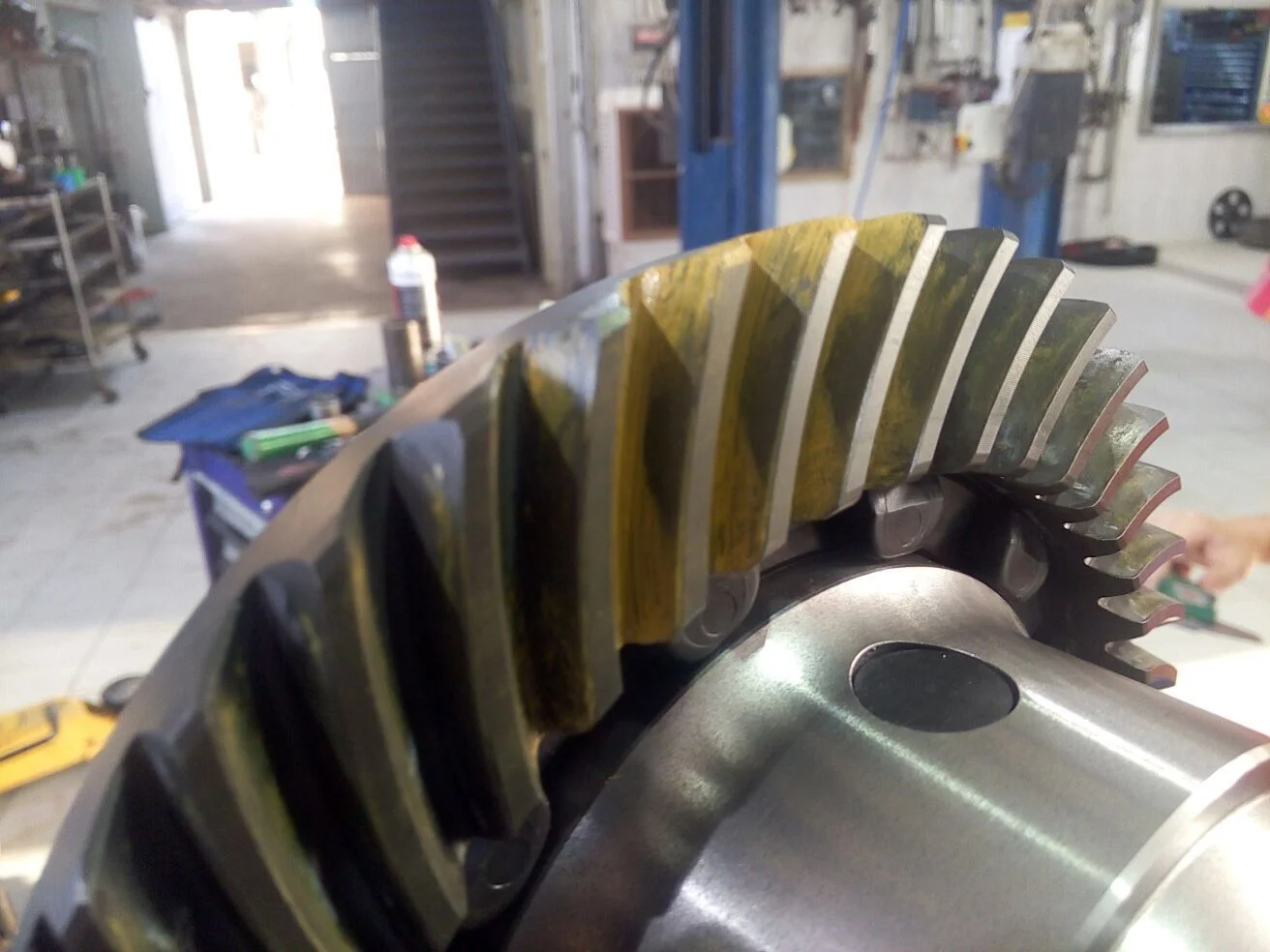

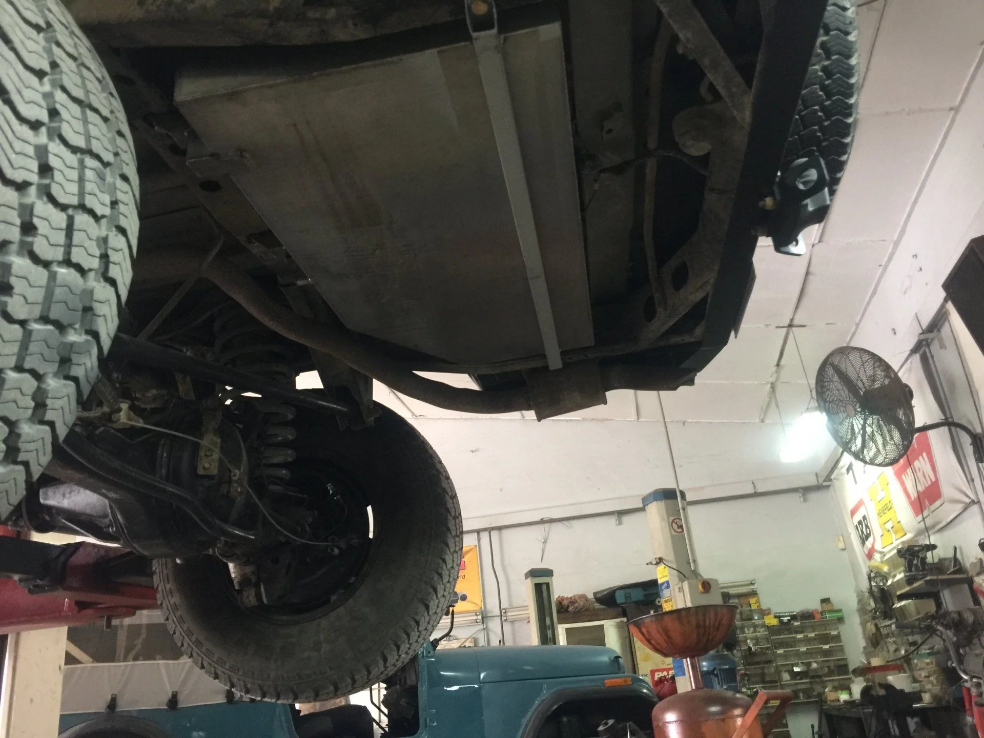

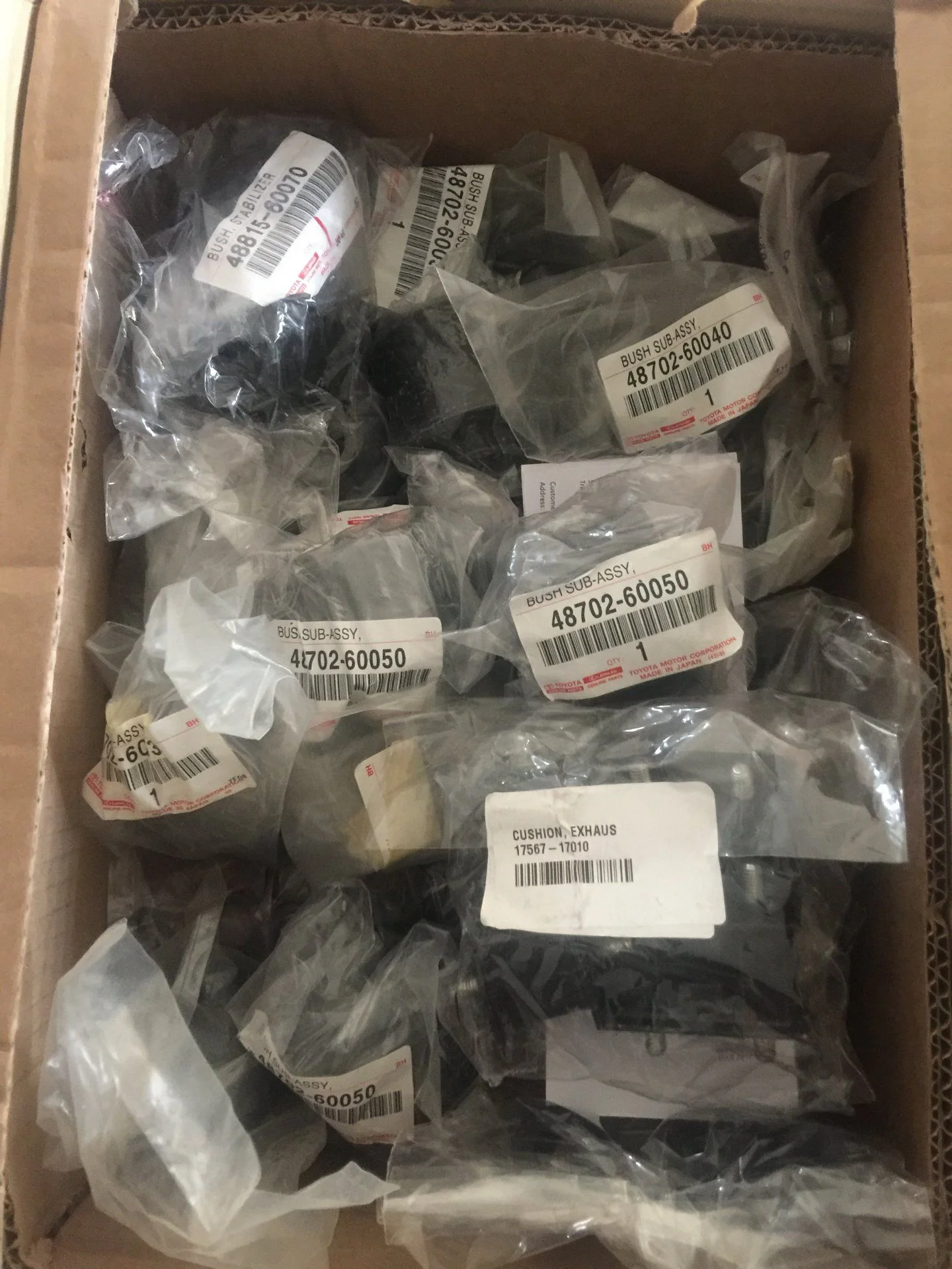

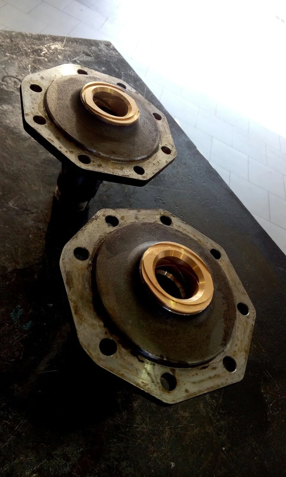

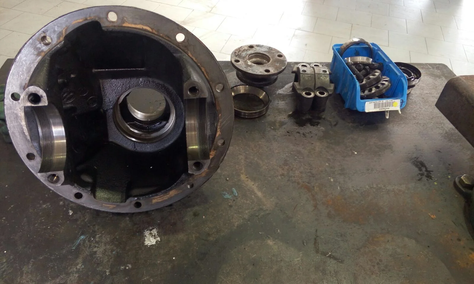

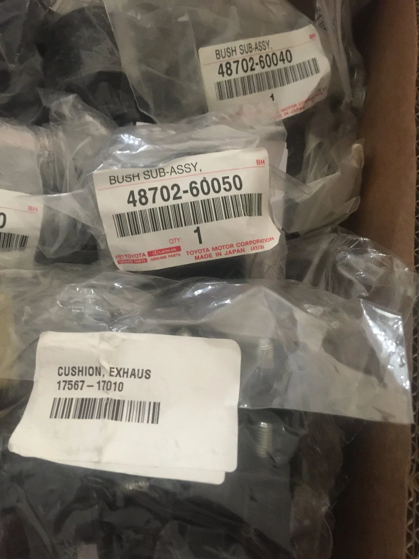

We started to work on the rear differential AEB lockers + 4.56 and full rebuild (seals and all bearings)

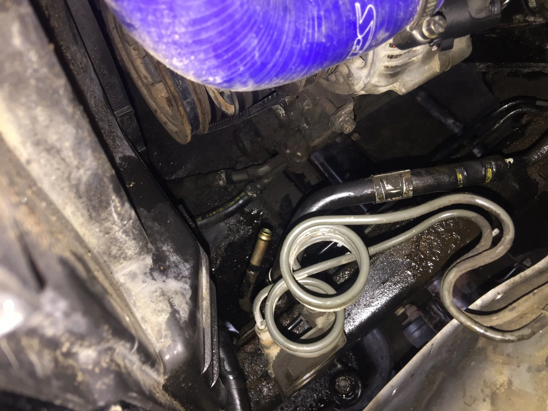

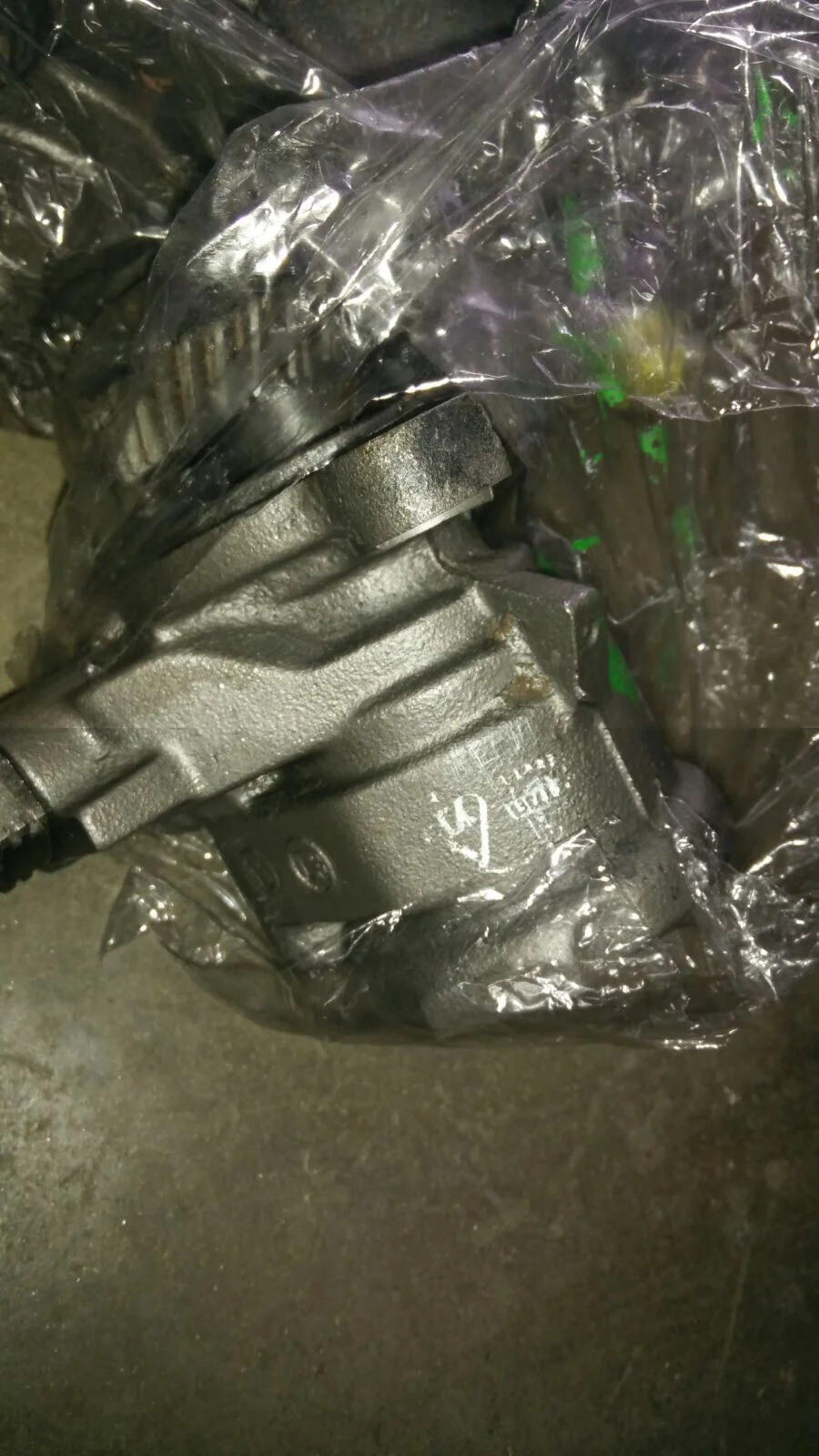

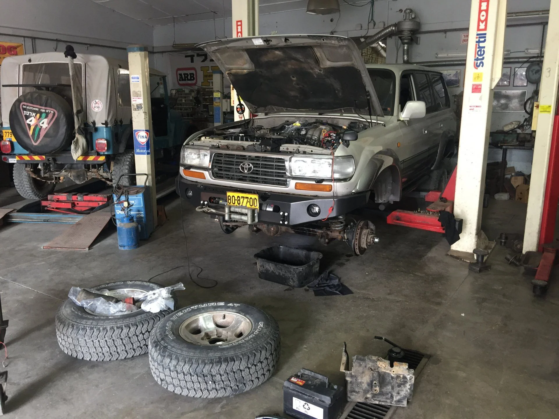

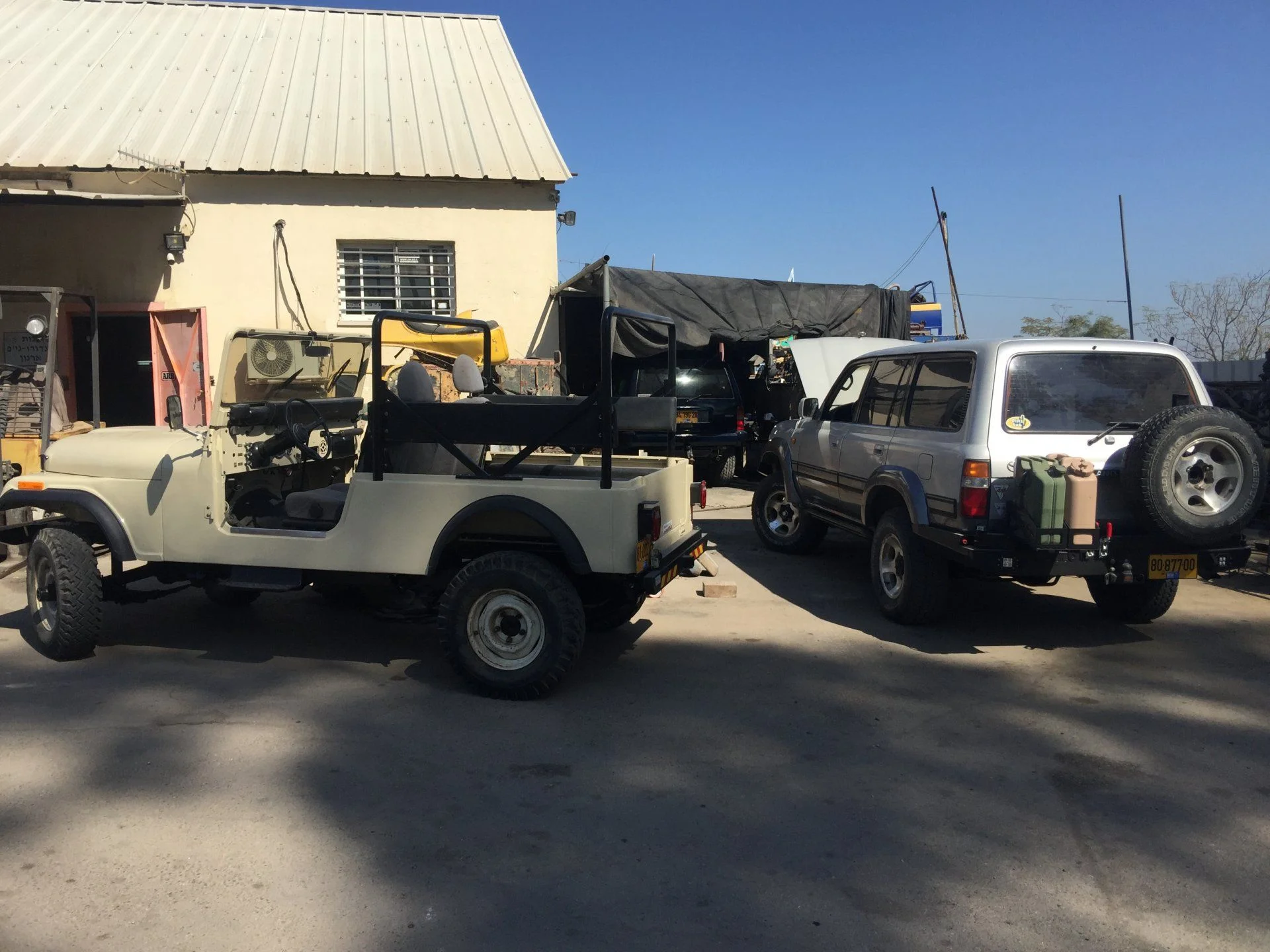

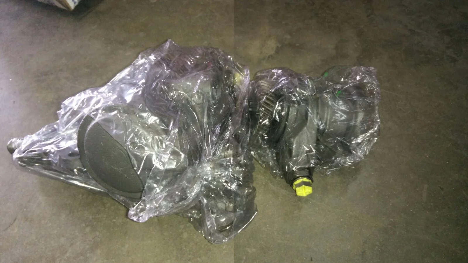

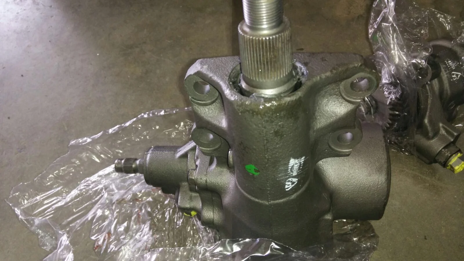

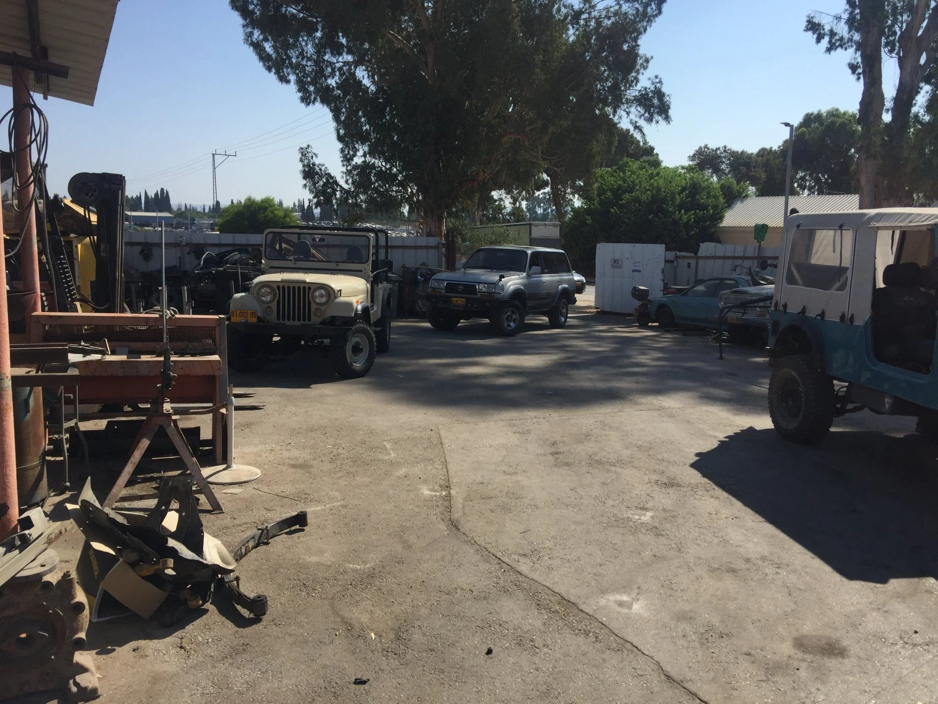

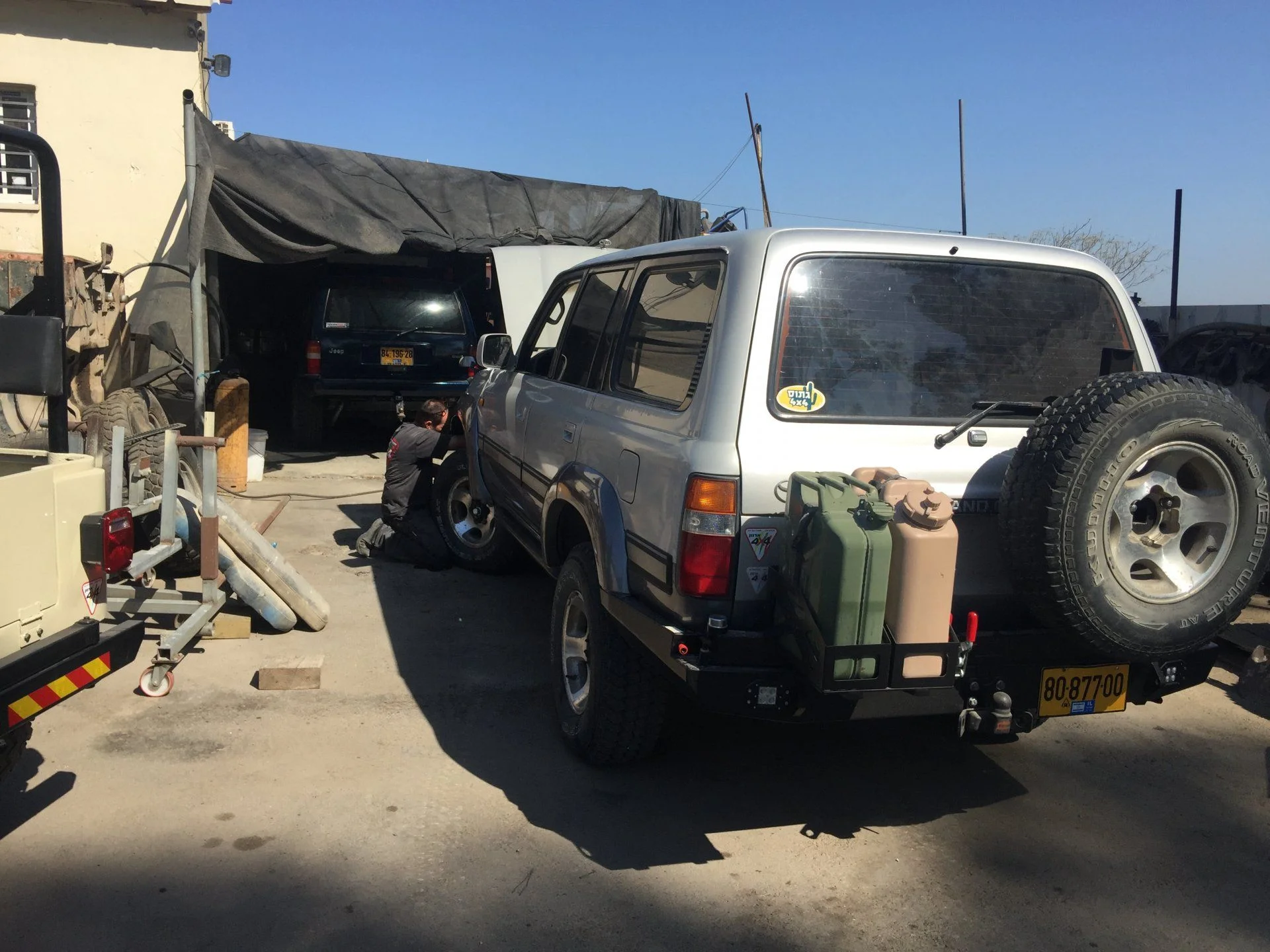

So this morning I took Pigi to Jeep Enemy territory going to rebuild the steering system that is dripping oil like a sieve

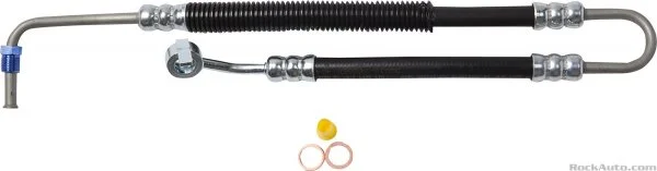

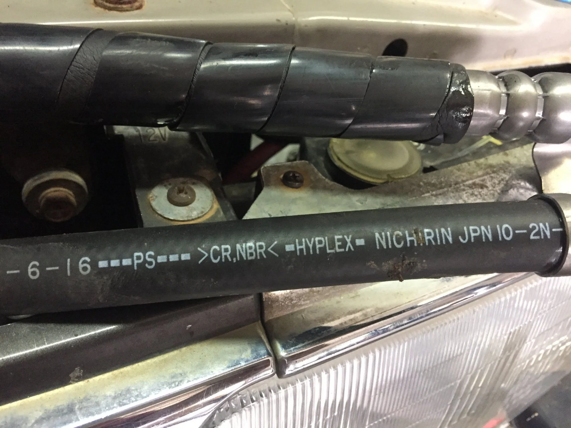

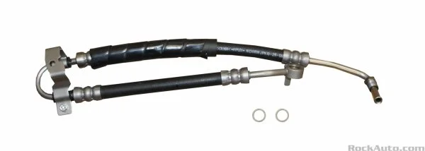

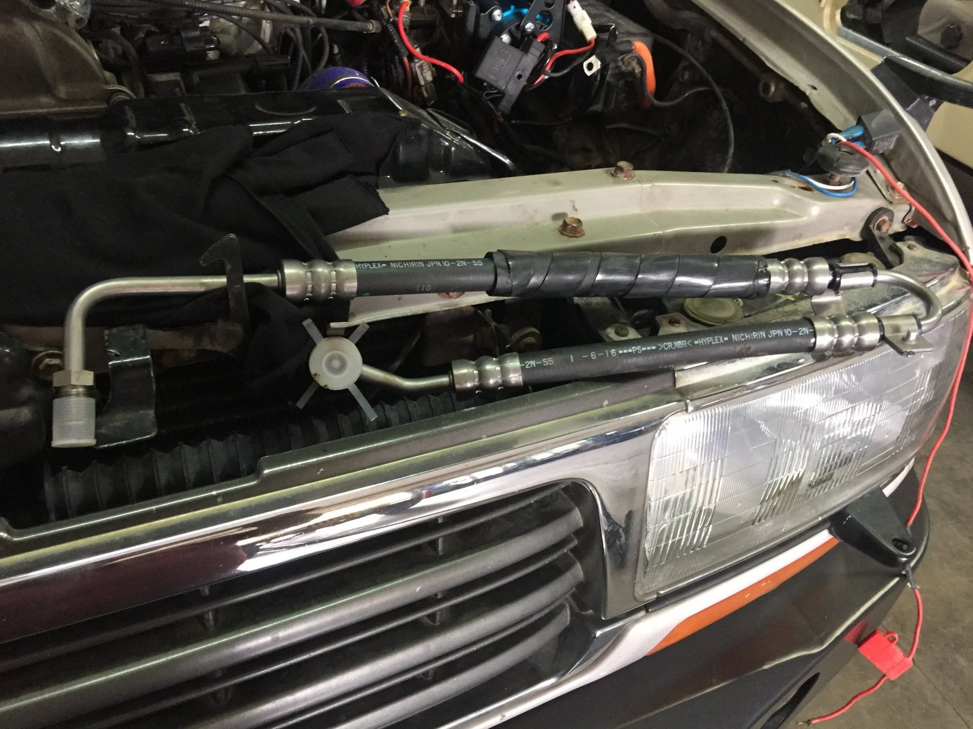

I ordered from all the steering hoses from Toyota except Gates Power Steering Pressure Hose
When the Gates hose arrived, I didn't want to install it it was poor quality I just left it for emergency and ordered a new one Rein® - Power Steering Pressure Hose made in japan heavy duty comes with the bracket needed for installation Gates come without
So if you need one don't bay Gates
PIGI got a wash and we will look for the leaks and change all hoses anyway
If it is from the pump or steering box they will be send to rebuild

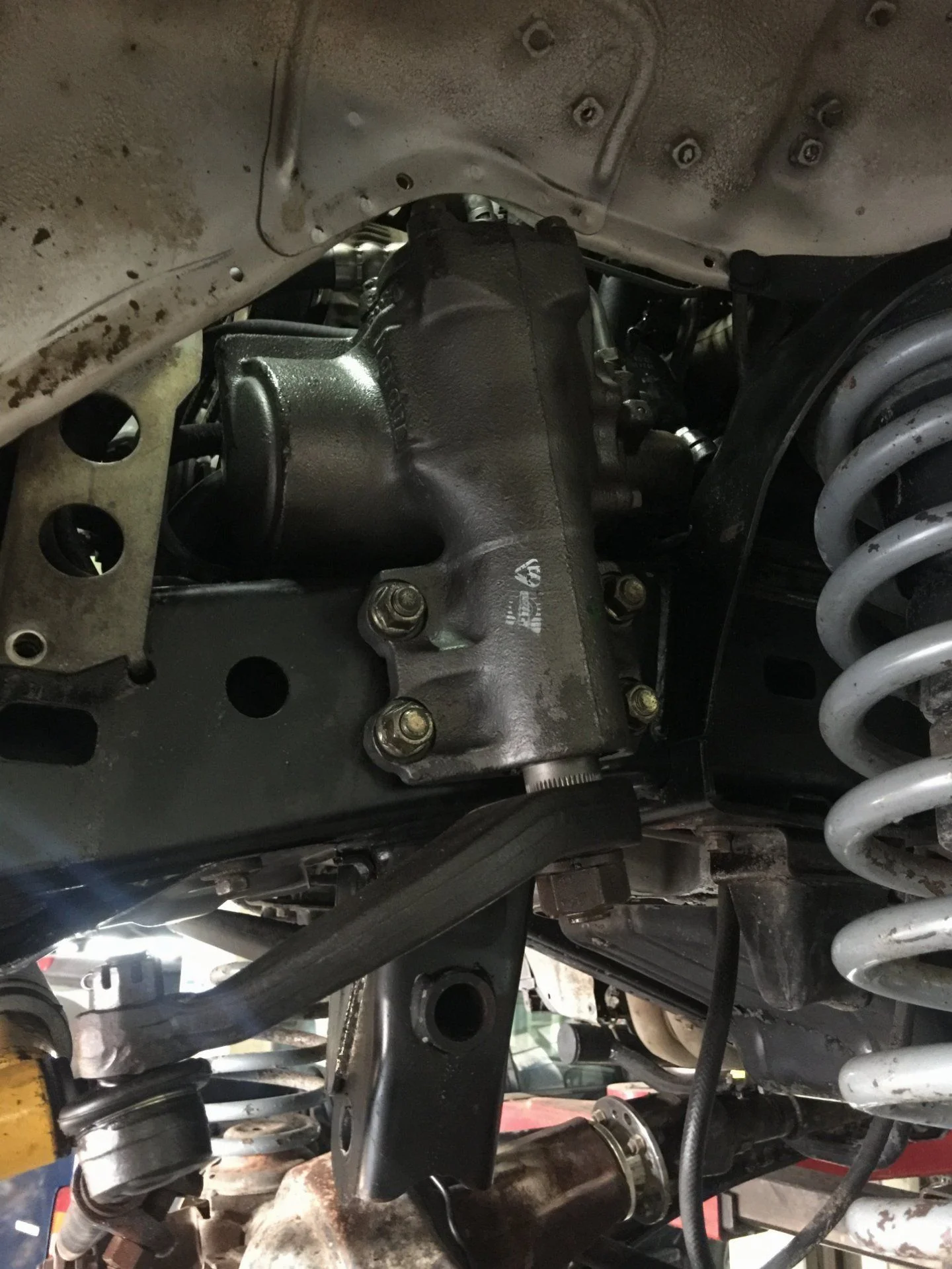

RTH the steering system like new. All hoses were changed the pump and box remanifectuerd. the only things left is the reservoir and the metal pipe cooler.

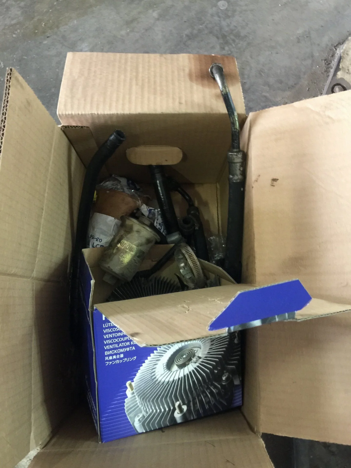

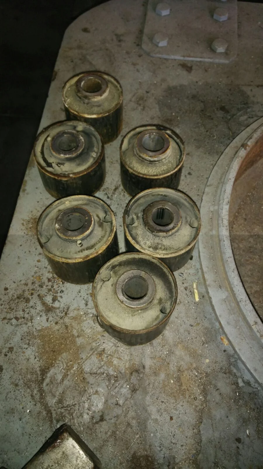

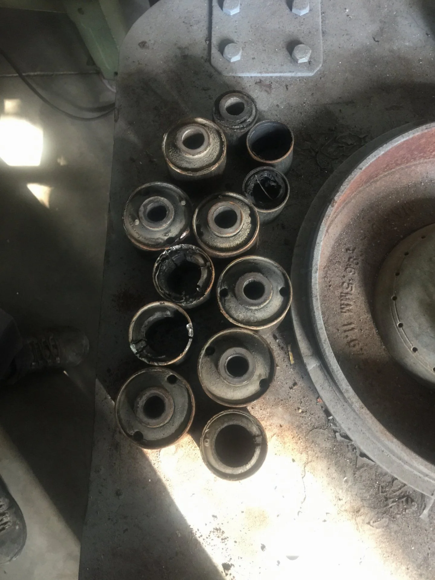

On the way I replaced the fan clutch (Aisin blue hub) and OEM fuel filter
The junk starts piling up when puling the FC I found out that the fan is not a Toyota but Isuzu reverses direction PO was a jerk I ordered the new Aisin fan from the USA could not find a fan for FZJ80 in Israel
