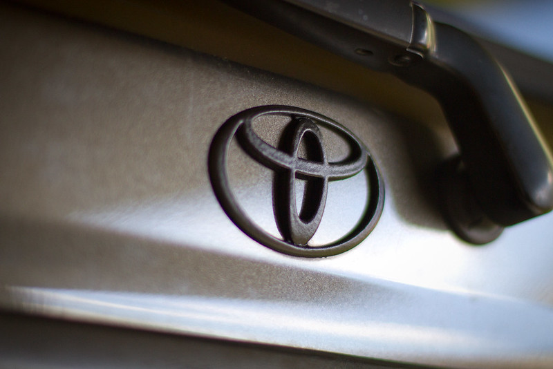

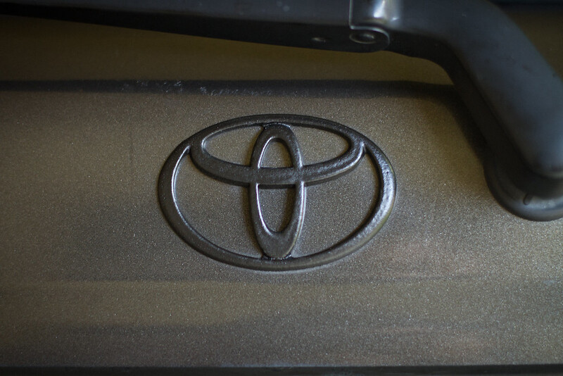

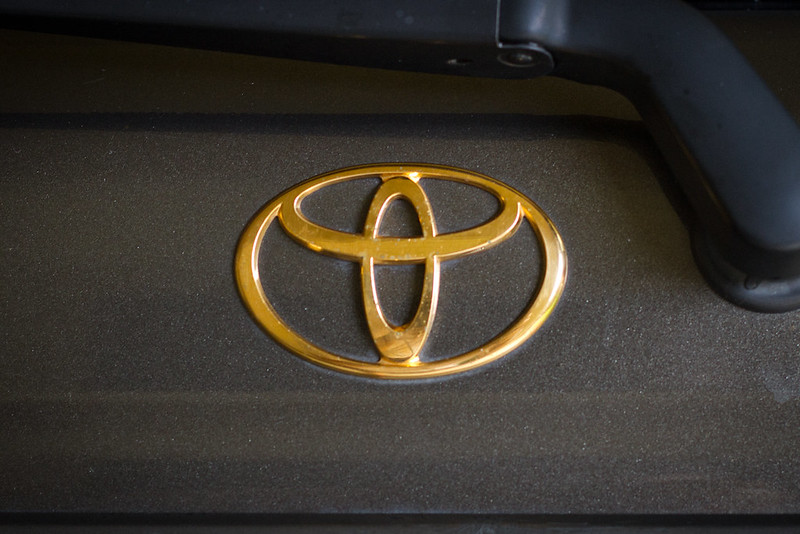

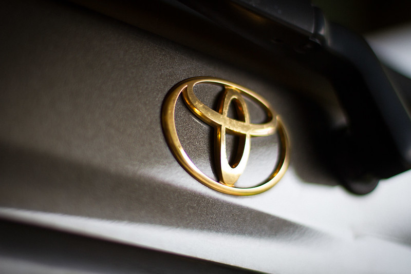

I've never been a huge fan of the gold emblems, although I don't think they look horrible on the Anthracite. I've been thinking about blacking them out and one of my friends had some extra Plasti Dip at the house, so I gave it a try today. I only did the Toyota sombrero on the back. I wish it had come out a little smoother. I don't know if that is just the product or user error. Either way, I like it and plan on doing the others.
Black emblems for the win! I love black/gray color schemes
plasti dip is crap in my opinion. it looks like crap, and peels off after a while and you have to peel all of it off and re-spray it. why not just use spray paint?
I've heard good and bad about Plasti Dip and understand its not a perm solution, but wanted to try it out for a few reasons... I could peel it off if I don't like it and I can spray it on without removing emblems. I like the black enough to eventually remove and do it right, but this will do for now.
