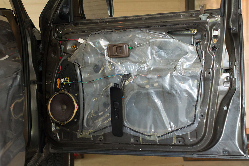

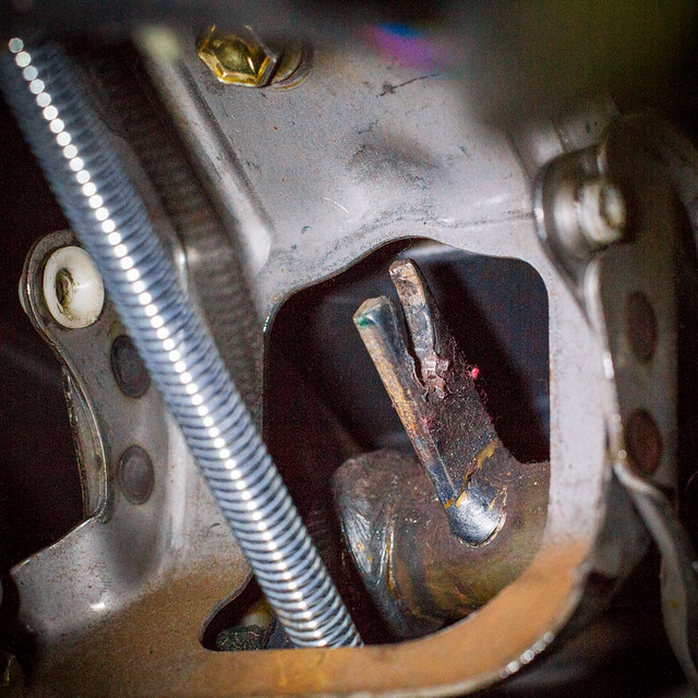

Fixed Door Handle
A couple weeks ago, my font passenger side exterior door handle stopped working. I've haven't had the time off to fix until this weekend. Being the novice that I am, I was pretty nervous removing the interior side panel from my door. However, it came off pretty easy and the problem was easy to fix. the metal bar that the handle pulls to open the door simply came dislodged from the backside of the handle and it popped back into place real easy. Here are two pics...
Here's what the door looks like with the panel off...
This is the functioning backside of the exterior handle...

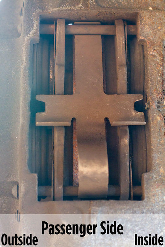

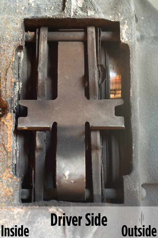

Question: Brakes
So, another thing I wanted to do this weekend is to replace my front brake pads and I was also assuming that I would be replacing the rotors. I had to pick up a new floor jack and jack stands, because my old ones weren't quite big enough. The GVWR for the '97 4Runner is around 5250 lbs., so I picked up a 4 ton jack and 6 ton stands. I went overboard for two reasons... Better to overcompensate than go too low and I needed the height of the larger jack stands.
Once I got it jacked and on stands, it was a major pain getting the wheels off. I figure it's been awhile. It's the first time I've removed them since buying it. After trying to muscle them off without pulling the 4Runner off it's stands, I was able to knock them off with a few swift kicks.
And I wasn't too happy with what I found. The brake pad that I had eyeballed on the outside driverside was worn as I had seen. Although way more uneven than I could tell with the wheel on. The pad on the backside was pretty thick. The passenger side wheel was similar, but the outside pad was not nearly as worn. Pics below...
So, do I change the pads and rotors (assuming the rotors can't be turned any further) and keep an eye on them? Or am I looking at a bigger problem, such as replacing calipers or something else? Feedback is appreciated, as always!
Rebuild or replace the calipers.
I've gotten calipers from Advanced (or pick whatever one you want) and they were like $60. Granted it was only 2 piston calipers for a Pontiac, but as its been said, just replace them. Can't see it costing you more than $150-200 for two front calipers if you just decide to replace both.

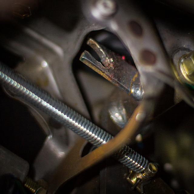

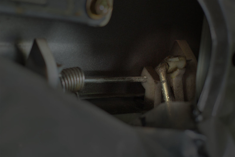

May 17, 2014 - Odometer 188051 - More Clutch Pedal Work

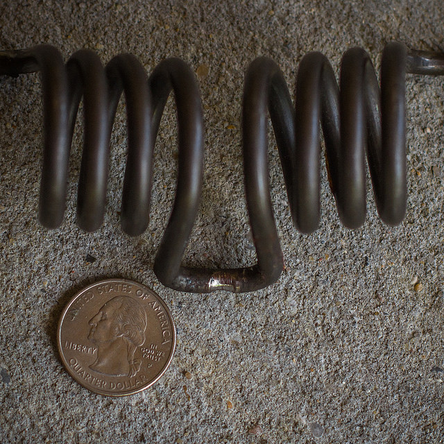

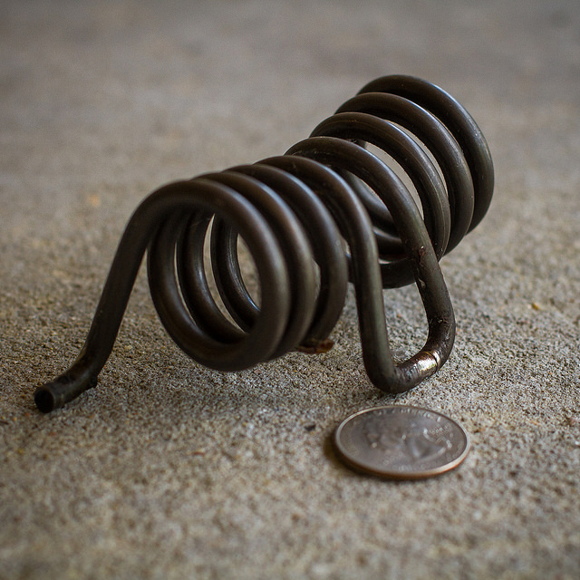

This past week, the clutch pedal took a major turn for the worst and it felt like the master and slave cylinders were going out again. I researched it, ordered parts online, and then found a bunch of great threads on T4R.org that led me to this great post on YotaTech about the clutch pedal return spring.
Apparently, many people have this problem and it revolves around the return spring design. There is a horrible, cheap plastic bushing that sits between the spring and pedal. Once the bushing breaks, the two metal parts start to beat each other up and once that is done, there’s no going back to the bushing. It can’t hold up to the extra stress that the two worn out parts put on it and breaks within days. At some point, the metal is so worn that it affects the functionality it was meant for and adds extra wear and tear to the master and slave, or at least it felt like it.
Finally, here are some pics…
As stated in the YotaTech post above, there is a simple, low-cost fix. Take out the compression spring and replace it with a small linear spring found at most hardware stores. The post suggests using a True Value Spring #70 or a Toyota Break Pedal Return Spring. I couldn’t find the #70 and purchased a one that appeared to be similar size and strength, True Value Spring #XXX (I’ll update this with the correct number, as soon as I find it again). You can see this spring in my photos above. The linear spring passes through the space where the compression spring used to be. There are places to mount the new linear spring, as if it were intended as the proper design in the first place.
The best part is that now the pedal works as intended and the clutch engagement feels great, too. So, the master and slave cylinders I ordered online (OEM), hopefully won’t have to be installed anytime soon. The fix was easy, fast and only cost me $5 at the hardware store.

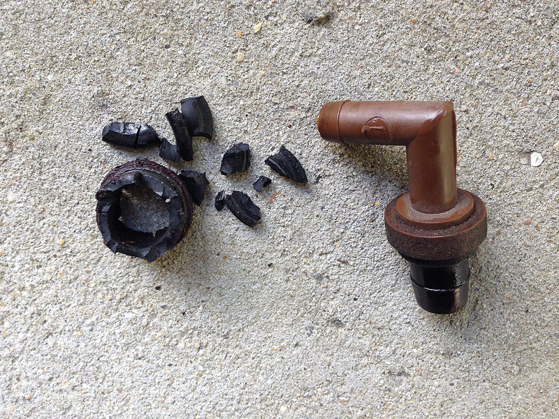

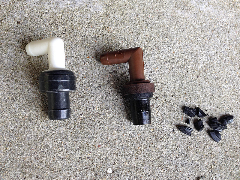

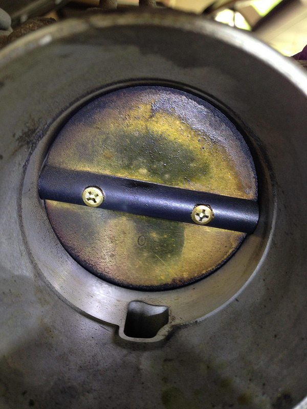

Haven't been driving the '97 T4R too much since getting the '02 T4R from my father-in-law, but I wanted to give it a little love today. I replaced the PCV valve with a Toyota valve and grommet (it had an aftermarket valve in it for who knows how long). That grommet was a PIA to remove. It was hard and brittle. I did my best not to drop little chunks of it in the hole, but had to suck a few chunks out with the shop vac before installing the new one.
Also cleaned the MAF sensor and the throttle body. MAF didn't appear too dirty, but sprayed it with some MAF cleaner anyway. Throttle body had a little buildup in it, but not enough to gunk it up. Sprayed it with some TB cleaner and scrubbed the funk out.

Old valve and what is left of the grommet.
Here is the Toyota valve (white) and the old one.
Throttle body.

Question: Brakes

Fixed Door Handle
Hi, thank you for all your pics and updates...I bought a 97 Runner for my daughter and I know nothing about cars or trucks/suv's...Im enjoying learning a few things. These sites with pics are very helpful! Her passenger door handle stopped working and so did her gas door opener. The door was a little yellow clip/holder I bought at the local Toy dealership. The gas door was luckily only a spring that had come off the inside that released the door to open. I took pics also and will have to load them. I haven't downloaded to computer yet. I'm not too good at all this stuff, but the little stuff is kind of fun, and I actually enjoy it! I really don't like how dirty the hands get from even doing this stuff, but I'm dealing with that too...found some wipes at the auto store that I just keep inside her Runner. Ok just wanted to thank everyone for this site and you, "Frey" for your updates and pics...it really does help!!
