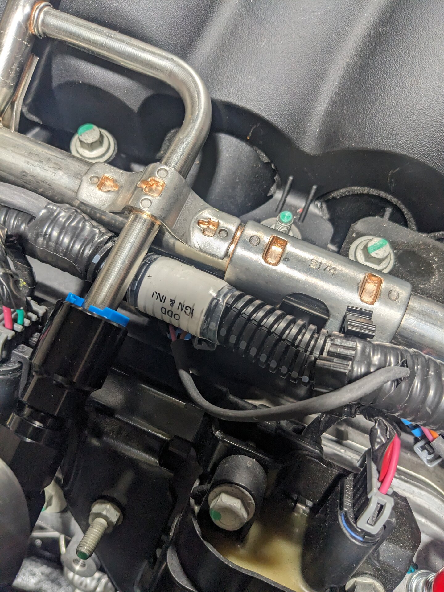

Wiring clean up and new wiring. 95% of our wiring is loomed, friction taped and 100% is crimped, shrinked and labeled.

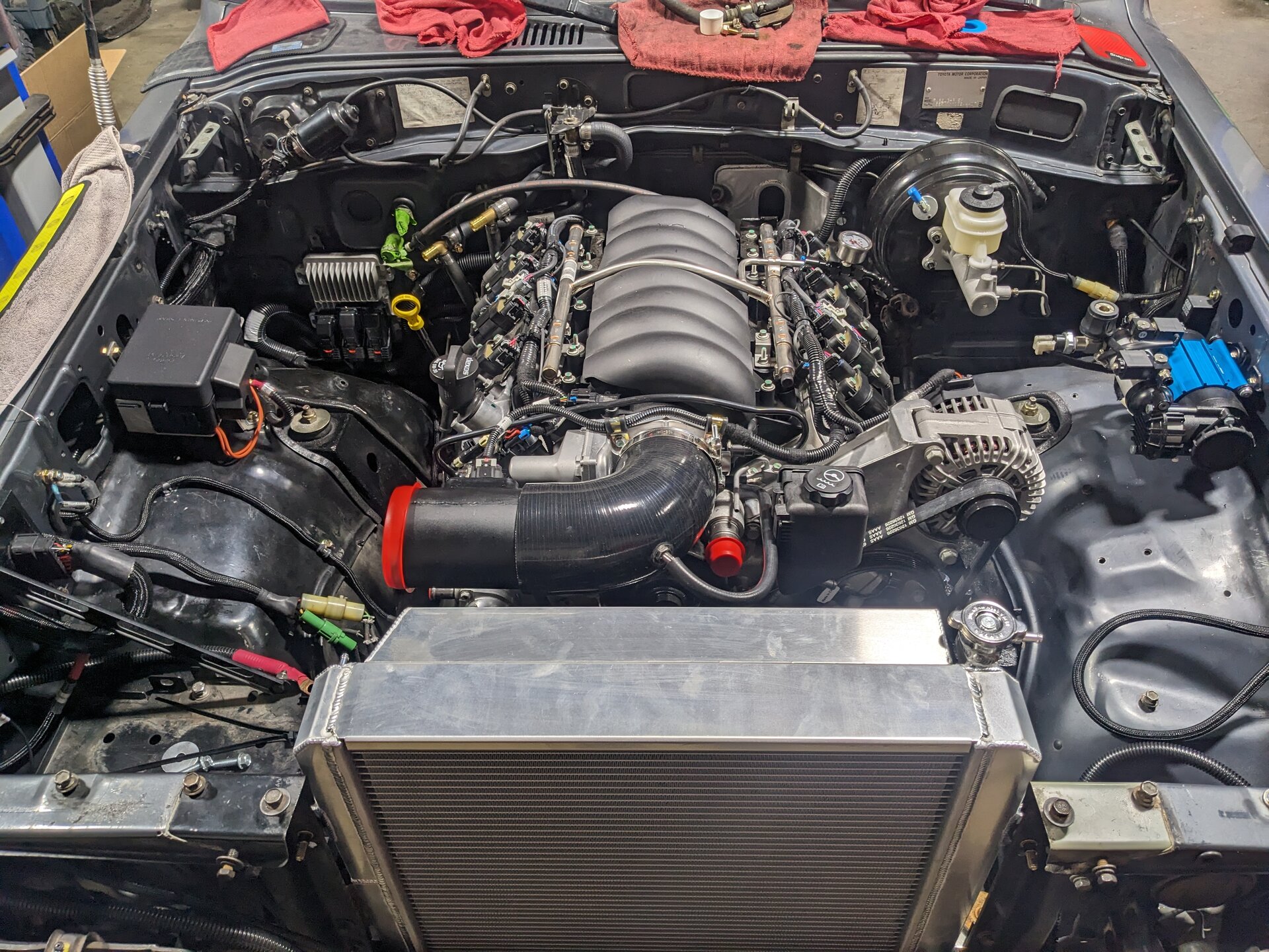

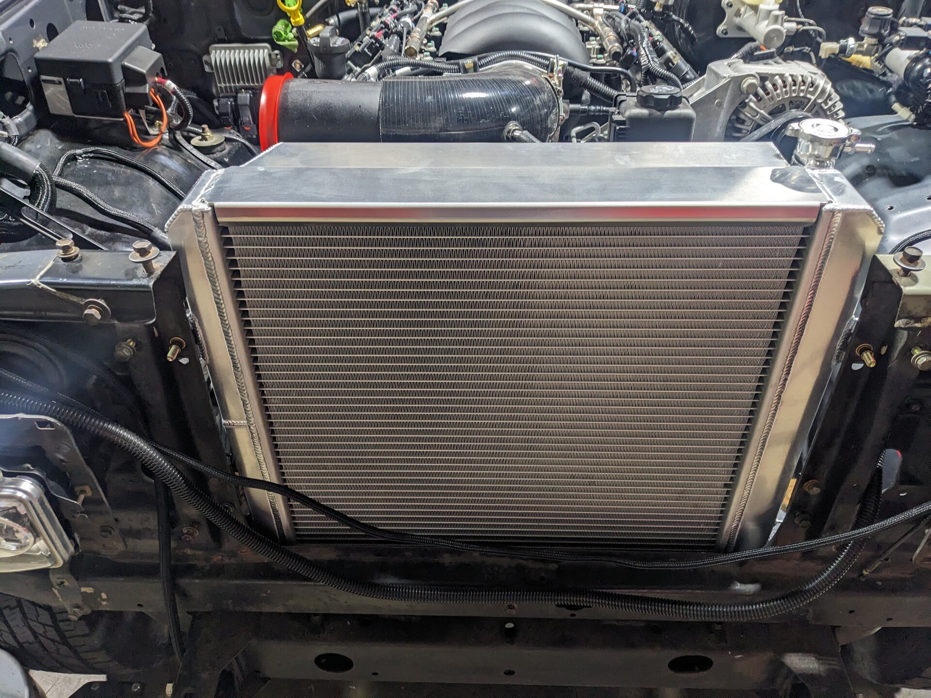

FSR radiator is in.

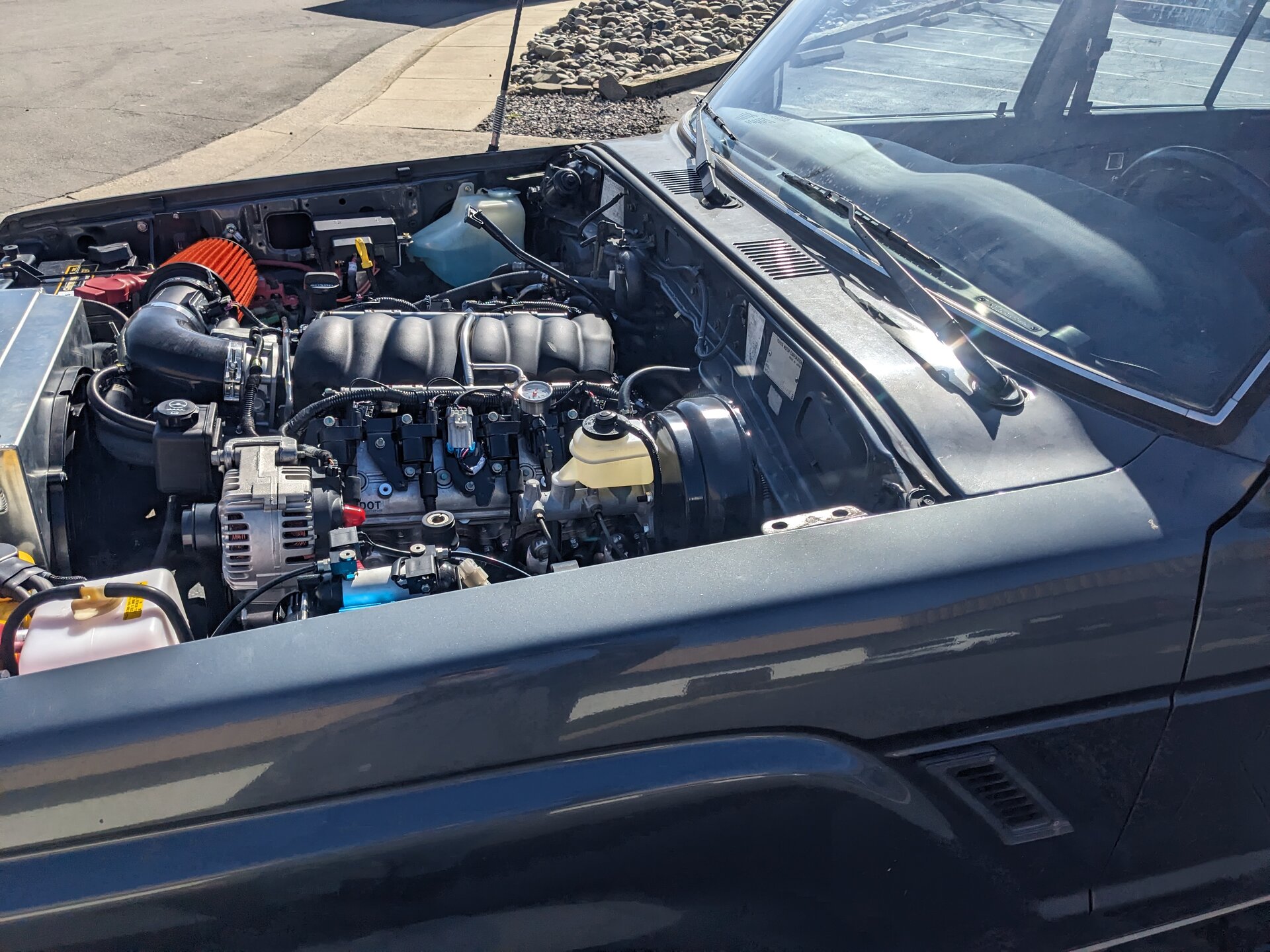

Getting ready to fire this beast up. Every system is checked prior to firing.
Cooling system - 2 hour pressure and vacuum test. Vacuum fill the cooling system to assure no air pockets.
Was hoping for a fire this afternoon, but Monday for sure.
