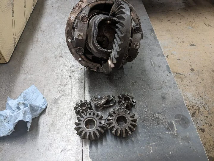

Gods of poverty blessed me! Can't believe the ring and pinion are perfect! Welder back up good for 2 more seasons hahaha. The plus side I found out how much it takes to break a welded diff . I have to say RVC 300m shafts are the s***!!.
Bet you were shaking that thing like a piggy bank to get all the pieces/parts out!!!! :rofl: Turn the heat up a lil more and burn em in again!! Love that rig, glad to see you kept it. :beer:

Have you ever damaged the ring gear or pinion? You just using 300m axles and welded stock diff?
No I haven't on this set ( cyro treated Yukons). The nitros I had i destroyed them in 1 season ft and rear . This was a freak accident that the welded diff even broke. I snapped my pass side motor mount bolts . the engine fell down pushing my slave cyl into my drive shaft making it impossiable to depress the clutch. at the same time it pulled my throttle cable damn near wide open. I got both ft tires in the air and slammed them into an undercut Then I experienced a frt diff RUD (rapid unscheduled disassembly)

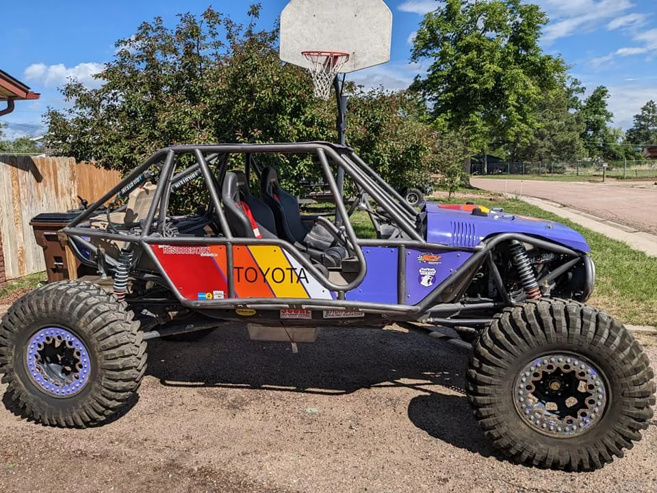

Well,, Raisin Hell 2 is up for sale again. After a few joyriders let me just say if you have a mental problem, bad back, weak knees, bad eyesight or just have small balls and your wife keeps them in a jar in her purse ( If so permission slip signed by her stating you're allowed to spend 30k required before test drive) . THIS BUGGY IS NOT FOR YOU! Perhaps a jeep and roof top tent would be a better choice. Don’t waste our time. Come prepared to buy the buggy, Don’t show up in your smart car. Sure you can buy a pounded into the dirt Buggy for 25k and spend your weekends watching others wheel while yours is broken. Highly modified f toy chassis # 092 This is a turn key proven buggy. It has ran some of the most difficult trails in Co and Utah It is the perfect balance of rock crawler and trail rig. with enough room to throw all our gear in and be comfortable.. It is built for someone 6ft or more. seat can be moved for someone smaller. This is a 100% Toyota DNA rig. Colorado vin# and Clear title Frt axle 1991 semi float rear axle cut down with 1995 balls welded on. hellfire knuckles 1995 landcruiser brakes with upgraded green pads.RCV 300m axles with chromoly drive slugs held in with arp studs. 529 yukon cyro treated gear with a welded spool. Custom made heavy duty truss. 3/8 thick mohawk diff cover. TG full hydro steering. Rear axle 1995 landcruiser full float. cyro treated oem axles held on with arp studs.landcruiser disk brakes. 529 yukon cyro treated gear with a welded spool. Custom made heavy duty truss. drive train Bullet proofed 22re mild cam. modified oiling holes . LCE header 2.5 flow master exhaust. Professionally built in 2021. less than 1000 miles on it. w56 5 speed tranny. dual cases with rear being 4/7 both cases built with cyro treated marlin parts. Tom woods drive shafts. Suspension 2x 16 bilstien coilovers with 2 inch bilstien bump stops Interior carobeu suspension seats , brand new 5 point harness's, floors and fire wall removable for easy service work. Coated in dune beige vortex liner. custom made 25 gal fuel cell with a hyperfuel in tank pump. anti leak roll over venting.Custom made basket to carry gear. Lighting rock lights on all wheels. 2 interior lights. 2 frt high intensity pod lights . 2 rear high intensity pod lights. 7 inch round frt driving lights. lighted whip and purple accent lighting . Wheel tires 4 17 inch pro comp with crawl works machine bead locks and anti cone rings, 40 inch dot Treps no patches or plugs 75% tread. 1 17 pro comp wheel non beadlock with 40 inch trep radial for spare. body all panels removable Fj 45 hood and bezel. This is a super reliable buggy . It will go anywhere when asked nicely. All last season I only broke a radiator cap. Only the best parts were bought or hand fabricated for this rig. Other than some rock rash it is a perfect rig. Comes with more spare parts than I can list Spare parts.(big stuff) core engine 3 trannys 1 top shift t case a bunch of t case parts, RCV frt axles and birfs not 300m spare oem rear axles spare 3rd 529 nitro gears with a welded spool brakes for all 4 corners clutches Radiator and fan I am sure I am missing alot. I built this over a 3 yr span so there is no question about it I cant or wont answer. . $30k Located in colorado springs

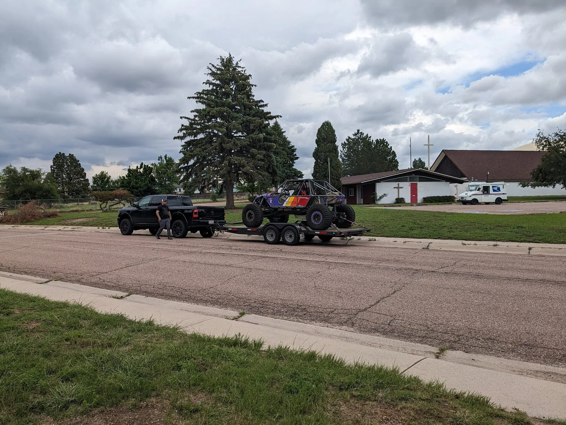

The last Pictures of my journey with this buggy. It went to a good home. What a love hate experience this has been . I suggest everyone try it at least once. I'm going full retard Just bought a RTT for the 80 I'm going overlander! Now I need to learn how to vape hahaha

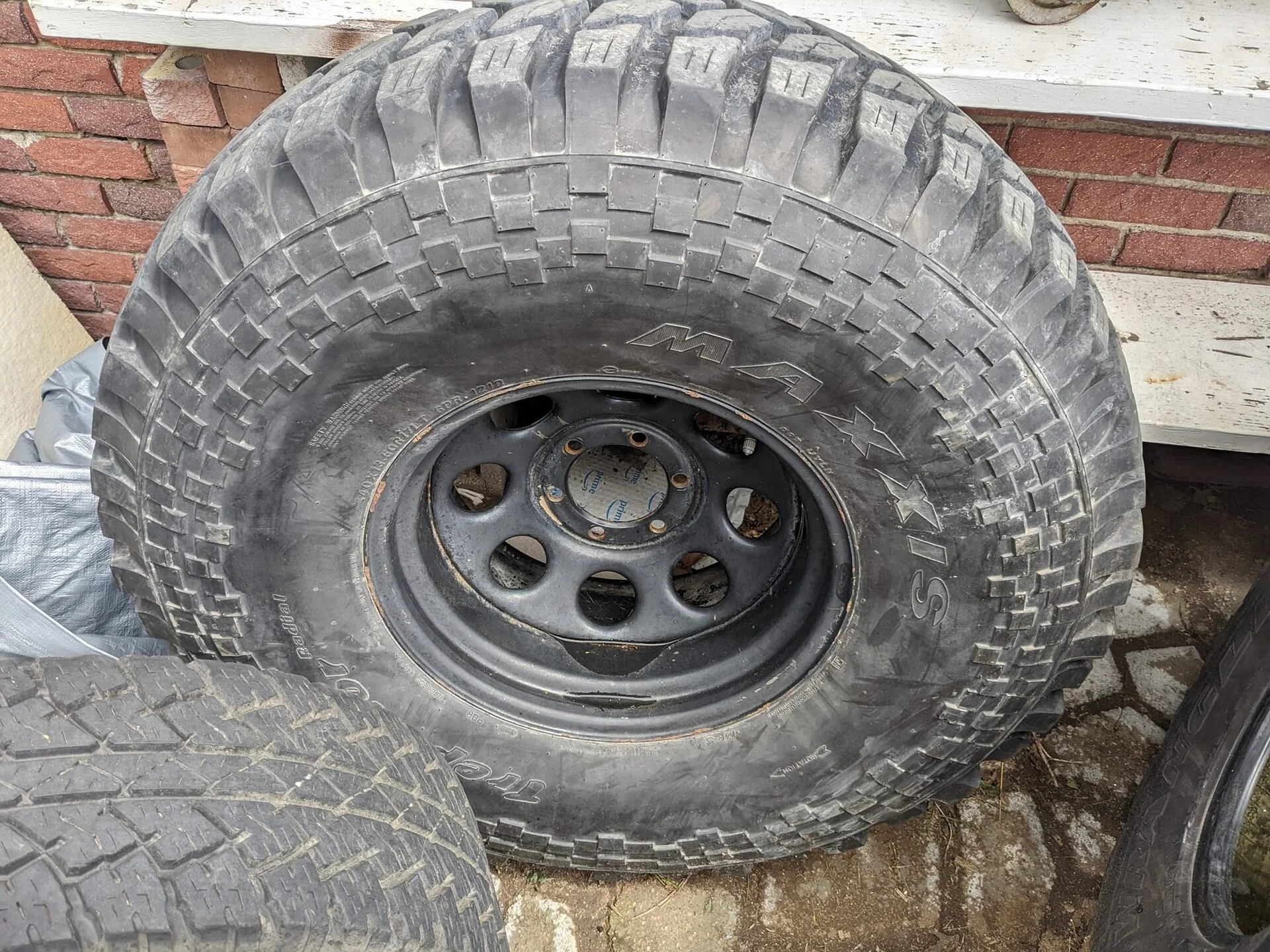

@Broski Guy didn't want my spare . You need spare for your rig ? 40 inch radial trep it might have 100 miles on it its on a pro-comp rim (non bead lock) Im thinking 3.5 back spacing fits an 80 perfect. $500 I can bring it to SAS
Looking forward to seeing you at SAS !
It’s going to be good times.
Thanks for the offer but I have two spares already, one mounted one unmounted both like new 😉
