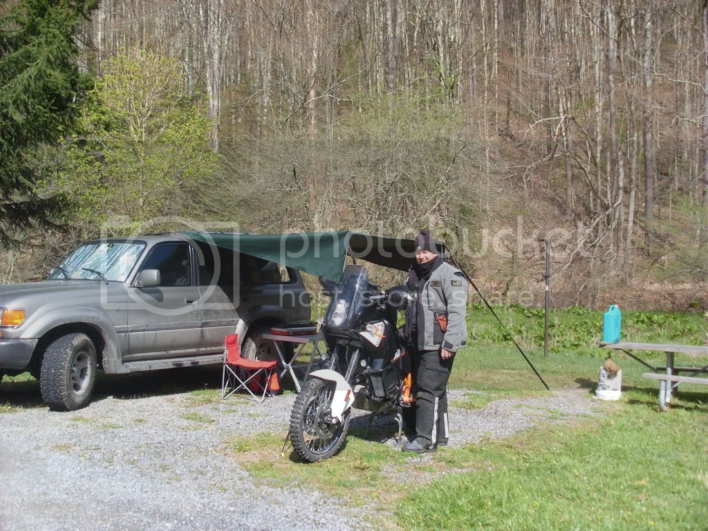

Quick update...
I have 5 nights sleeping with this setup under my belt... all in all it works really well....
My German Shepherd sleeps next to me on the floor of the truck and the platform provides ample space...
I added a camping awning for rainy days and have enjoyed the ability to duck under the rain....
Simple and effective.
