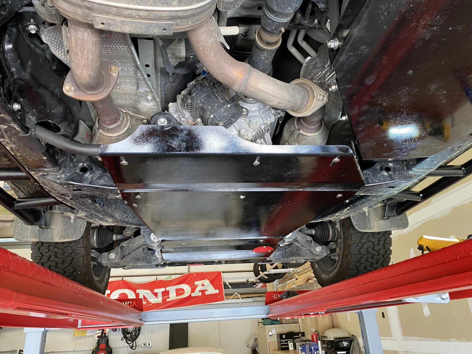

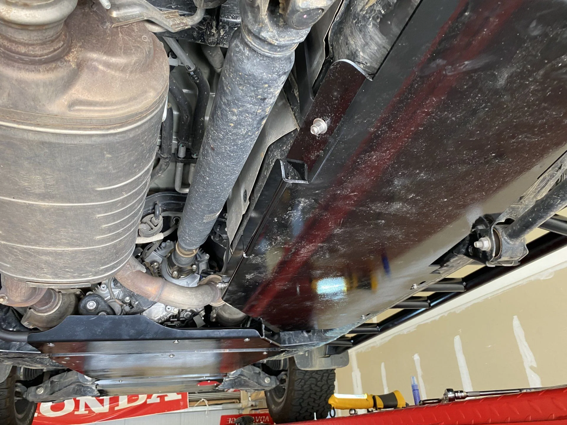

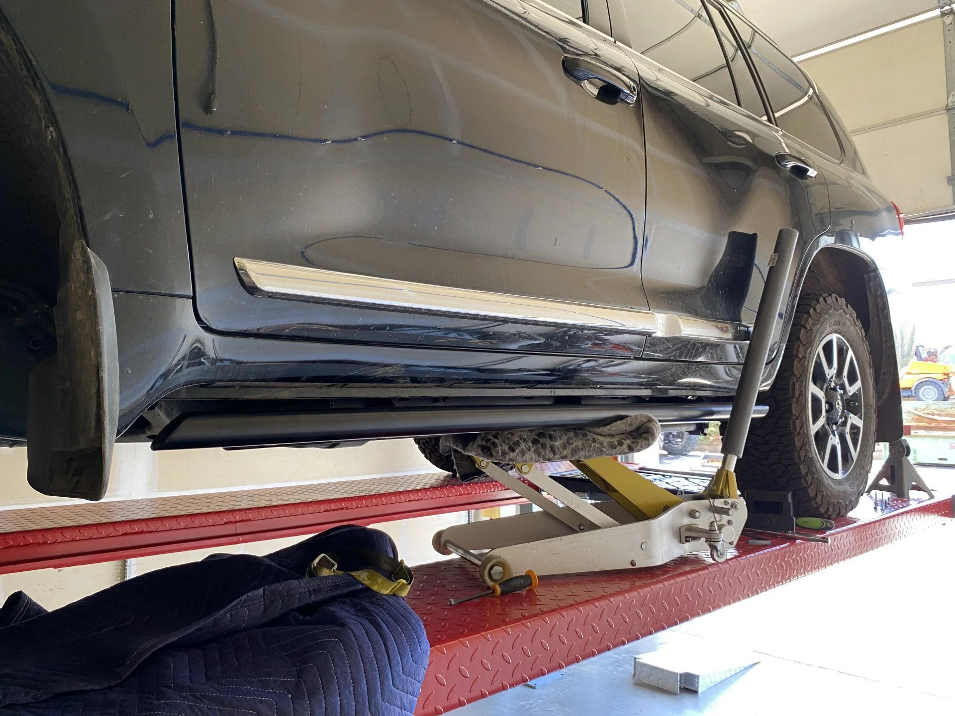

Just finished ours up yesterday. Huge thanks to @afgman786 and @CharlieS for the insight and write ups. For anyone that’s curious, this turned out to be about a 3 1/2 hour job for me by myself for the stage 4 aluminum. I have jack stands as well as ramps, but just chose to do it on the ground. I only used a floor jack to lower and raise the gas tank skids. Honestly, it couldn’t have gone smoother.

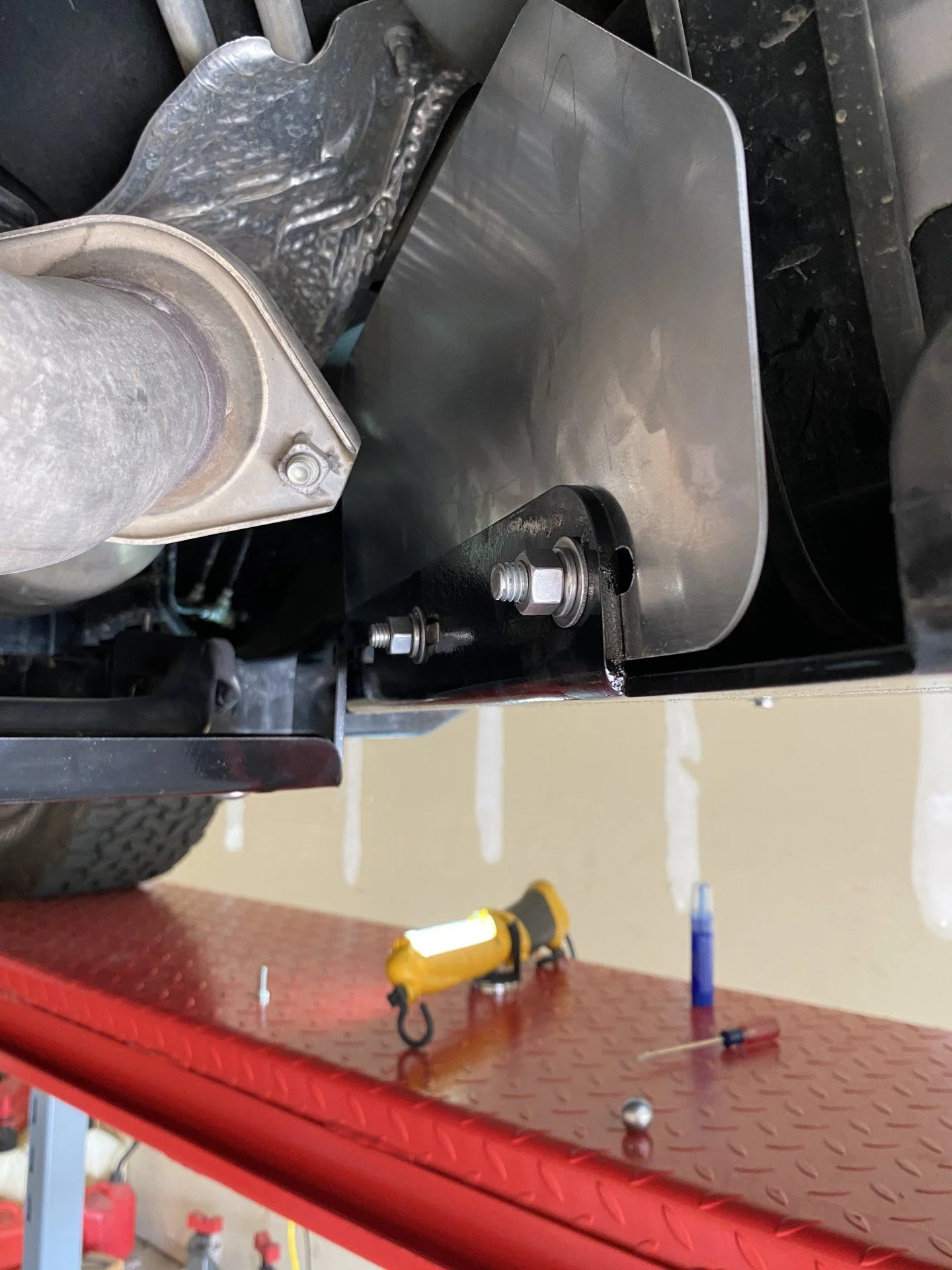

I spent about 15 minutes playing with the heat shield on the inside and outside of the tank skid and landed on the outside. I like the aesthetics better on the inside, but the outside provides a little bigger air gap between the shield and the tank.

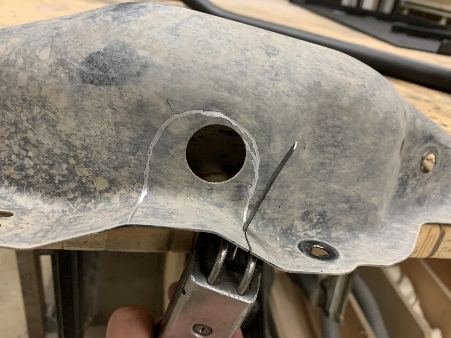

I really don’t think I have much to add, other than how I trimmed the front factory heat shield. I used an air saw . You can pick them up at harbor freight for about $20 and honestly it’s one of the best purchases you can make for a do it yourselfer. It’s about a five minute job with the air saw.

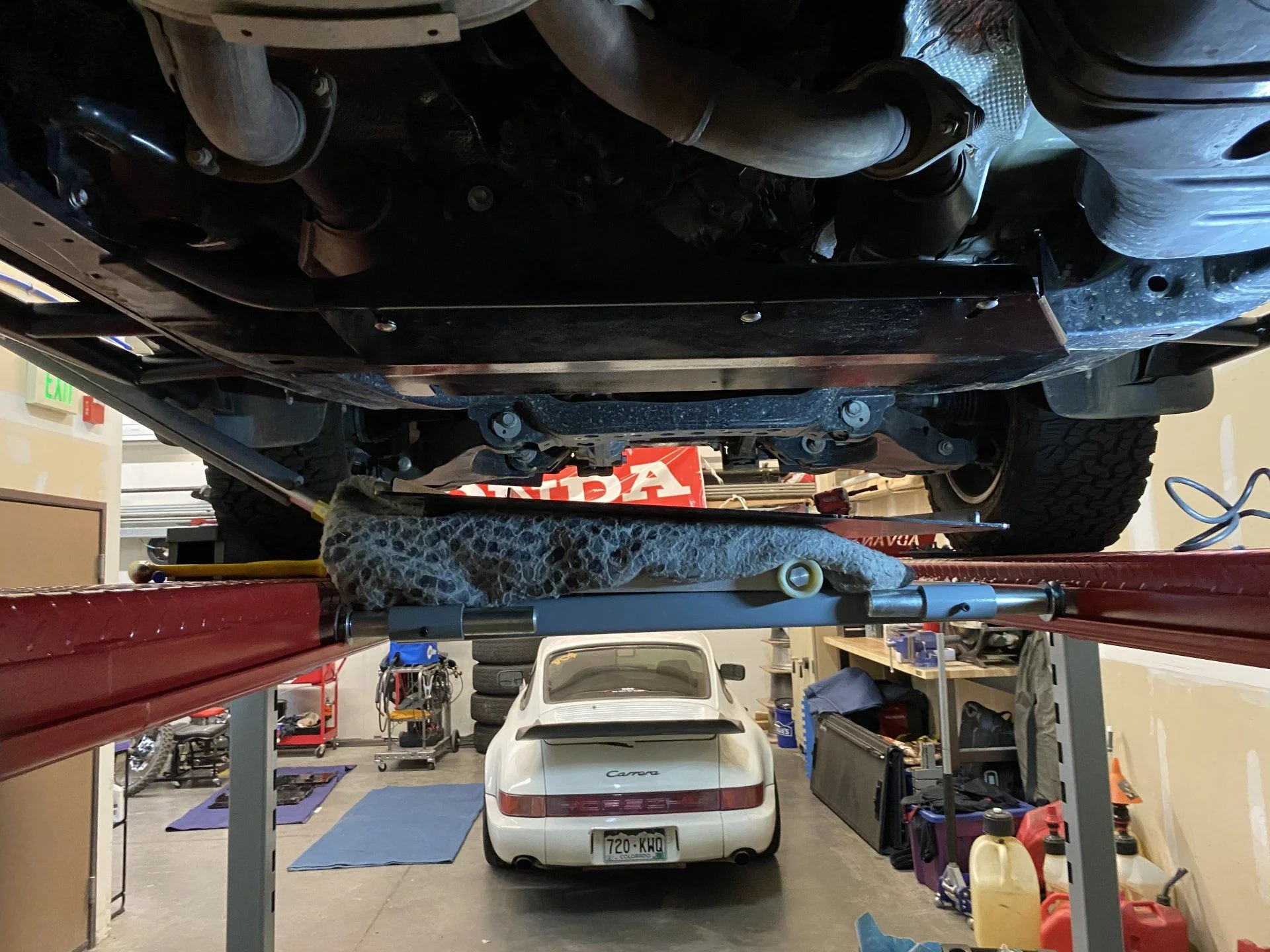

It’s just a crappy harbor freight motorcycle lift jack. the 4 post is an advantage 9k that i can lift my F350 with (or put under the cars....)
Yes, it’s my personal shop. FWIW, really appreciate the build of Buds / Robs work.
