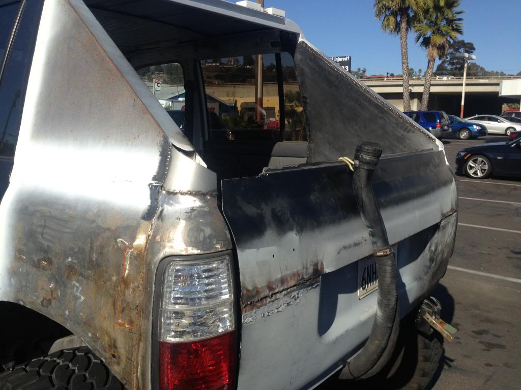

Doing some work today.
Filled the gap left from the roof cut with a piece of the old roof. I made a small lip that I plan on installing a led strip for a third brake light, or possibly a reverse light , if I end up ditching the factory lenses. Not sure ill do anything with it, but its there just in case. Still have some holes and gaps to take care of, and then probably smooth everything out with some light bondo.
Now working on finishing off the rear of the wheel wells that I had to cut off for the bob. Couple people asked about the square wheel wells. i decided to make them flat instead of an arch so the space on top would be usable. I'd like to install some old ammo boxes on top, or find some tool boxes that will fit, for storage.

I'm guessing it'll get cut off when you make the truck even shorter :)
Maybe I missed it but what are you doing about the fuel filler, now you've cut the hatch off?

Thanks! That's on my list. Right now its looking like I'm going to run it up through the floor right near the tailgate, and up and over the wheel well. Attach it to a flush mount fuel filler. It will take up just a bit of cargo space, but I'd rather do that than run it inside the well.

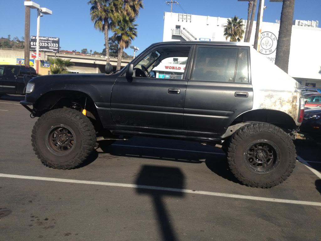

Sorry it took so long. Snapped a couple at work today. Crappy photos, but you get the idea. Still lots of metalwork to do to get everything solid and fairly decent looking.

This is one of those builds that really makes me think about doing a bob, especially since every time I go wheeling the a** end of my 80 takes a little more abuse, looking pretty tough ! I like what you did on the rear, different than the others (not that bob-jobs are all that common !). Nice work !:beer:

Here ya go. Looks pretty messy since everything is different colors and filthy. I'm going to fill all the holes that I'm not using and bedline the whole inside up to under the front seats. That will cover all the pinholes and not so prefect welds, and clean things up quite a bit.
