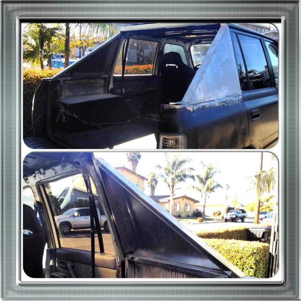

That's going to be sick. Are you going to run Lexan for the back "glass?"
I was contemplating getting a thick piece of lexan and drilling it for bolts. Then I could make the entire back one big window, and it would be removable. My other thought is screwing snaps into the rails, tailgate, and roofline, and getting a vinyl cover made with a window sewn in.even another idea is to install a piano hinge along the roof line and building a big rear hatch that could open up.
Now that I have the sunroof out, I'm debating just cutting the whole center of roof out all the way back, to get rid if the structural ridges, and welding new sheet across the roof to make it flat and close the sunroof at the same time... If that makes sense. Nothing I do is going to look factory, and I'm not too worried about it being ugly. It is the frankencruiser.
Anyway, it isn't supposed to rain for a while, so I'm going to ponder things a bit more.
Loving the "fastback" ... and while the snap off canvas top thing seems cool, I don't know if I could live with the lack of security. Maybe I'm paranoid. I bet if you were able to fab the "piano hinge" thing, you could make an interchangeable frame with snaps that would let you run something more secure (metal frame, Lexan window) most of the time... and swap it out for a canvas back when you don't need to worry about security?
Yeah. The more I think about it, the more I'm leaning toward something solid. I have nothing of value in the cruiser at the moment. But eventually I'd like a good GPS, and a decent stereo. Plus it would be nice to be able to leave my tools in the rig parked somewhere, and not worry about it.
