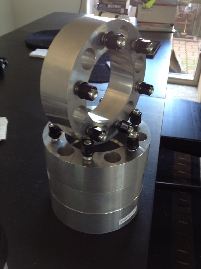

And my spacers came in while I was gone:

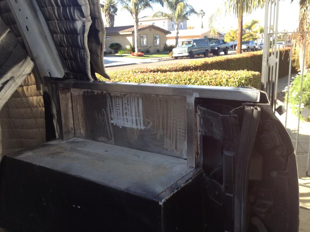

Rear end version 3.0 in the works. For some reason using MIG is all of a sudden not working. The welds are full of bubbles. Tried adjusting settings, cleaning the metal, changing tips, but to no avail. Next step is to pull the hose and gun apart and check all the O rings. Just haven't done it yet because I needed to get the truck put together enough to drive to work. So for now I'm using fluxcore. Which means lots of popcorn and plenty of flapper disk work.

How they will sit and form the new bed rails:
Check that your nozzle is not pulled out too far. If it is it will suck air (ask me how I know!).
Can tou clarify what you mean by "pulled out too far?" You mean like the nozzle isn't seated all the way down on the gun? If so, its definitely seated. I just changed it.
