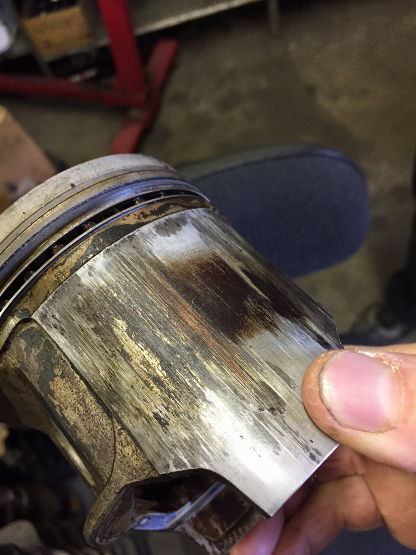

Currently the motor is out to the local machine shop for a total rebuild. I was able to rebuild the t-case, and tonight was working on finishing up the rebuild on the transmission.
Here's a few photos of the motor from the machine shop. Hopefully it will be ready for pick up this week.

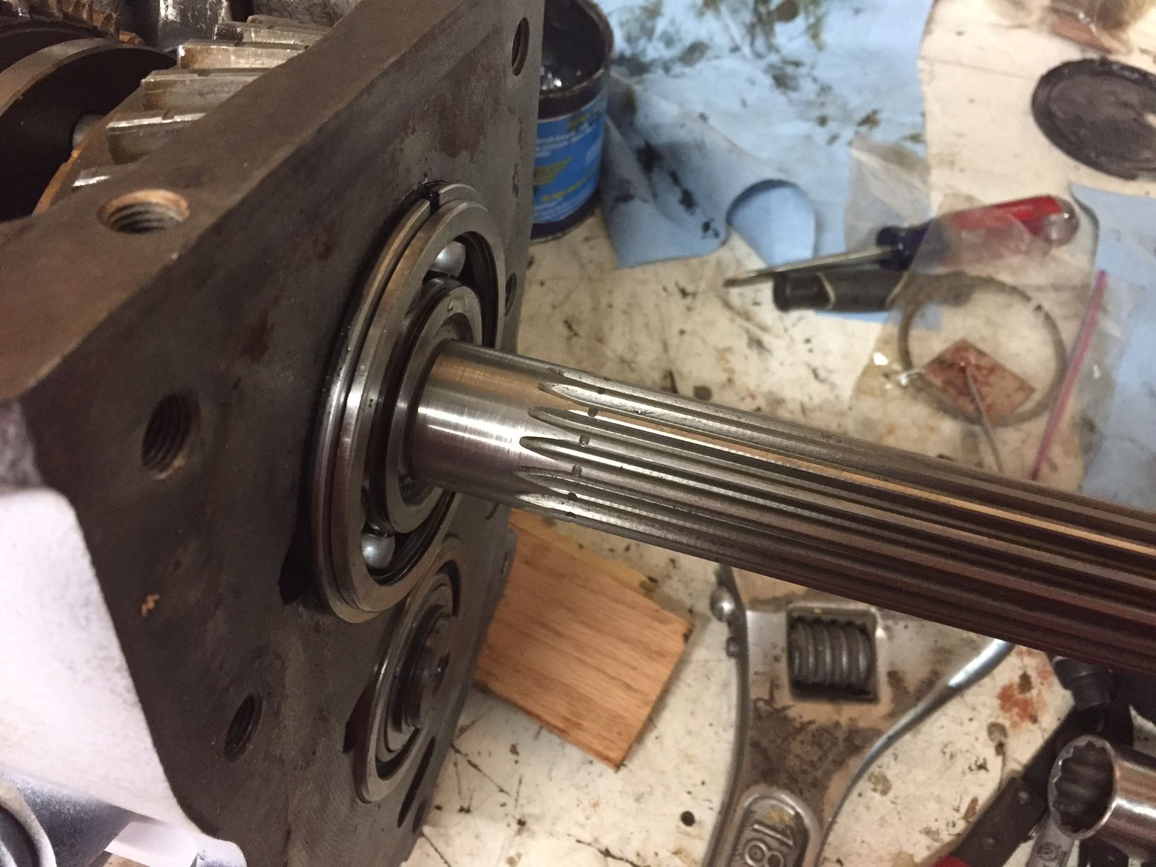

1. I feel like i've seated the rear output bearing as far onto the shaft as possible using my stand it up and support the input side and wack it method as well as my rig-a-ma-jig SST. However, the output bearing with the output shaft inside of it will 'walk' back and forth .075. The bearing is not a press fit into the house at all...(when i took it apart no tools were needed as the bearing just pulled out) Once I put the Rear Bearing Retainer, will this limit this movement? Is this movement OK?
2. On the input side, it looks as if the snap ring isn't flush with the case, should I 'give it a wack' and push it on further? See the last photo for this question.

My gut tells me it's normal, but I would wait until others chime in. As far as the motor, consider having delta cams grind you a little better profile cam for the 2f while u have it apart. It's not much money to have done. Also seriously consider installing rear disc brakes. It will make it a safer and more enjoyable driving rig. Other than that I think your well on your way to having a nice 40.

All the play in the transmission goes away once the covers are bolted on but I don't want to have any issues.
Anyone rebuild a few of these experience the play in the output shaft and the gap in the input bearing?

On the input shaft, your retainer ought to keep it from walking back and forth. Is there a lot of slop there? Might try taking a center punch and hammer to the inside surface where the bearing sits to tighten it up. Probably going to get slammed for that, beats the hell out of buying a new case or spending money.
there wasn't much 'slop' side to side at all, the output shaft (along with bearing) simply would walk .075 in and out. I put the covers on w/ some new gaskets and some Right Stuff, now there isn't any 'in and out' walking...

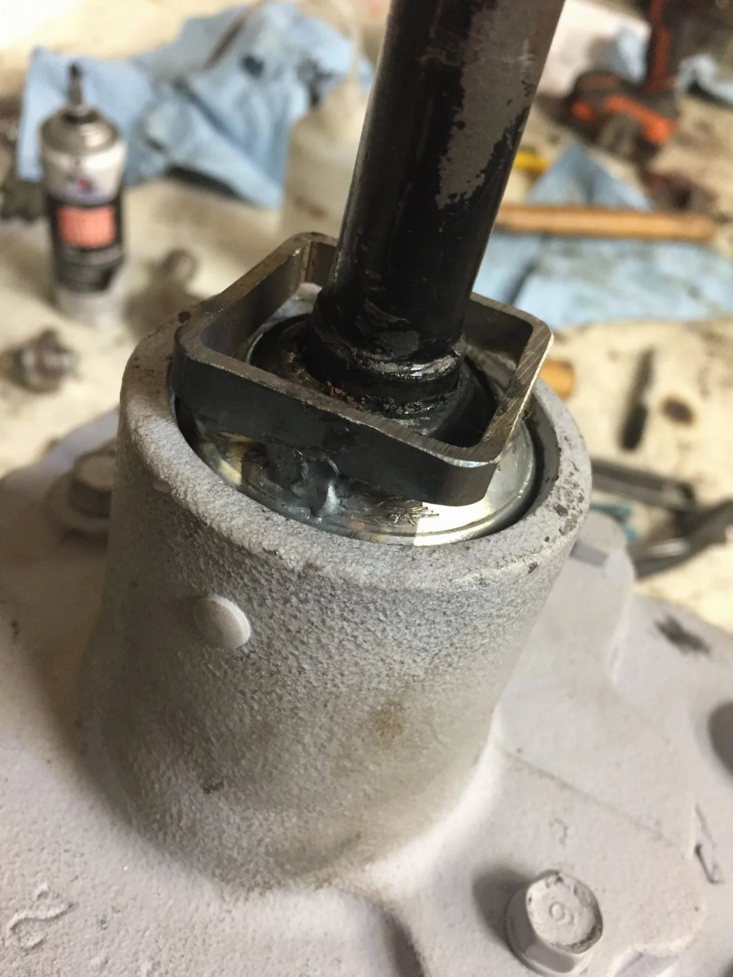

I got sick of fighting the shift lever spring with channel locks etc so I tigged a small piece of square tube on to the collar for something to grab on to. Works pretty good.
