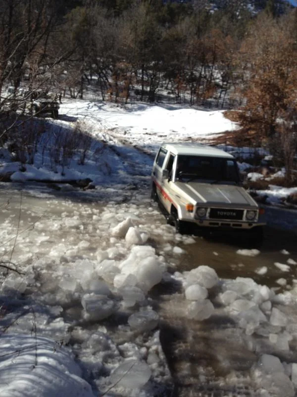

Went on an impromptu snow run up to the Jemez with some buddies from work today. Took 376 to 608... didn't make it thru the stream crossing - broken birfield. winched the truck out of the stream and headed home. More later when I pull it apart...

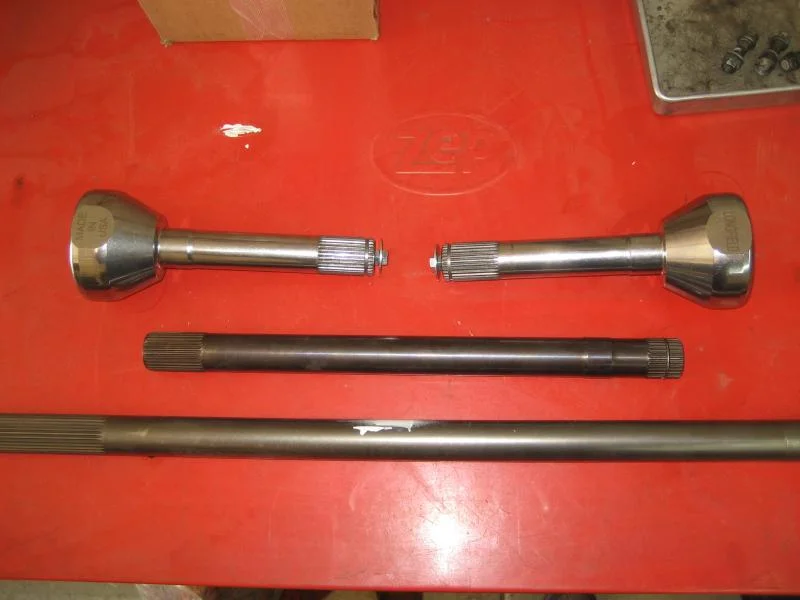

10 months later... its alive! Axles and birfs upgraded to Bobby long's 30 spline, and of course marlin inner seals.

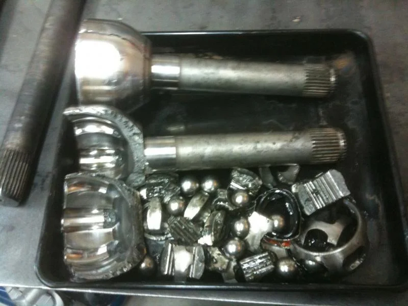

In the river!
One exploded and the other one cracked!
Beefy!
Install went smoothly, the 70 series,or at least this one, has the same size axles as the 40 series - so all that needed to be ordered was Bobby's axle set with the long side having long splines. :) There was some collateral damage: spindle bushing, inner seals and some disfigured metal. All cleaned up and new or replacement parts went in. Thanks Beno for the spindles - worked perfectly!
