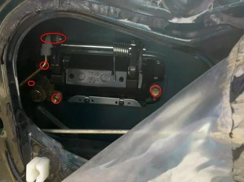

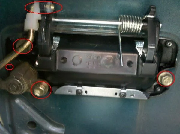

I was on a snow camping trip this past weekend and happened to catch my drivers side door handle at an awkward angle. The plastic handle snapped. Here's a rough guide on replacement.
Once you have the inner door covering off. Peal back the plastic water barrier from the tar and metal door to expose where the handle is from the inside. I've marked with circles the places where you need to either unscrew, unbolt, or slide a metal piece out.
The top circle is the part where it slides out of the plastic piece. That controls the handle from the outside. The other 3 circles that are roughly the same size are bolts that need to be taken out. And the smallest circle is a screw that can be unscrewed slightly to allow the lock mechanism to rotate clockwise and detach from the handle. That screw doesn't need to come all the way out though.
Once you've gone that far, the install is just in reverse. Good luck.

In the picture shown below:
You have to pop the white plastic away from the gold shaft, then slide the shaft away and out if the handle. I'm talking about the top left corner. Good write up.

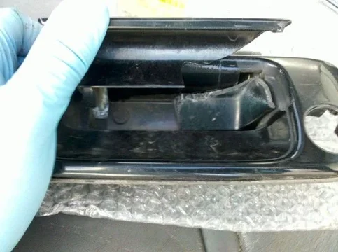

JB Weld has poor strength for this sort of prying action. Maybe with a wire mesh embedded in it.
cruiserparts.net quotes used front left outer door handles at $55.
I found one in mediocre (scratched) condition at a local junk yard for $35.
Yup, they're the one's I just spoke to on the phone. web page says $35, but over the phone they gave me $104... :confused:
Either way, I figured if I could repair for... nothing vs $$$... Why not give it a try?
Still, I was hoping someone could say whether it'd worked for them or not.
In fact, the break looks EXACTLY like the one in the posted pic.

My driver's door handle developed a crack that felt like it was going to pull apart so I used Locite two-part epoxy for plastic to glue it back together. There is a gasket that fits between the door skin and the handle which on my truck was hard from age, don't know if that gasket is available as a separate part or if it comes with a new handle??

Wish I had seen this first, my FJ 62 is very similar. They have new plastic similar to yours that goes over the rod. Did you push the plastic in to the handle first then push the rod in?
Honestly, this was almost 3 years ago, so I don't really remember. It should be pretty easy to figure out once you're in there though.

Did a handle repair nine years ago using Loctite two part epoxy. It's starting to pull away from the plastic, might still be holding some. Next time may try a plastic welding tool which uses heated staples that're pressed into the plastic. Only issue with that is you'd
then be left with some pointy staple ends after the staple arms are cut off, so still may need to add an epoxy to cover those sharp tips.
