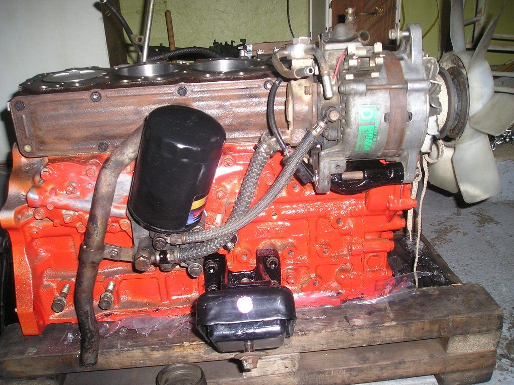

The breather tube on my push rod cover on my 84 3B fell off and decided to take a hike down a logging road. Has anyone ever welded a new tube piece on before? The pushrod cover itself is discontinued and I can't seem to find it anywhere. Would I be able to weld it in place if i properly cleaned the surface of the cover? If anyone has any input or knows the whereabouts of where I could find this piece, it would be much appreciated!
I was just looking at that plate today on my spare 3B. It's a bit rusty and I was wondering if a piece of flat metal would work as a replacement. I have welding a oil pan so I can't see why you could weld on that. Check the classified section there are a few people parting out engines.
Not familiar with these motors,but would a splash guard of some kind be needed just inside the push rod cover before welding the new tube on?
Don
I would mig it. These engines vibrate ALOT so the secondary support should be part of the new design. Maybe get some electrical conduit with a 90 degree bend.
FWIW there's meant to be a bracket on the tube that bolts to the oil filter housing, it looks like yours was missing.
