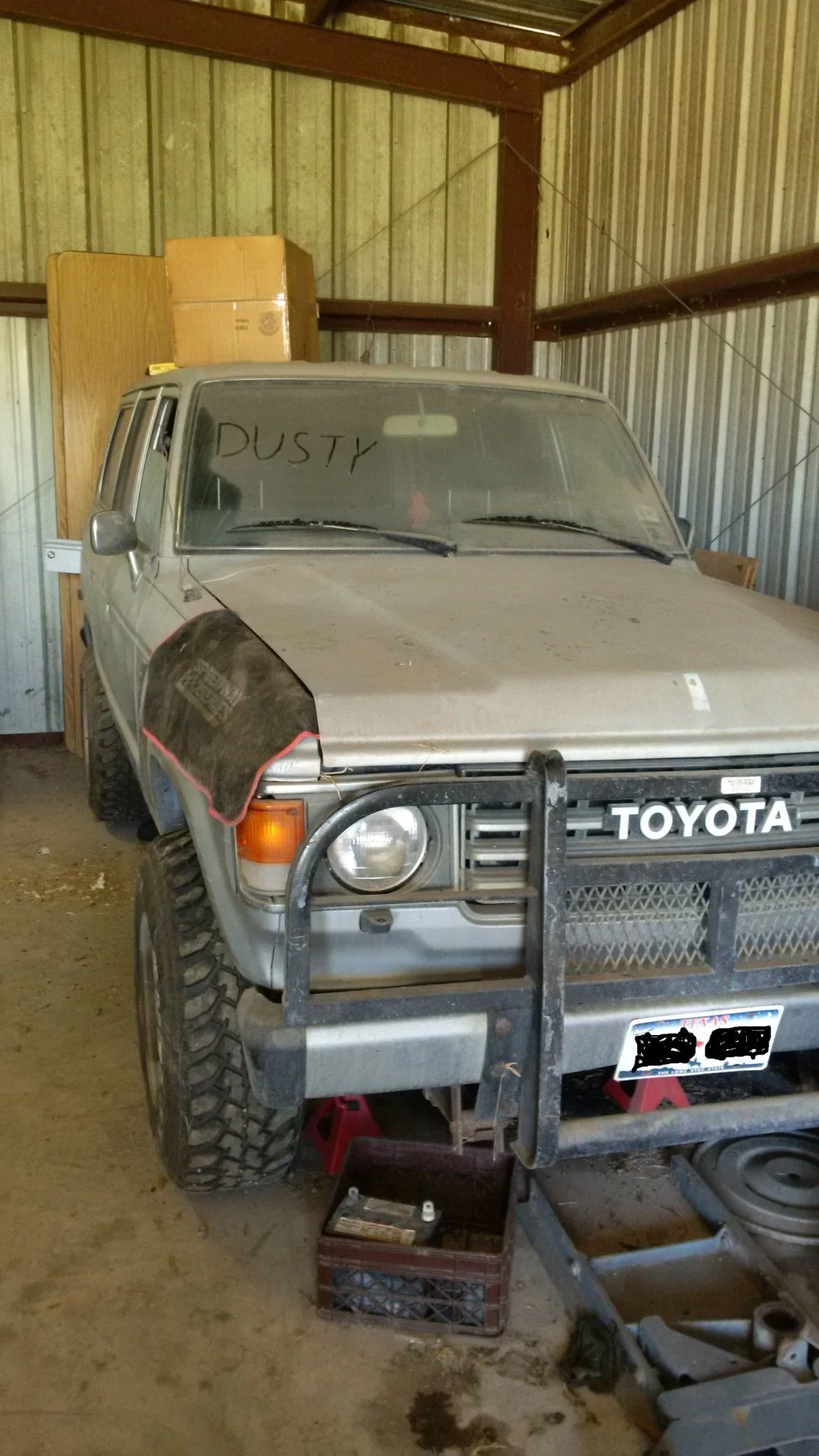

Good to see you back working on your FJ60! I think we deserve some pictures by now :)
Never seen a bumper add-on like that one, must be for an American truck or something. Just looking at how it meets the bumper end cap.
Thanks for the pic! Now get Dusty running! @GasganoFJ60
@GasganoFJ60
The grill guard was put on by the previous owner. It's actually heavier than it looks.
