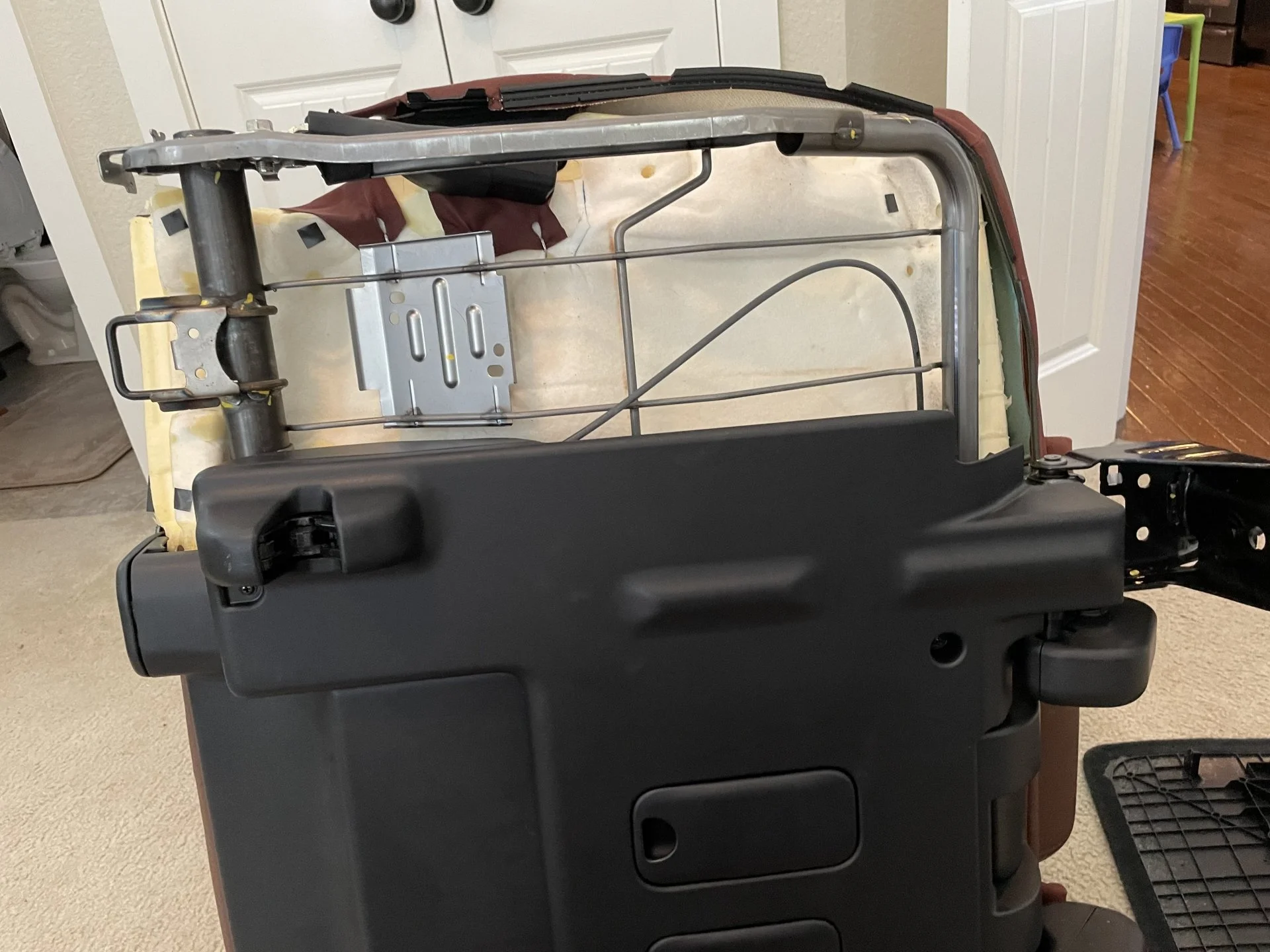

With the family growing to 5 kids now, we were really feeling the inconvenience of not having quick pass through to the third row. We had been making due with having the kids in the 3rd row climb over the folded center seat, but add backpacks or anything else to the equation and that becomes a much more tedious task. After looking at parts diagrams it seemed that the center back rest should have an easy enough time coming off and that was validated after about 30 minutes of playing around with disassembling various parts until the whole piece slid out.
Of course why stop there, the bottom panel under the middle row seemed to be a separate piece from the main unit, so a little prying and removal of screws showed that to be true.

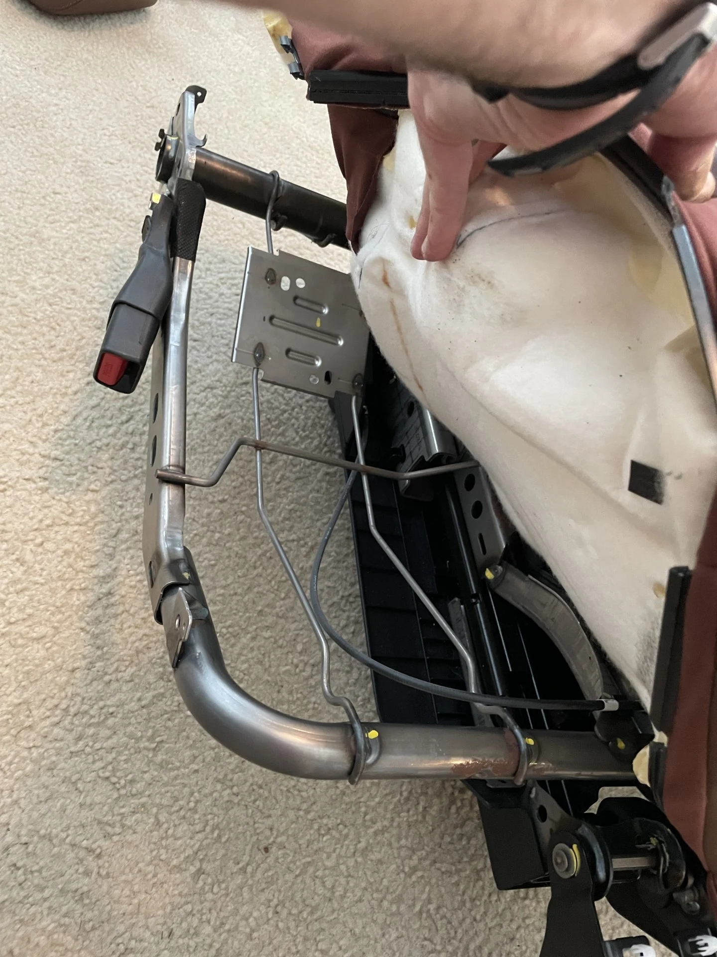

The steel structure clearly goes all the way over both the center and outside seat, but the cushion and leather could easily be played with/cut/modified to just cover the outside seat.
So where should I go from here? Retreat and reassemble the bottom and keep the whole bench and just take the added benefit of removing the backrest? Or should I continue the surgery and cut the frame under the middle seat, clean up the exposed areas with some abs plastic and get true walk-through access? Im not worried about losing structural rigidity because there is another large frame piece running north to south in the same direction as the outermost rube (can be seen just under the cushion in the shot above).
I love the idea of keeping full seat functionality with this route (side airbag, tumble forward/back/ slide forward/back), even if its means not necessarily having totally symmetrical seats on each side, but I don't want to end up creating a giant mess either. Thanks in advance for any advice/insights I could use before proceeding any further.

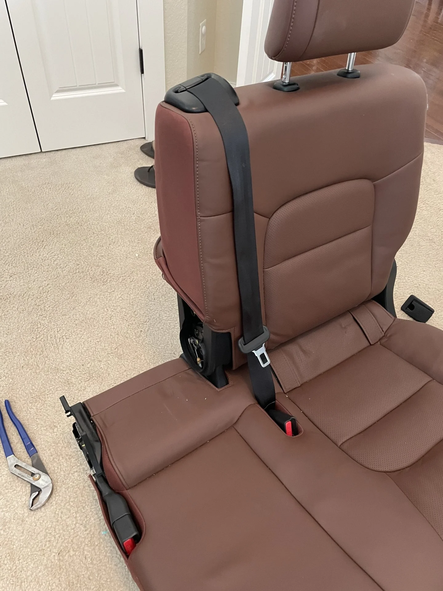

Do you have anymore details on how you disassembled the seat? I want to get at the mounting brackets for the seatbelts to clean up some spilled soda the prior owner left me with. Disassembly as you have done is the only option.
I recall starting with removing the screws from the hard plastic trim pieces in that area and then disassembling from there but after that I don’t recall the details. Don’t have cruiser anymore to verify…
Appreciate you commenting regardless.

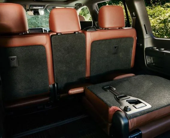

Here's a random picture from the internet of an Aus vehicle...looks promising.
Do the RHD drive Land Cruisers have the 40/60 split reversed?
If so, you could get the 40 side from a n Australian/Japanese/etc... LC.
What am I looking at? It looks just like my 2020.
The bolt holes in the second row are not symmetrical from one side to the other so there's no way of bolting a 40 section to 60 section without making your own holes or custom mounting brackets.
I’d take the 9 secs it takes to fold the seat up, like I did for years in older SUVs. I don’t understand wanting second row buckets, you give up seating?
The 40 split is on the driver side. If the bolt holes line up, you could conceivably put a 40 split chair (one from LHD lc, and one from RHD lc) on both sides and have an open middle.

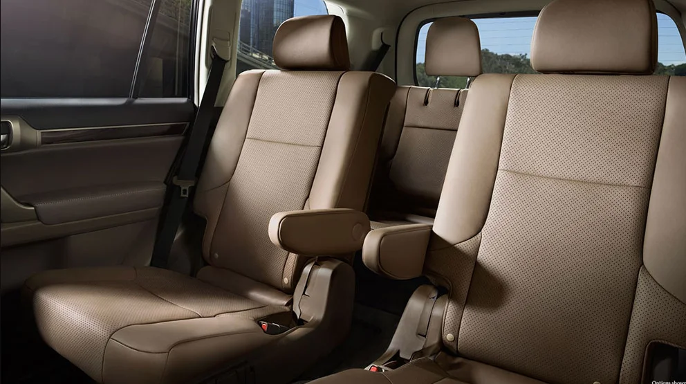

I love the design of the second row of the Ford Explorer, captains chairs that allows entry to the third row but with a very low floor-level center console which has a couple cupholders. Maybe the Sequoia is similar and others too....
Hey - how’s you actually get the middle section out? Do you need to take the entire unit out of the car in order to get the middle section to slide out or can it be done with it still installed in the vehicle?
