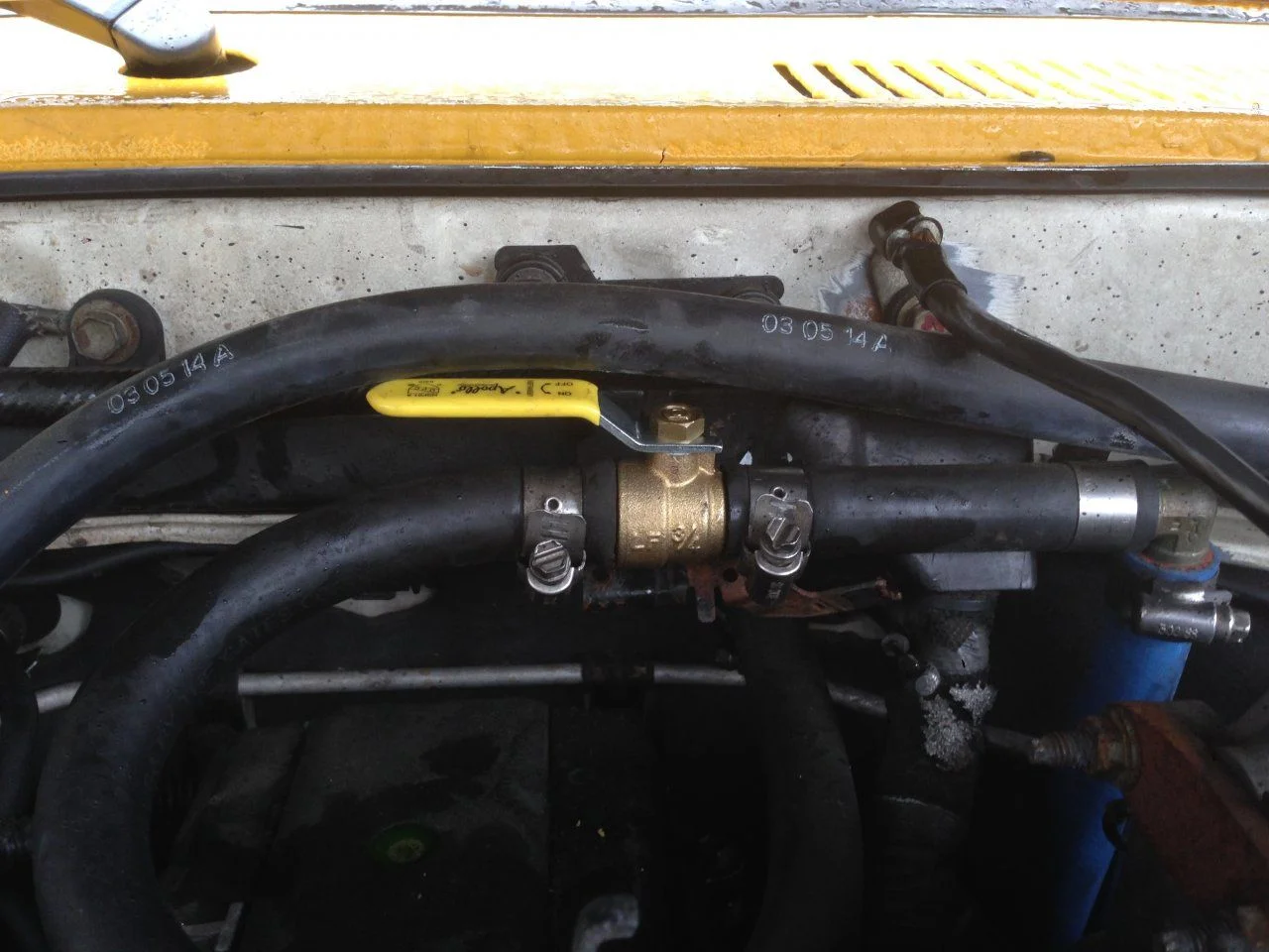

Went to Lowes and picked up a 3/4 PEX ball valve. It fit like I expected even though I wanted one with a shorter handle, it will do. Warmed her up and no leaks, heat works great.
Note: you want a 3/4 ball valve, NOT the 1/2 like I previously stated.
The PEX fittings measure 5/8 OD.
Here it is installed, just resting on the old valve's mounting bracket. You can see where I have a 3/4 PEX elbow in the system already, leak free for 2 years. The hose above it is for my OBA.
Any additional info on this install...any downside? Not seeing why this isn't more popular. I'm all for OEM, but this just seems stupid simple, robust, and quite effective.
I don't see any downside yet. No leaks or anything, heat works great. Once I had the correct valve I just cut a fresh end on my heater hoses ( I usually make them extra long when I replace them so I can do this once or twice during other repairs) and used good clamps. Strictly speaking the PEX barbed ends aren't designed to have rubber hose clamped onto them so you need to push the hose on as far as you can to get a good seal and enough space for the clamp. I think this brass valve is a way better solution than the chinsy plastic heater valves I can afford.
