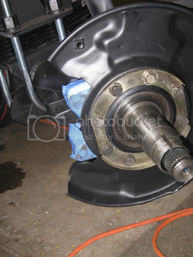

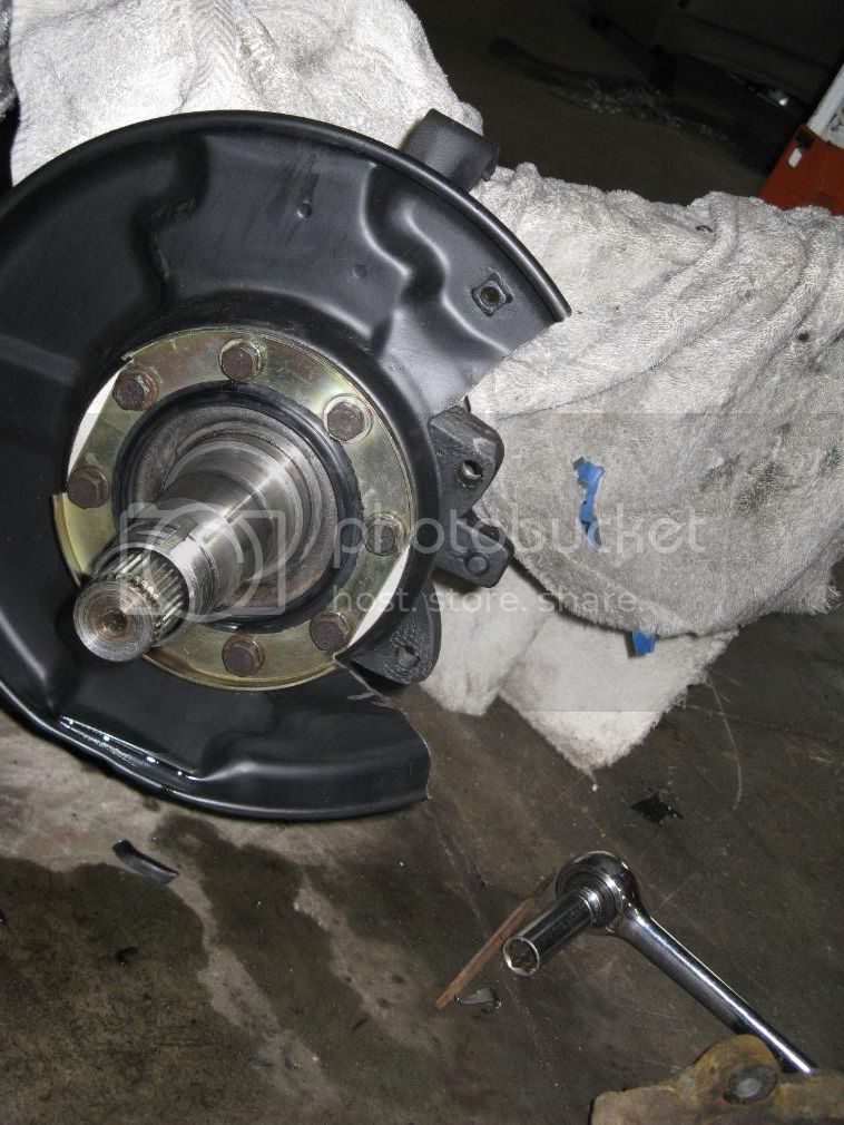

Anyways....I trimmed my dust shields with a cut off wheel, not too much has to come off to make a good fit. One thing i am pretty shure of is that you cannot just get rid of the dust shield, it needs to be in there to have proper spacing of the spindle assembly. You could just get rid of all the material around the flange portion. I am not sure what you want to do there. I have some pictures that might be of help to you.
Sorry the picture orientation dosent match...
Here is the before
Here is the after
Hope this helps..:cheers:
