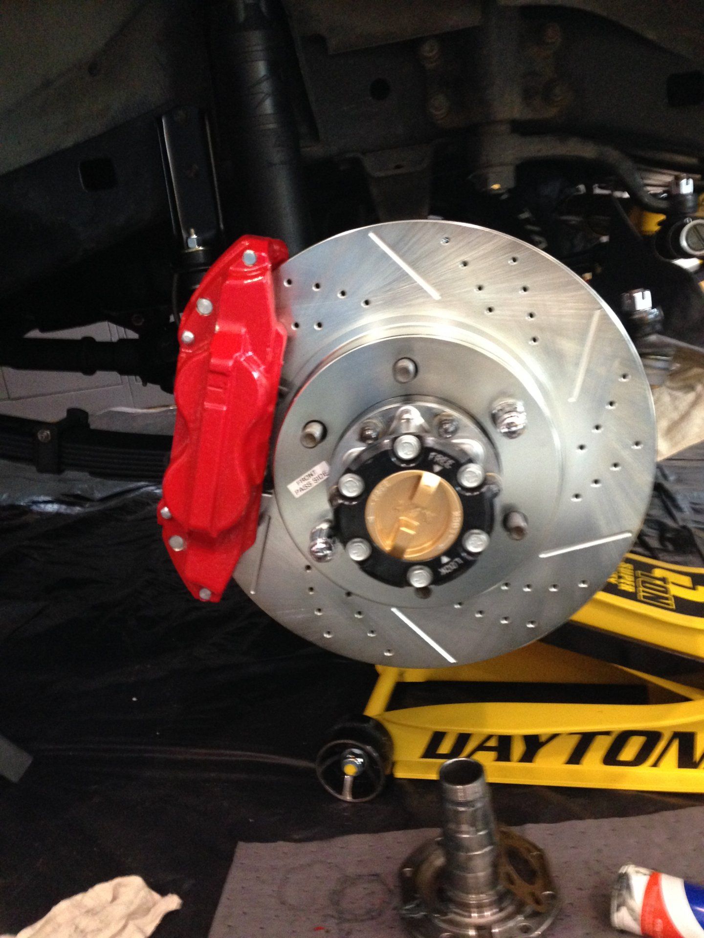

I used the 5th gen 4R brakes and my tires are pushed out quite a bit. I also do not intend on keeping these Method wheels )if anyone in the NYC area wants to buy them let me know) so I will def be finding a classic looking wheel with a better offset to fix this
