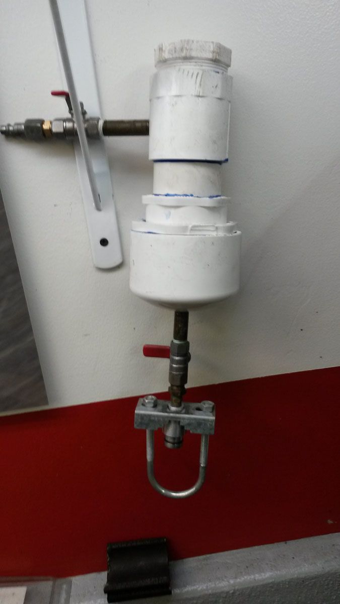

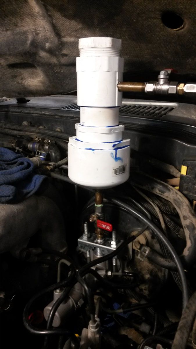

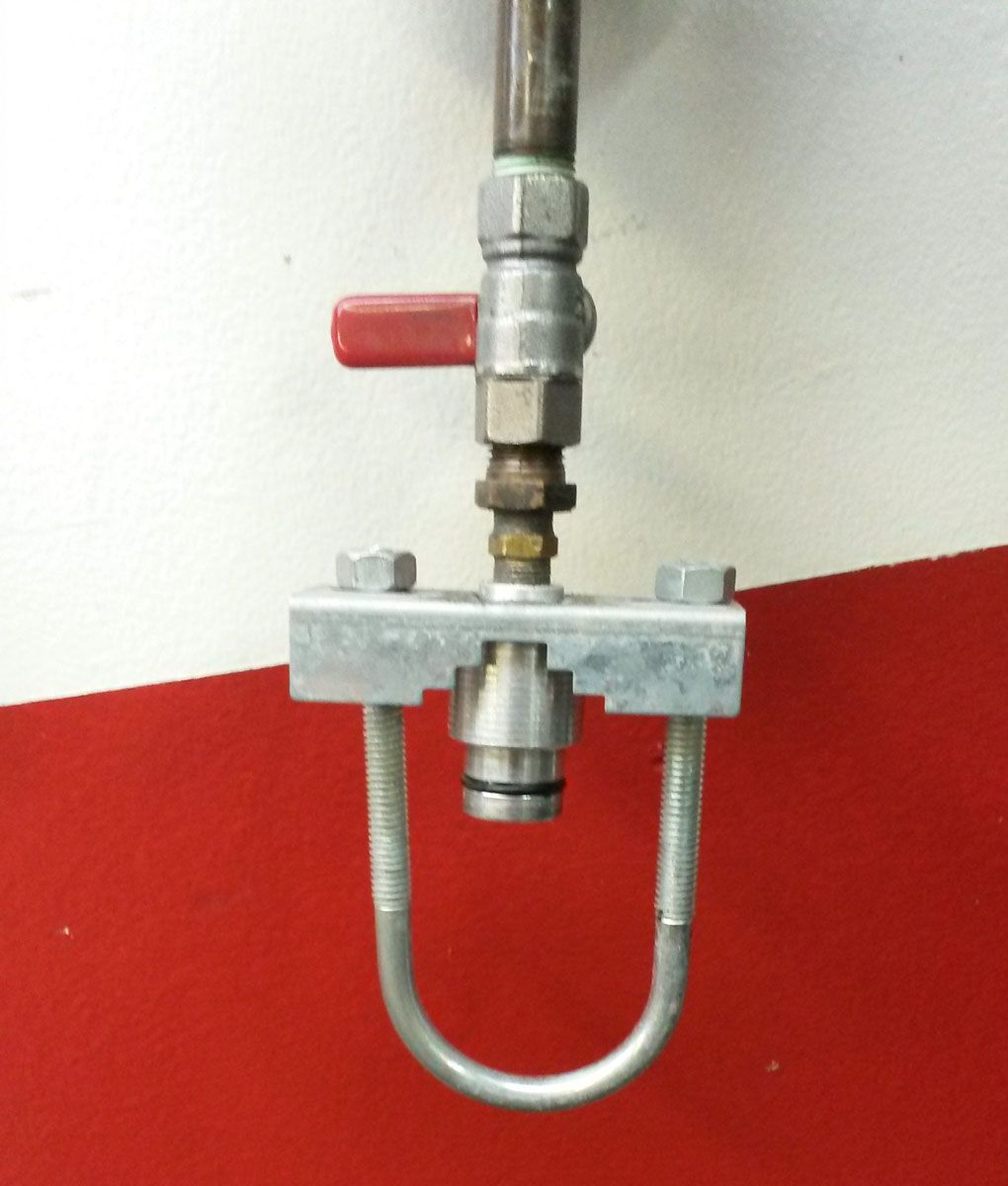

I've had the best luck using the pressurization method. It is quick, easy and 100% successful in getting the air out. I made the one in the photos, but they can be purchased and look much nicer. I add a quart of new fluid in the bleeder, use about 40-psi and bleed each corner quickly.
Like it! but how you connect it to the master cylinder? It is not clear on the picture...
It's attached using pipe clamp.
Remove the brake fluid from the MC reservoir using a syringe and remove the plastic reservoir from the MC. Insert the bleeder into the port of the MC. Use the pipe clamp to hold the bleeder on the MC when pressurized.
Works great.
