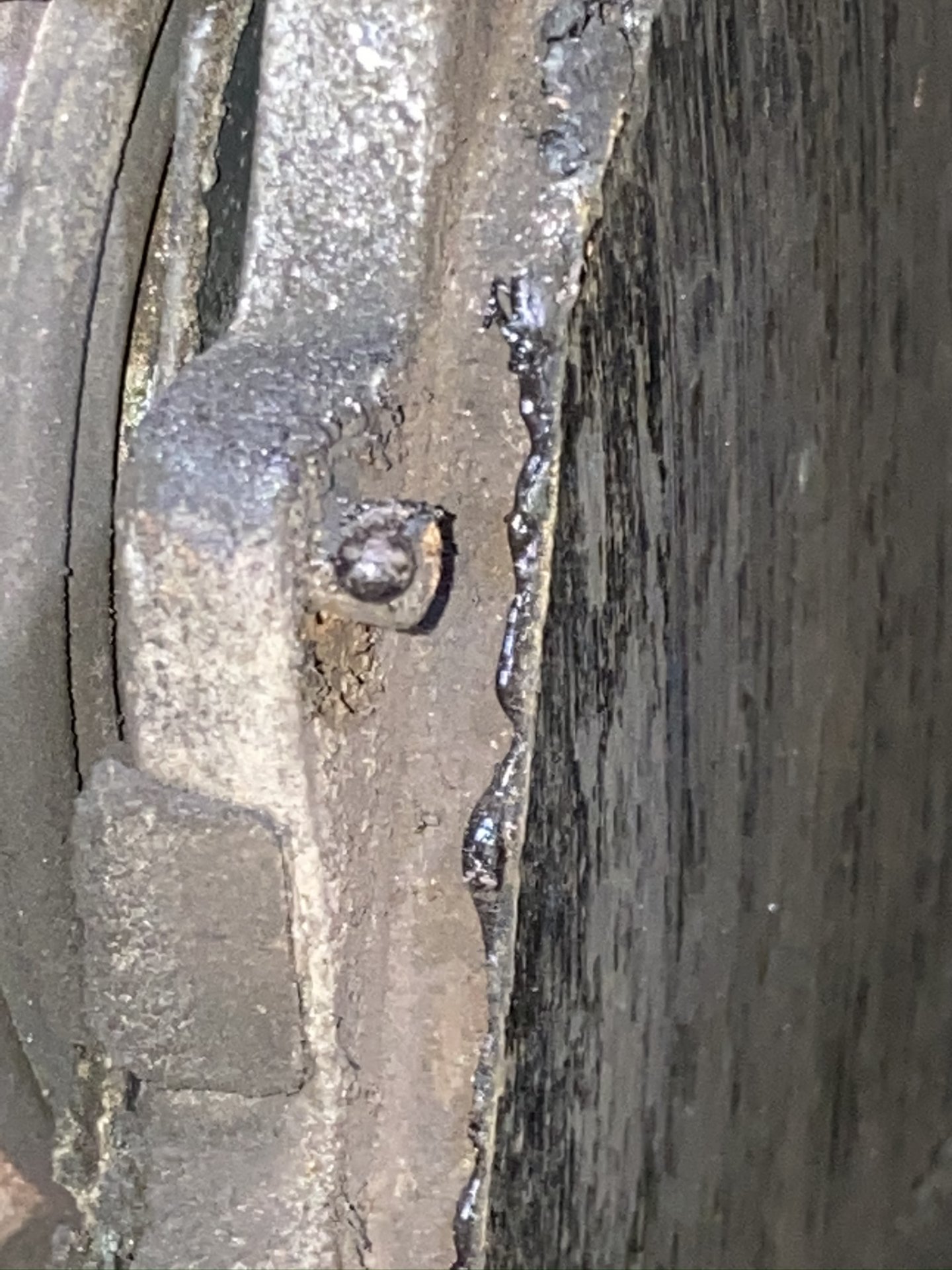

Here a set of cooked rotors I pulled last month, from a TX rig. Which TX, doesn't have many long descents that I know of.
Pictures doesn't show how black they really are. Driver complain his newish aftermarket rotors already wrapped. They were wrap the day china spit them out of a factory. It's overheating from riding brakes on downhill, that revealed the wrapage (run out out of spec)
Again hard to see in picture. These pads from CO driven rig (Driver from flat land or rather hilly TN). They're are melting. In a less than 3 ton rig (05LC)
Also cooked his caliper piston boots. Any guess as to what seal looks like!
