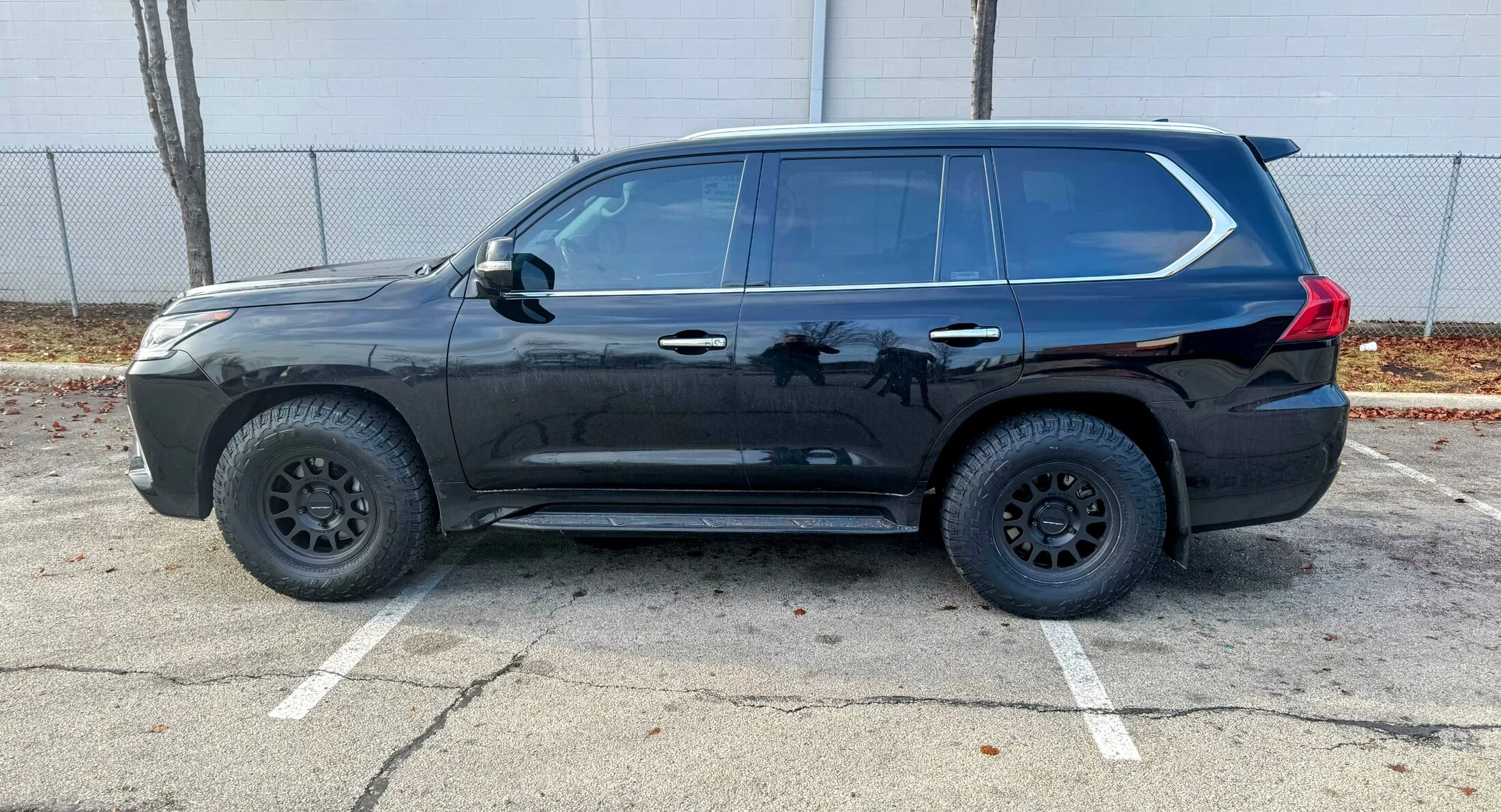

I have 17" ICON on a 16+ LC. No problem, but you do have to be careful where the tire tech installs the interior wheel weights (stick on weights), as the front calipers will hit them if they are in the wrong place.

16+ USDM LC's and LX's got the larger front brakes, not sure about other markets.
My 17” methods fit on my 2018 but I had problems with the wheel weight clearance so I used a heat gun to unstick them and move them.
I also had a rock or something jam between the wheel and caliper and leave a gouge 3/4 the way around the wheel within a month or two of installing them

Methods will clear but not a lot of room left. Like someone else mentioned above, if you travel a lot of gravel roads you might get something wedged between the caliper and rim.
