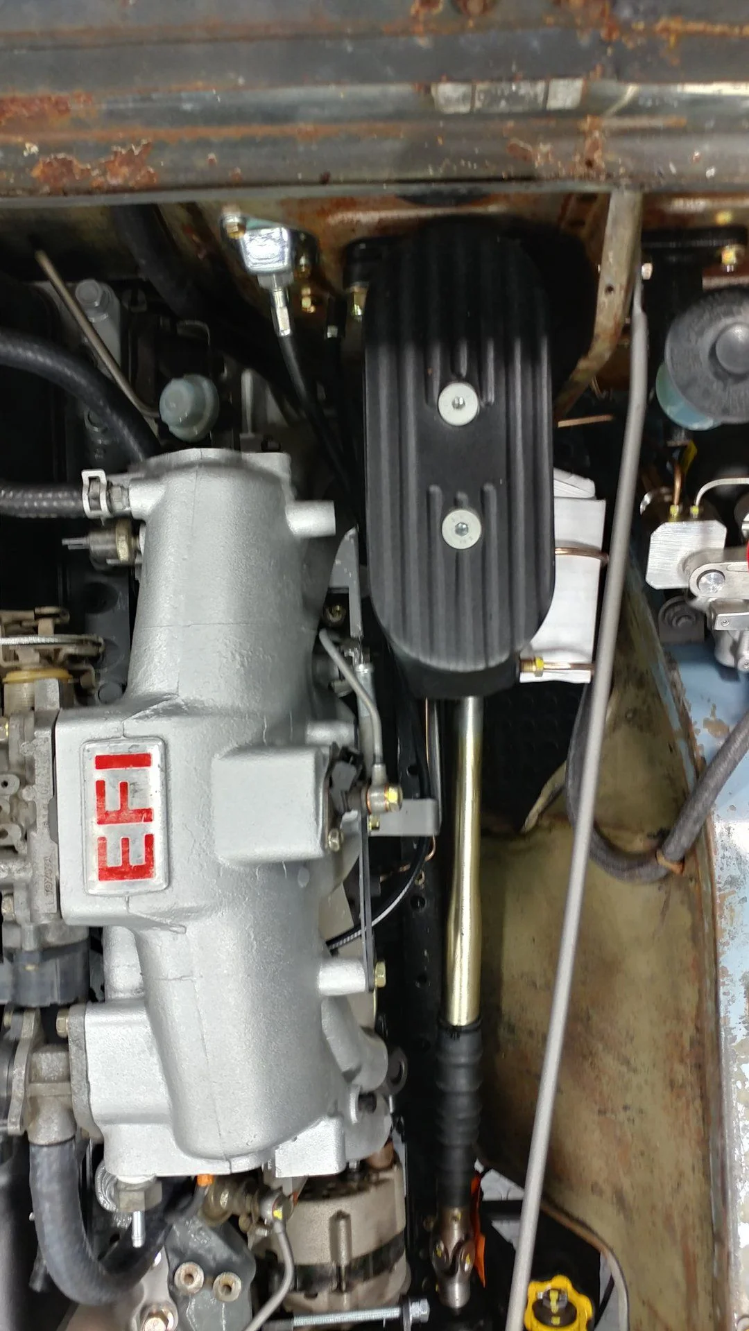

After some major time on the back burner I’ve been able to make some progress on my 3FE install on the 65 SWB. I’ve read countless threads and it seems like there are quite a few 40’s and even 45’s with the 3FE and most do not specify interference with the 3FE and brake boosters. I did see that a few guys have scabbed in a newer firewall and maybe that’s why they don’t have an issue?
There is really no chance in hell mine fits even with the small geo metro booster. There are definitely a few options to resolve this but I wondered why it’s not discussed more?
It seems like most don’t have major interference or just opt for a slightly smaller booster. Is the brake setup on the early trucks “inboard” more than the early to mid 70’s rigs?
Appreciate any insight.
When I did my first 3FE conversion on my 45LPB, I immediately saw that the master was going to be a big deal. We've got the ability to modify anything we need to make things fit so none of it is a big deal but time is. And I have an aversion to cutting sheetmetal in old trucks. A non-boosted dual circuit master wasn't an option(which is probably what a lot of people do because it's easy) so I went with my electrically boosted master. I love it. Pricey for sure but it saves countless hours of labor which in my world, pays for itself. Less time on my trucks, more time on customer paying work.
I've run my setup on 3 trucks now. It just barely clears. They are all mounted on early trucks with a rib. I have a 71 40 that doesn't have a rib that will get my setup on it next when a 3FE goes in. I'm curious to see if I can some how try and use the booster on that one(probably a late 70s) as I really like the brakes. I don't see it happening easily though.
I was poking around my trucks this morning....i have a 78 in the shop and my LV. My LV measures roughly 13" from the center of the master cylinder opening to the corner of the cowl/upper bib/fender. The 78 measures 11". So the master is over 2" more on a non-rib truck(not sure if ALL non-rib trucks are the same or not). That's a lot but those 3FEs have huge plenums on them...they take up a ton of room. Maybe moving the motor up and over a little? Not sure. Seems like a lot of work. Maybe a custom plenum on the 3FE? Lots of work.
Even if a booster cleared the plenum, there is still the ebrake mount and throttle cable on the firewall right there....plus the clutch master. Lots to work around....

Glad I could be your inspiration...you'll love that 3FE in the truck. All that work on the brakes will be worth it. It's really a perfect motor. Too bad they are becoming hard to get these days....
