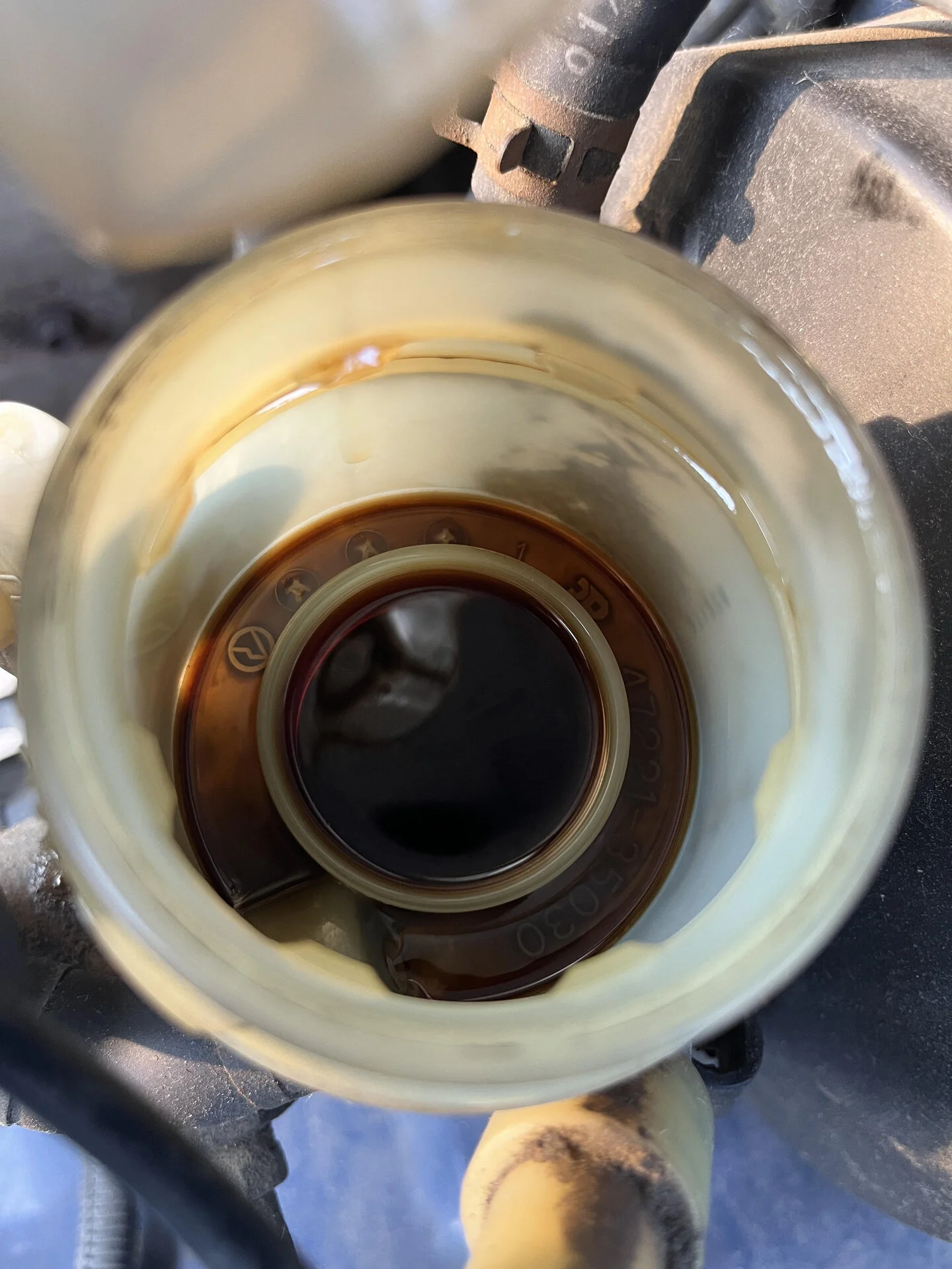

I understand the process for the most part, but I'm confused about the 5th bleeding spot (according to Hayes manual), the master cylinder. Do I need to take the cylinder out of the truck to bleed it (bench bleeding I've seen it called). How would you bleed master cylinder? Also in my research I came across this comment in another thread:
"Did you let the master cylinder go dry? If so, you need to bleed it first, refill and then rebleed the rest including the LSPV."
Unfortunately I did let my master cylinder run dry is there anything else I need to do because of this? My truck is a 1984 Toyota Pickup 4x4 base model. I'm pretty sure it does not have a LSPV, but wanted to double check.

I looks like there is still fluid in the master cylinder. I completly disconnected the brake line from the front wheels and they were left unscrewed for a couple of weeks. I figured it would have all drained out, but it looks like there is still fluid in there. So do I need to take the master cylinder off to bench bleed or was it not run dry? Thanks! Also if I do need to remove master cylinder should I just replace it with a new one?
Bench bleeding is for when you are putting a new master cylinder on, new out of the box. You clamp it in a vise to hold it and put a couple tubes typically included with the new master into the outlet ports and back into the reservoir. You fill the reservoir and push on the piston of the master to pump fluid out the ports and back into the reservoir. It's just a way to pump the air out.
On yours, I would just wipe out the dirty reservoir and fill it up with fresh fluid. Then open bleeders and gravity bleed it first. Just to get the system mostly filled. Then bleed it in the order the service manual says.
I would think your truck would have the LSPV. It's the one on the rear that the rod from the axle attaches to.
To avoid the master cylinder going dry, make sure you monitor the fluid level as you bleed the system. Add more as it gets lower from bleeding. It's easy to lose track while bleeding it. If it runs dry ,you have to start all over because you just let air get in at the source.

or if it runs dry. Can be done in the truck easily enough, though. Should only take 10 minutes, give or take.
And if I do need to remove master cylinder to bench bleed, should I just go ahead and buy a new one. I imagine the current one is the same that came with the truck 40 years ago.
Any ideas why there was still fluid in my master cylinder even tho the lines to the front calipers were disconnected for weeks? I figured everything would have drained out.

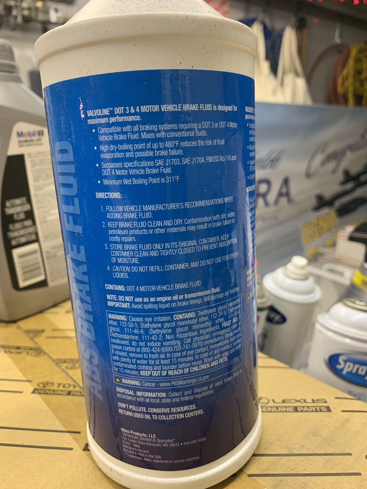

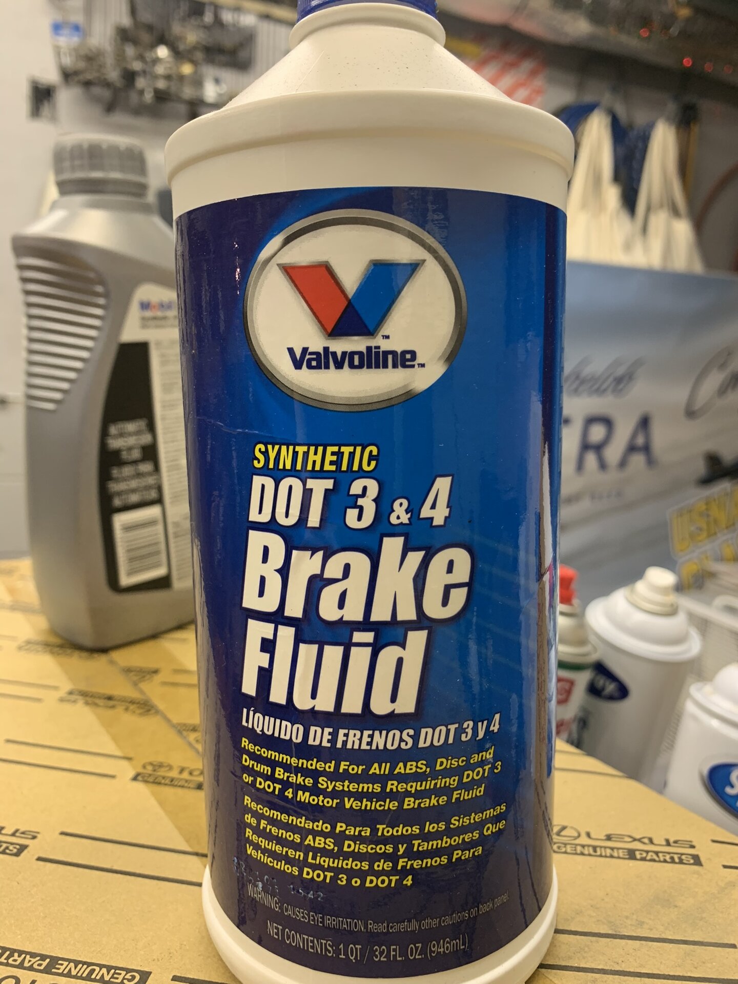

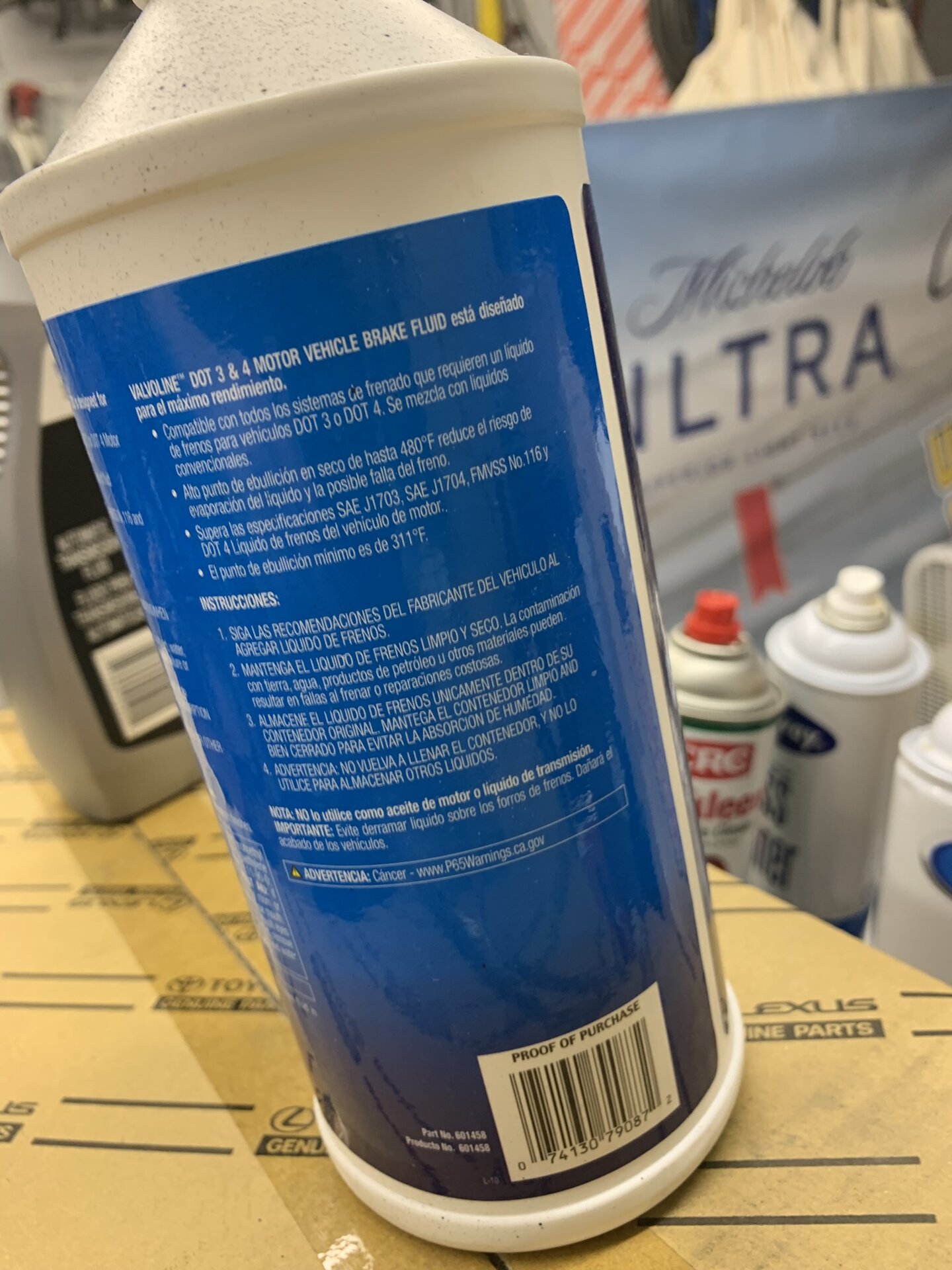

View attachment 3386274View attachment 3386275View attachment 3386276
I bled the brakes earlier with DOT 3 Prestone. I don't think I've seen Valvoline brake fluid in my area. Does it make a noticeable difference and what does that difference look like? Do you also use valvoline engine oil?

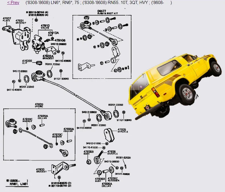

please let me know if i got this PARTS DIAGRAM RIGHT
1984 4WD pickup
Your doing a great job here , !
MATT
its at advabce auto ,$12.39 is 32oz :cool: :wrench::wrench::wrench:
yes , in all the fleet ,

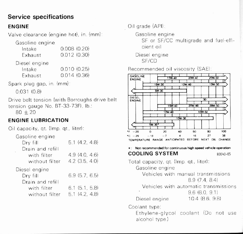

do you know for certain the correct viscosity grade for a hot SIAGON Summer
Find your owners manual and this page chart , I want to make certain , for good measure :wrench:
