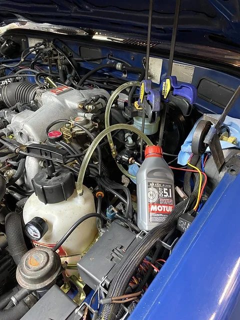

My truck needed a full bleed from the master out. This was so easy and only had to check the pressure a couple of times for all four wheels, no separate bleed of the master needed. The universal cap and chain works fine for the stock non threaded cap.

I can see that there is a huge potential for a big mess. That said I was very carefull with the setup, I wet the rubber seal on both sides with brake fluid and confirmed it held pressure before adding any fluid. old T-shirt just in case. Having done this a lot of times with assistance this is worth way more than the cost along with a better bleed.
I have a Motive, sometimes the hook n chain seals great...sometimes not, which is a big pita. A Mud member posted a pic a few years back using two short sliding bar clamps to clamp the Motive cap on tight.
I like the idea of the dedicated cap but between my rigs I’d have 3 different ones.
Are you talking about small Quick Grips or whatever?
