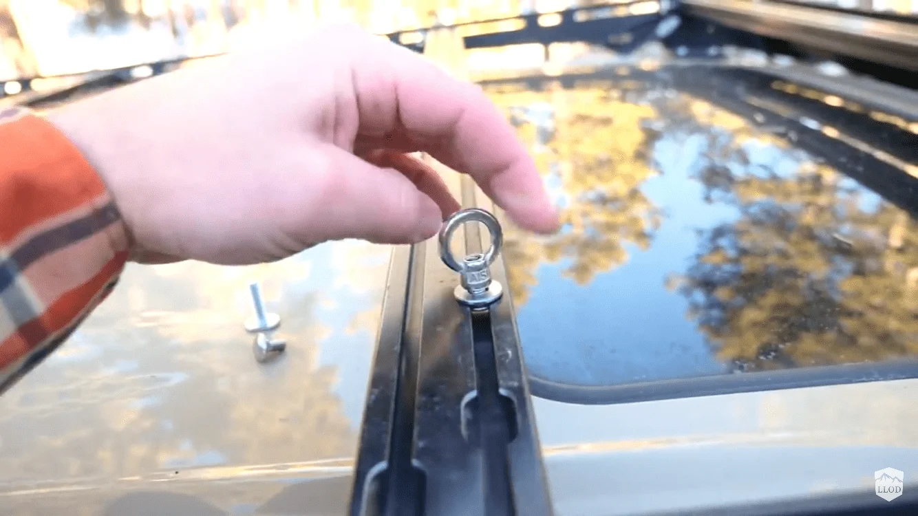

@dogfishlake I may have missed it but do you (or can you) machine the slots in the rails to accept accessories similar to the Prinsu? I’m not totally clear about how to attach to the slots on yours. Sorry for the rookie question. Here a pic showing what I’m thinking about.
You would have to pull the rail off of an end to put the rings on that way. Standard T-nuts are this way as well. For other items that clamp on, like "quick fist" clamps, you can use drop in style t-nuts. I don't sell them myself because I don't get a discount and don't need to be charging you extra to sell them through me. The best place I have found to buy them is tnutz.com. They have been a good supplier to me and great pricing. You would be looking for 10 series t-nuts in 1/4-20 size.
I haven't had call for such a machined slot but I will look into possibly getting this done if requested.

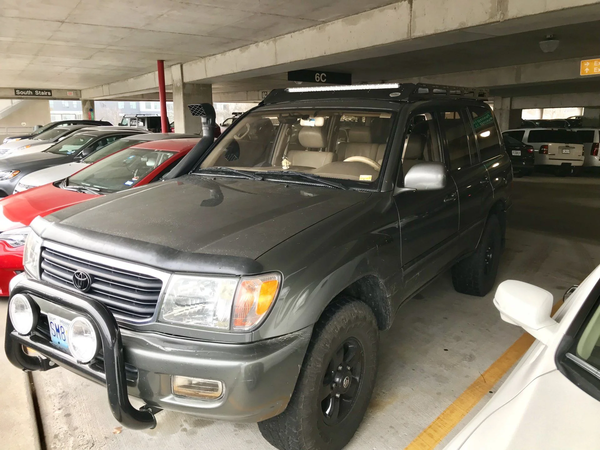

Did I just spot your rig in the Harmon parking garage at the UofA?? If not it’s a twin and I love the rack!!

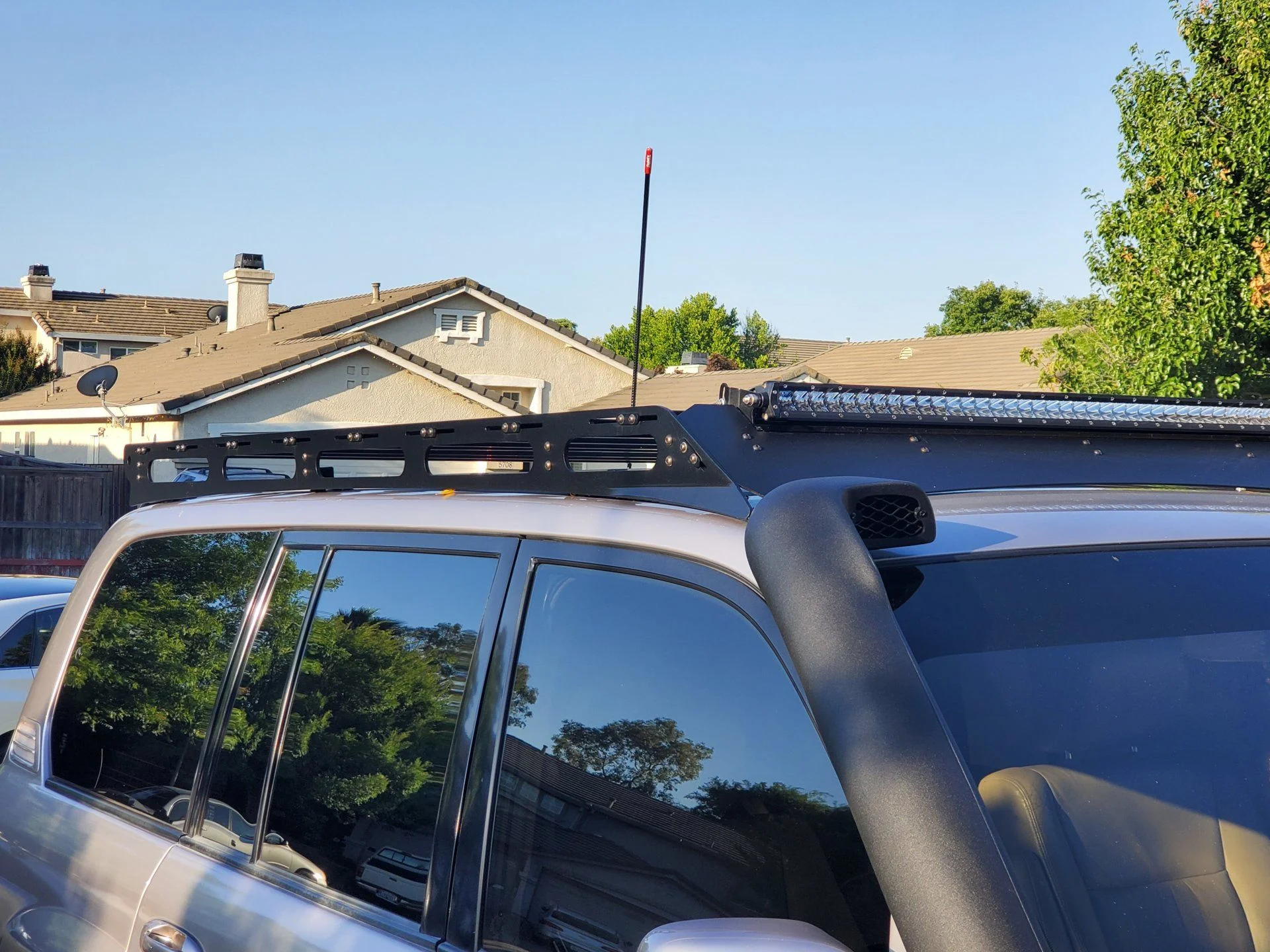

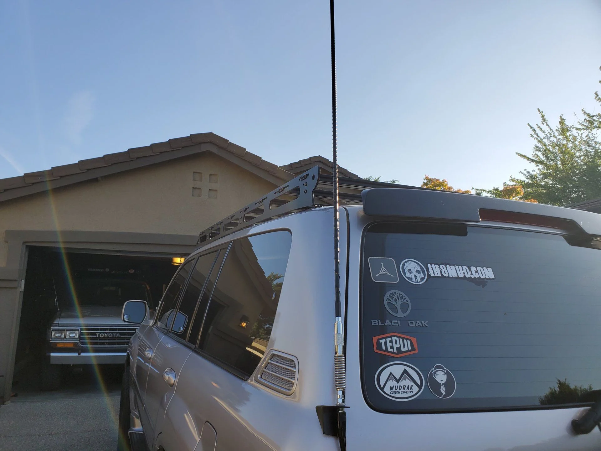

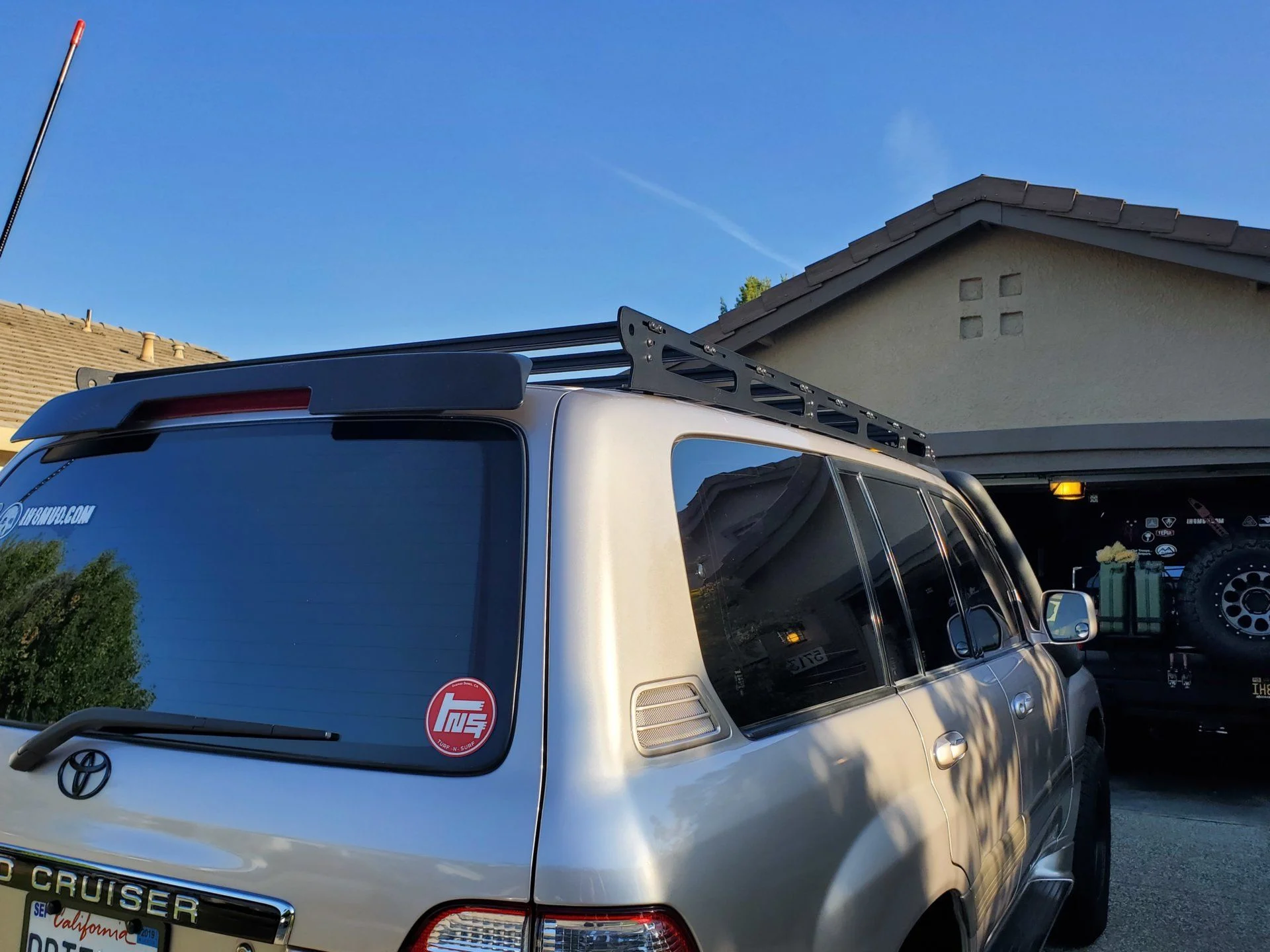

Does anyone have some more pics of this rack installed on their rig? I've narrowed my choices down to this rack or a Rhino Rack. So just wanting more info on how this one looks as well as try to understand how things attach. Thanks
Here you go
Wow. That was fast. Thank you. You happy with the rack? Is it easy to attach things like a shovel or axe? RTT, maxtrax? What about random miscellaneous loads like suitcases or coolers? Lumber, ladder? Sorry to be annoying.
The racks lend themselves to diy stuff for sure once you are savvy with 10 series extrusions. That said, I am finally getting it together to get accessories and pricing on my website.
