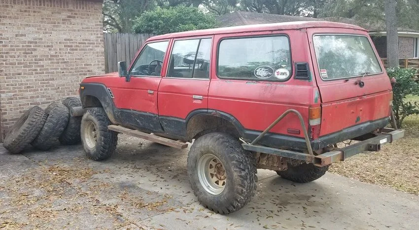

As the title says...I bought another 60. Knew it needed some work, but it's taking more than I expected just to get it running. Figured I'd post a build thread (of sorts), in case you all like watching me waste $$$ and time on another old Toyota.
The backstory: Met the owner in 2015 at "Mardi Krawl" - He's a good friend of one of my friends (Ray Towner). I immediately liked the truck, it had character. It was a bit rusty, but was SOA, on 37's, had a big ridiculous front bumper, and seemed to just go anywhere.
Saw it again in 2016 (this time it was sporting military 36" tires on 16.5 wheels), still thought it was awesome:

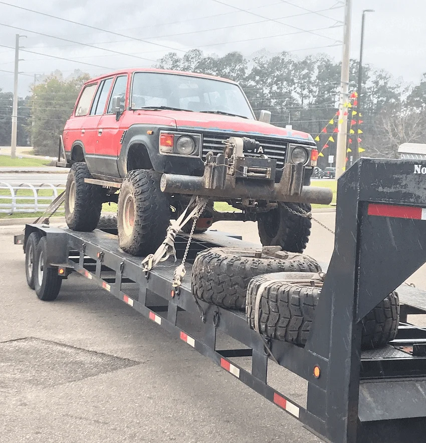

So, we have a long running group text, and late last year, Ray mentioned the truck was for sale. Piqued my interest, but it was in Pensacola...and the last thing I need is another project.
But then the stars aligned - Earlier this month, Ray was driving West to East across Florida, and stopping by my place for a night...and offered to drag this 60 to my driveway. Talked with the owner a little on the phone, struck a deal, and 3 days later -->
...I had a non-running FJ60 with 6 extra wheels and tires sitting in my driveway:

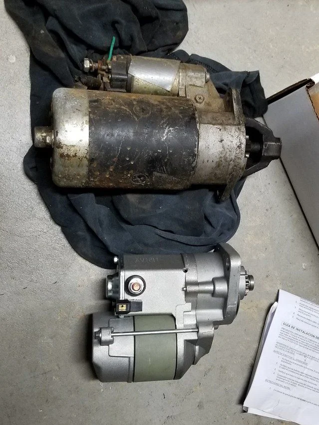

Oh, and I put on a gear reduction starter (as I mentioned before, the other one was iffy...worked only 80% of the time):
(turns over WAY faster now, too)

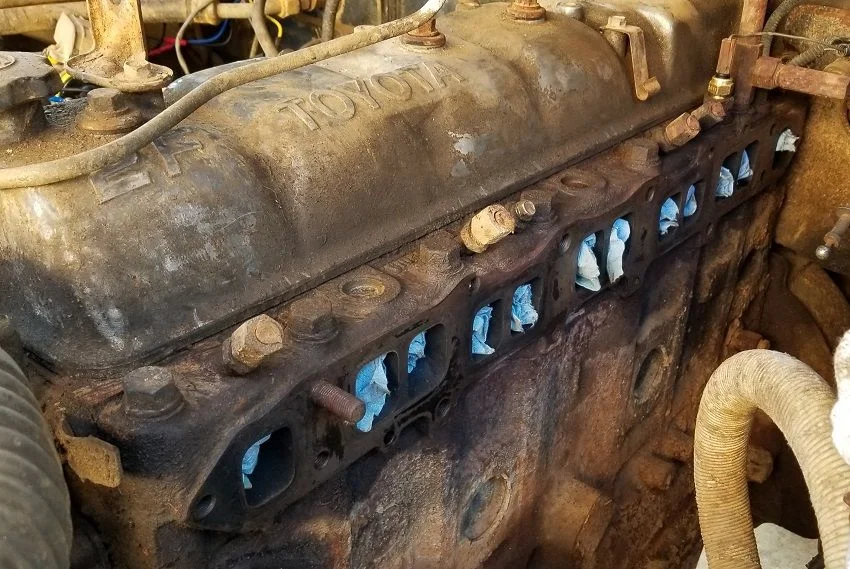

Worked only a half day on Friday, and I snuck in a few hours under the hood. Got the manifold off, separated it, built a "heat riser block off plate" and replaced the 2 gaskets on that part. Also set the heat riser "flapper" in the exhaust to direct the gasses out at all times (don't see a need for that contraption here in FL).
I also pulled the air pump off the motor to assess its condition - Turns out, it had already been "de-vaned"...so I just put it back on.
Once the manifold was in one piece again, I replaced the 3 studs for the exhaust and then straightened it the best I could with a flat block and 220 grit sandpaper. Worked surprisingly well!
The 2 exhaust ports (top left of the pic above) still sit a little under the flat edge (on the bottom of the flange, mainly), but I think it'll work out (fingers crossed).
