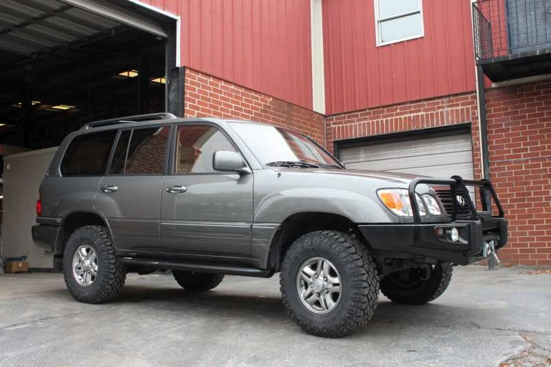

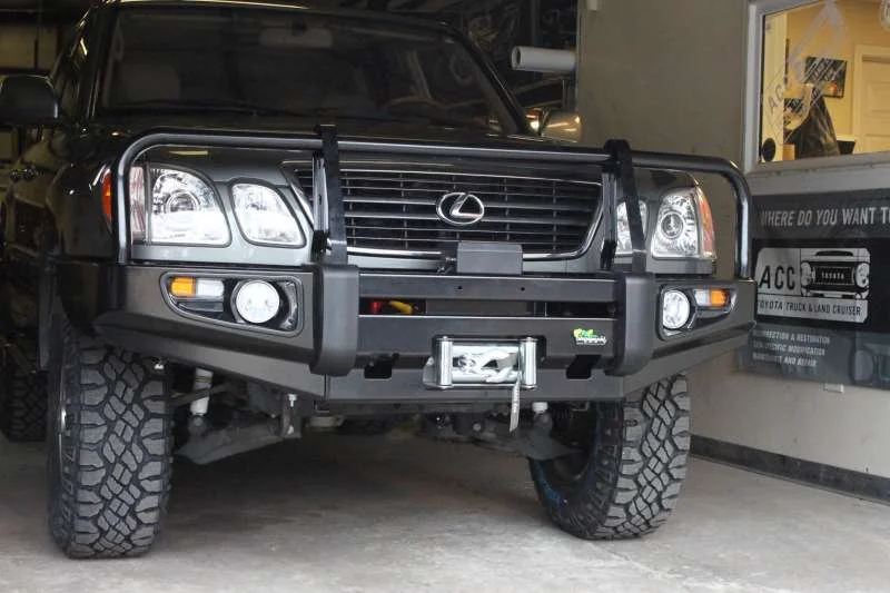

So put in the order for some mods today. I decided to go ahead and have my friends at ACC do the work before the truck comes to Houston.
Ironman Deluxe Commercial bumper (with light package)
Metaltech sliders
Ironman suspension with 2" or so lift
Goodyear duratrac tires (285)
I can't wait!!!

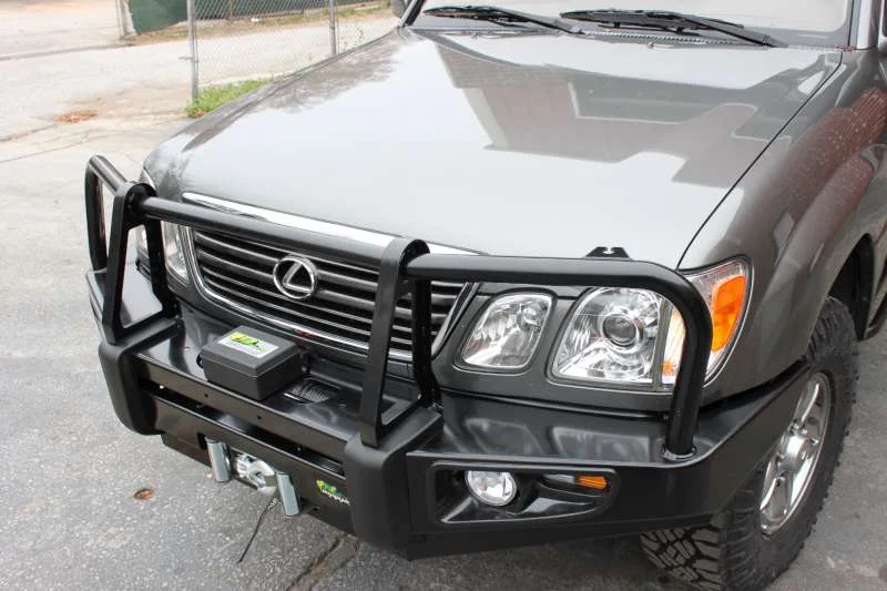

The lift will put you up about 5-6 inches from stock on a Lexus (ask me how I know).
That bumper will be a little different looking since that is a Prado in the pic, but I love that bumper...I have the same plan.

Yep. They will be at ACC. I'll take best offer. Anything to offset the build cost. And for you...I'll make a hell of a deal!
I forgot the slee front diff drop. Also I am thinking about an ironman winch. My install will be the first in the states on an LX, so the US rep is going to come down to see the install. If he's going to be here, it makes sense to do the whole thing, winch and all. Will depend on the price.
BMThiker said:
Will the diff drop make it harder to install skids?
Good question. And one I haven't asked. But the diff drop is needed to correct the angle. So I am thinking no.
