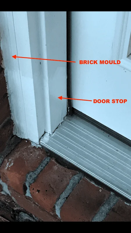

These doors and frames were replaced 3 years back, painted with a quality paint last summer and now are showing wood rot.
Does anyone know a good way to fix these or something to slow down the rot. I was even thinking of spraying fluid film or oil on to at least stop it from growing, until I can drimel out and replace with something like stone based filer I’ve been recently told about.
I’m alittle less than a mile from the gulf in Florida, for some reason they don’t put gutters on most homes in the area which makes no sense to me. That may help some but for the most part they stayed dried and clean with fresh paint which pisses me off his happened so quick.
Any advice or just part of living in Florida?
The wood they use for those pre-hung exterior doors is crap. Having it right against the masonry like that only wicks up more moisture and destroys it faster. As you note, lack of gutters only adds to the issues as it puts more moisture into the masonry as water splashes back up and soaks it.
It's hard to tell from the pictures, but the brick sill looks flat - as opposed to sloped to shed water away from the door. I'll guarantee that water is getting down between the brick and the metal sill. You say the wood "stayed dry," but the brick is like a sponge. It holds water - and then the wood trim just soaks it up over time. Although the exterior of the wood trim is painted, I'm going to guess that the backside and the bottom end are not - and that is where the water is getting in.
Particularly so close to the coast, I'd take the whole door out and flash the opening with EPDM, paint all sides of the wood to seal it, and redo the sill with a greater slope to shed water.

that makes sense coming from behind and under. The house was built in 74 but all new doors, windows and sheetrock in 15 before I moved in. the bricks seen better days and im sure the lady I got it from used the lowest cost option when getting doors so probably cheap china wood just stereotyping.
I guess Ill figure out how long I want to live with it and plan on staying in this home before moving.
Thanks for your reply, itll give me something to say to a handyman when I can get one out

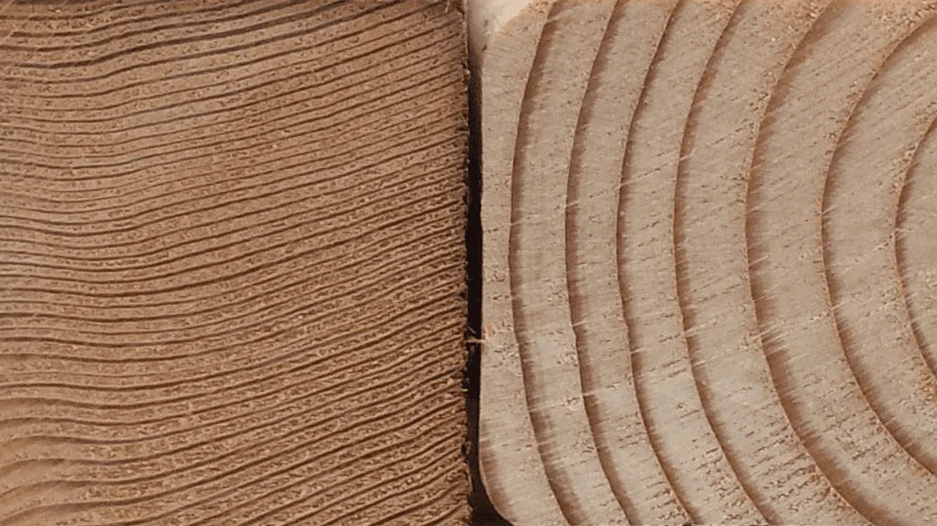

Not as much "Chinese" wood as just that everything is "fast growth" wood these days. This picture is a piece of pine from the 1920's on the left vs. a recent piece of pine on the right. The old wood was so much denser that it didn't soak up water like the new stuff does. As I say, it's like a sponge.
If you were planning to stay for some time, I'd recommend pulling everything out and doing it right. If you just want to keep it together for a few years, you can make some superficial repairs.
Again, it is somewhat hard to tell from the pictures, but the brick mould and door stop are applied to the actual door jamb. Depending on the thickness of the wall, the door jamb may be visible with the stop applied to the face of it and the brick mould applied to the edge of it. It looks like on yours the wall is thin enough that the brick mould applies to the edge of the jamb and butts right up against the door stop.
Neither the brick mould nor door stop is "integral" to the jamb nor attached to the wall, so you can usually get a putty knife behind them to loosen them up and then take them off with a pry bar. Start with the brick mould to expose the edge of the door stop. Replace those with Azek (or other "plastic" trim) so they don't soak up the water. Often, the jamb itself is protected enough that it will be in better shape. Just get new trim of similar dimensions to the existing and put it back in with finish nails into the door jamb. You could lay them in a bead of latex caulk before nailing to help seal it up and then even though the plastic trim doesn't need to be painted, give it all a good coat of latex paint to seal up the joints so water doesn't get in to the remaining wood.
Depending on how handy you are and what tools you have (miter saw, pneumatic finish nailer, putty knife, pry bar, hammer) , this is less than an hour's worth of work.

thanks thats great. its on my radar and to-do list this will help big time when the time comes.

As an Architect, I actually see more problems in houses from the past twenty years than from the ones 70+ years old. Not only the better wood from years ago, but a lot of it has to do with the details. Now, too often builders don't pay attention to how they put things together and rely on caulk to seal it up and make it work. Back when they didn't have tubes of caulk, they actually built things so that they would naturally shed water.
Like I say, that brick sill should be sloped more to better shed water. And a related question - how wide are the soffits on your house? Modern houses all seem to have lost wide soffits - the edge of the roof is right at the wall. Older houses had wide soffits to shed rain away from the walls and foundations for a reason… ;)

I have fixed issues like this by surgically cutting out the bottom ~6" of trim and jamb with a multi-tool saw, then replace with the same size PVC. Caulked and painted well, you can't even tell from a few feet away unless you look really hard. You're better off in the long run to replace it all, but this also works.
