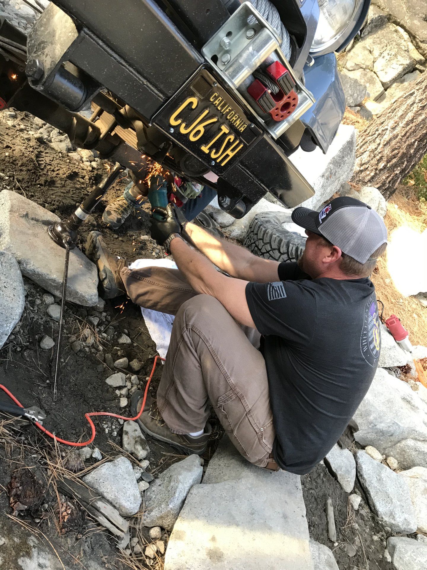

My stock bottle jack was the only thing holding it up aside from his tire underneath as safety. Everyone thought it wouldn’traise it that high.
Btw he busted the yokes on his ujoints on little sluice.
